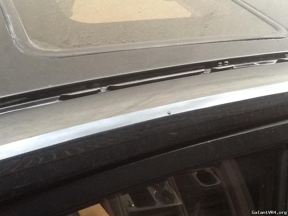

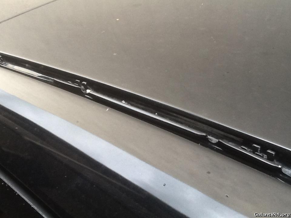

raptorWagon
May 17, 2007
2,828
Oak Harbor, WA
Quoting kama1:
They clamp on here.
And here
Alan ^ these are normally covered with a rubber strip. /ubbthreads/images/graemlins/wink.gif
