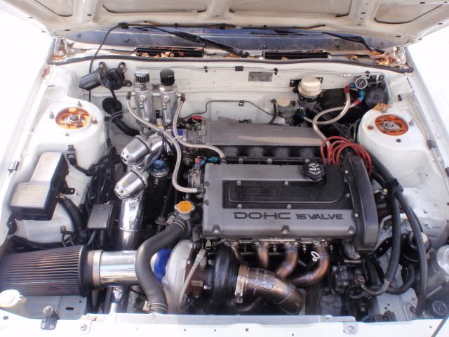

I used a stock 1G bottle. Mounted in the pass side wheel well. The factory neck sticks up through a hole already there behind the headlight. Extend the hose and wires, done. And looks factory.
Have the exact same thing

I was going to try and get my hands on one of the RHD ones as seen in this photo, and mount it where the resistor pack sits, but i wound up making the stock bottle/location work for my setup. I may end up putting something in the ABS spot, now that mine's open.

The 1G tank looks baller behind the headlight. I'm totally stealing that.
