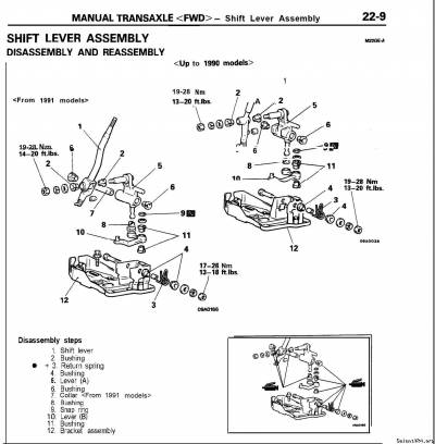

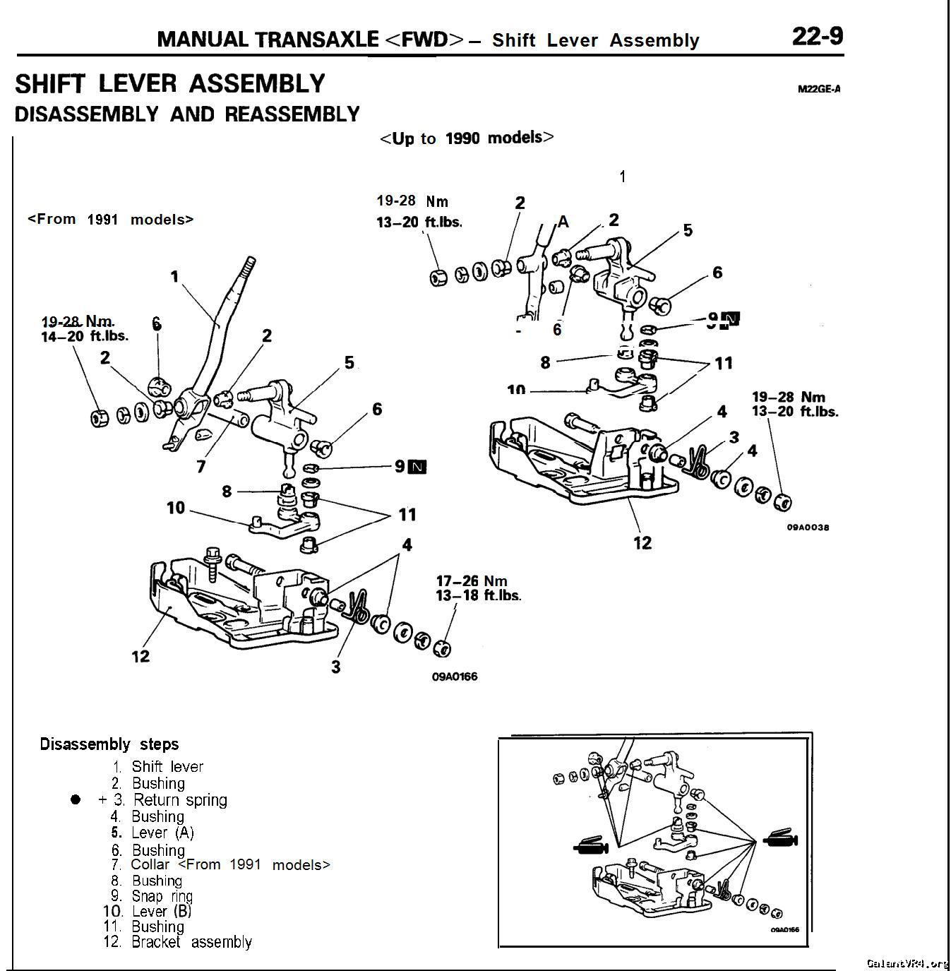

I had tons of side to side play, not in the actual linkage but just the shifter. I replaced the bushing in the shifter shaft(#2 in that diagram) and it made most of the play go away. The only other bushing I want to replace is #11 in that diagram, IDK what its called but there is still some play in it.

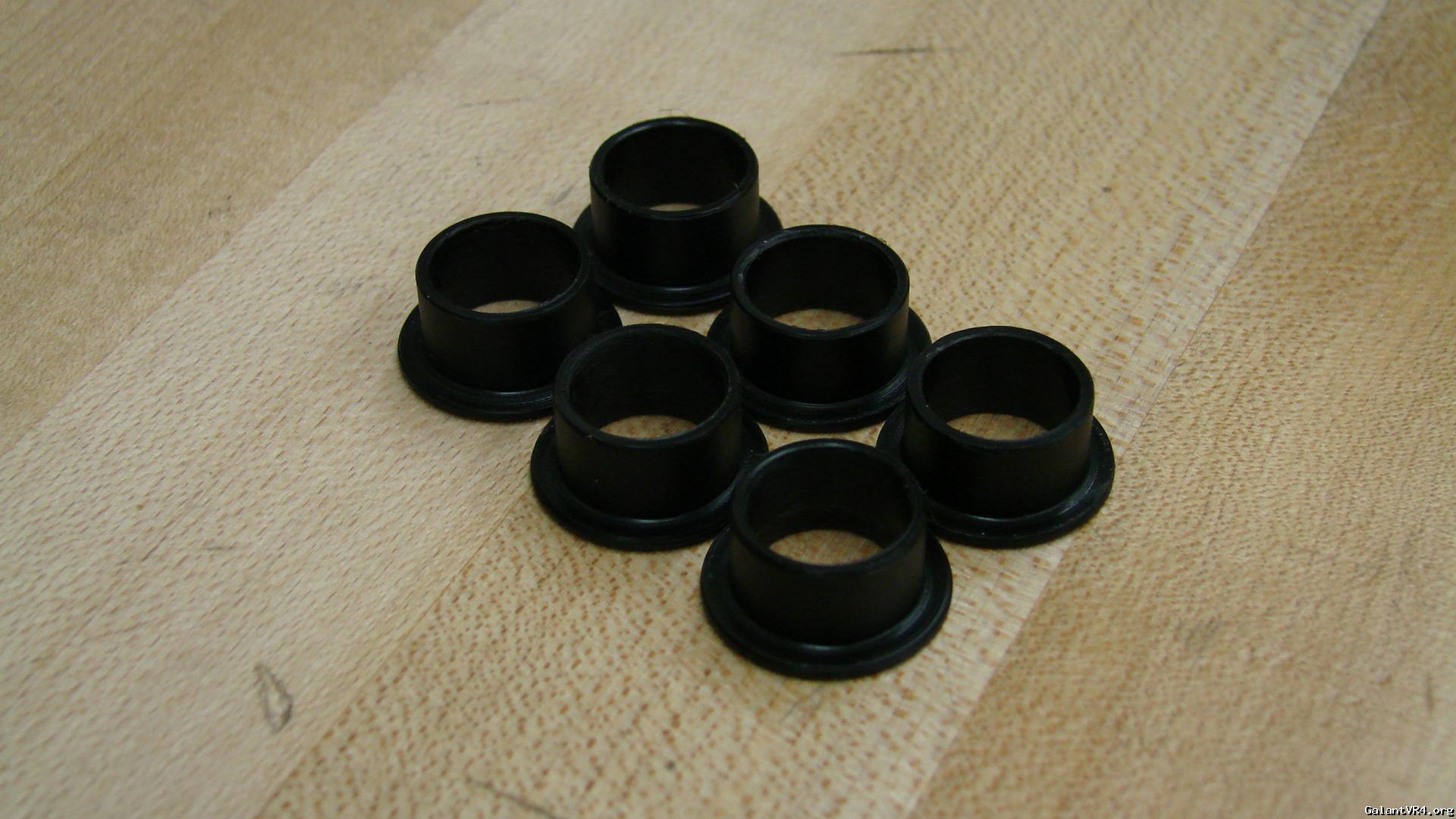

I'm personally just going to machining some new ones out of delrin later this week. Might be willing to make some extras if there is interest.
Its raining so I'll probably be making up a set this weekend. I'll post some pics when there done. Both looking for full sets?

Got them finished and installed today. Wanted to make sure they fit before I posted any pics. Made them from some spare delrin. Has 0 play, yet no bind after some minor sanding on the face to get the lengths right. What do you think?

Sets 2, 6, and 11 in the picture. Sets 2 and 11 are the same, and set 6 has a bigger bore.
