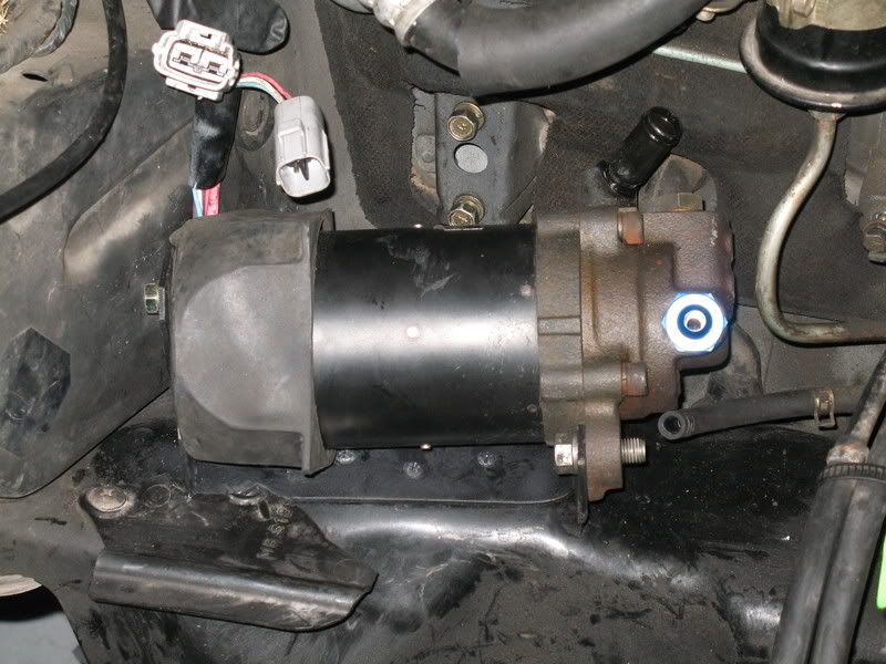

Has anyone ever tried adapting an electrical power steering pump to their Galant? I pulled my engine today and realized how much it could clean up the engine bay. I have an electrical PSP from a 2g MR2 that I picked up at the junkyard a while ago that I thought I could adapt to one of my projects. These are commonly adapted by people running in Honda Challenge. It seems like it would fit nicely where the emissions canister sits. While the engine is out I'm going to be swapping in a DSM steering rack to eliminate the 4WS lines up front and thought it might be a good time to try experimenting with an electric pump. There isn't really any performance benefit other than constant pump pressure. The main benefit I see is eliminating the stock pump and cleaning up that corner of the engine bay. There would be plenty of room near the windshield washer reservoir for a power steering fluid reservoir.
Here is what the pump looks like:

Yeah, I bought it for around $10-15 and another $5 for the rest of the system that I probably won't use. I'll dig it out and see if the motor can be seperated from the pump and take some better pictures of mine. In case you haven't found your answer, these came off the 91-95 MR2.

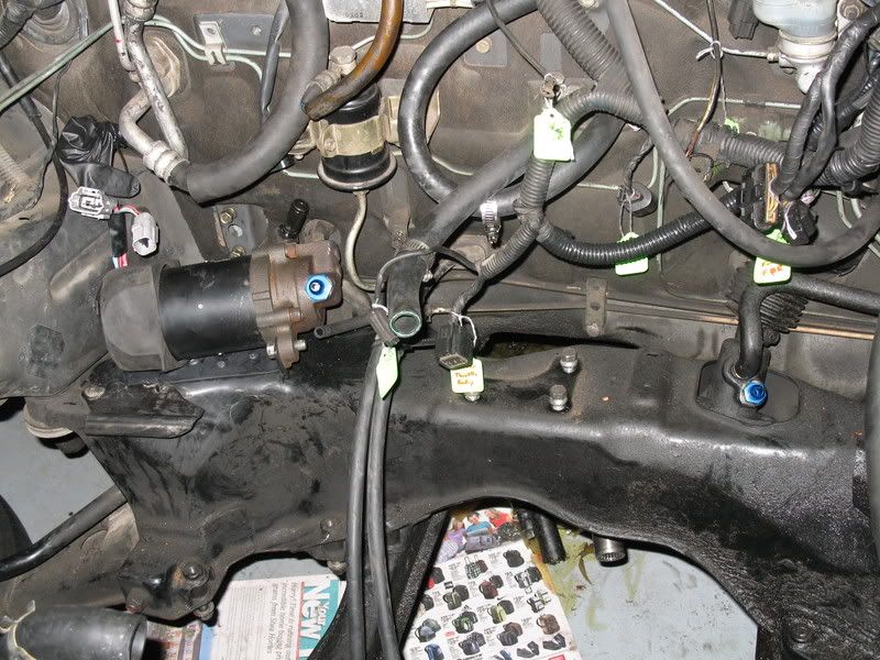

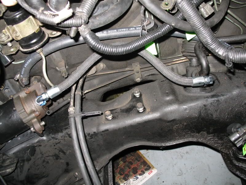

Well I finally got around to setting this all up. I pieced together a whole aftermarket setup with lines, fittings, and a reservoir but in the end I decided to utilize as much of the stock setup as possible. I'm only using my own, pump, pressure side line, and pump feed from the stock reservoir. All AWS lines were removed and the rack provisions were blocked off. I'll know in the next 2 weeks or so whether or not everything clears ok with the engine in the car. I'm not too worried though sine it occupies the same space as the charcoal canister and the AWS lines which are both gone now. In the current position, I need to move the fuel filter up about half an inch which is not a problem, even with the stock lines. The only real issue at this point is how the pump will function on its side. I have seen it mounted this way but MOST of the mounts I have seen keep it vertical like the MR2s.

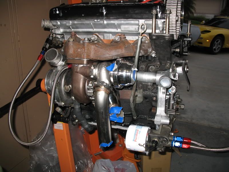

Teaser pic:
2.4L, BC280s, BC valvetrain, mild port work, FP3052, etc.
Don't expect any roadtest feedback for about a month. I still have to get the engine back in the car, qutie a bit of electrical/interior work, and swapping out the rear for a 4 bolt. Depending on time I might install the Hotbits too.

Awesome motor + FD in the background makes me jealous!!
/ubbthreads/images/graemlins/applause.gif
Is that gonna be the location for the oil feed line for the turbo? Why not get it straight from the filter housing, your braided SS seems long enough. That's what RRE Recommends. Not hating, just wondering. Looks like a sweet setup.
