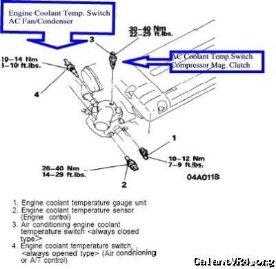

Yeah - the lower part that bolts onto the head. I've got one out in the garage which doesn't have the extra port on the back, but I'm not sure where it came from.

My understanding is that the GVR4 lower housing has one extra AC sensor which faces the firewall. Pic here, #4 in the drawing:

Okay cool. I hope Mitsu still sells them. JB weld isn't holding and I'm not sure exactly where the crack even is.
