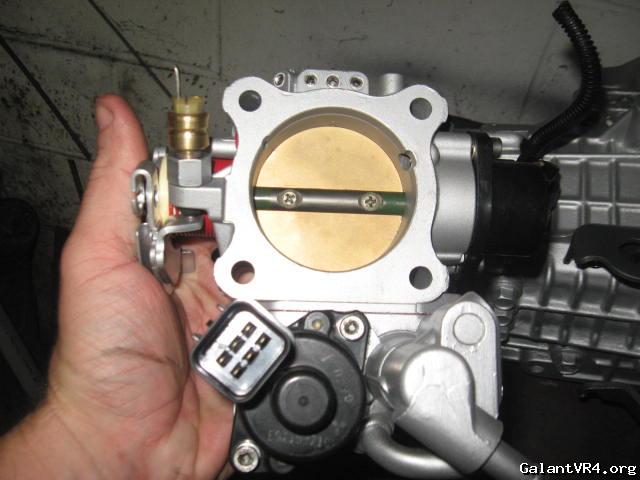

I know this isn't what you're asking. But it's a lot cleaner to remove those barbs altogether and tap the holes and then install a SS set screw.
tektic
Dec 19, 2012
1,497
ronkonkoma, ny
Yeah. It is... but I'm not planning on taking the tb off to do so. Maybe next time around. Ill just measure when I get home.
pot
Oct 28, 2003
1,577
Fayetteville, NC
If memory serves me its one of two sizes:
5/32" (4mm) or 7/32 (5.5mm)
However, I've been meaning to perform the same mod Chris (89Mirageman). Man, it looks good!
strokin4dr
Aug 30, 2005
2,770
Savannah, GA
I've done the same thing on both my cars. Much cleaner and I don't have to worry about caps cracking and leaking
