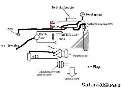

alright.
this is how i got mine set up..
meaning all you need is what is there.
all other can be removed!
NOTE: make sure all fittings and hoses DO NOT LEAK!!!!!!!!!!!! read that again!
after you are done do a boost leak test.. zip tie all the lines where they connect to be safe.
make or buy a MBC so you can remove the stock BCS

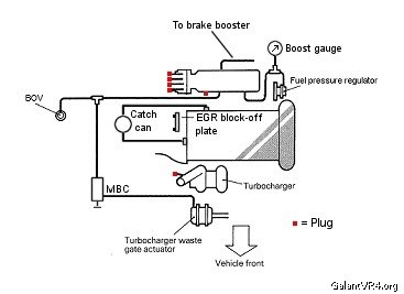

I would amend that diagram by suggesting that you not tee the WG vac. line into the BOV vac. line as it may cause BOV surging. Not all people/cars have this issue, but I did, and after giving each their own dedicated vacuum line it went away.

agree.. i ran a line from the WG to a line on my IC pipe.. and had a strait line on the BOV

I run the fuel pressure reglulator off of the closest fitting on the manifold. I run the BOV off of the normal (big) fitting. My boost gauge comes off of the P-port and my MBC/wg run off of the turbo outlet pipe port. CCV and PCV are in their stock configuration for me.
Just to list the items that can be eliminated. My EGR is gone as I have a JDM Cyclone manifold but I believe you can just unplug it on the USDM and it'll stay closed. Charcoal cannister is gone. Fuel pressure solenoid is bypassed.

FPR should always be alone, less to leak on the line and cause bad things to happen.
Personally i like to separate it all out, and it seems to work quite well.
