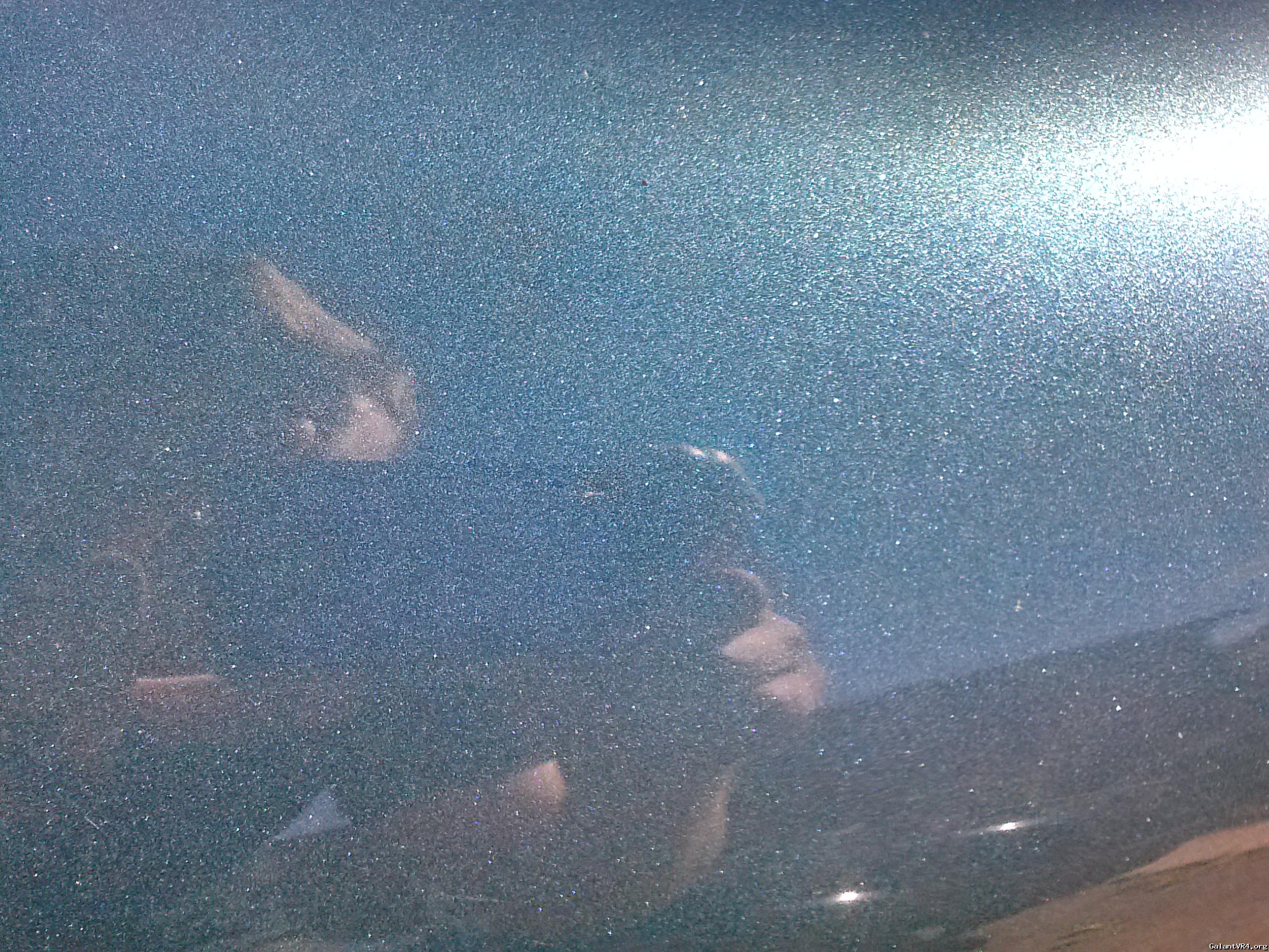

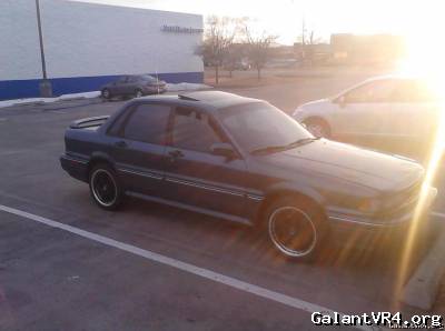

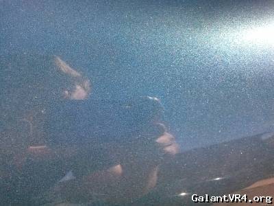

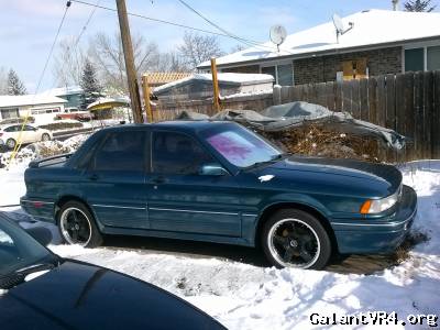

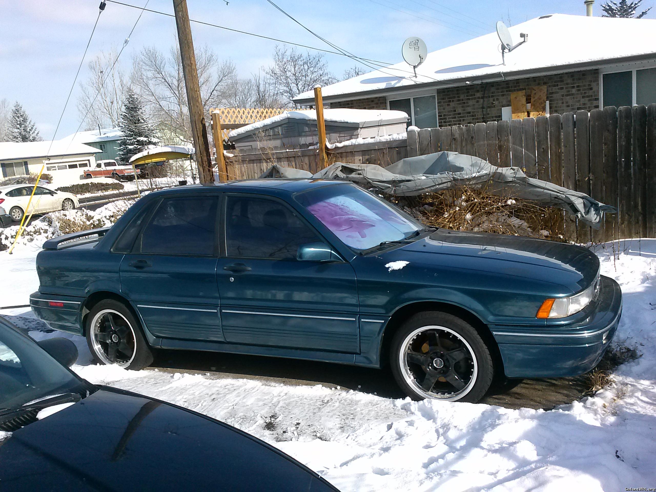

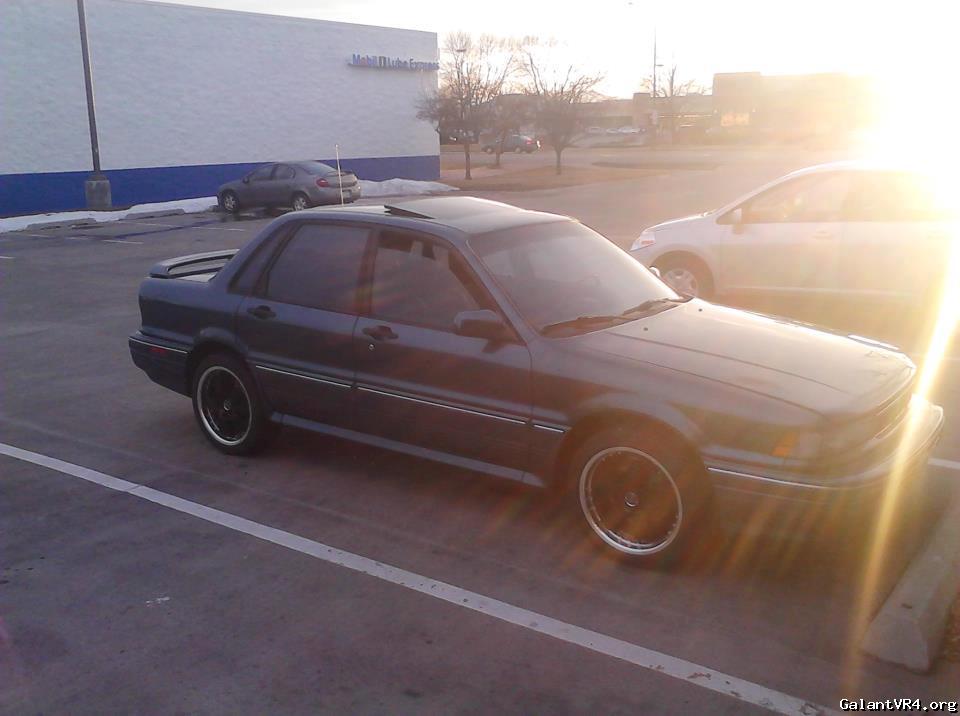

No problem, dig your car BTW. If I ever get another one, I want a green one. One of my sisters lives in Colorado haha.

Thanks its two coats of the factory green and one of ocean blue peral so it changes and thats cool colorado is a good spot.
