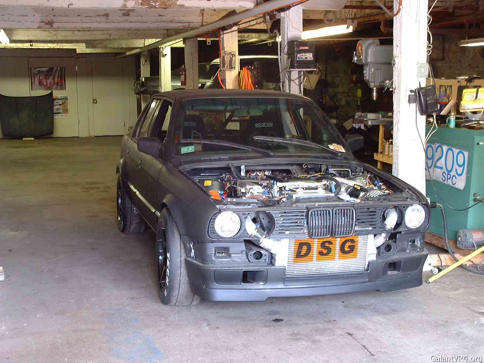

Cy, the car is running. (phew) it took a hell of a lot of work but I learned a Shi%load this week about this motor. It's so damn sensitive to any minor fuel changes compared to the 4G63. It won't start with the 850cc injectors, period. I have to shut the pump off and crank it with residual fuel in the cylinders, then fire the pump once the car is running. Needless to say the ECU is being sent out this week and I'm going to miss another event. The body harness is done. I can loom it now that the car is working.
I had to back the AFC low throttle settings out 50% across the board and back the FPR out to about 28lbs to get it to start.
It backfires and shoots blue flames every now and then which makes me quite randy.

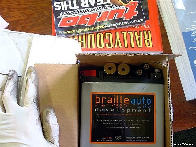

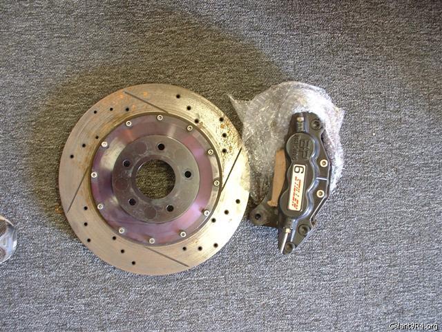

Anyway.. enough of that. I'll have some more to say about that later. Here are some more Galant parts. Talk to Paul on these.. they just show up at the shop and we can only guess who they're for.
One more just to show that I have no life and I'm at the shop 13-14 hours a day trying to get this POS on the track.
