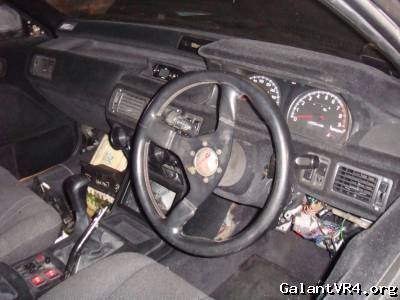

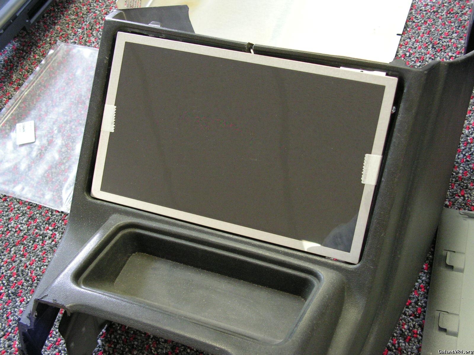

Well the car runs, thanks to Brian's information regarding the 'bum' timing mark on the fluidampr pulley. A few other setbacks caused some rethinking. The Koyo rad won't fit with the big turbo, so I had to have something custom done. Working with Iceman on a plug n play harness for the M&W CDI box and COP.

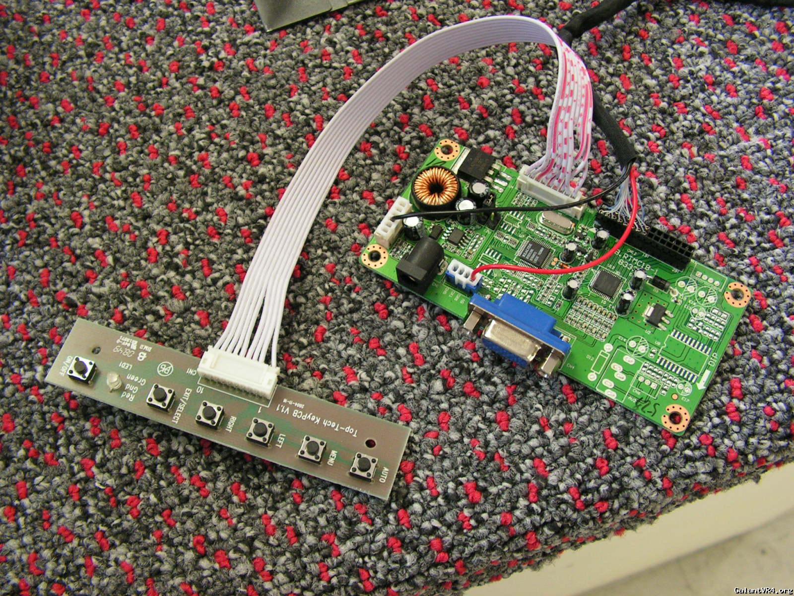

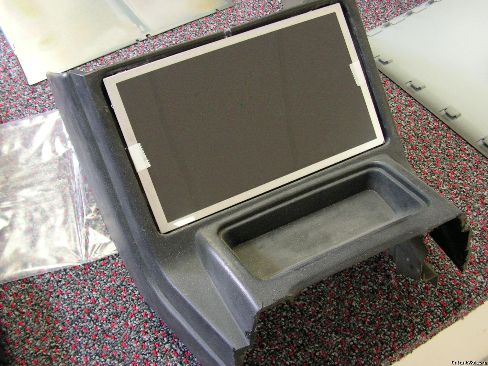

But this little project has got me excited. I have been looking for a touchscreen monitor for the onboard PC and DSMLink software because I didn't like the 7 inch screens. After long research and numerous failed attempts to find something that fit finally I have found this: -
The plan is to build a custom flat black aluminium bezel for the screen so it fills that aperture perfectly, which it almost does already. The controller board will be secured to the back of the screen and the button panel installed under a custom plate in the coin tray right below the screen. Done properly it should be very clean, hopefully not ricey and just functional. Big 8.9" transreflective display (visible/readable in direct sunlight) with a touchscreen. This will allow DSMLink or ECMLink to be hardwired and additionally it will allow the PC to become a media player for music/videos as well as allowing mobile internet connection and satnav via Google earth.
I know some people don't wholly agree with the in-car PC but to me it is a far more functional setup for tuning than a lap top on the passenger seat and the other functionality is just taking advantage of what is available rather than having to mount a CD player in the glovebox, satnav on the windshield and post to galantvr4.org from a cellphone.
BTW the console is just a hacked mock up I sent the company for fitment.

Is that location going to make it hard to use the touch screen? The gear stick might be in the way for some of the lower half
cheekychimp
Apr 19, 2004
7,333
East Sussex, U.K.
I guess if you were in first, third or fifth your hand might obstruct the screen a bit, but conversely in those positions your hand is going to be conveniently located to touch the touchscreen. In all honesty though I think trying to do stuff on the computer whilst driving would be bloody dangerous. I actually have a Griffin Powermate which I want to install for stuff like scrolling through playlists because I think that will make it as safe for playing music as any MP3 type player in that location.
Generally though there is a fair bit of distance between the shifter and the screen, more so with a shorter shifter.

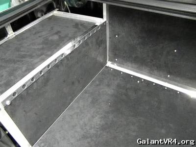

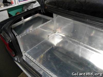

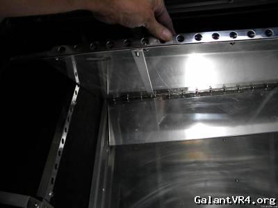

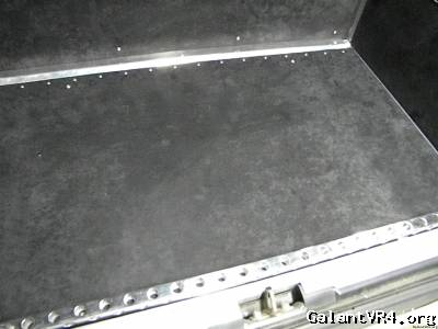

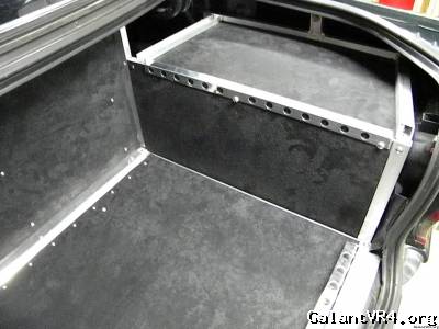

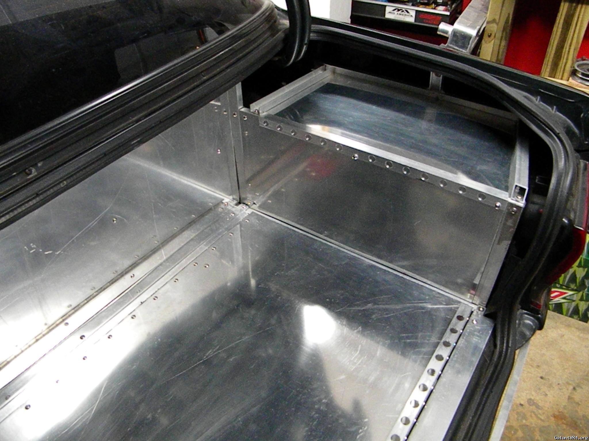

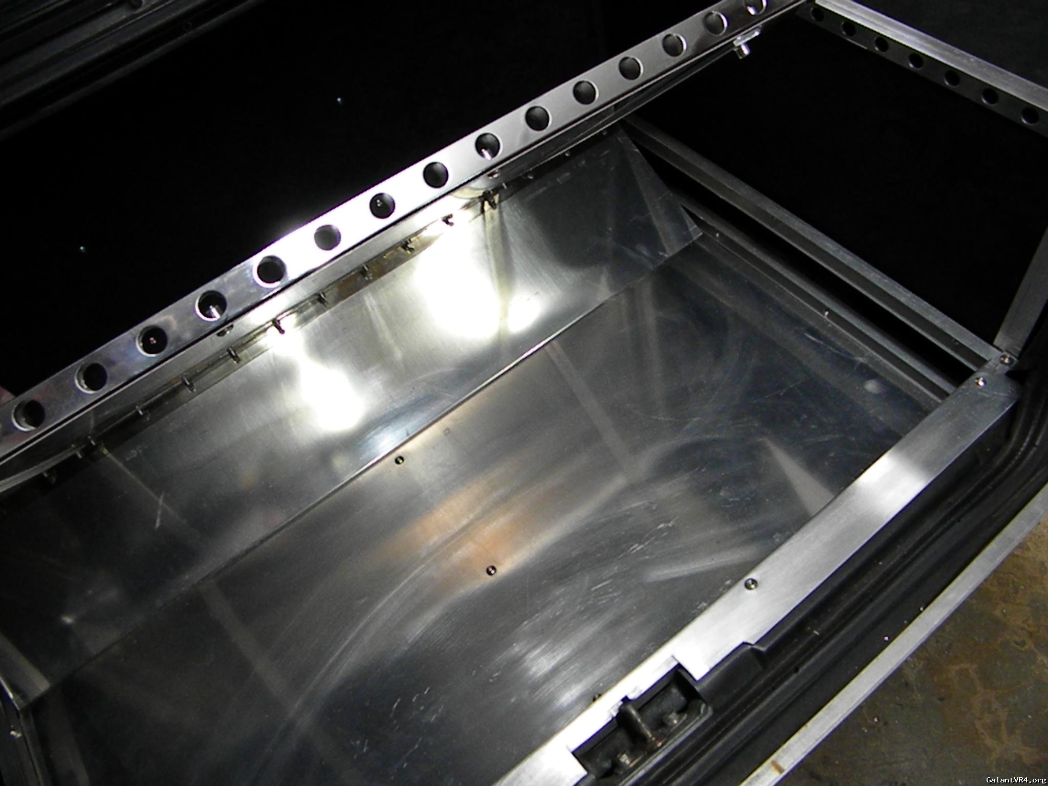

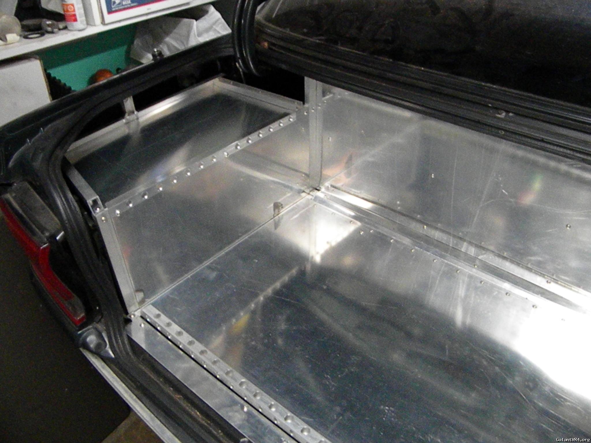

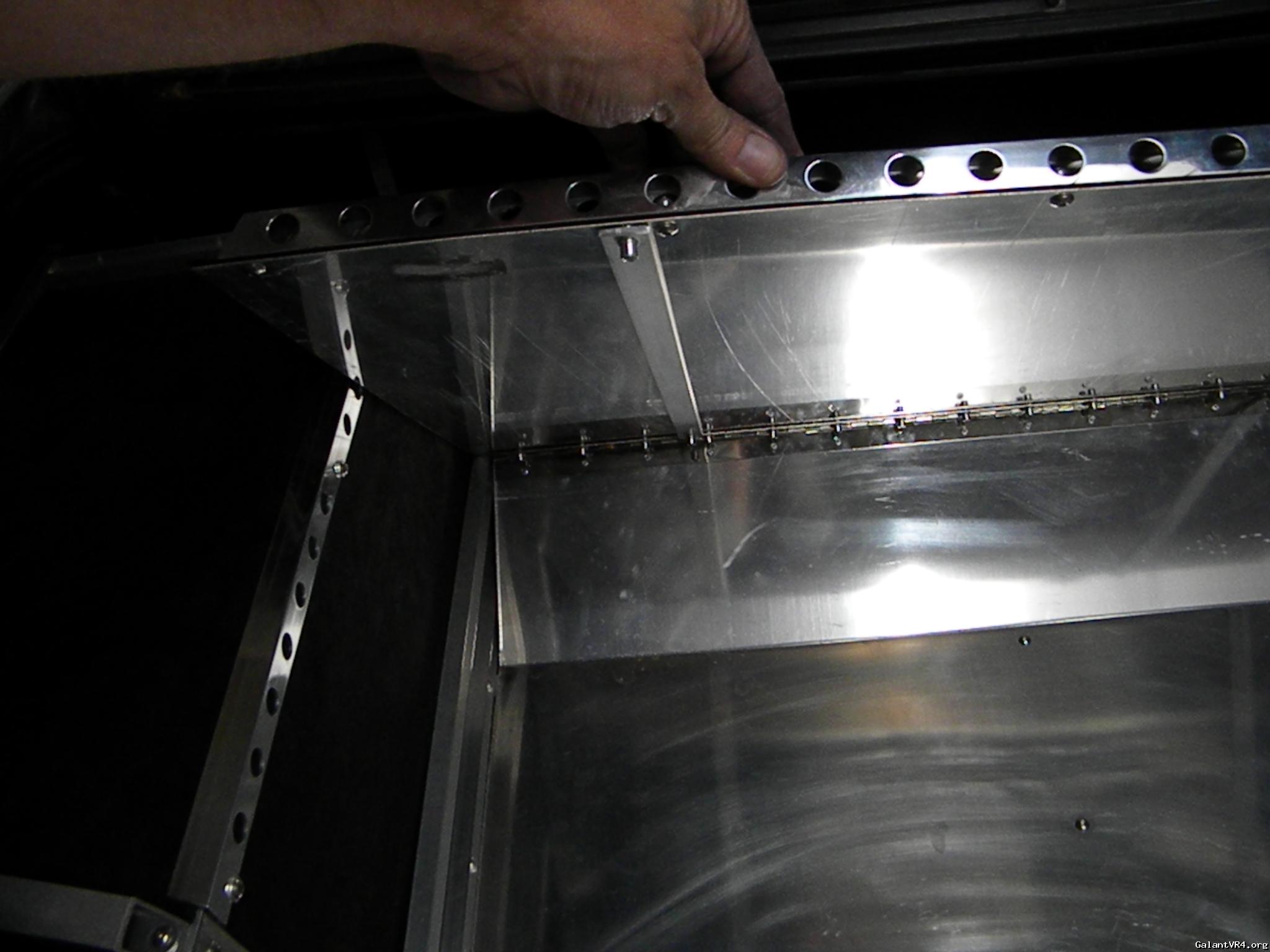

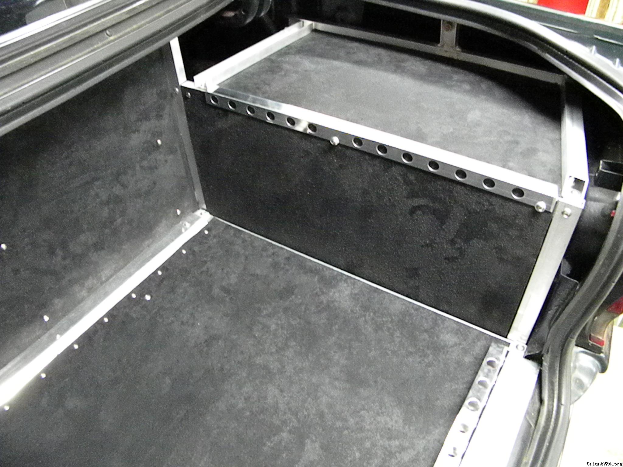

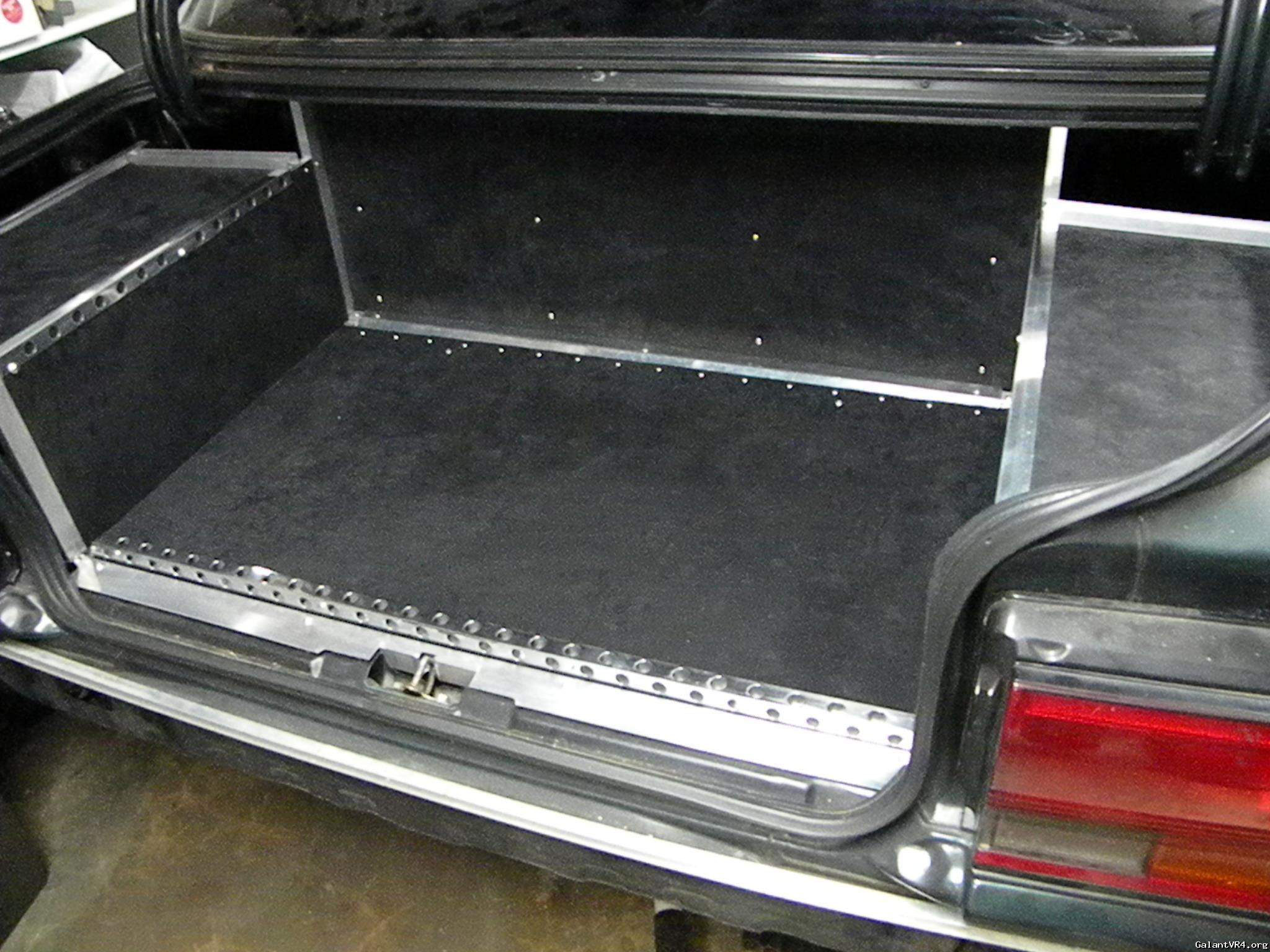

Crate has been moved out of the shop area and next to the door. That wasn't an easy task. Everything in the shop including the car had to go out then back in in pieces. Had a couple people slow down like i was getting ready for a yard sale. Stuff in the crate has been reboxed/inventoried/and banded up. Other stuff has been built and and down to the small stuff now.
Finished the trunk panel assembly today and need to find a box large enough for the bottom section and and the smaller panels. Its my own built aluminum erector set its all assembled with rivnuts and stainless button head machine screws. Paul has a bunch of fancy toys that will go under this in the spare tire hole and the side pieces are for the battery and the other side is for the meth tank. Still have a little work left to do but didn't want to pull it all the way down and have to reassemble everything from the ground up again.
Paul I left the task of putting on grey 3M double sided tape for your final install after you see where all the toys will mount. And also didn't drill the 4 holes on the back edge where the phillips sheetmetal screws lock the factory plastic pieces down was afraid they wouldn't line up in your car.

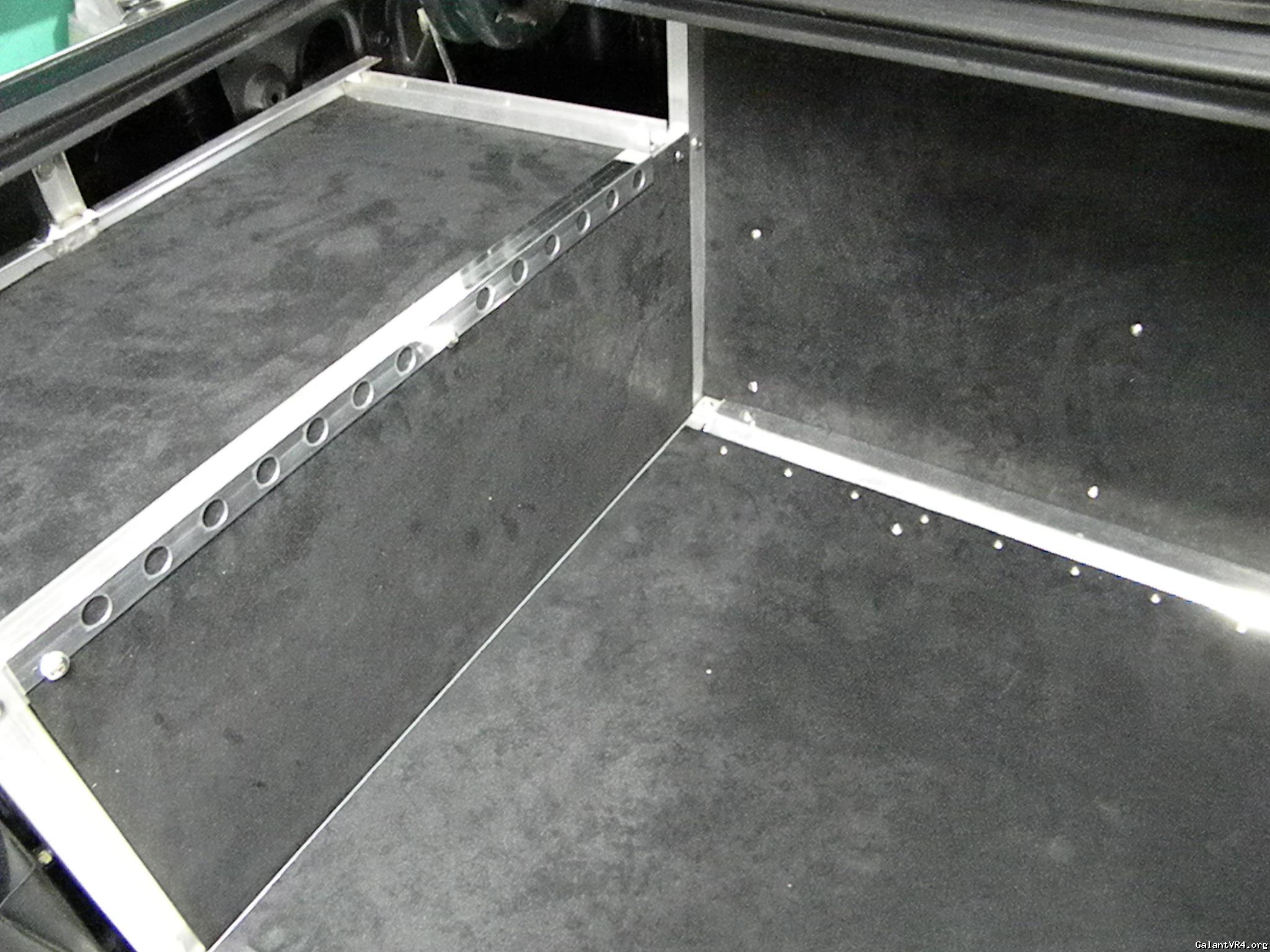

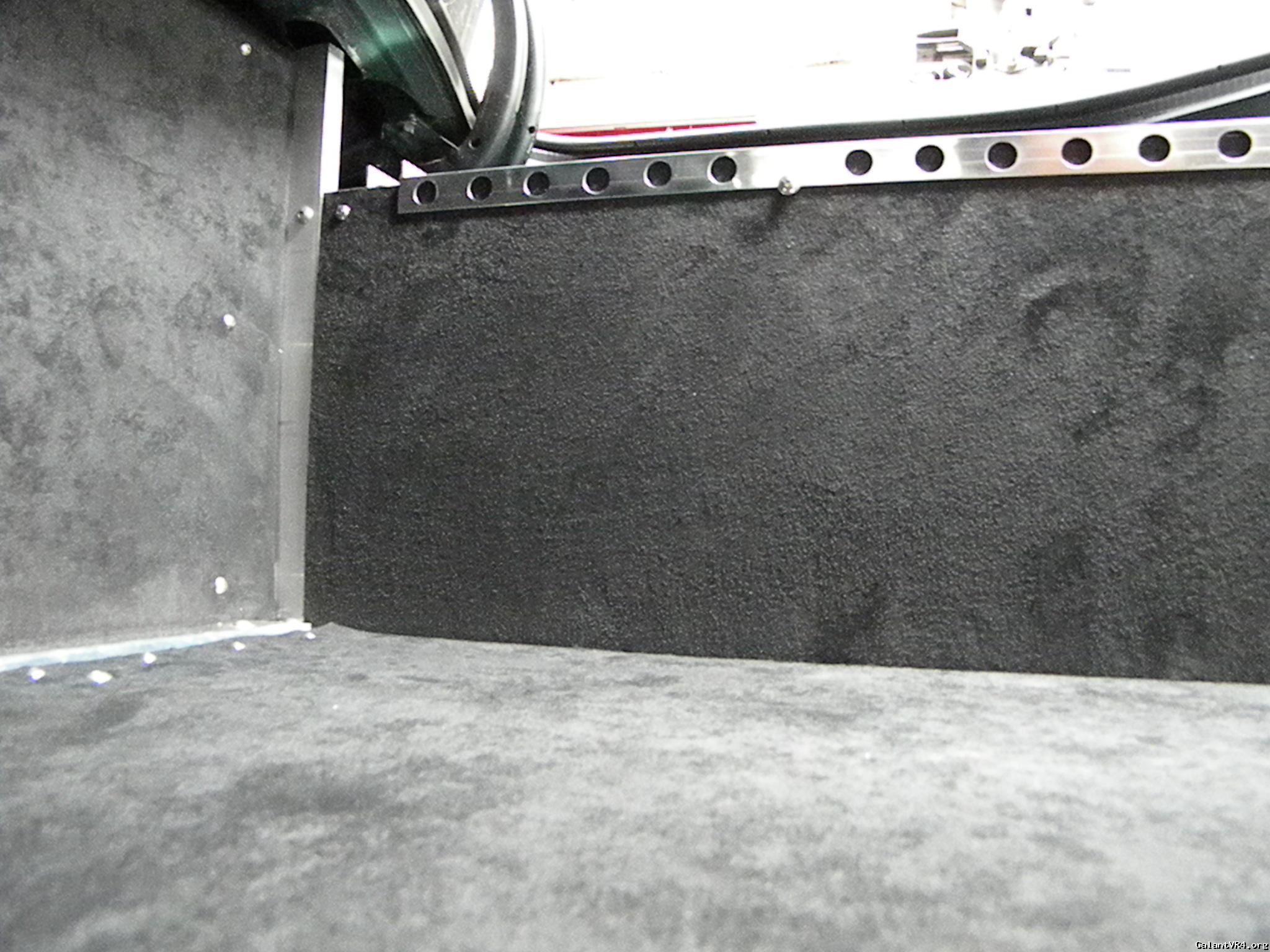

Oh and if you want the storage hole wrapped in suede send me a PM, I know you have a package tray and other stuff in the interior around the rear seats that needs to be addressed and didn't want you to run out. I can take it in the living room and unroll it and see what we have left if your wondering. Just yell back before I get it disassembled and boxed up.

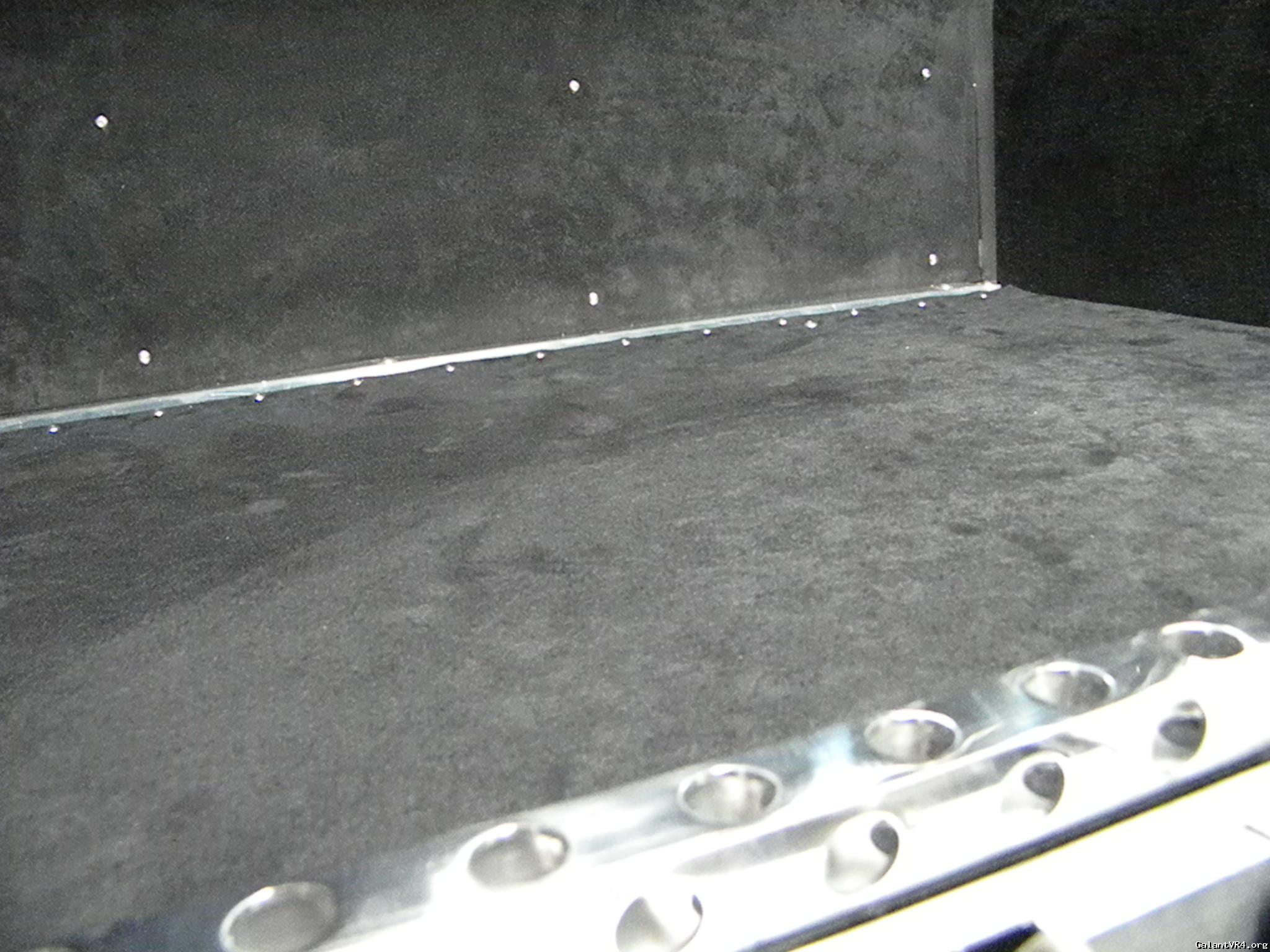

Raw metal
Wrapped in suede
cheekychimp
Apr 19, 2004
7,333
East Sussex, U.K.

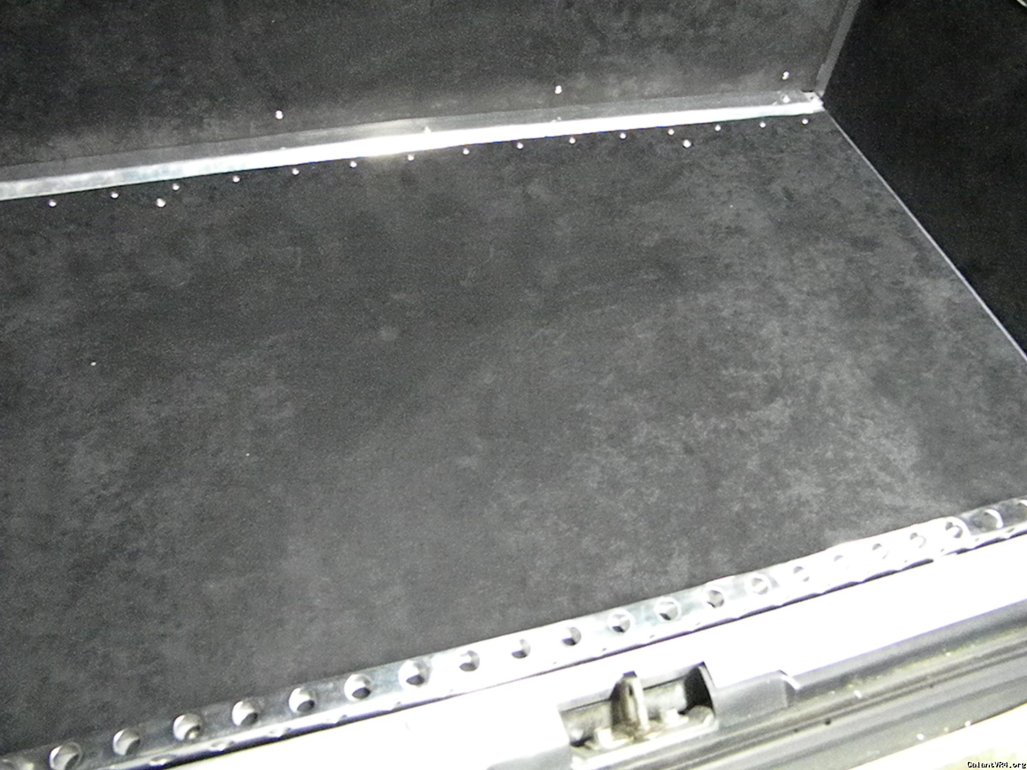

About bloody time you got your finger out /ubbthreads/images/graemlins/rofl.gif
That looks really, really nice. I PM'd you to say I think I'll keep the storage area bare metal. I know stuff might slide around a bit in there and get a bit noisy but I'd like to keep that space to chuck anything I don't want to mess up the nice part of the trunk. You know, tools, wet umbrellas, dirty shoes, flip flops from the beach, frozen stuff from the supermarket etc etc etc
I think those metal edges need to be black /ubbthreads/images/graemlins/grin.gif You just couldn't resist the aviation/rallyesque stainless drilled metal could you? /ubbthreads/images/graemlins/rofl.gif
I like the safety and security aspects of this as well. I know it isn't and wouldn't qualify as a firewall but having the battery and meth tank isolated and that large metal sheet between the trunk and the rear seats is till awesome and whilst getting into the speaker/amplifier area will be a pain if anything breaks later on at least no-one can just undo four screws yank the RCAs and walk off with a $1000 amp now.
