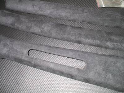

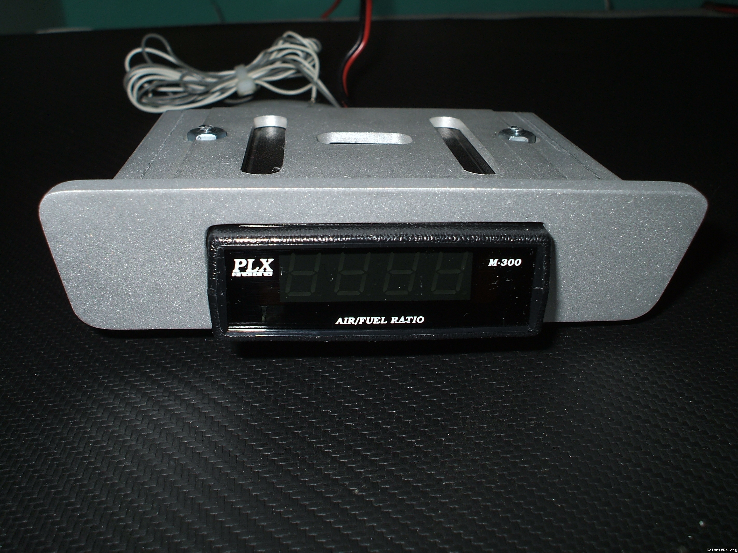

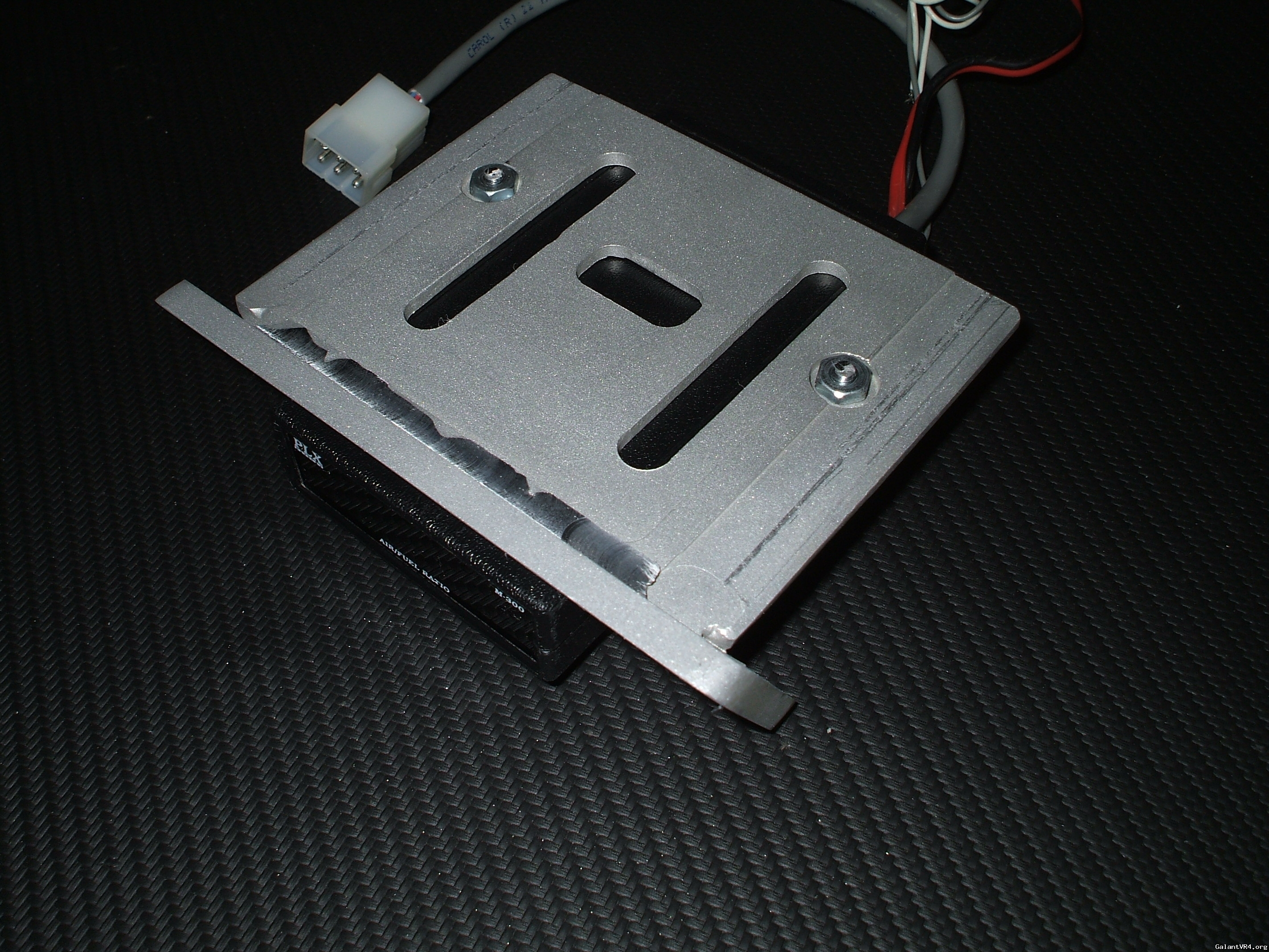

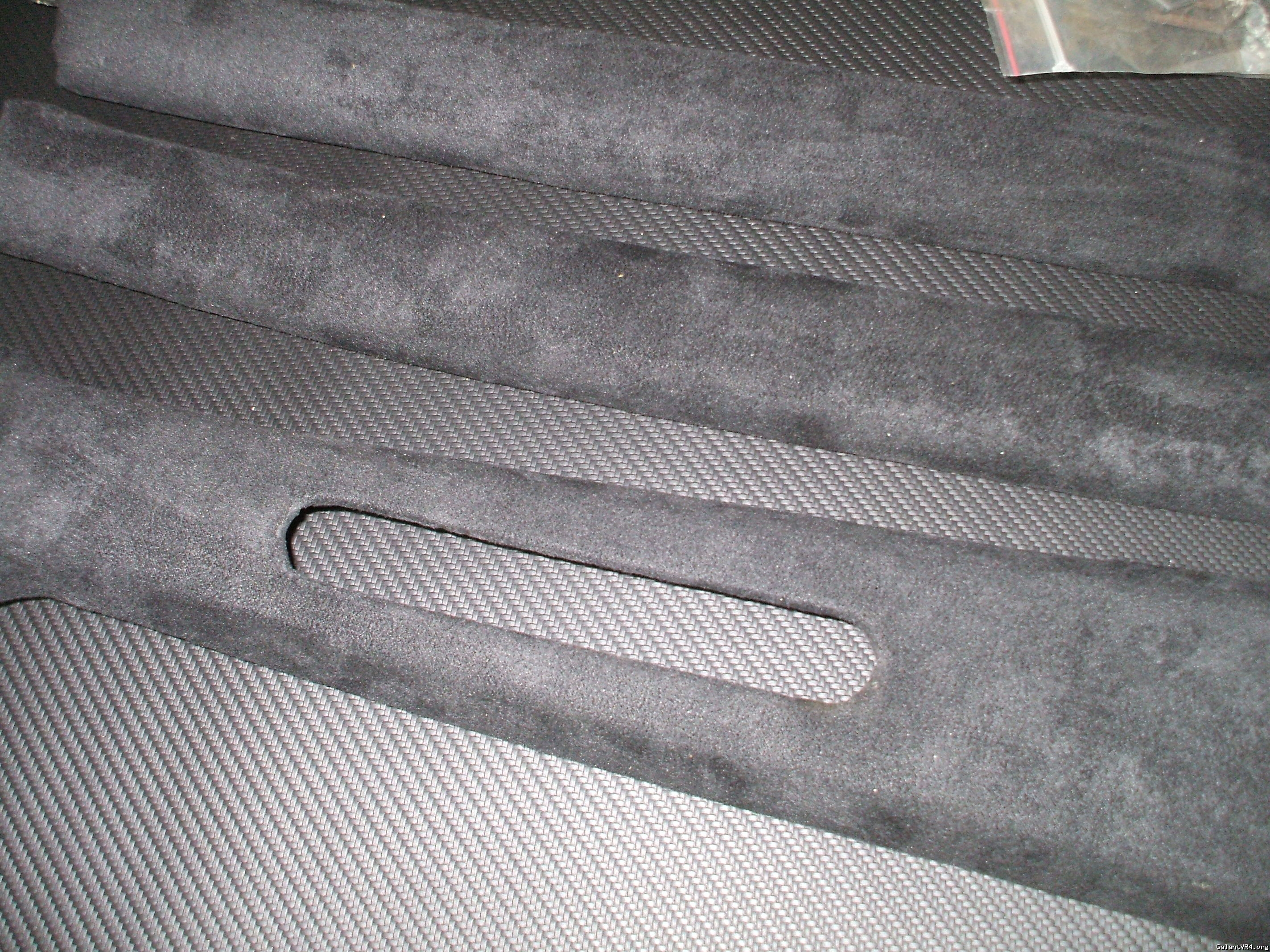

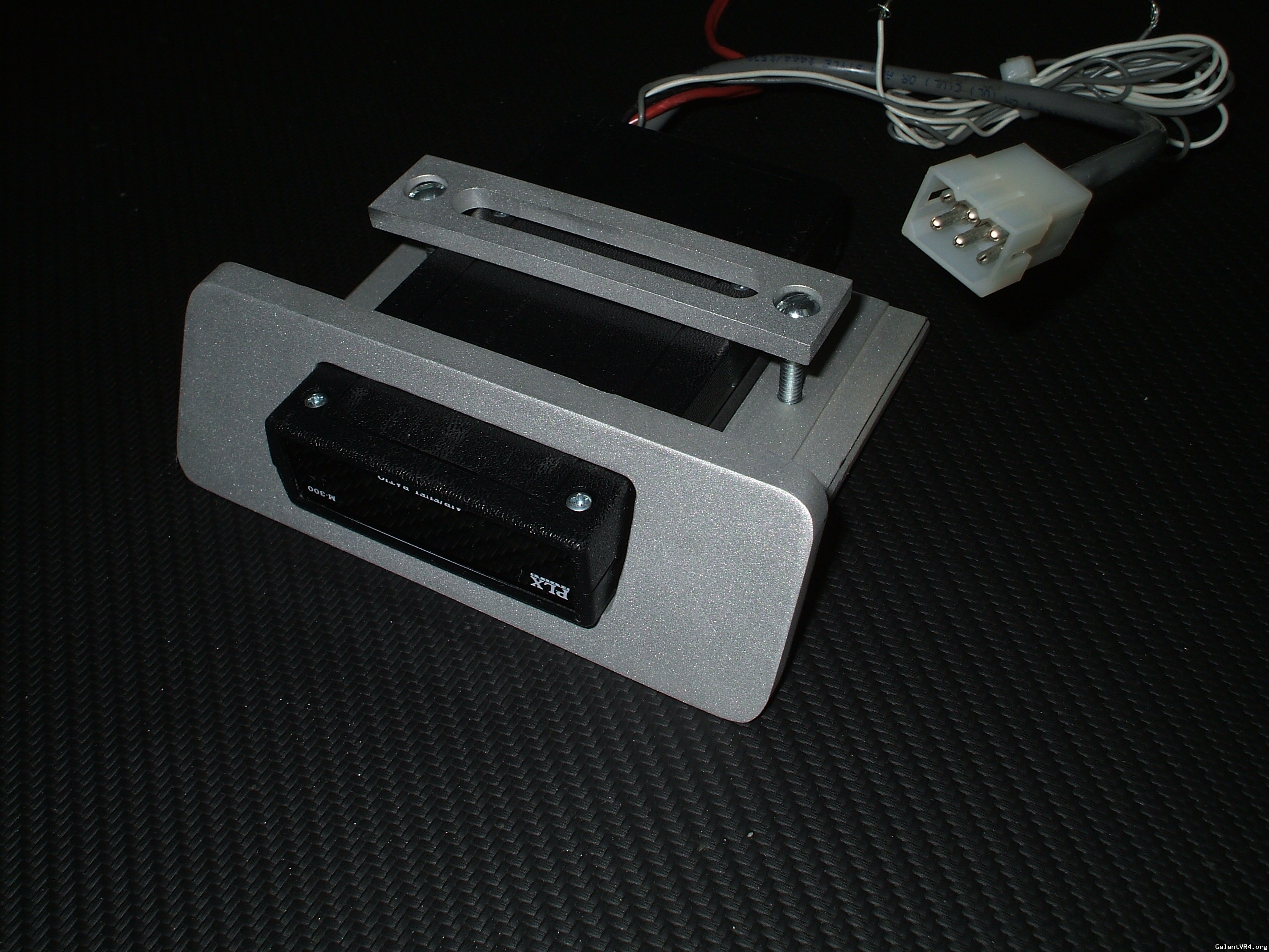

Well finished a few more things for Paul for the last big shipment
B pillars and the extra wide top rails are now in suede, C's will be next week the areas around the windows are to deep and the material wants to bunch up.
Paul brought over a ashtray to cut the center out in for his plx air fuel ratio gauge, crap bakelite plastics cracks and explodes the first sign of chatter from the mill so after 4 or 5 attempts .....I made a billet ashtray insert. /ubbthreads/images/graemlins/grin.gif
still needs a little more work but everything fits nicely.
