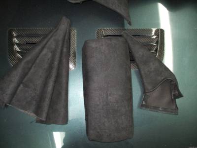

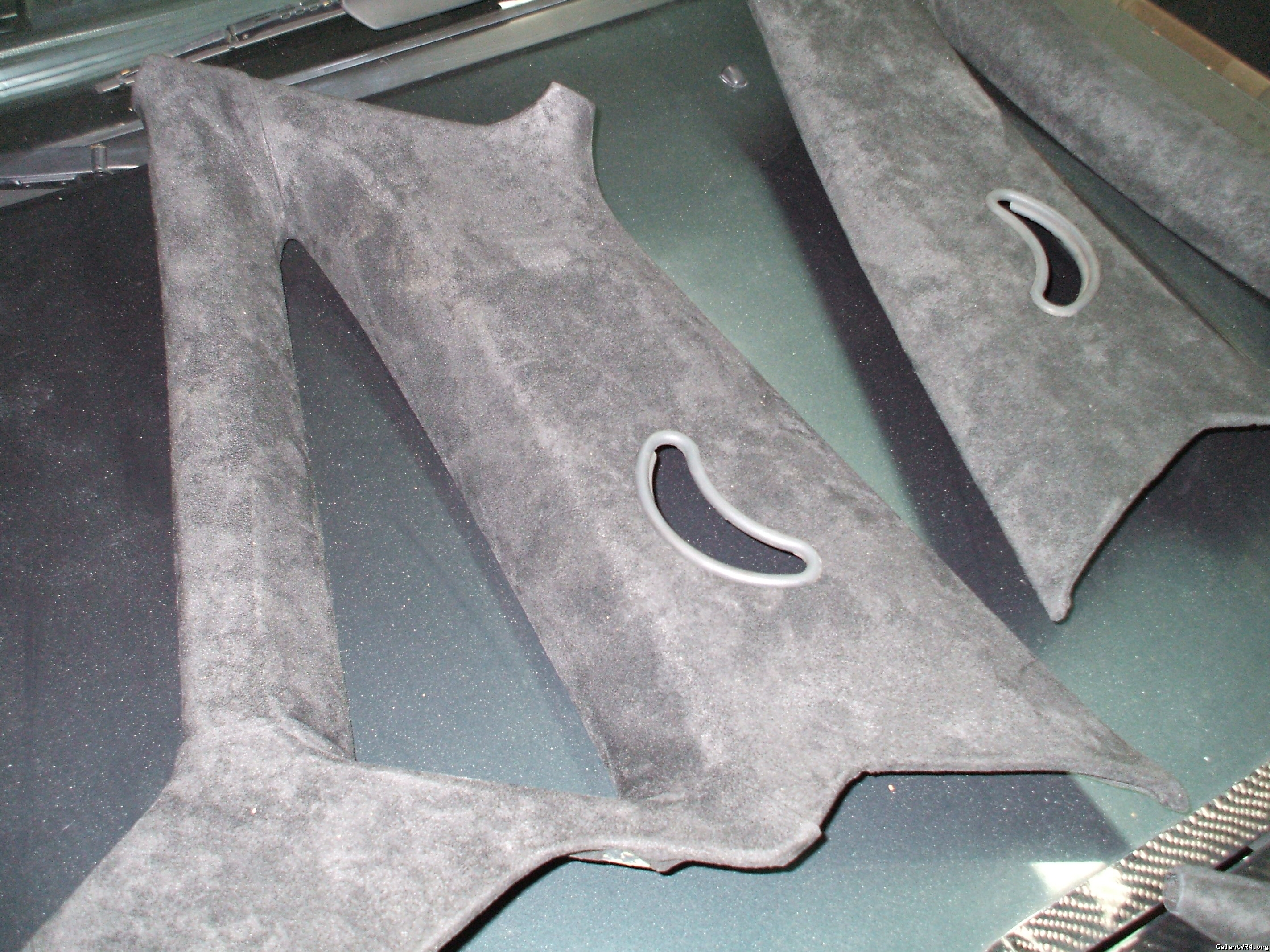

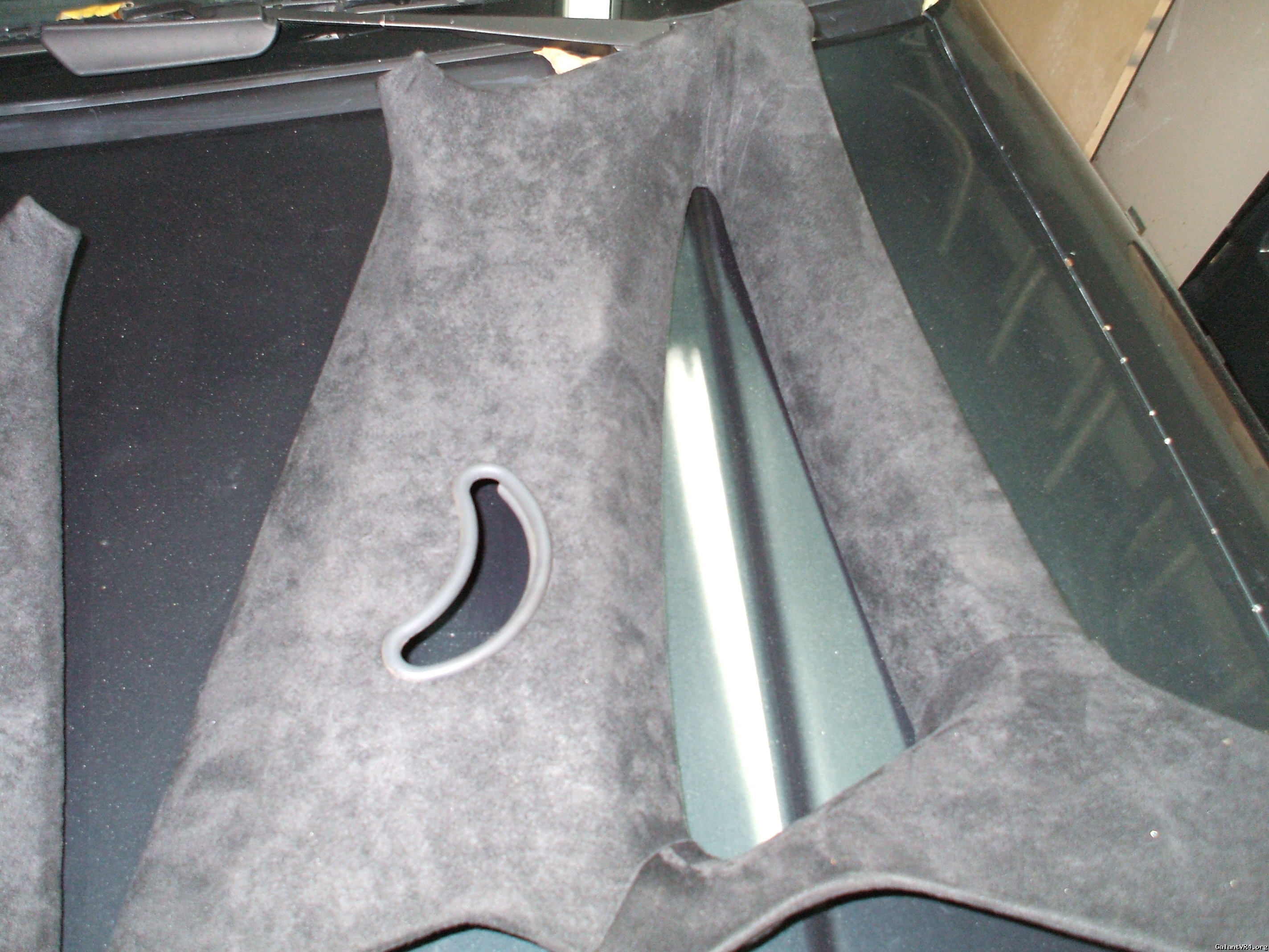

C pillars, Paul my buddy told me this is the last set he'll ever think about doing. There each 3 pieces of cloth and had to be fitted and formed, took him a few hours on each.

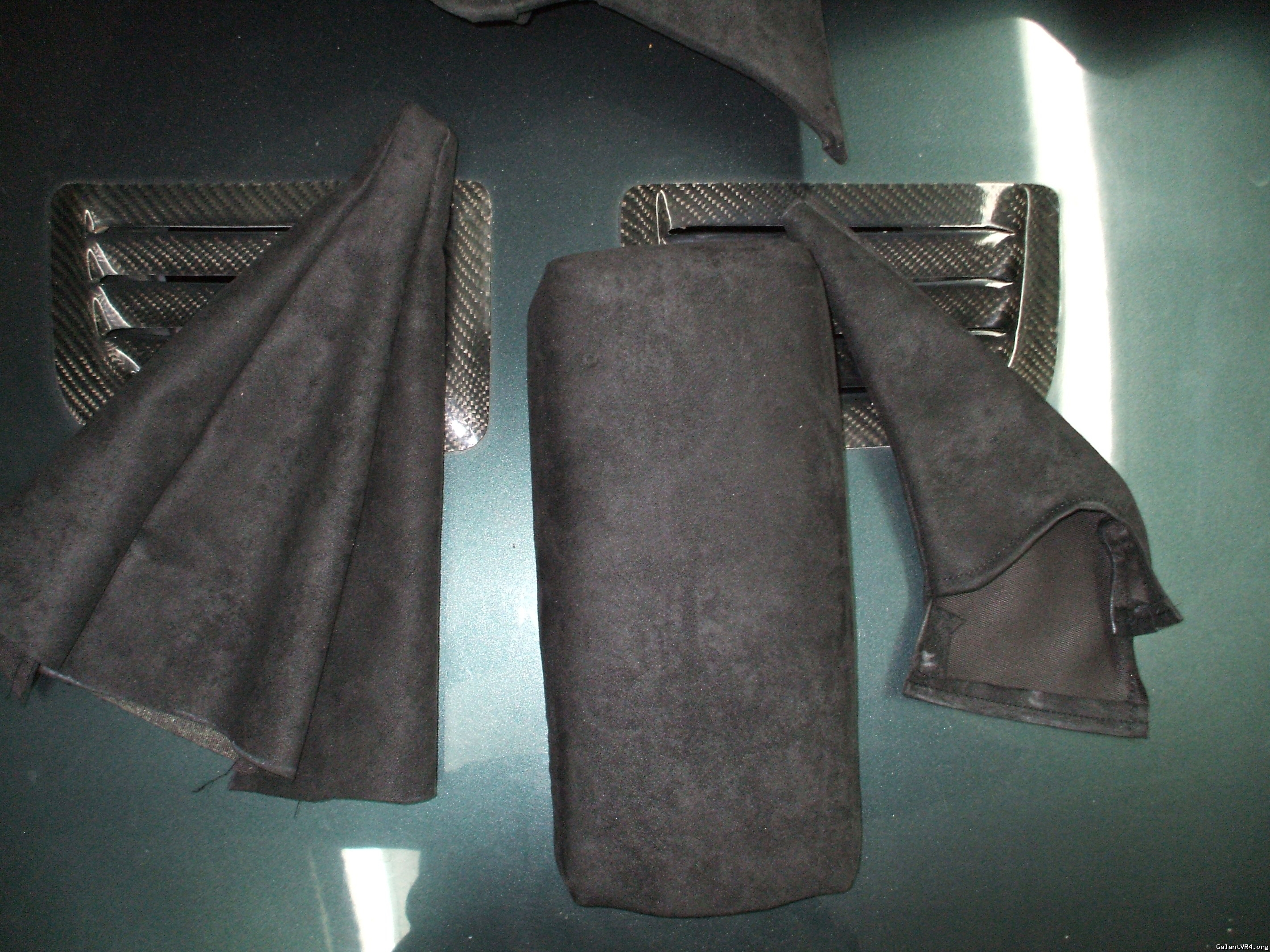

Center console , shift boot and e brake handle all in suede. Yes its a mirror image so it will work on the right hand drive e brake handle

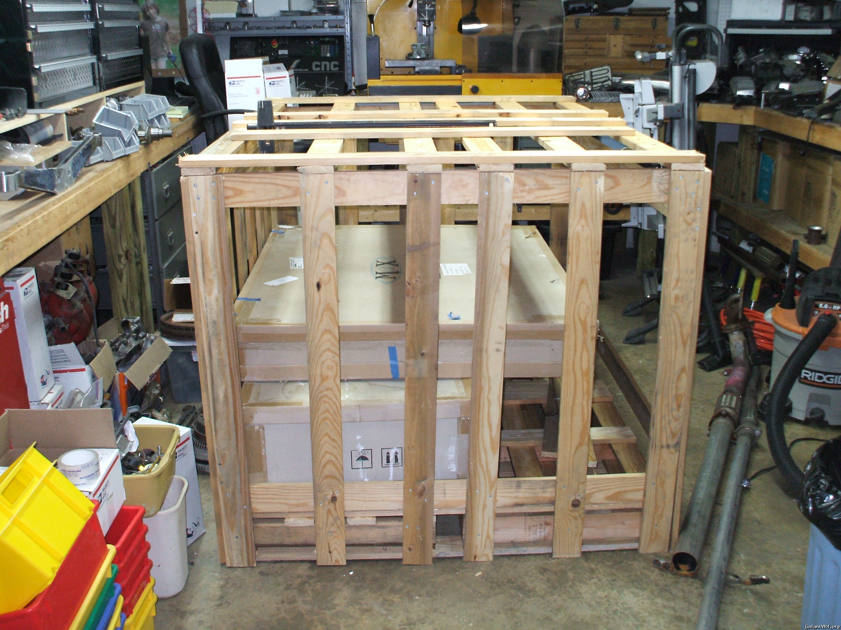

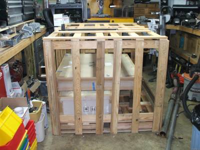

Then there's this hunk of sh*t, two days in the building, I'll have to drag it outside with the mower after its filled. Its like 4.5 x 6 x 4 high. Yes there's about that much here folks, rear bumper will fit on the bottom by the large box then the front push bar and inter support will go on top. You know I can't figure out were all this stuff will fit on the car....I sent 3 pallets then there's the stuff from Alex and Aaron.
I use to have a shop end of my garage. /ubbthreads/images/graemlins/grin.gif

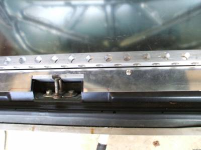

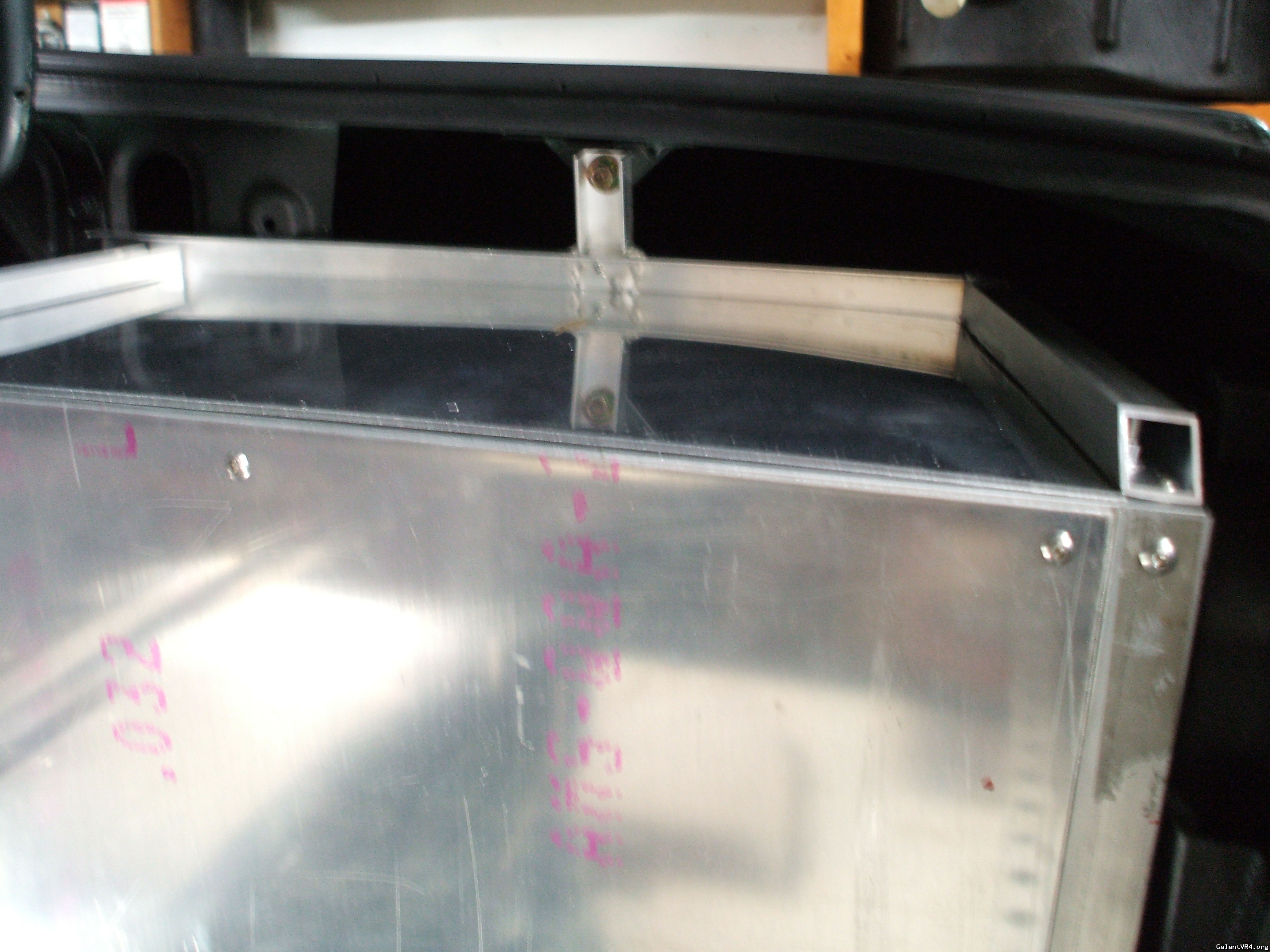

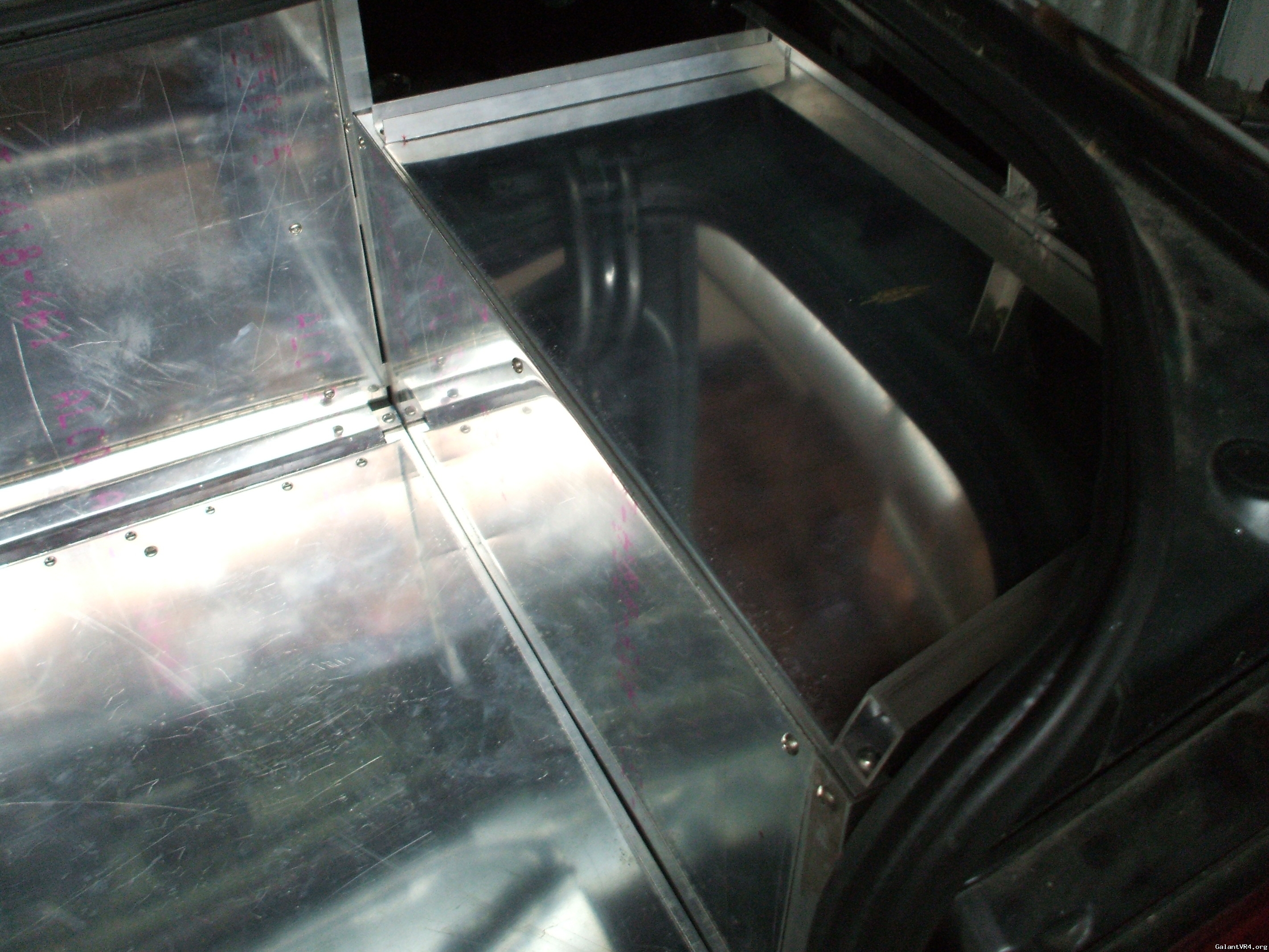

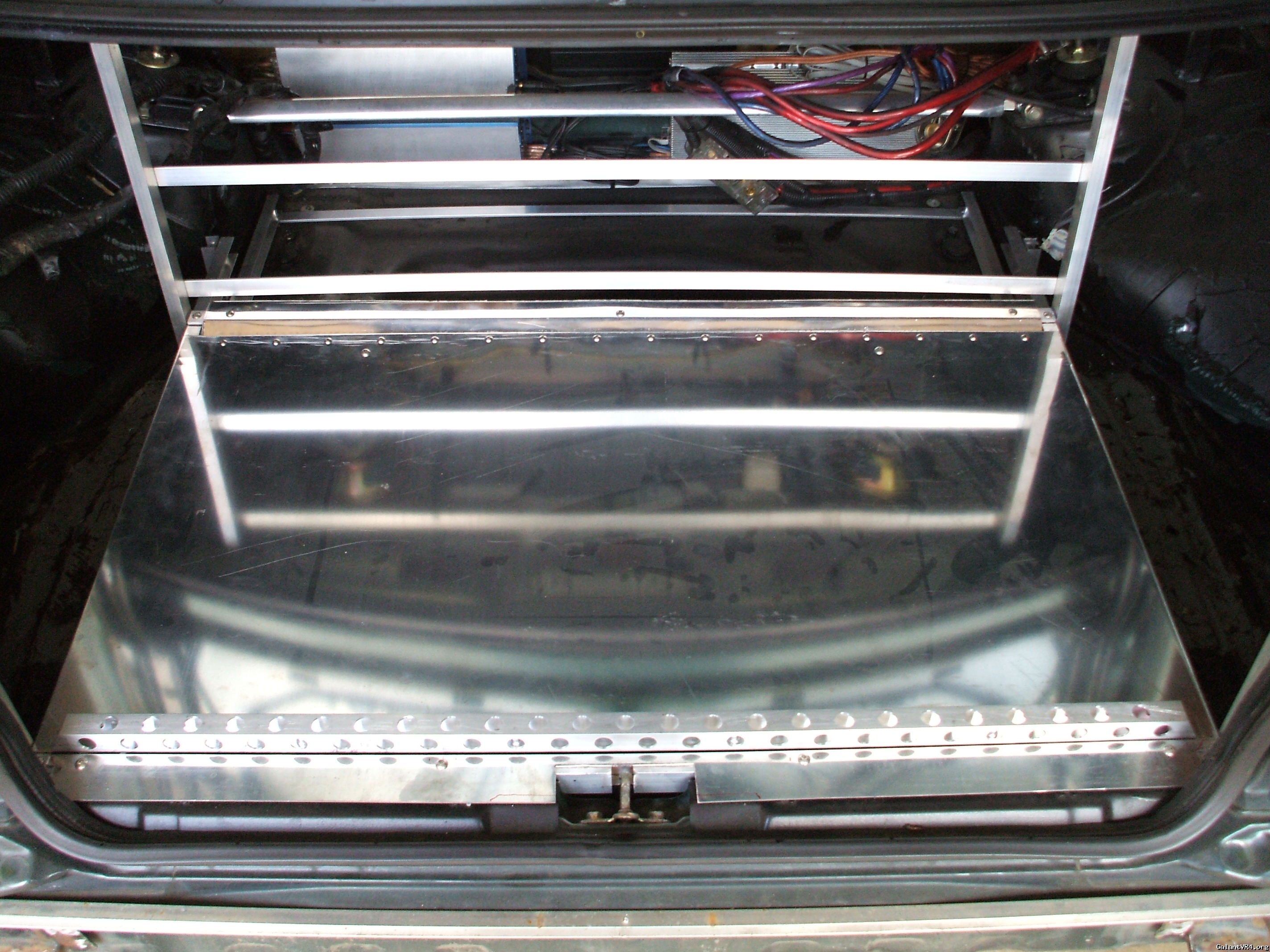

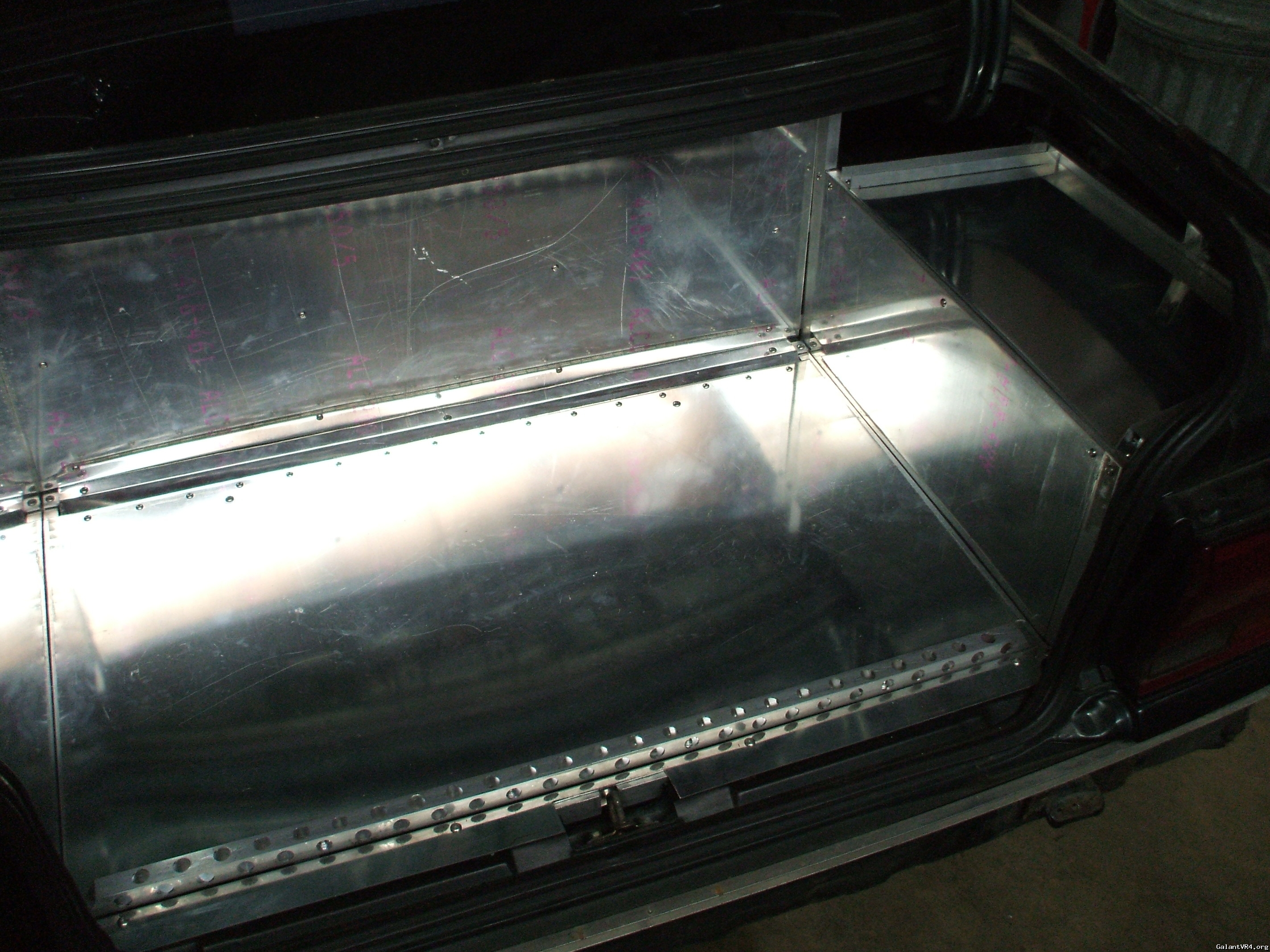

The trunk project needs another 2 days or so dedicated to it and the other welding project needs about twice that. Its been a long winter jumping around Taz's crate but now that spring is here the car is going outside after the trunk is done so I can get the welding things done and packaged up. After that there's a few small things I have to cut on the mill and a few pieces to paint up and restore and its time to ship.

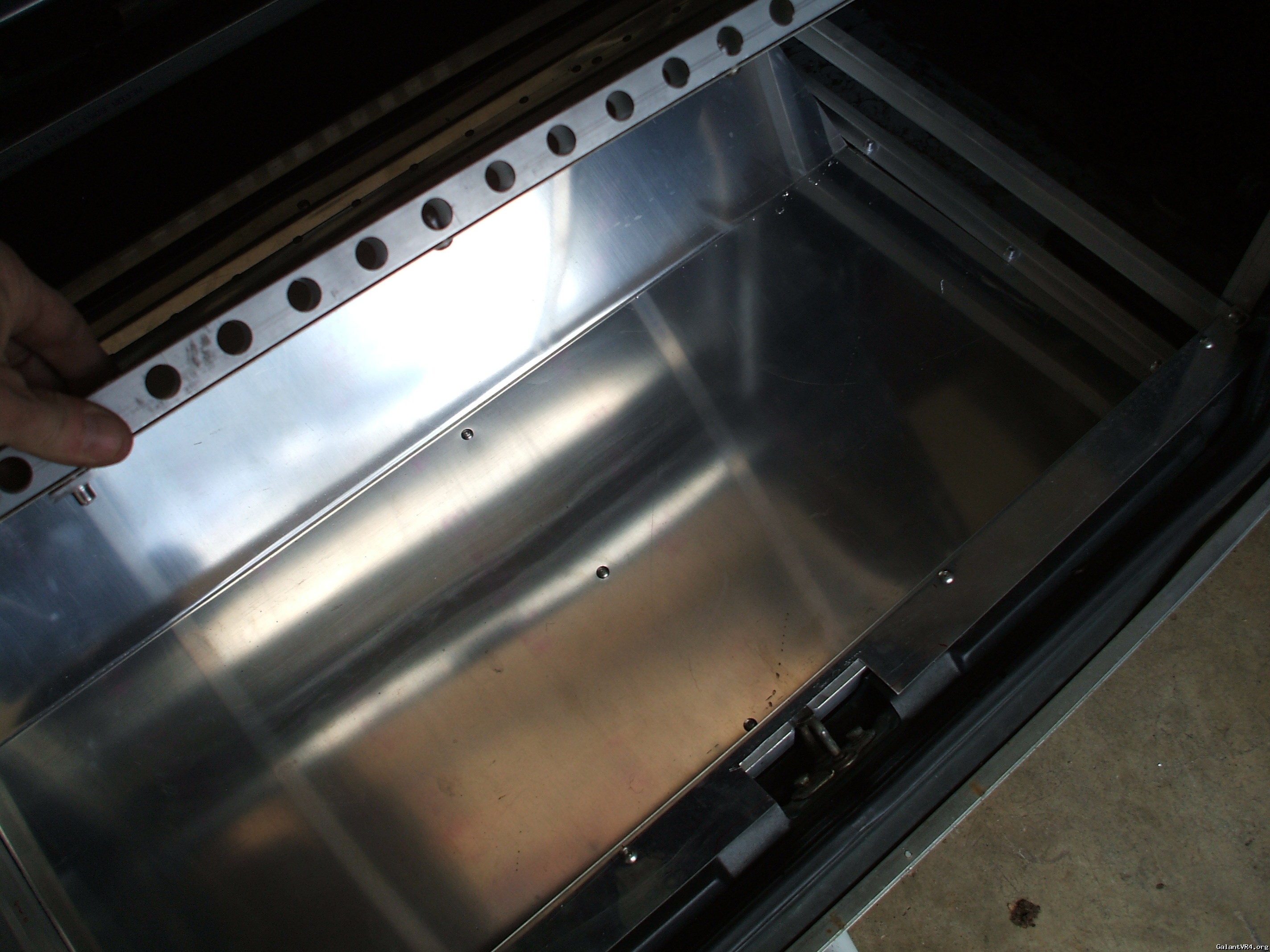

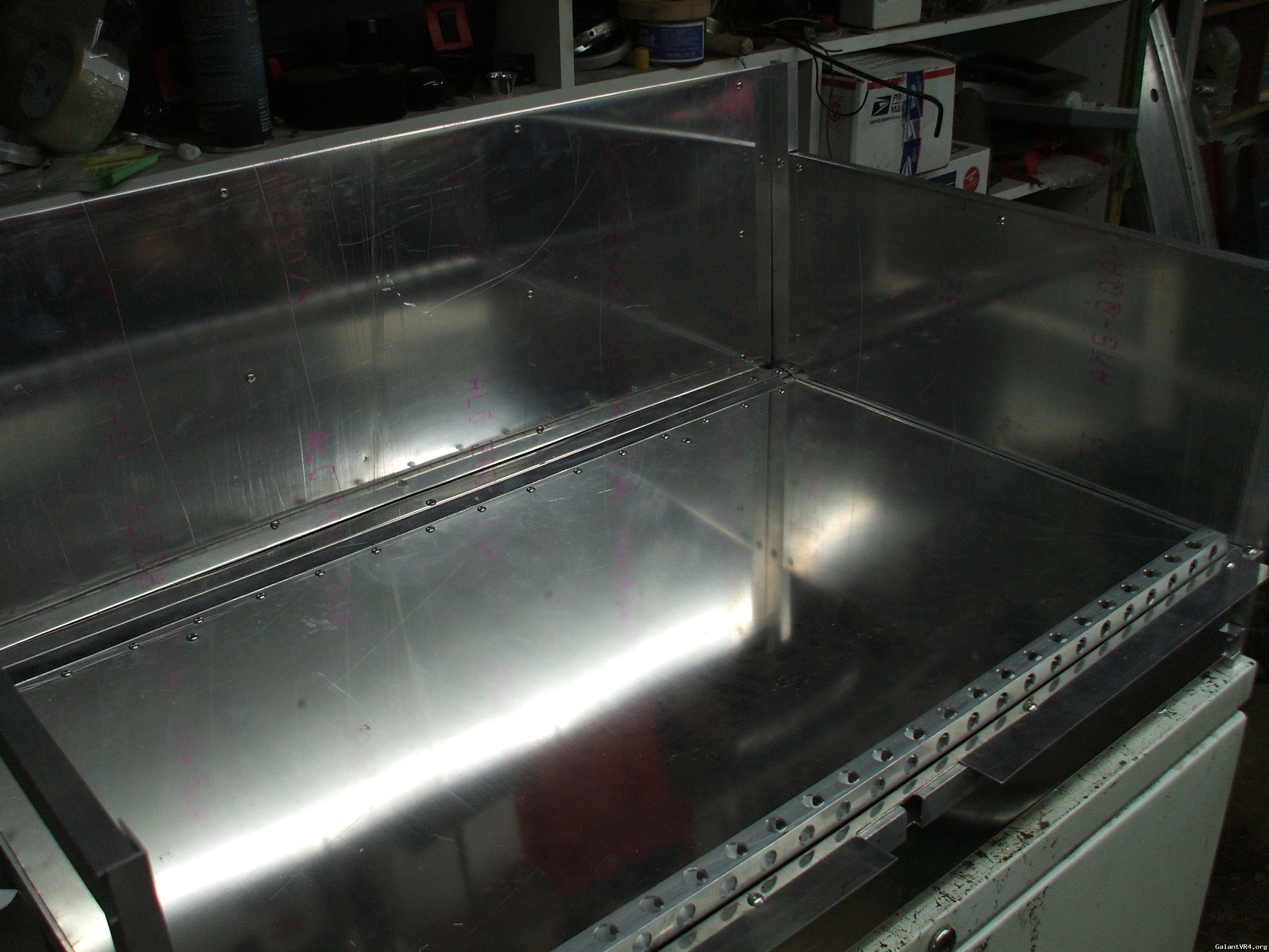

Got the belly of the trunk at about 90 percent still have to build the tray for the batteries and the cover for that side as well as the tray for the meth tank on the other. Was making good progress today until the tornado sirens started 2 minutes before the rain hit.
This is just in Framework stage everything seen will be covered in suede except the stainless hardware and the swiss cheesed handle in the rear

you're an artist! what a clean piece of work and look at the attention to detail!!! /ubbthreads/images/graemlins/worthy.gif

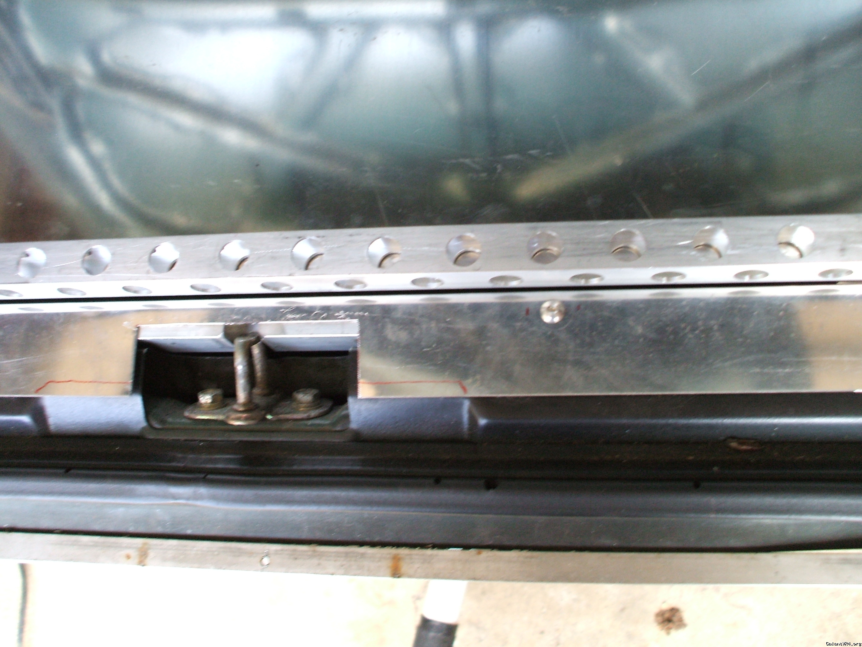

made it further yesterday another few days and the trunk is finished, It has 9 factory located attachment points so its as rigid as it can get. during final install in HK Paul will have to put down 3m double sided tape in locations that would never be removed and it want make a rattle or vibration either.
