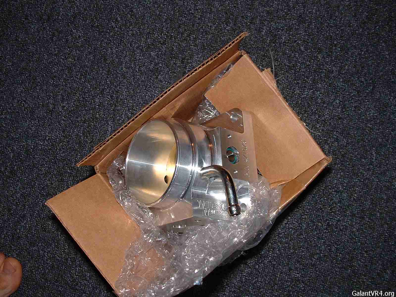

Here are some more pics. I'll take more of Paul's electronics later today.

Billet T body for the FRH manifold
Is that an AccuFab thottle body? How $$$ for those diff's? Car's going to be sick Paul!

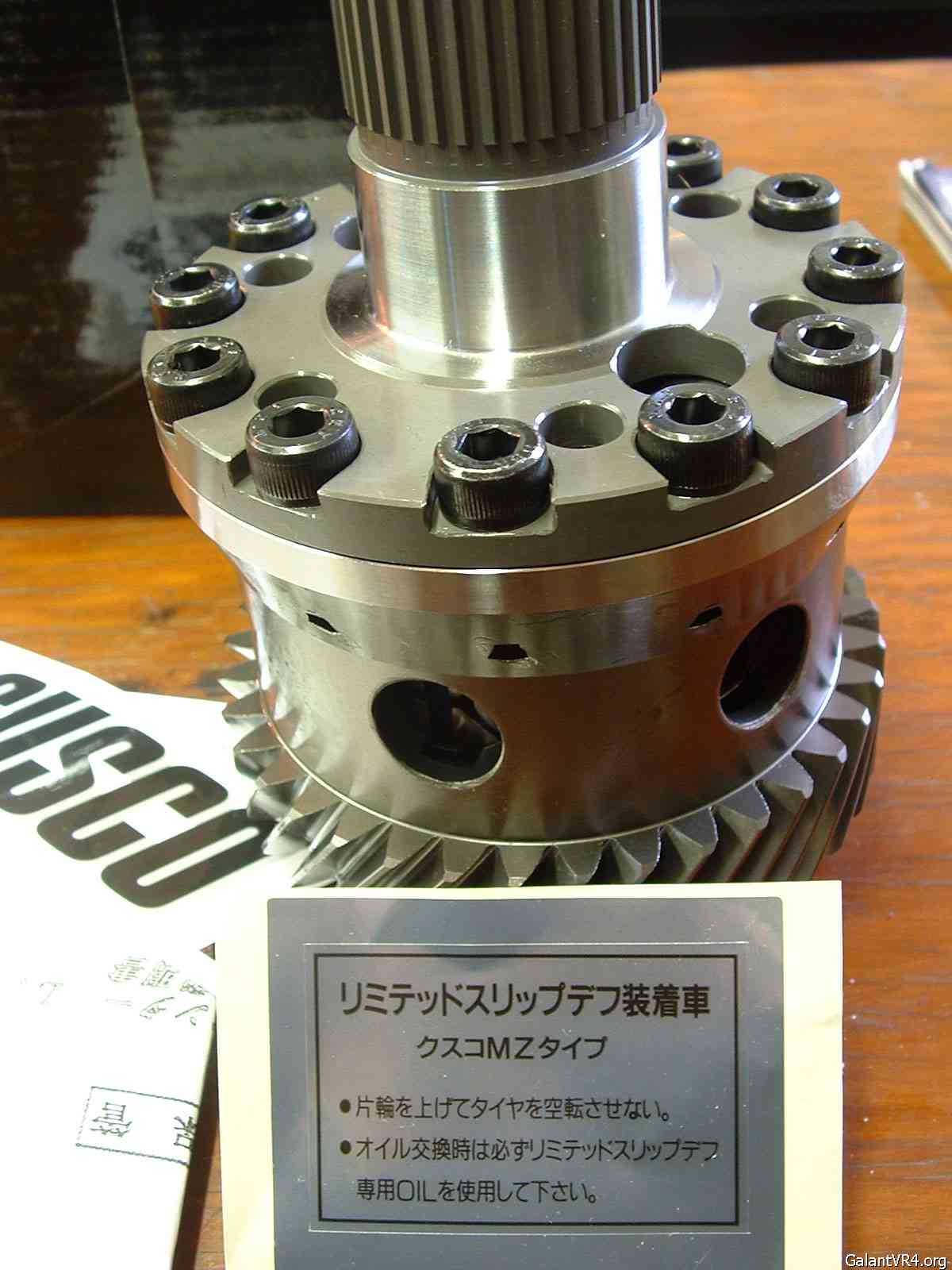

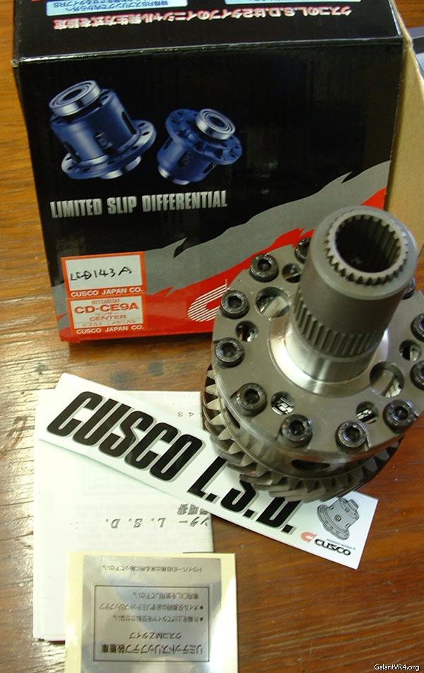

Paul, the Cusco diff is here on our desk. It's quite a sight. There's a machined ring that eliminates the need/use for the Viscous coupling. I'll post pics tonight when I get home.

With the mess I just went through with my tranny and the different gear pitches that Mitsu decided to use between '91 and '92 I hope for Paul's sake that center diff meshes correctly, with whatever tranny that Teet built for him. /ubbthreads/images/graemlins/uhh.gif
