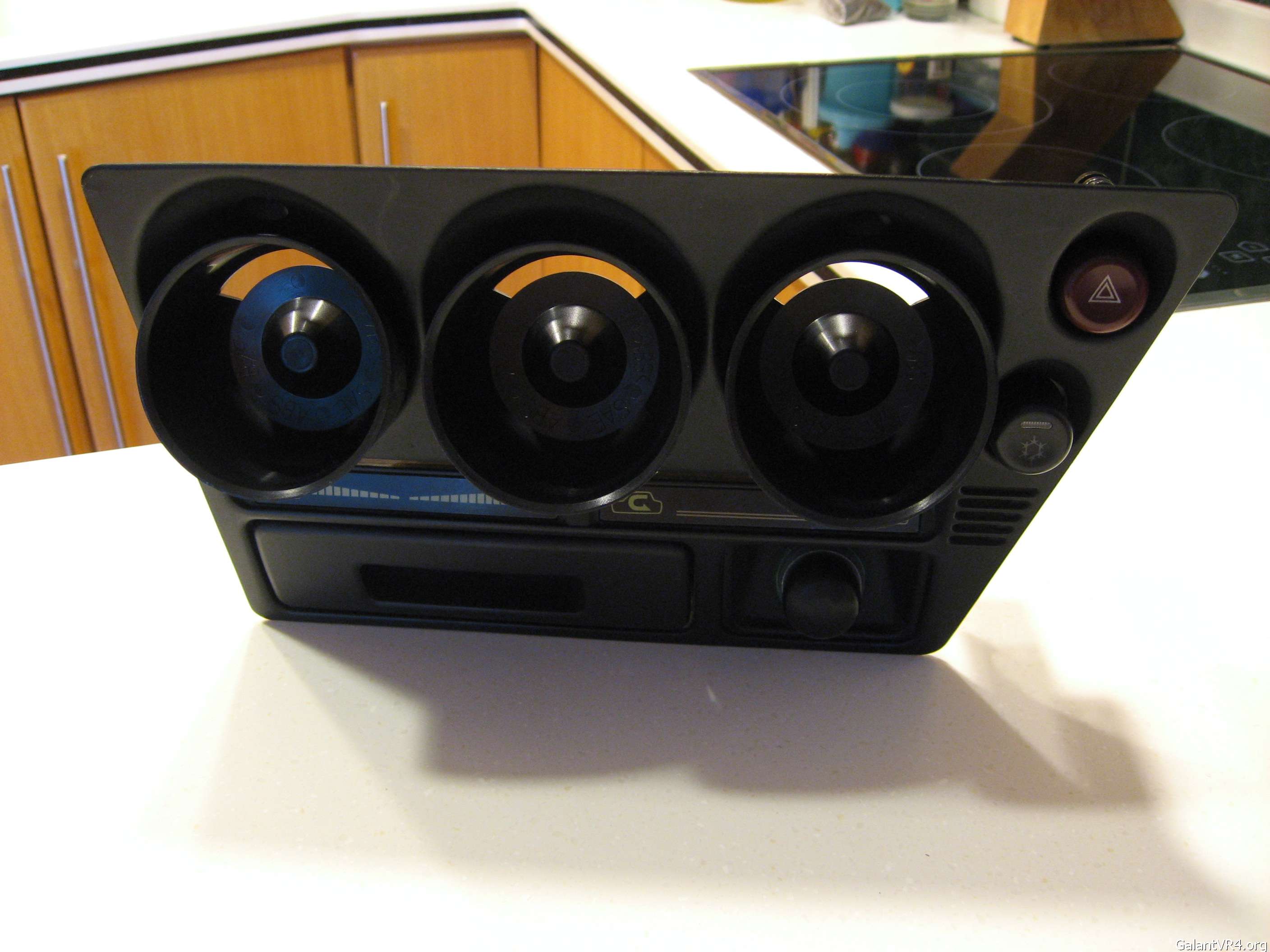

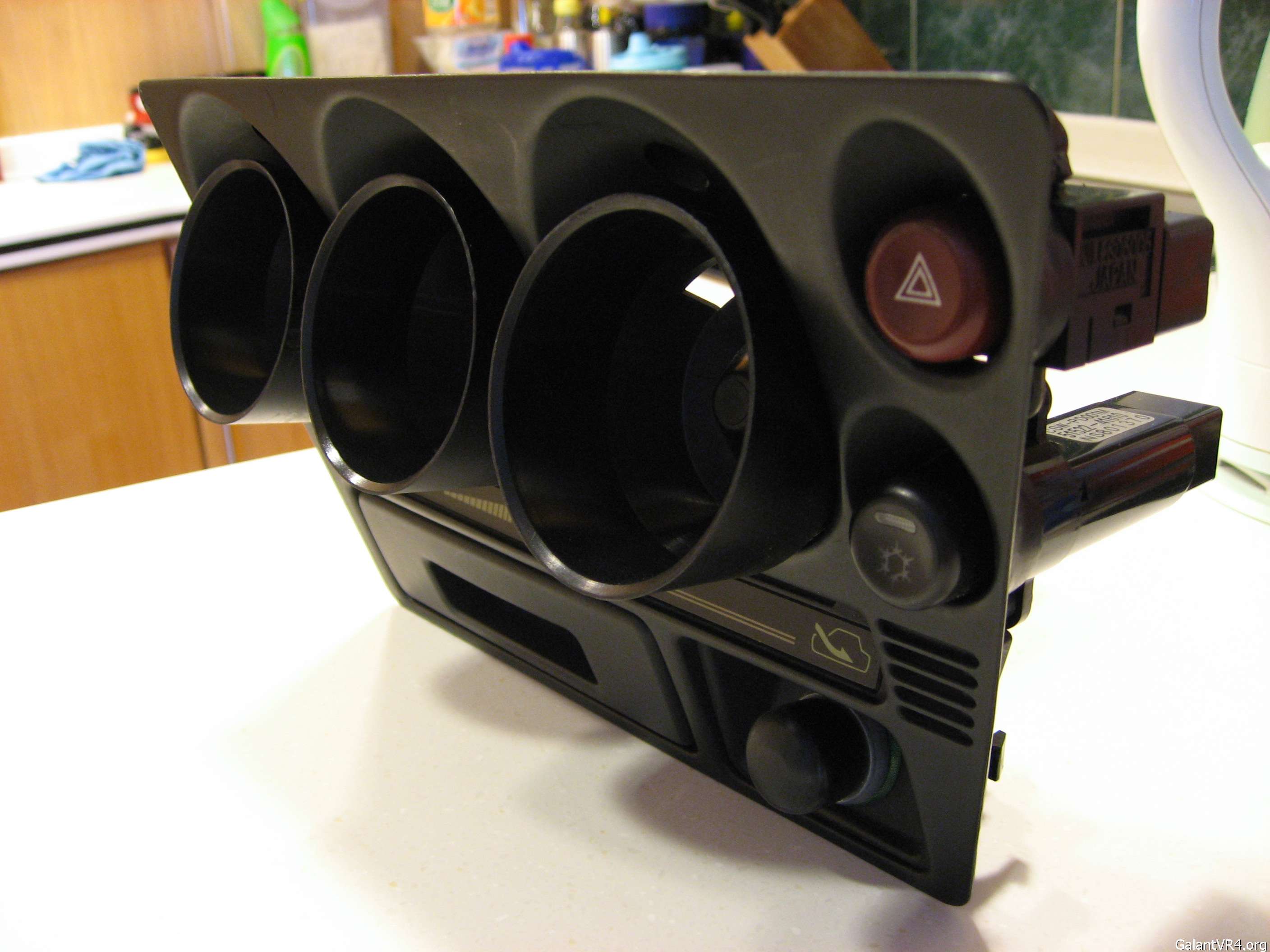

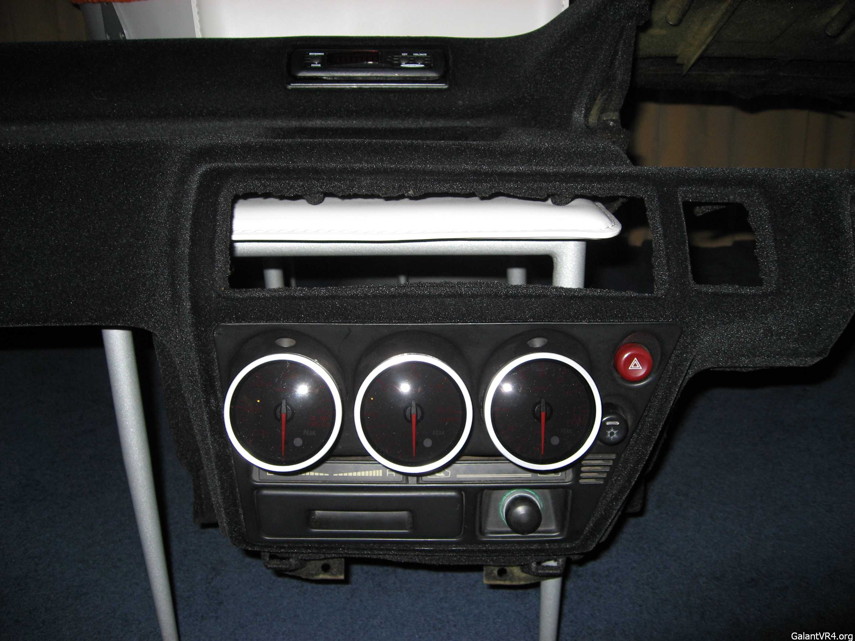

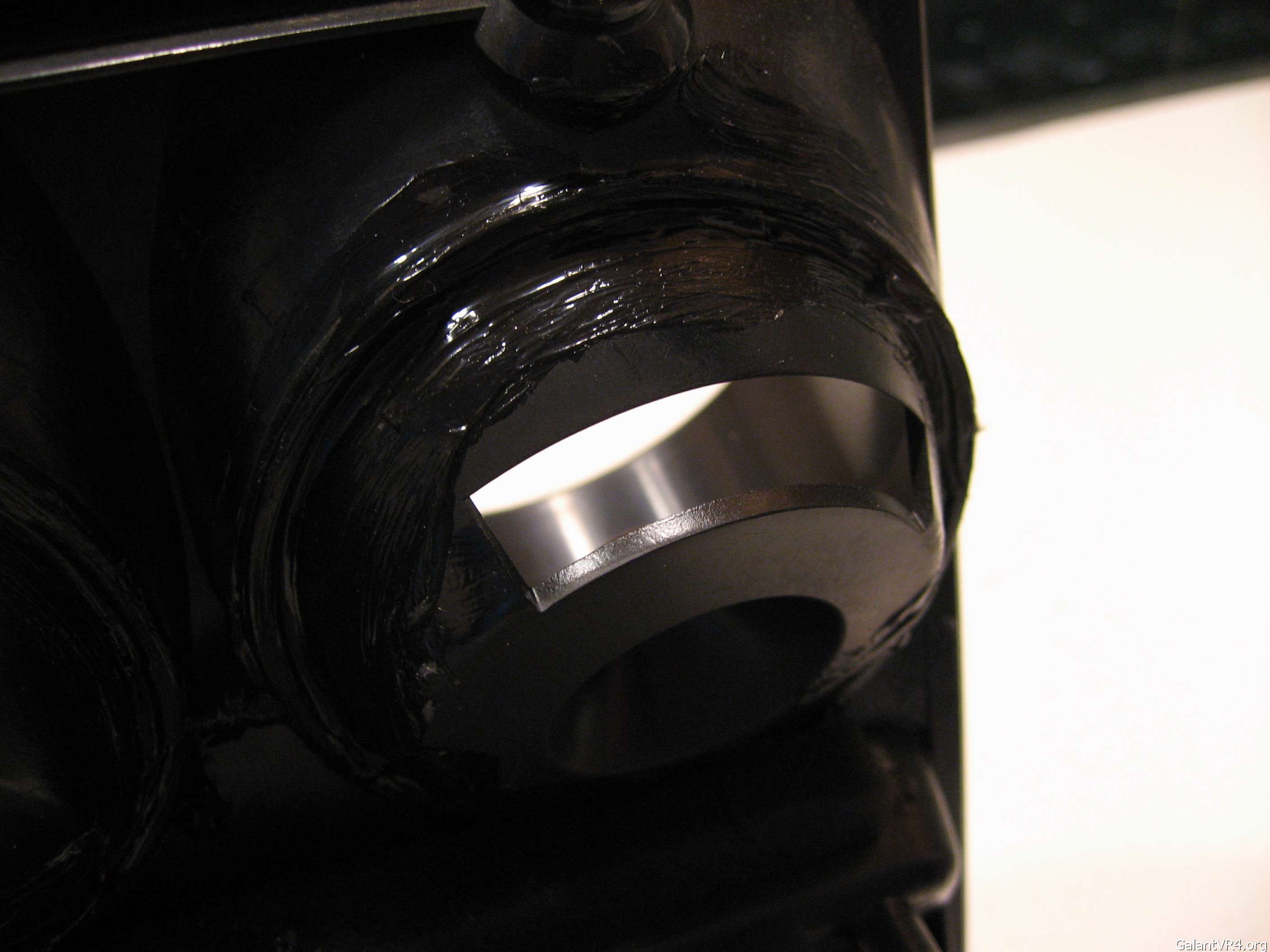

Some of you may remember my thread about fitting DEFi gauges in a manual A/C centre console section. One criticism was that once installed in the car, the gauges are hard to read because they point down. I had that project on hold for some time until one day I was looking at the cups DEFi supplies to mount those gauges on the dash. I never liked the dash mount solution. Too many wires everywhere! The cups had some bracket slots molded onto them. I took them over to my friend Gong-Jai and borrowed his grinding wheel for 30 mins and ground those off, brought them home tidied them up with a multi-master and sprayed them. Then I mounted them in the A/C control holes, 'spot-welded' them with superglue and once I was happy with placement I sealed them in properly at the back with black silicone. Initially the silicone was just intended to fill in any gaps and I was going to go over everything with epoxy, but the cups are so solid now I decided not to bother. Since the cups still move very slightly, I imagine the rubber/silicone will also help absorb vibration.

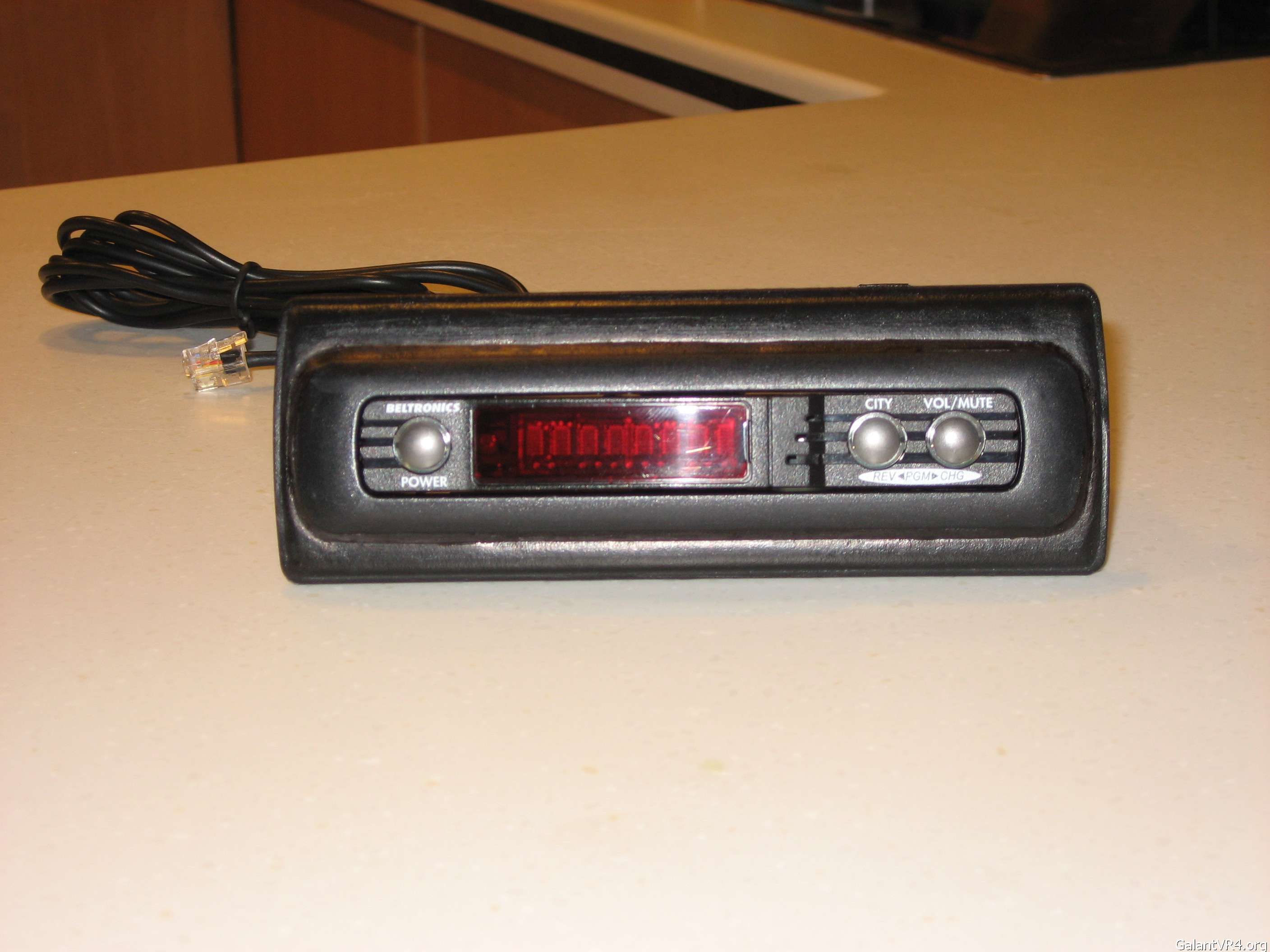

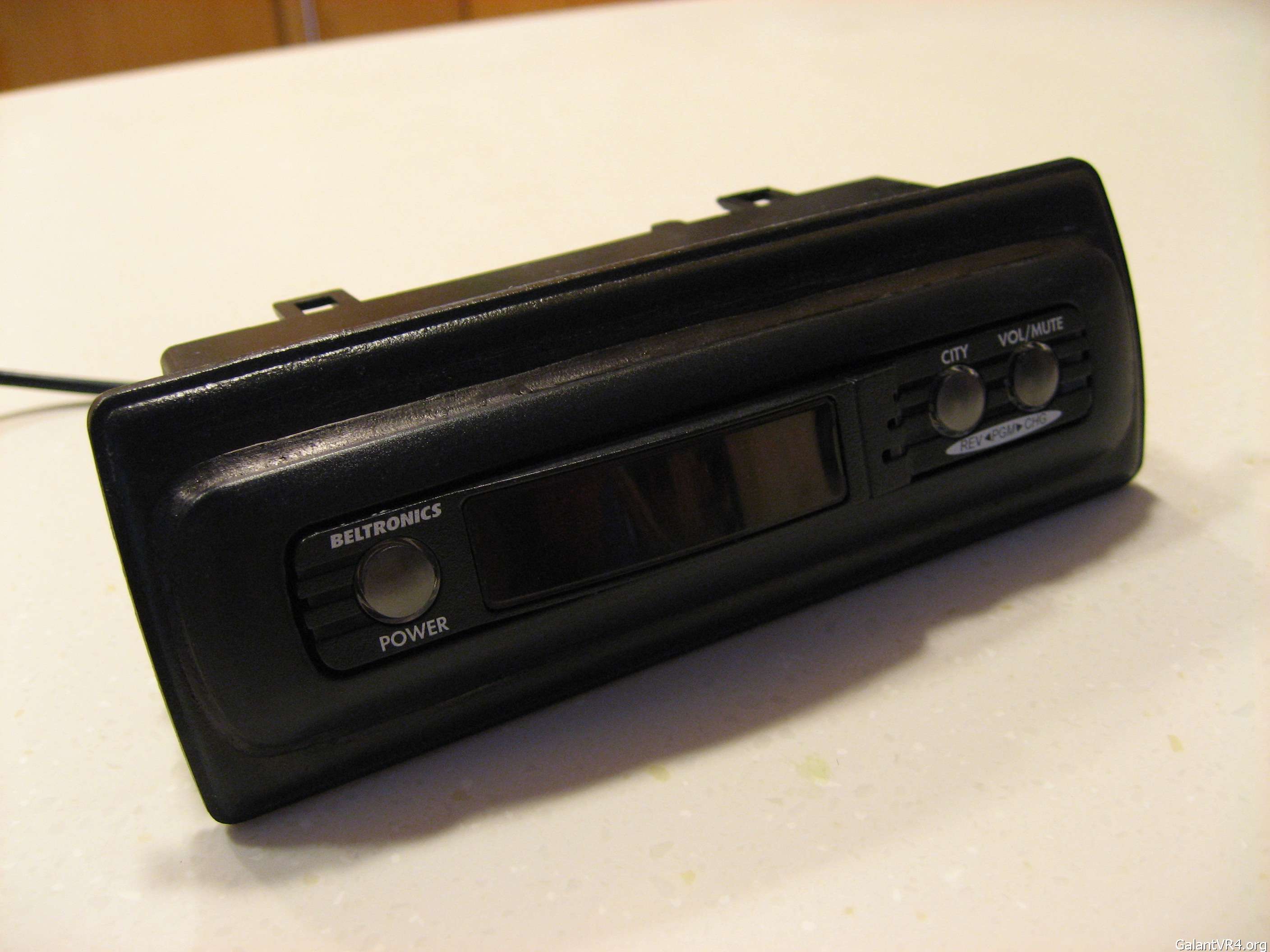

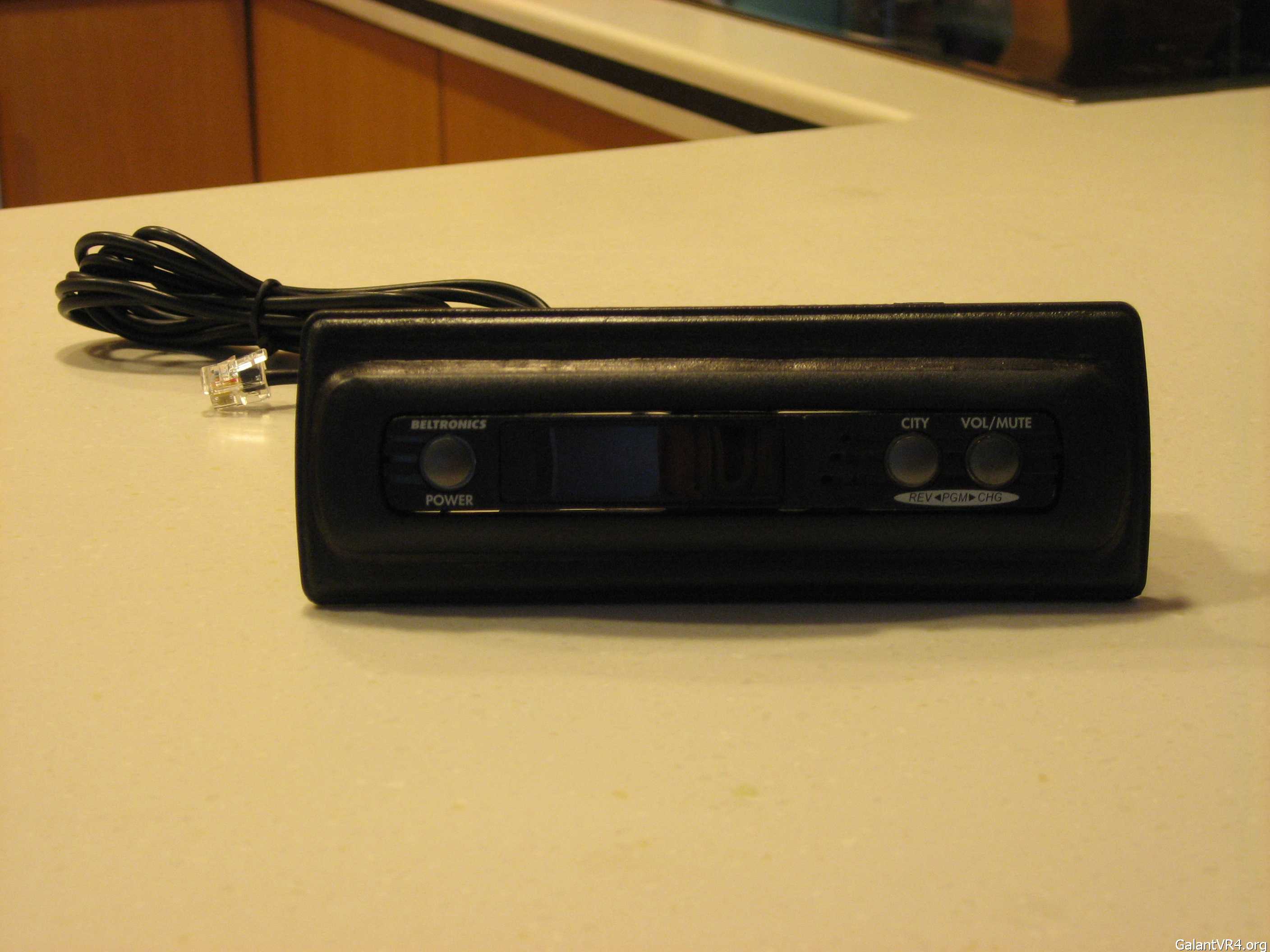

The next project was relocating the Beltronics remote radar display to the clock position. I sized this all up a while ago as I wasn't keen on keeping my clock, but I was still somewhat hesitant to start hacking the surround as I didn't have a spare. I finally plucked up the courage and just went very, very slowly cuting a little bit at a time until I could just slot the display in. The bezel is held in place by epoxy which is painted black. I have only gone round with a paint marker as a 'primer' so far. I'll probably mask off the display and bezel and do a final spray of black paint before I install it.
