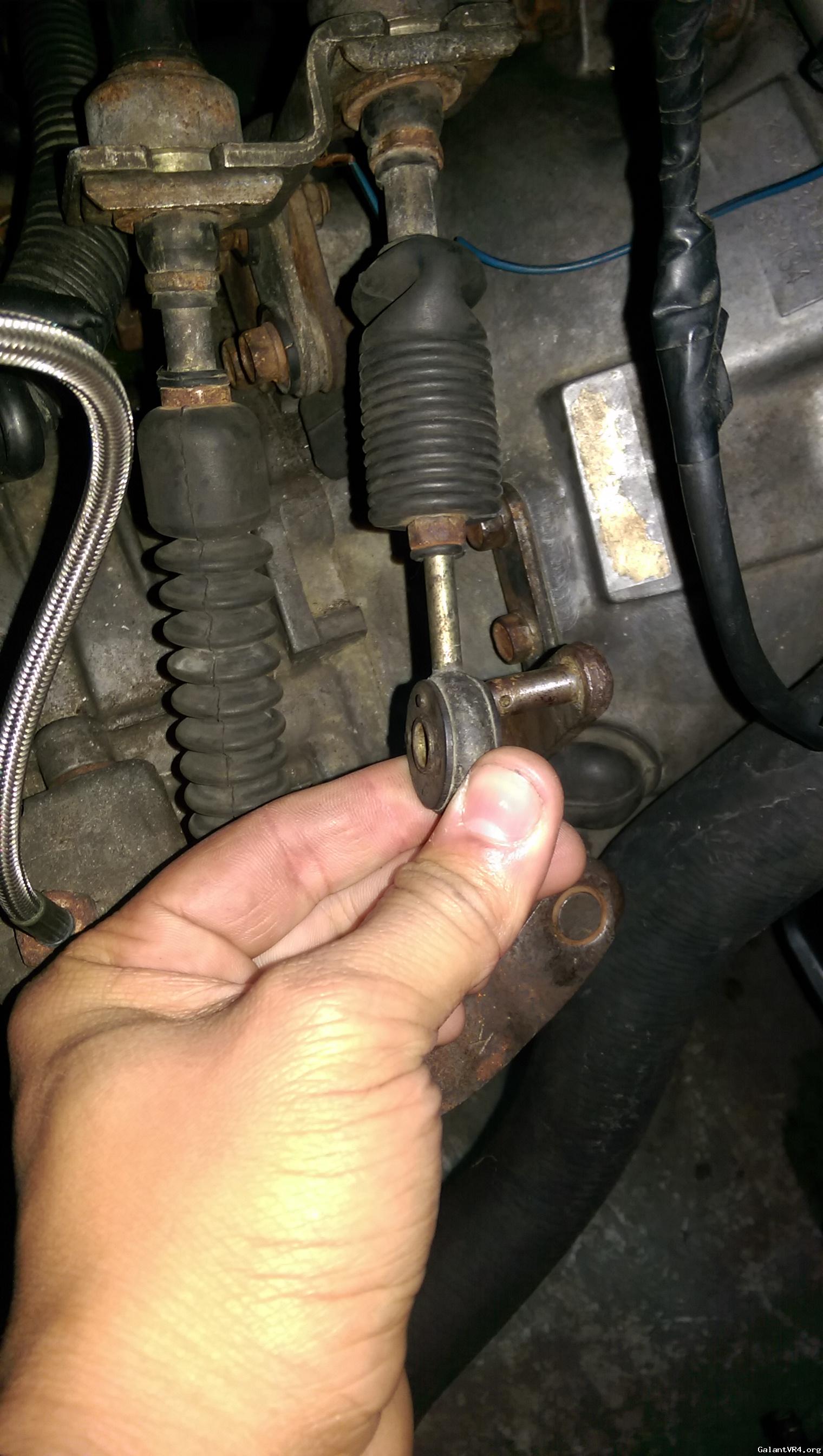

So, now back to my no reverse issue. I adjusted the cable that was installed and I still couldn't get into reverse. I ended up swapping to the cables that were originally in the car since both the left and right cables allowed for adjustments. The adjustments didn't help, when I think I'm in reverse I'm really in 4th and the car moves forward instead of back.
I did a quick search and I found some threads.
I followed both, and I still have this issue. /ubbthreads/images/graemlins/banghead.gif
citymunky
Sep 22, 2010
1,761
Chesapeake, VA

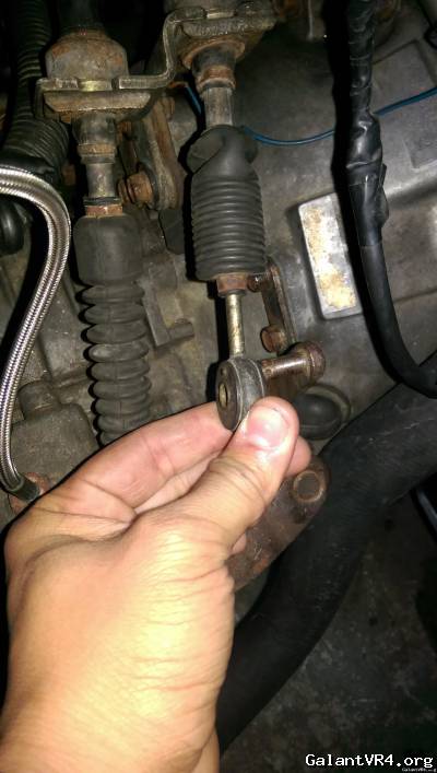

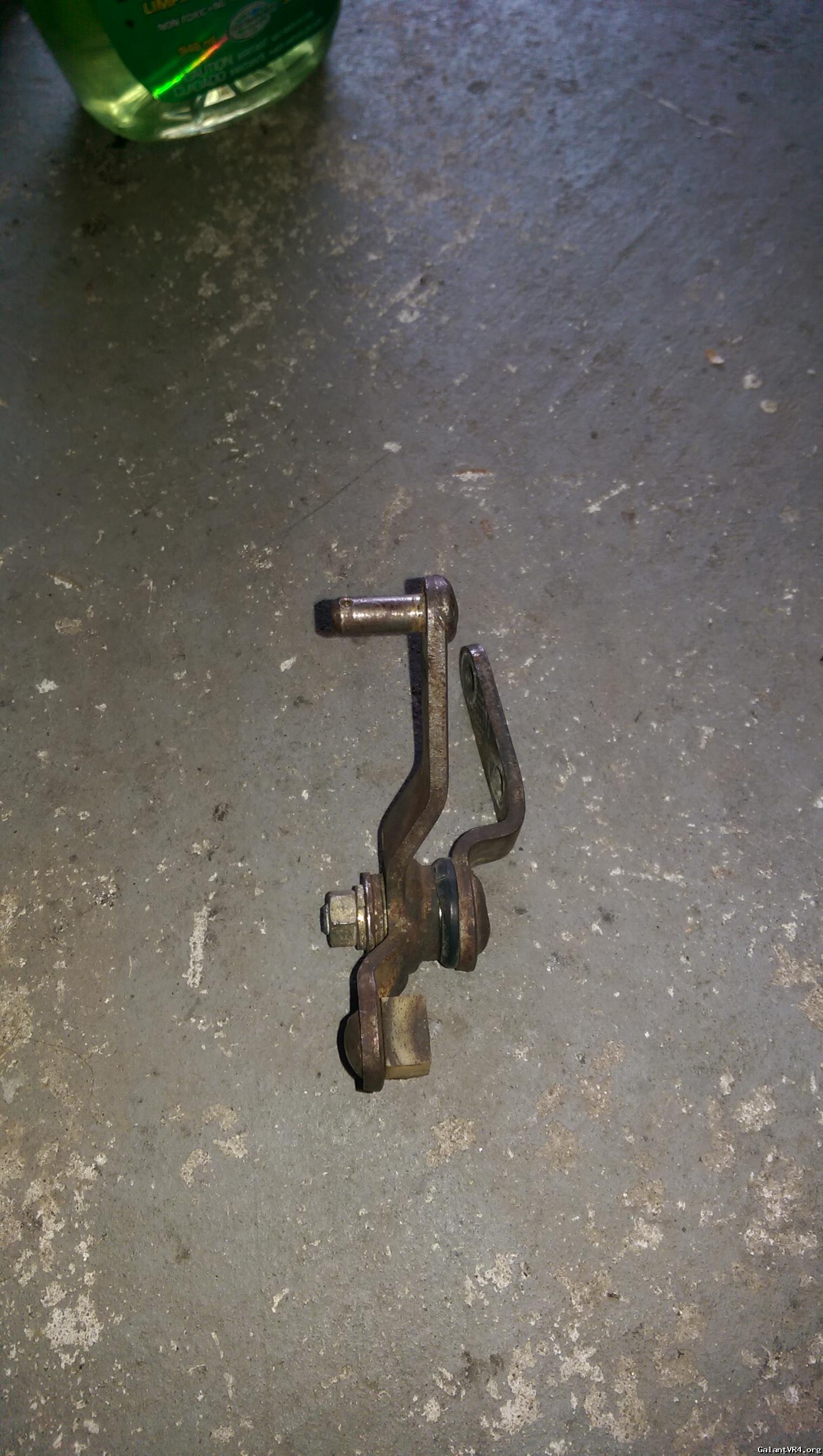

Well with the car off, I was able to get the car in reverse and start her up, the car started moving backwards. So I have adjustment issue somewhere.
I can't slide this end of my cable on when the transmission is in reverse. I need to figure out way. BTW I did check that I have right bracket installed.
citymunky
Sep 22, 2010
1,761
Chesapeake, VA

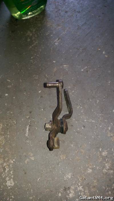

I seem to have fixed it, while I was checking to see if the white plastic box was worn, I noticed there was a ton of play in the gear selector arm. I swapped the whole braket/arm from my 22 spline transmission and I'm able to get into reverse now. /ubbthreads/images/graemlins/grin.gif

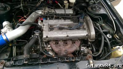

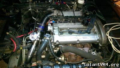

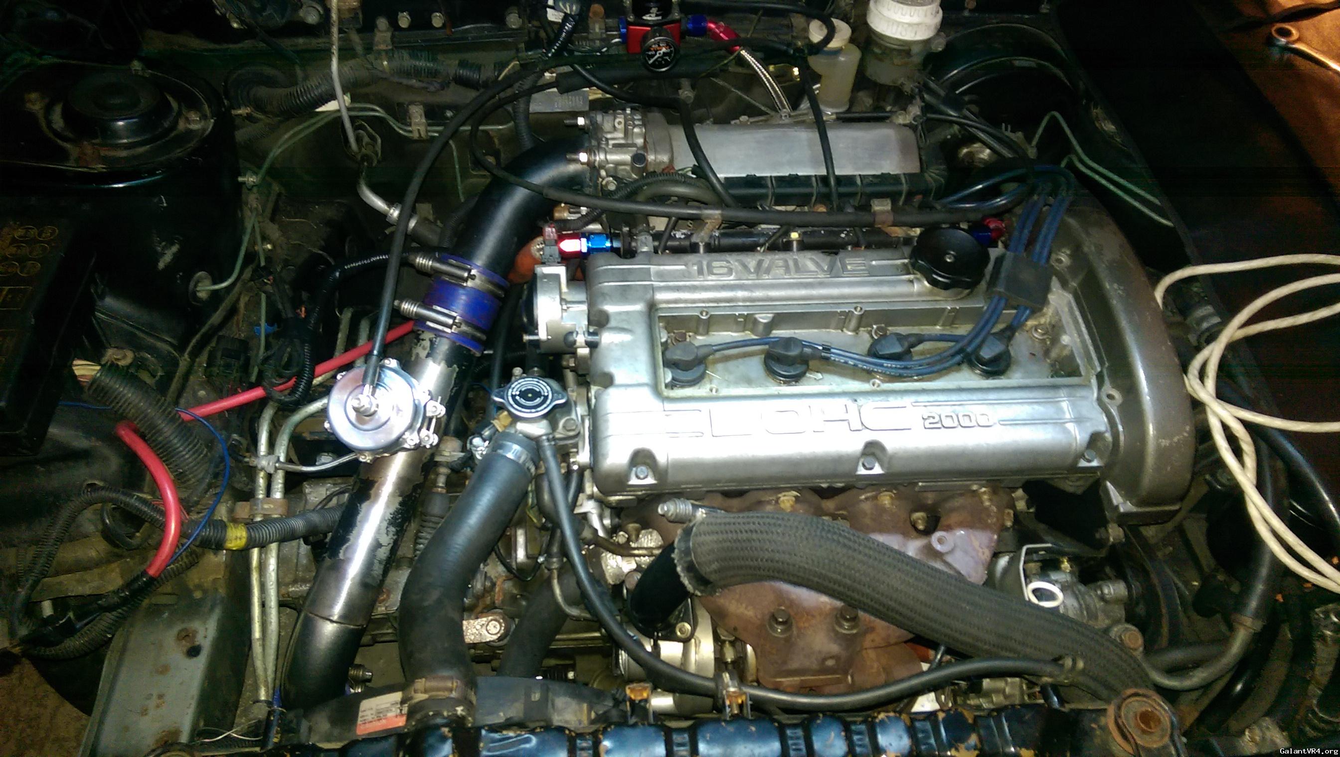

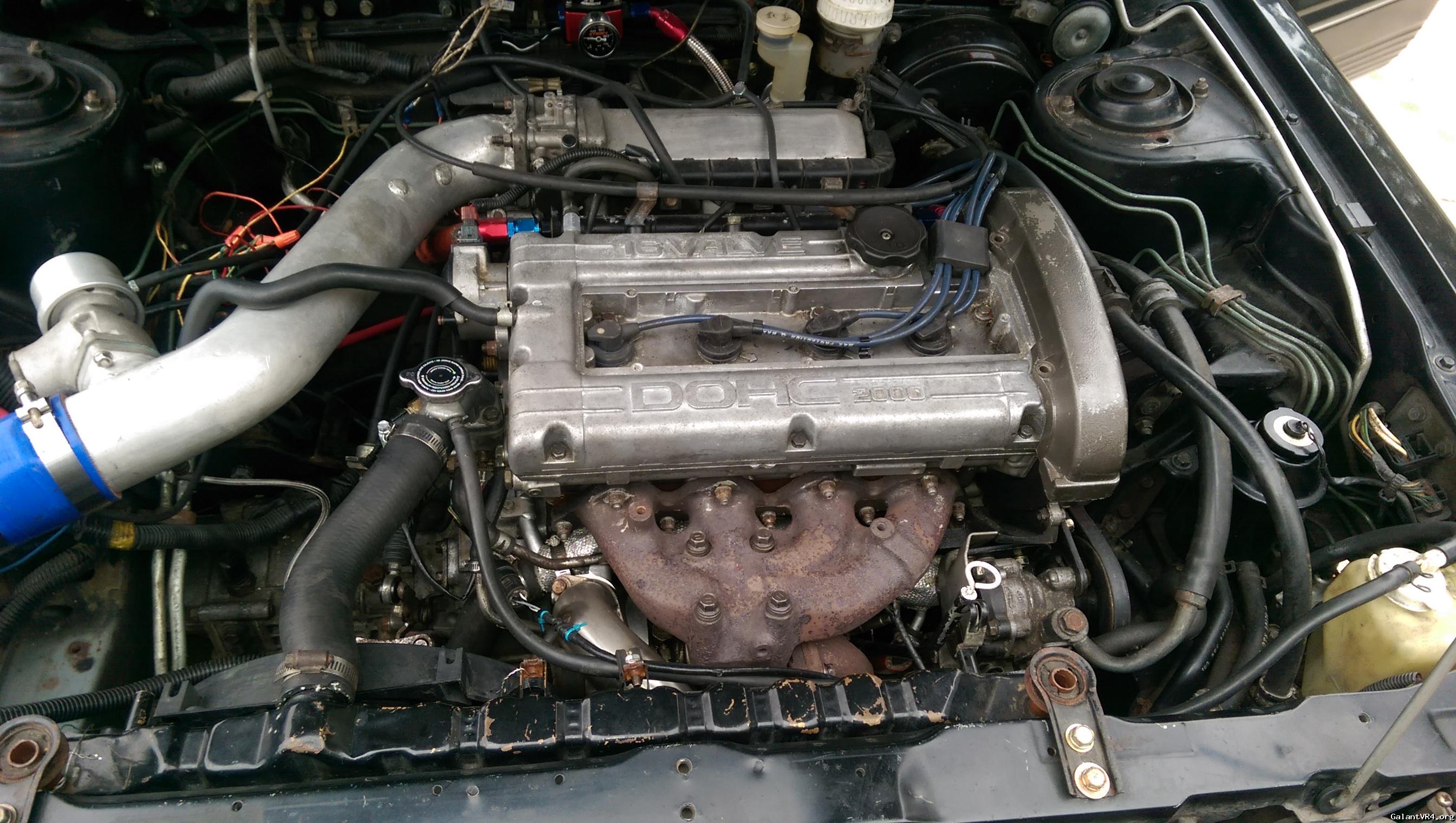

Well I been super busy lately, but I removed the custom intercooler setup and did a test fit of the ETS intercooler and piping. The reason for the switch was to make room behind the bumper for foglights.
I also had to pick up a new BOV since the ETS pipe was flanges of a Tial, I picked up a new Tial Q.
This pic was the before.
Quoting citymunky:
I know my engine bay looks like a rat nest and full of short cuts but this keeps the car mobile until I can drop the new setup in.

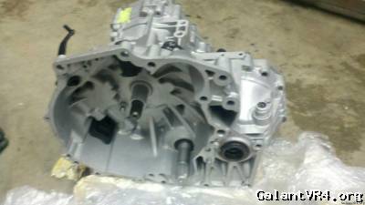

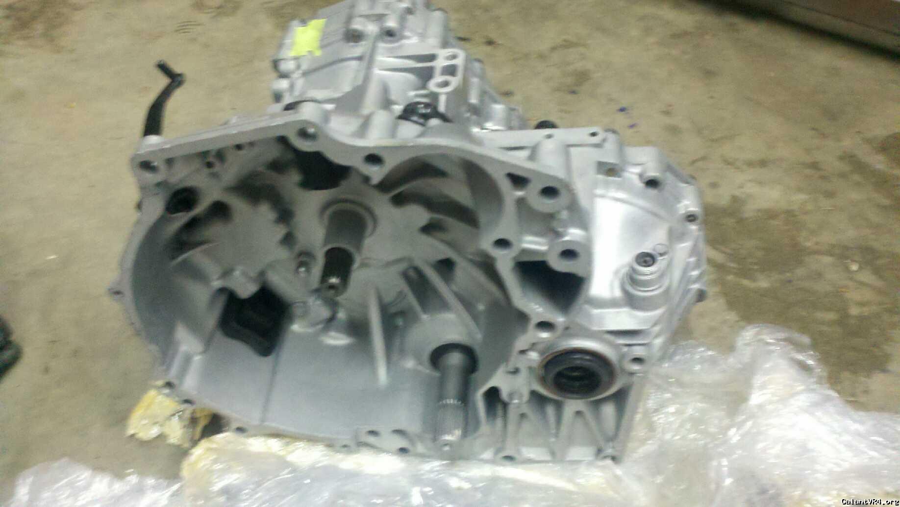

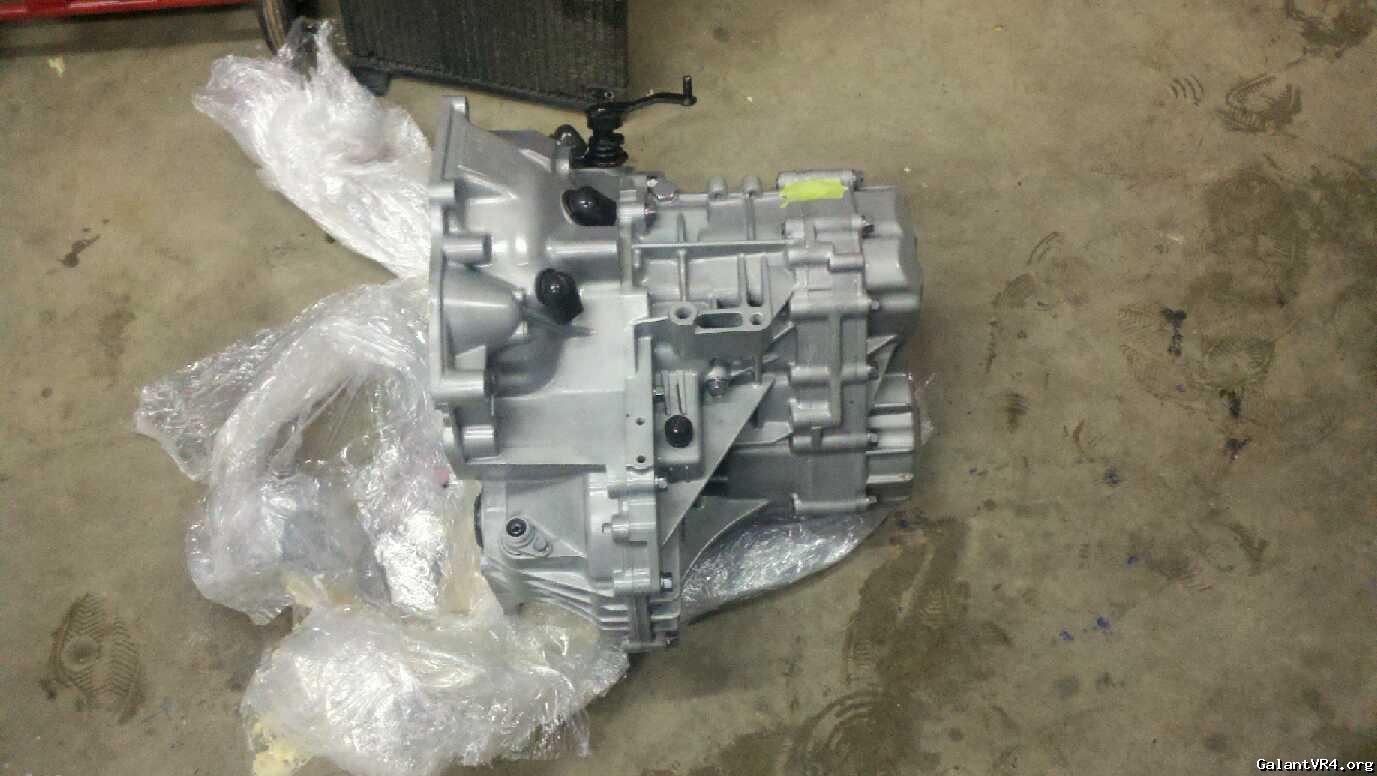

Just picked up this beauty today.
New (NOS) Jack's Transmission 2.2HD with a welded center diff. 0 miles and has been sitting for a while.

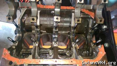

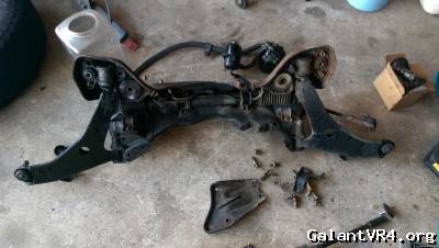

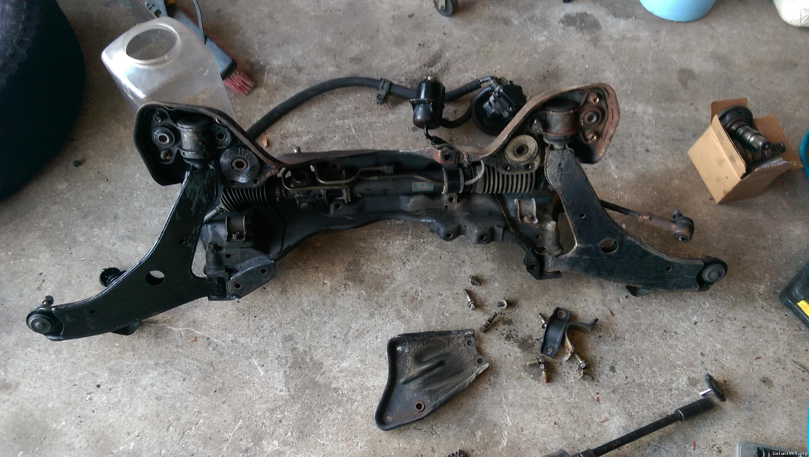

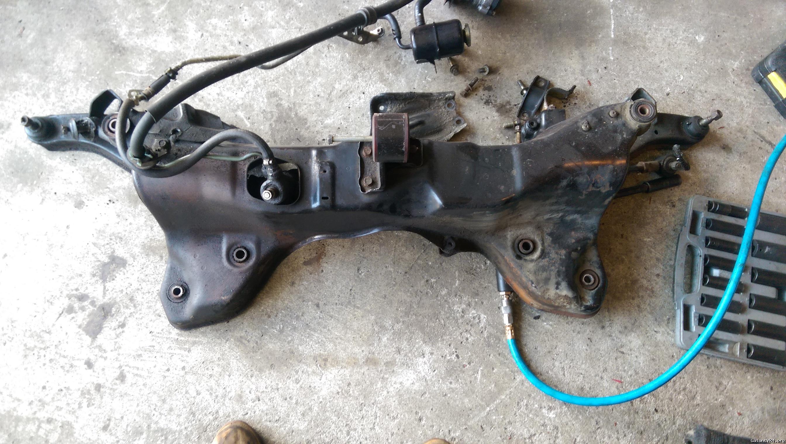

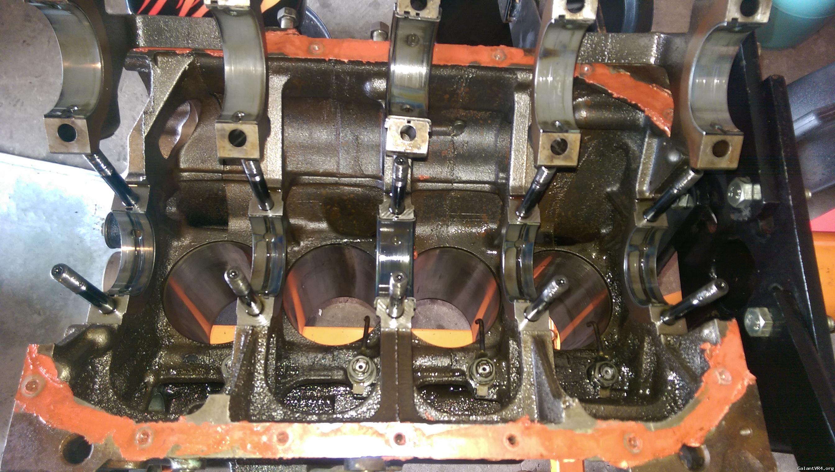

Dropped off the block to the machine shop yesterday, and I'm currently at a stand still with my head until I get my hands on valve spring compressor. So I started taking a part my spare front DSM subframe so I can clean her up in the meantime. For a reference point this is what I'm starting with.
New ES bushings and ball joints are on order for now and I'm looking into replacing that steering rack. It's showing signs of leaking, the inner tie rods are trash and both boots are torn.

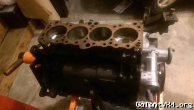

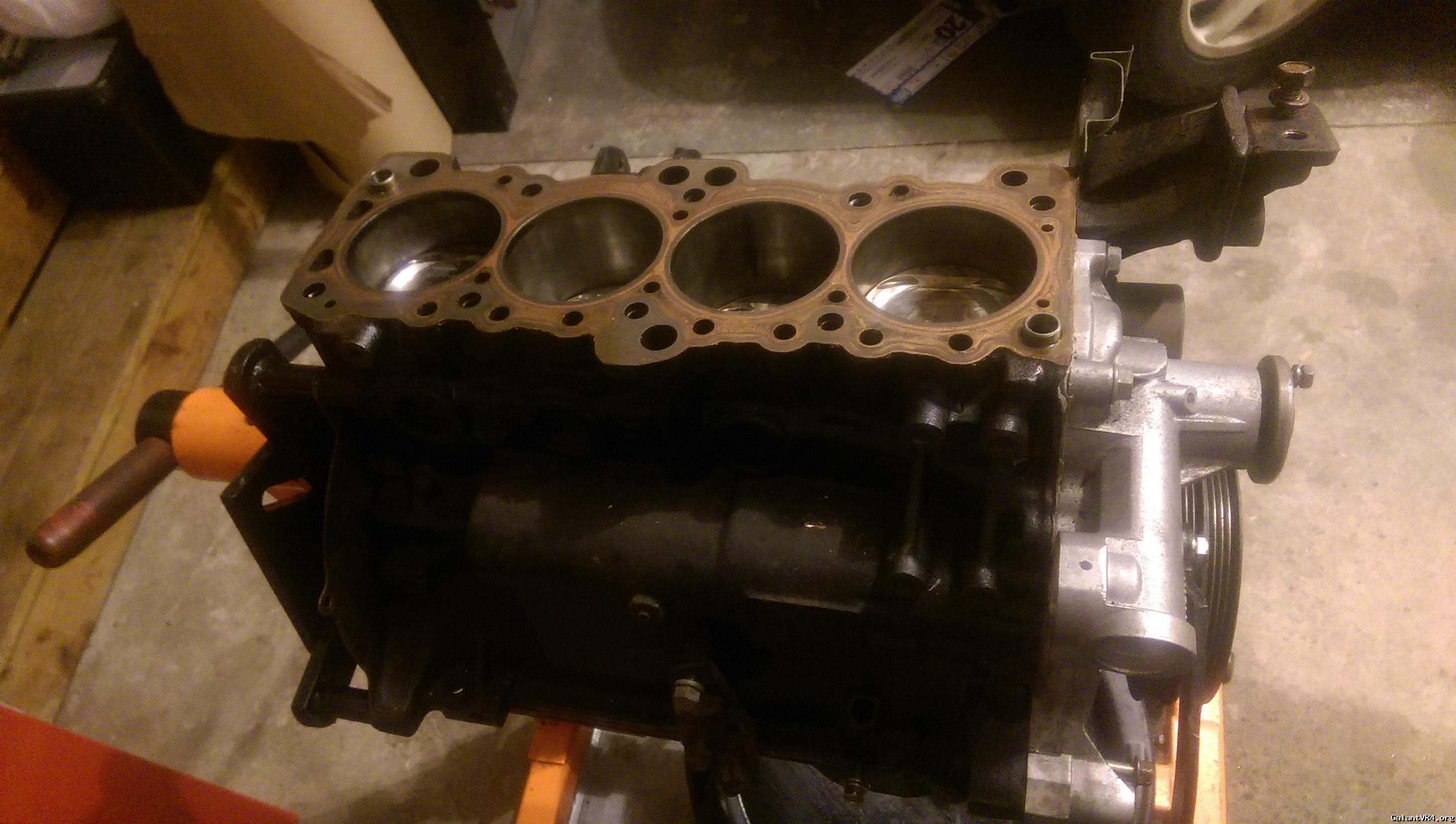

Well here I am again, out of time and out of patience. In the beginning of the month I posted this click . Since than I rebuild my small 16G turbo, had it balanced locally, installed it and I still have a smoking issue. I suspect the valve stem seals are done, however the only want to find out is to replace them. It's a cheap fix, however knowing the amount of time I have it would have me 2 months before I get around to fixing it. Than on to the next issue and so on and on and before I know it the car would be in the garage next winter.
I was in the middle on building my other short block so I can drop it in when it was done, but recently my Titan was totaled by a drunk driver and I been dealing with the issue for the last 2 weeks. Found a few suitable replacement SUV's to take it's place however I keep wasting by time with people who "Loss" the title or still have a lien on their vehicle, and I ended buying a mid-sized SUV this past weekend to hold me over instead of buying the Full-sized SUV like I wanted. If this would have never happened I would own Hittman's old car 747/1000 (https://www.galantvr4.org/ubbthreads/showflat.php?Board=UBB12&Number=1188614&page=0&fpart=1 ), since that popped up for sale right before my truck was totaled and sold right after I called BS and stopped dealing with scammer trying to sell me a SUV without a Title. This it twice I missed out on a high dollar GVR-4, the first was BluFalcon's KG 521/1K.
