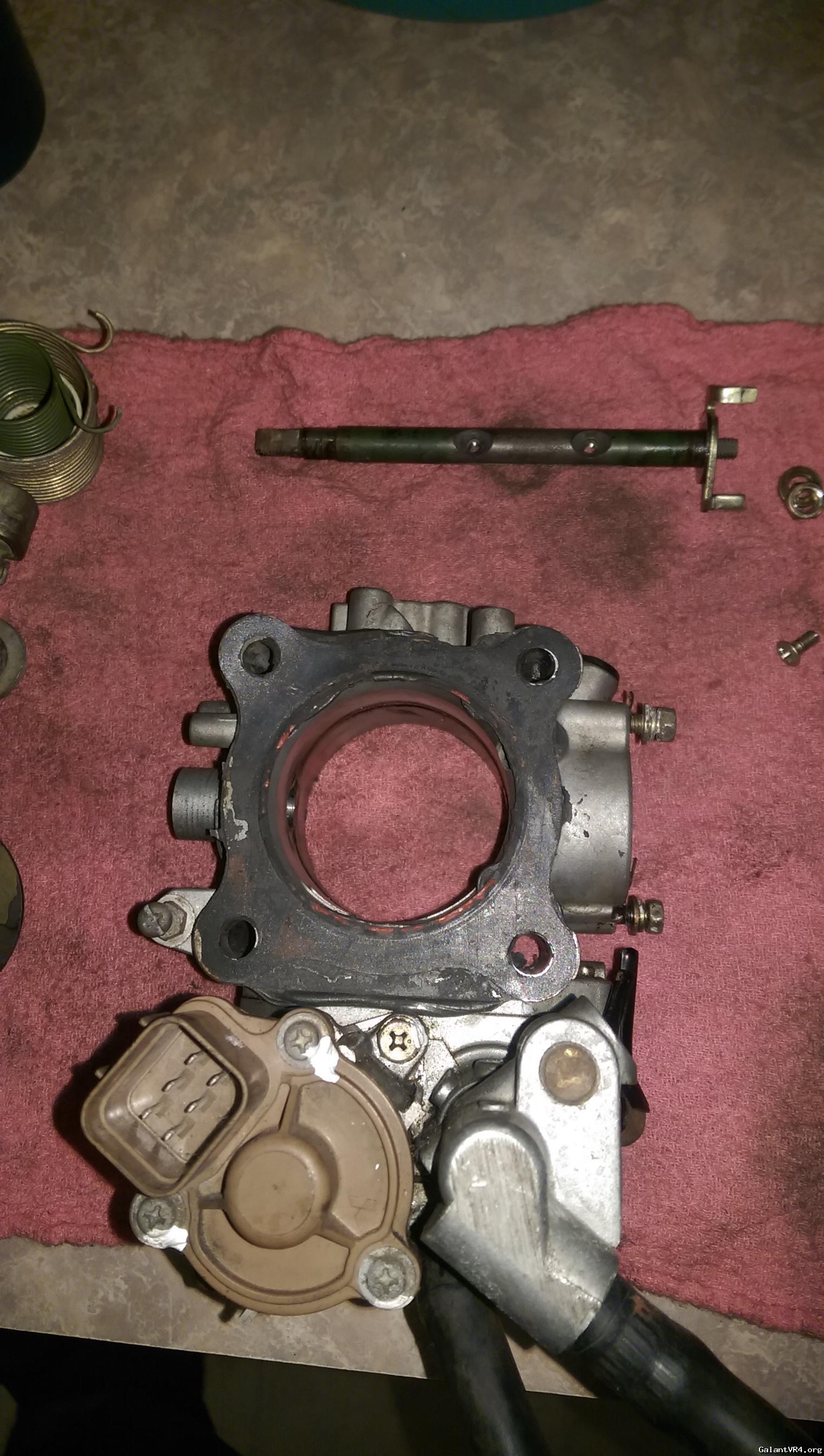

I noticed, I don't have many pictures on this thread so I'm post a pic of the current situation taking place in my engine.
Since to much rusty hardware for my liking, but I need to take baby steps and get this car running. Like ordered new throttle shaft seals to fix my vacuum leak.

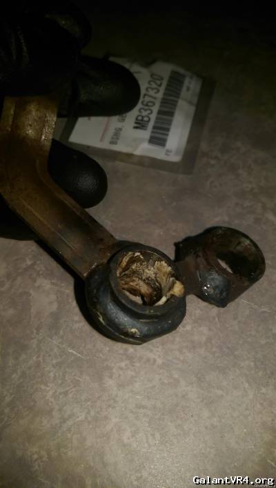

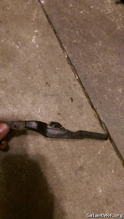

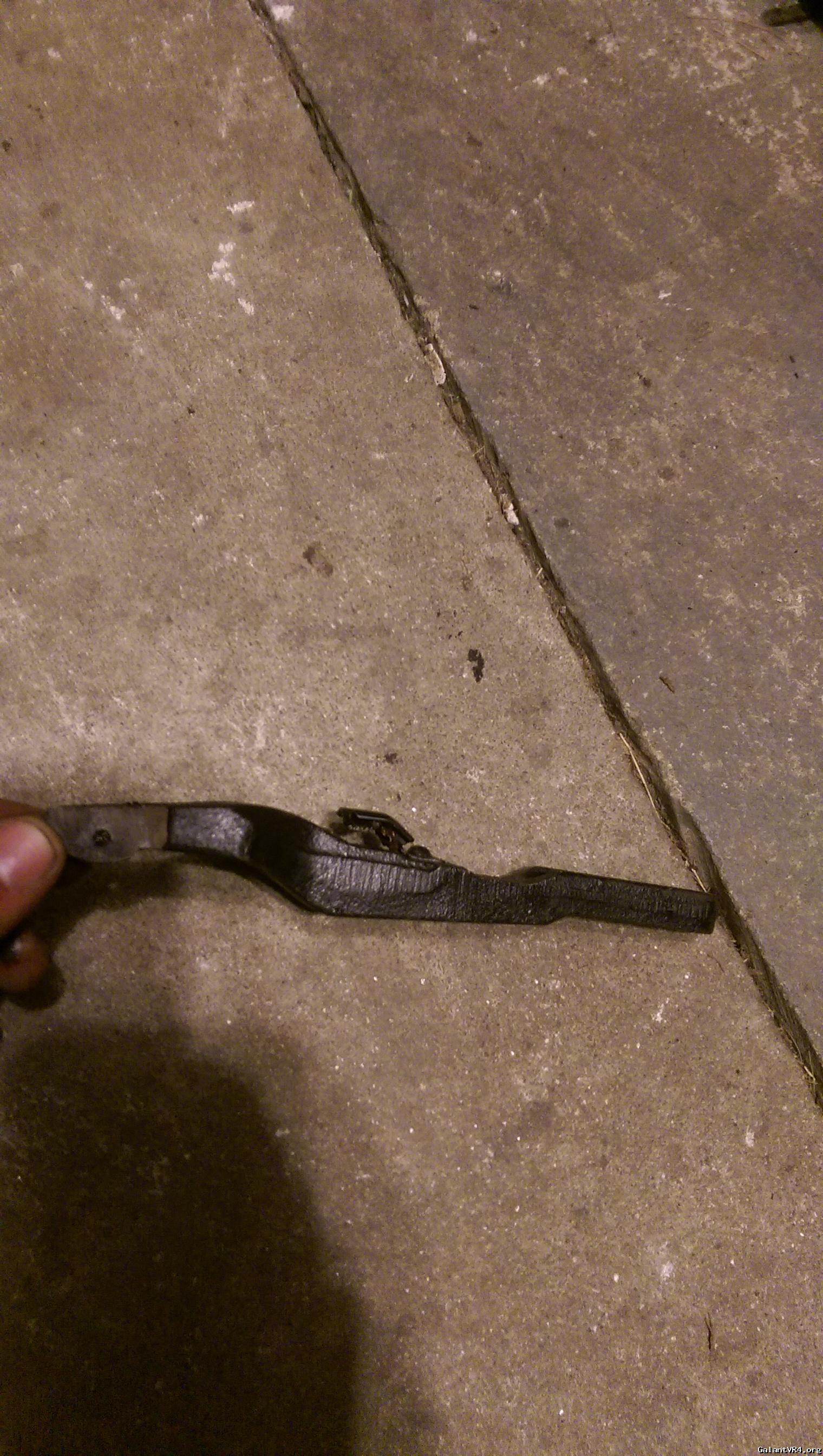

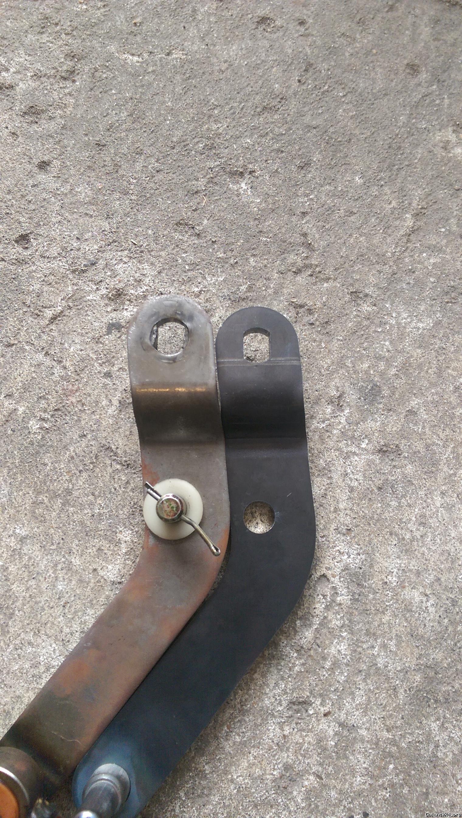

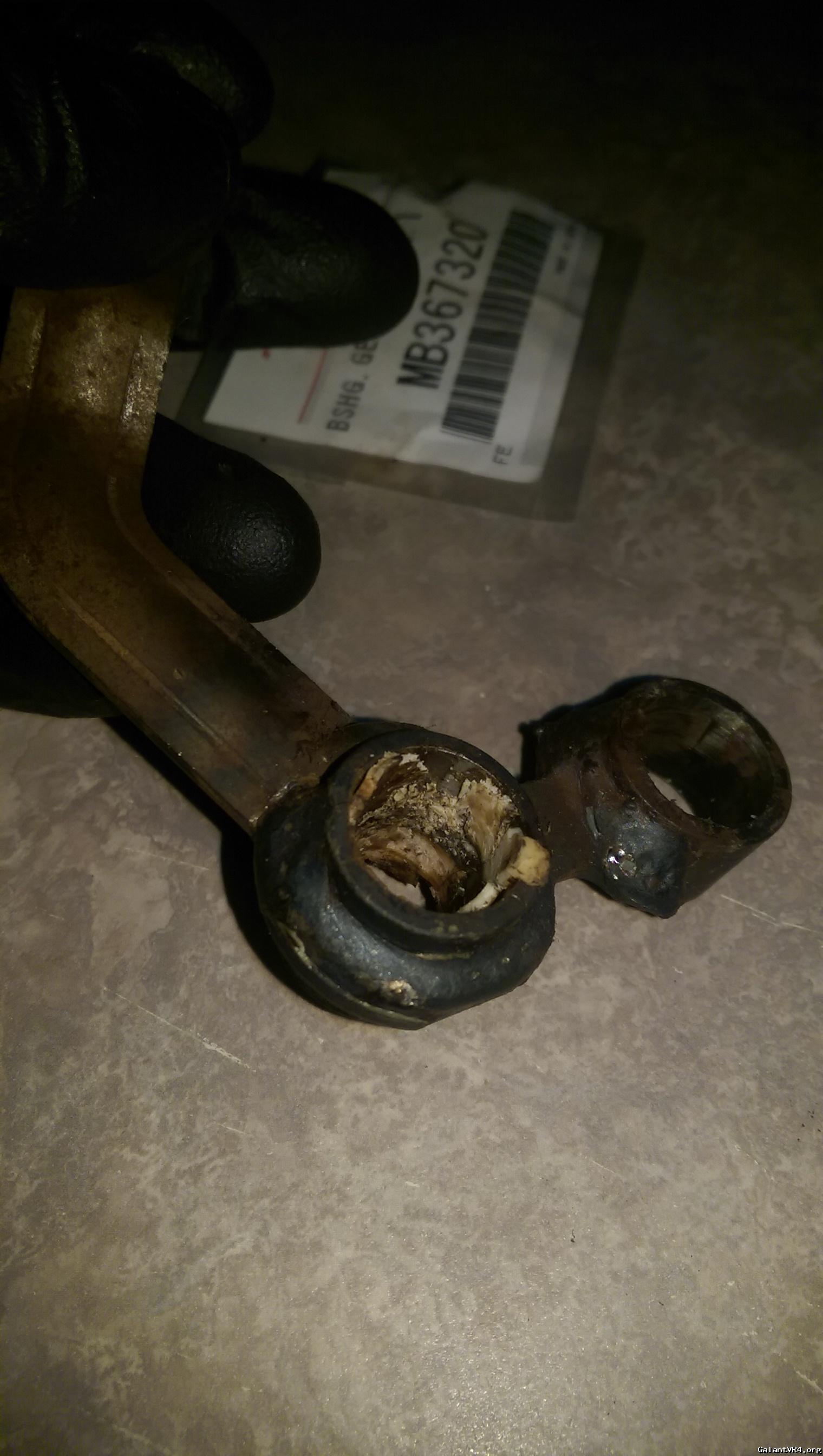

citymunky
Sep 22, 2010
1,761
Chesapeake, VA
Quoting strokin4dr:
That's them. Don't forget the 2 in the for the side to side (left/right) motion. Sounds like that is most likely your problem.
The lower arm was the worst off, looked like it was packed filled harden grease than plastic bushings.
I rebuild the rest of the shifter and I took the time to swap out that ridicules long GVR4 shift arm and installed the shorter DSM shift arm. Overall, this repair results where as expected; there is a lot less slop in the shifter. With the car not running, I'm able to get into 1st-4th gear no problem, I feel binding when trying to go into 5th and reverse still feels like a void.
