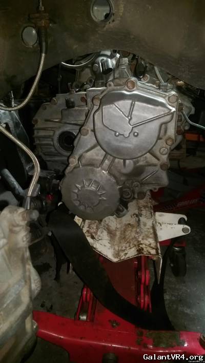

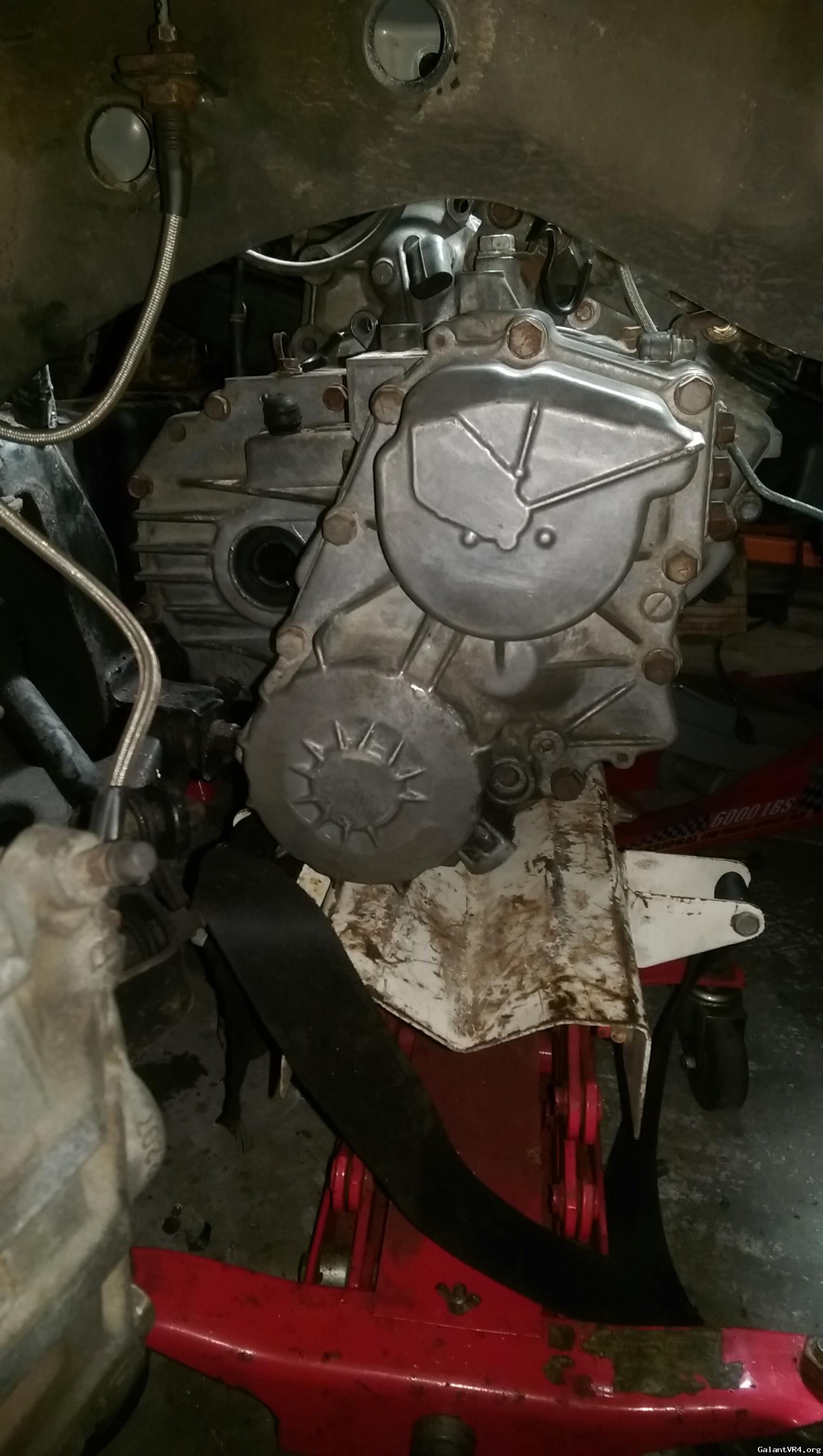

I was able to reinstall the Fidanza flywheel that came with 733. For the clutch I install the ACT 2100 instead of the ACT unspung 6 puck that was originally on the car. It later took me 2 hours of fighting with the tranny before I could get her bolted up.
I was having trouble with tranny hitting the subframe, I was only able to get it after undoing the front and rear engine mounts. After that it was a piece of cake.

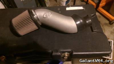

More parts.

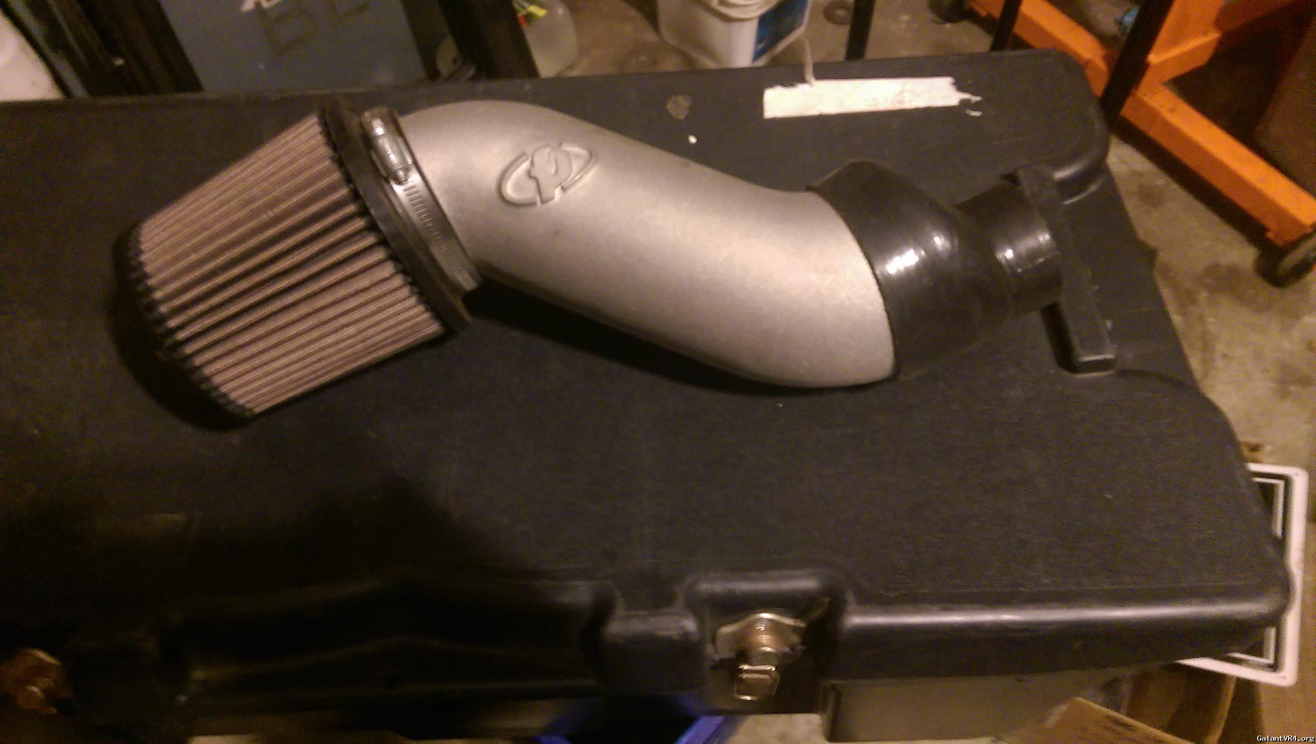

FP intake with K&N Filter to match the FP turbo.

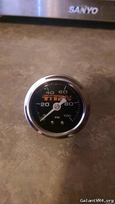

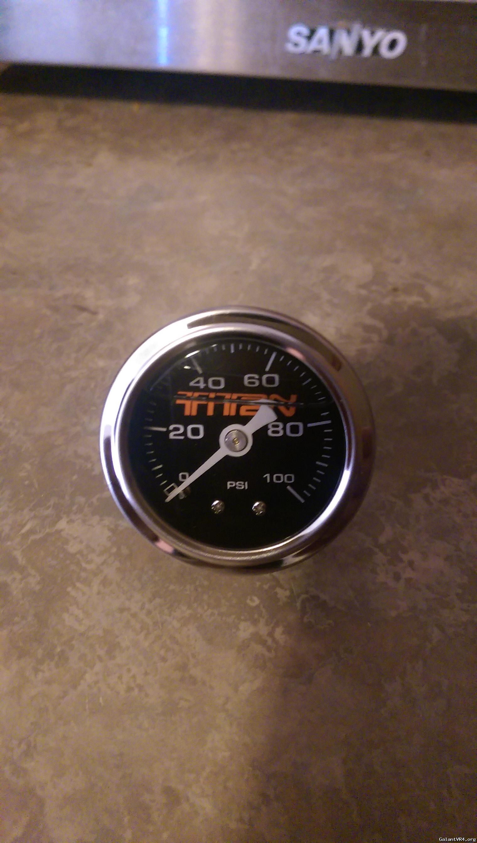

I also got a little bit of Supra for the Gaylant. My current AFPR has a electric presure sensor, but I don't the gauge to display the reading. So that was the only black face Fuel Pressure gauge I could find.

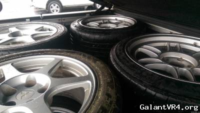

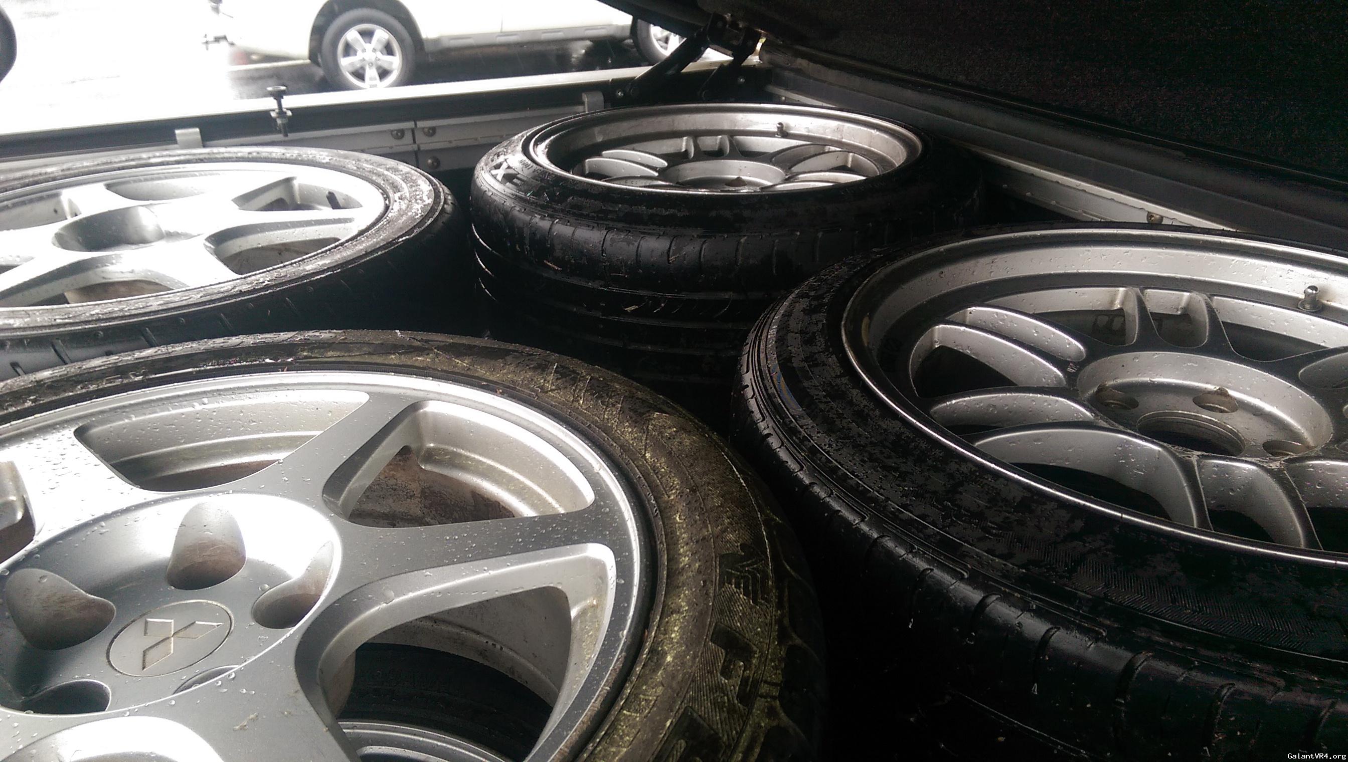

Picked up some new rims for the old girl this weekend for a killer deal.
I was offered the stock EVO 8 rims when I picked up a set of 1600cc injectors for a local EVO guy for the facebook page, he old girl was bitching about all the parts in his house. I told him, EVO 8 stockers are not my favorites but for the price I'll think about it.
The next day, he posted up a RPF1s, 17x9 +45 offset for more than fair price, I PM him asking if he is selling both sets of rims or just one set so he can keep the car a driver. He told me he wanted to keep a set, I told him I wanted BOTH sets. Next thing you know his EVO is JSB is his buddy's driveway and I'm driving away with a set of light weight quality rims and a set of rims for winter/backup.
Win, win in my book, now I guess I'm going through with my 5 lug swap. I wanted to find set of 4 lugs rims, it is so hard to find a quality set of rims in 4x114.3.
In other news I done some work to the car today and I'm very close on getting her ready to turn her over for the first time in over 10 years. For the time being I give up on getting the car perfect, I realized I will never get nowhere. I hope to have this car on this car on the road soon running a stock setup for now and build the other motor on the side.

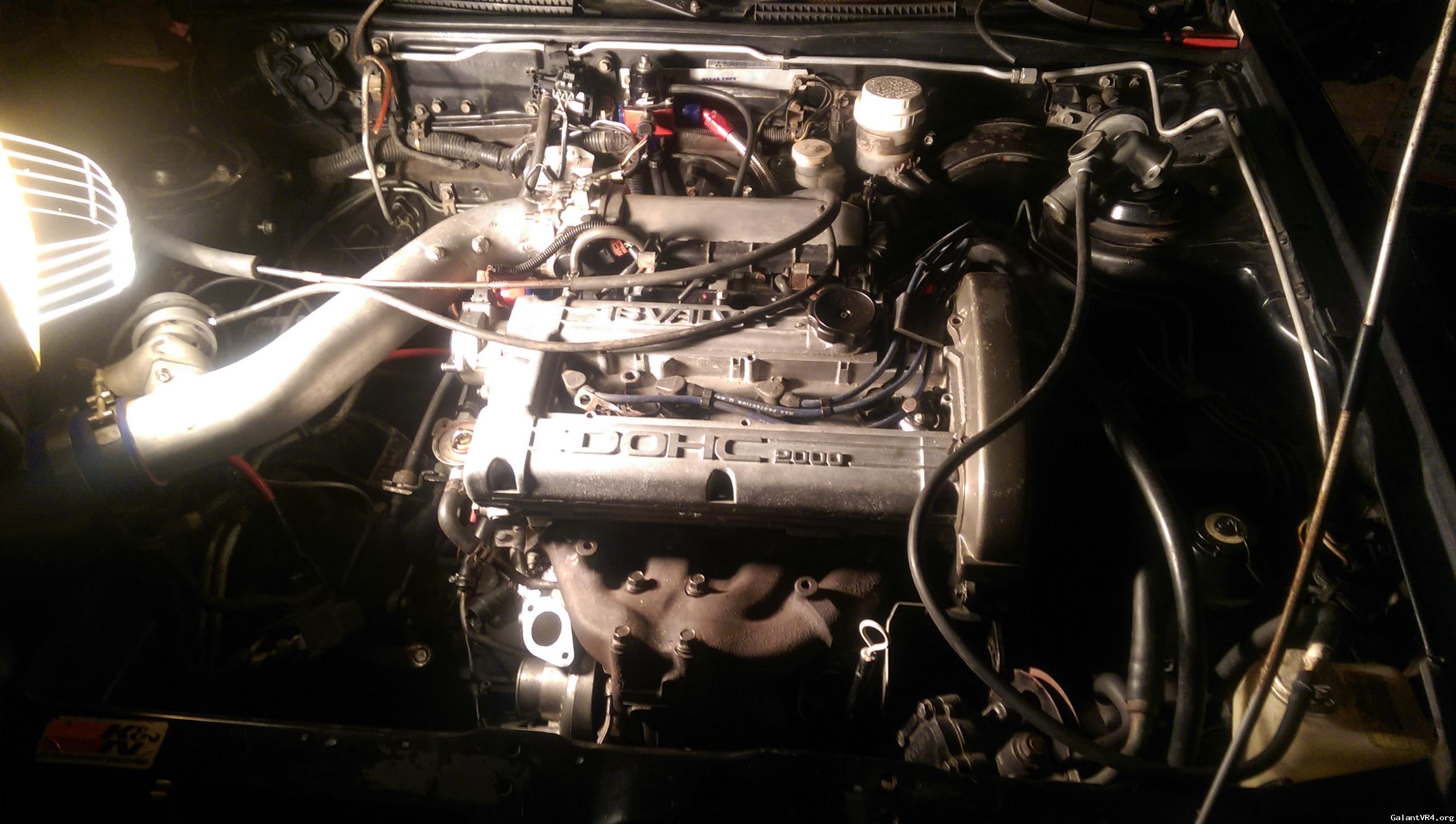

Quick update, I installed a stock EVO 9 fuel pump and I was able to get her started for the 1st time in over 10 years!! /ubbthreads/images/graemlins/bawling.gif On a different note the A/C blows colder air than my new cars.
The car still needs some work to be road ready, but at least she runs!
My current setup is as follows:
-Stock Long Block
-2G Exhaust Manifold
-Small 16g
-450cc injectors (just for break in)
-Aeromotive AFPR
-Custom Intercooler setup
-ECMLink V3 full
Everything seems to be working fine, beside the DTC 0012 Check engine light I have.
Things I still need to do:
-Fix driver's side front sub-frame mounting stud treads (Tip and Die kit work)
-Wire in stock fan, I used the stock fan jumper harness to the my FAL fan and I don't want to use the FAL fan until the other motor is done.
-Bleed clutch slave cyclinder
-Check Tranny, transfer case, and diff fuilds
-Fix small leak from turbo oil return pipe where the flange meets the oil pan
-Install carpet and interior trim
-Bleed brakes (and hope they are not seized!)
-Fix fuel pump wire ( it was cut 1/8" in front of the connector")
-Fix the one ECU wire.

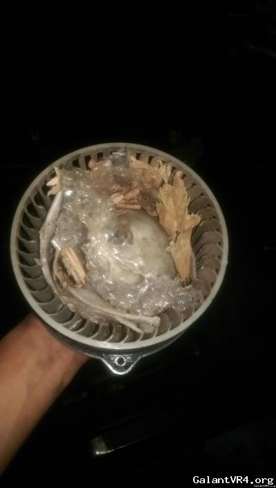

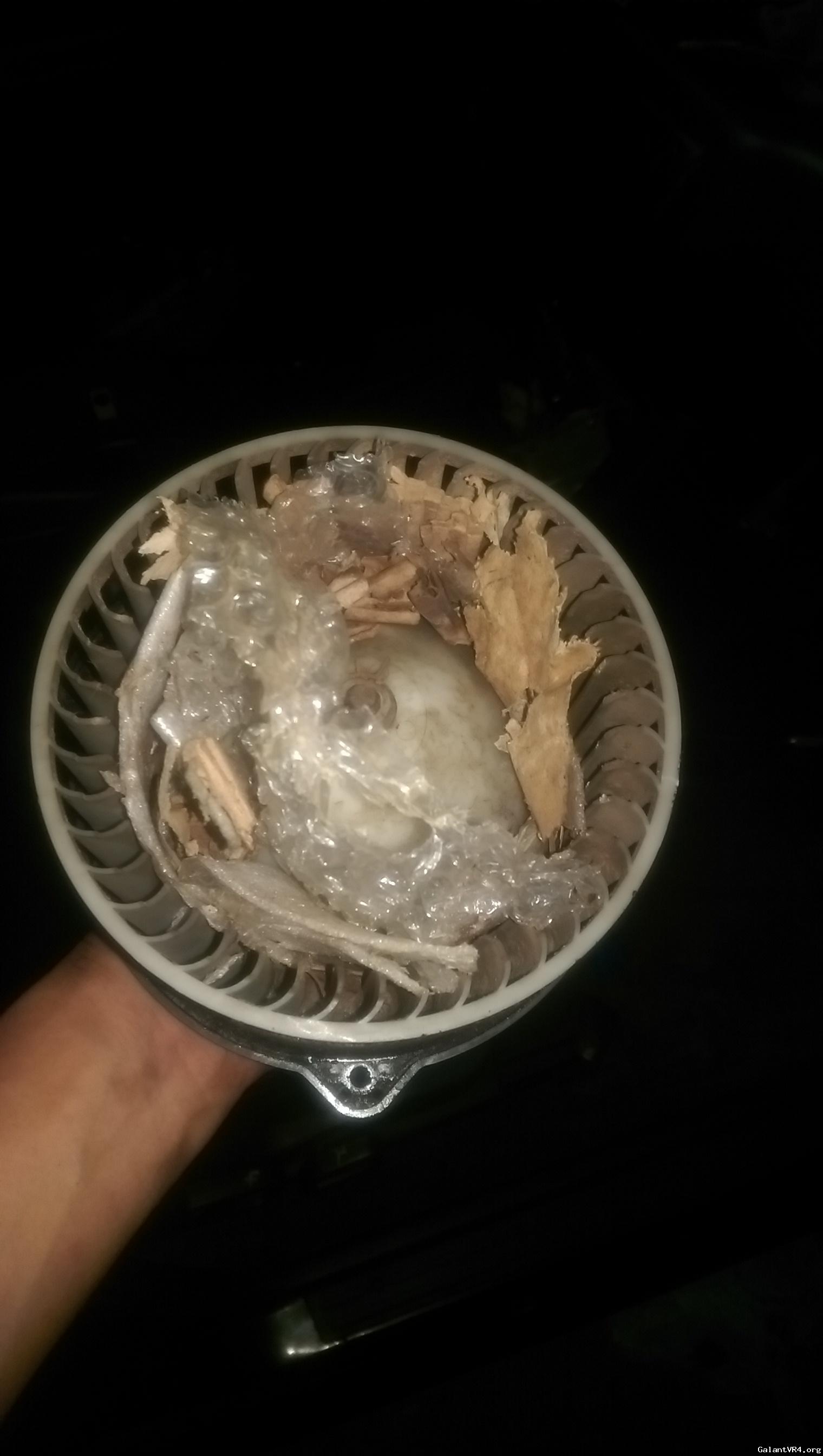

So I repinned and fixed the fuel pump wire, and ecu wire. I installed the interior and the trunk carpet and trim.
I also cleaned out the HVAC motor, that sh*t was gross and smelled like death.
I must have removed a trash bag full of that sh*t from under the wiper cowl.

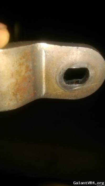

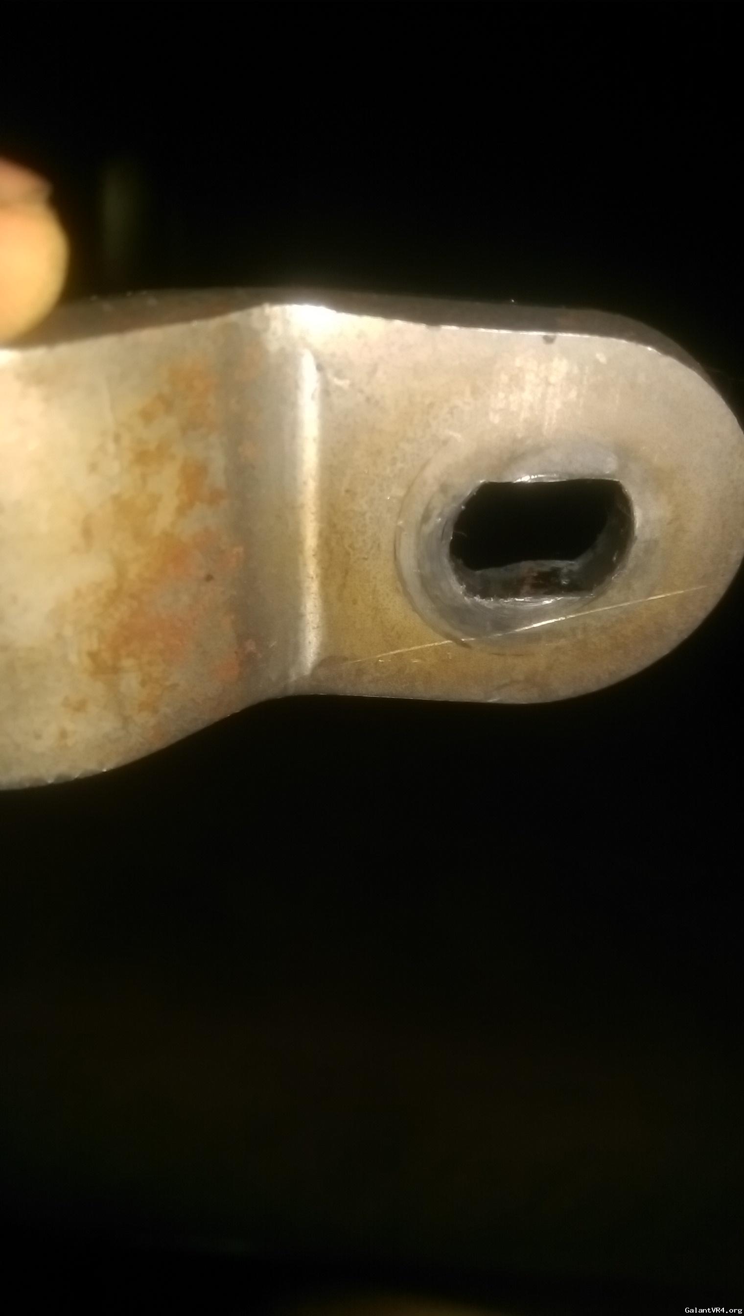

I think I found my sloppy clutch problem. This is the clutch fluid lever, and it's almost rounded out. Also the bushing for the pivot pin that connects to the clutch master cylinder was all worn out. An order has been placed at JNZ, I hope to get the parts in by the weekend.
