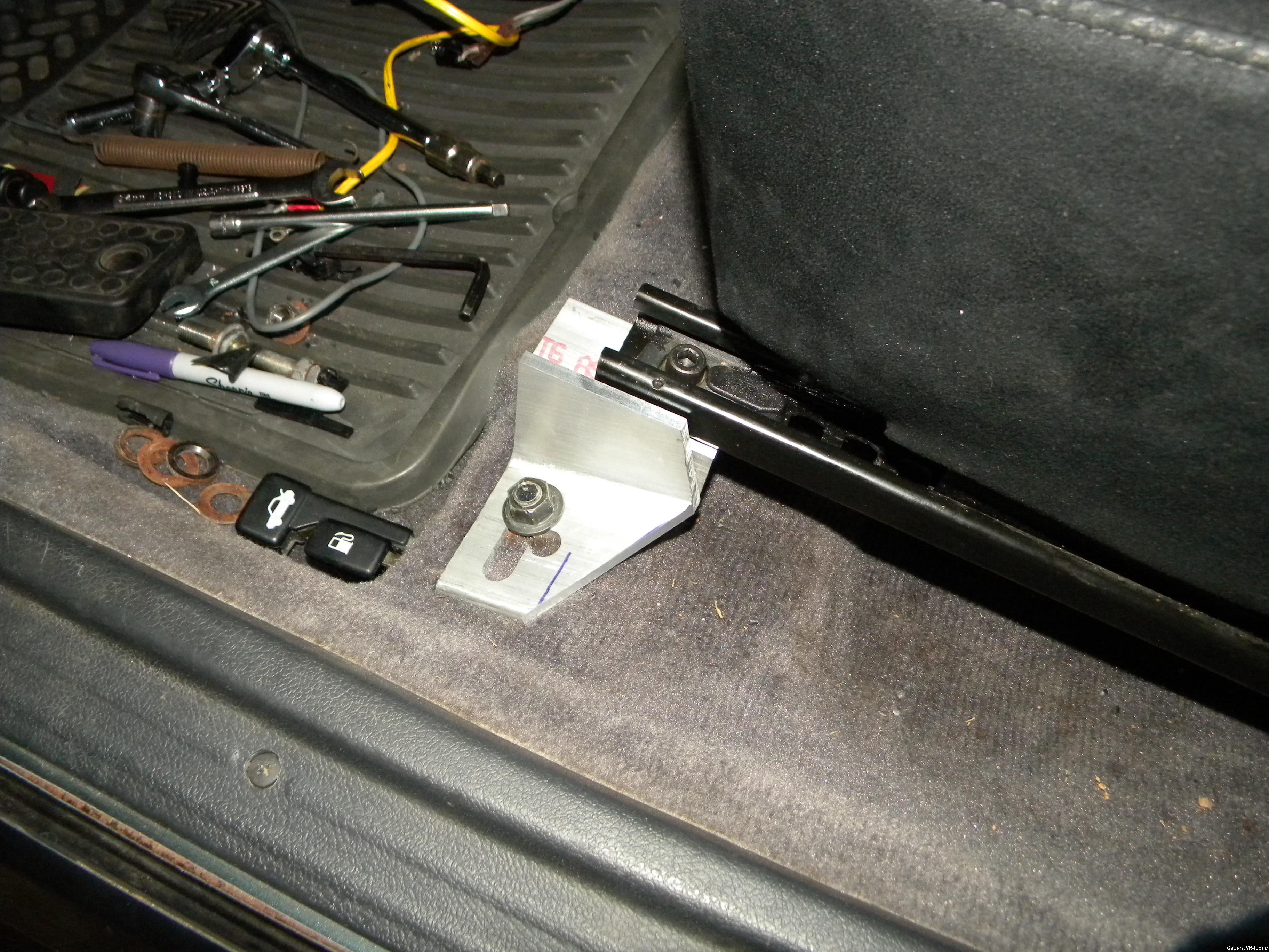

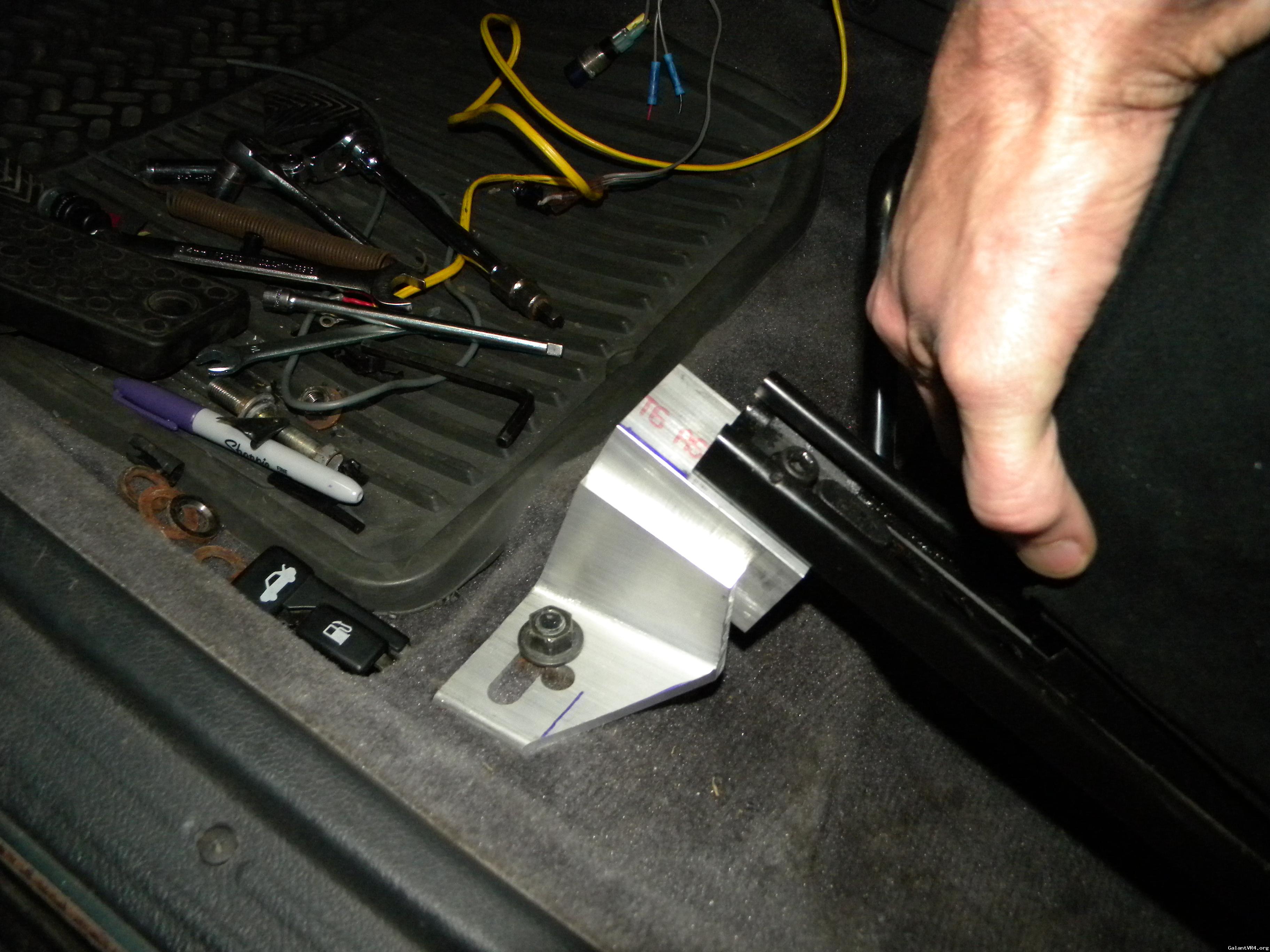

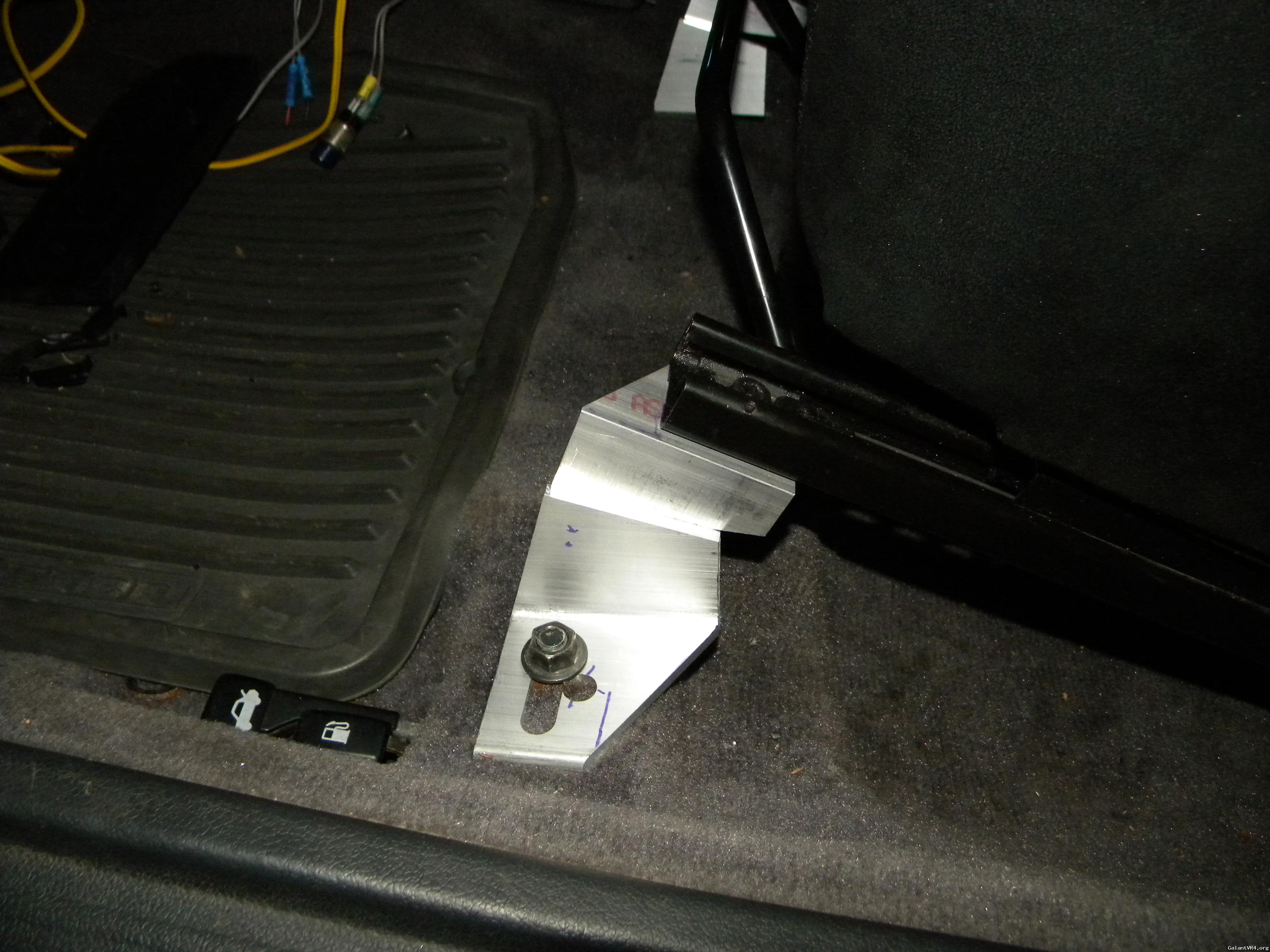

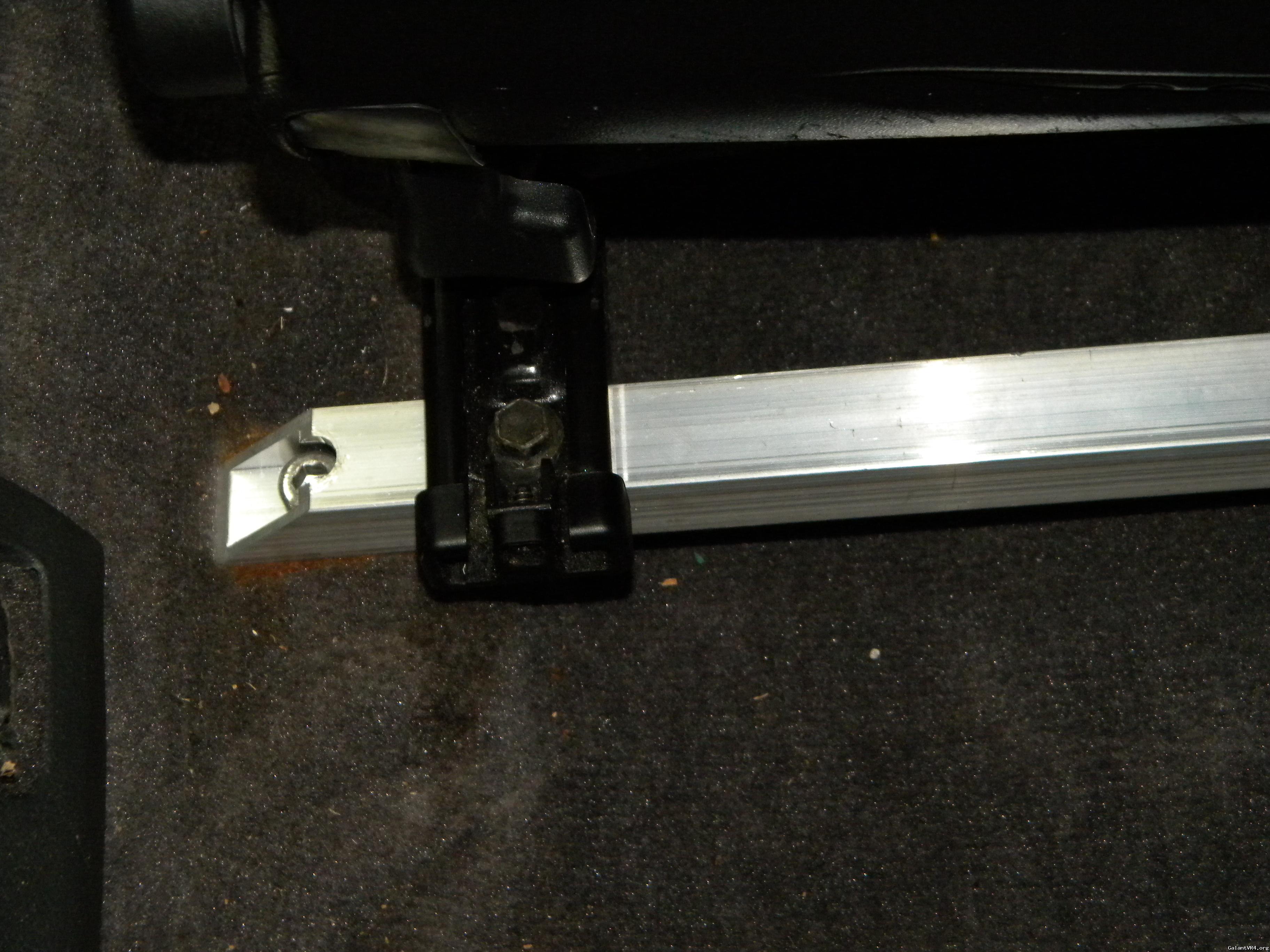

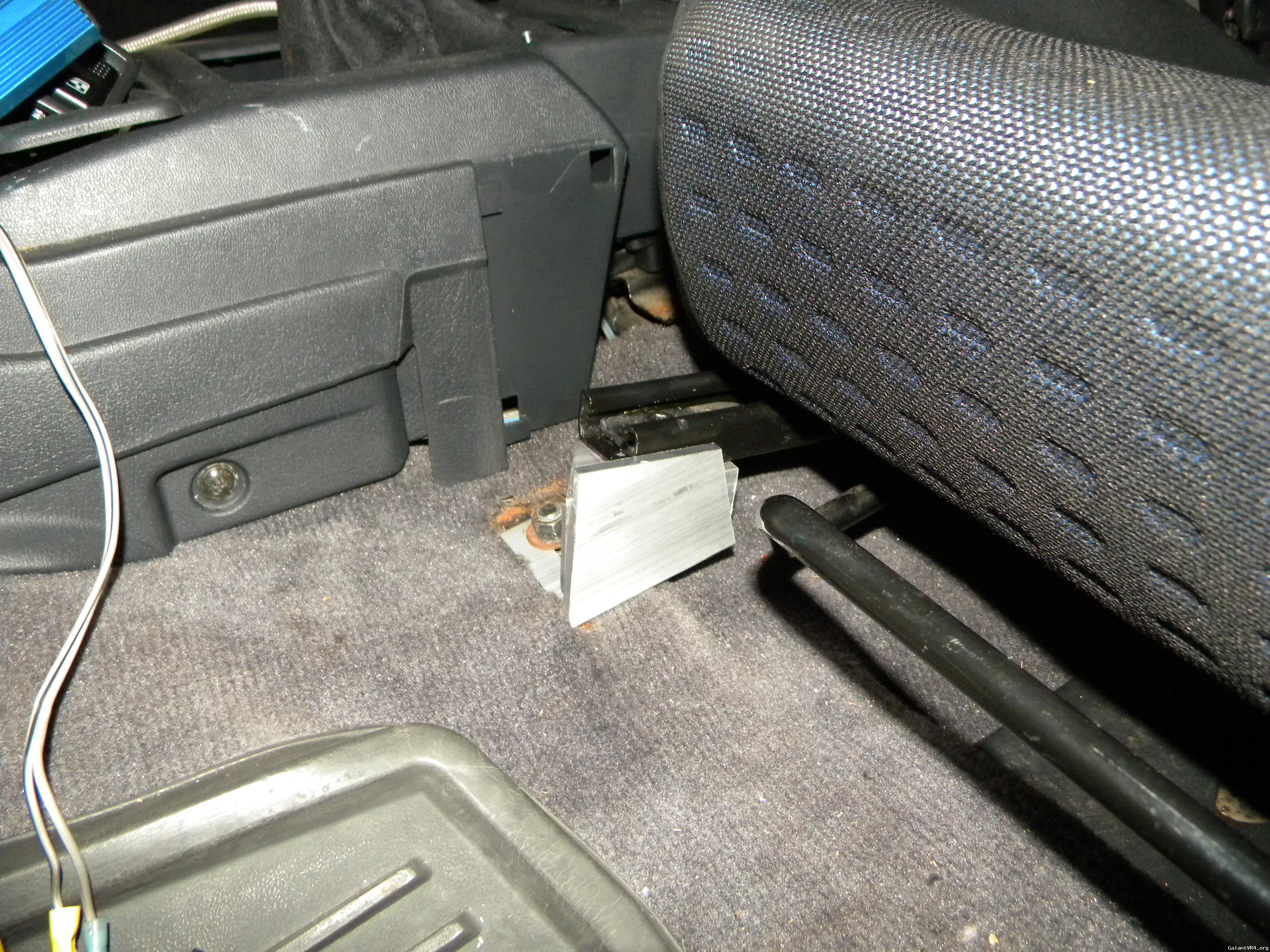

The test prototype rear has the slots for the seats now and mounted. Got all the measurements and doing the autocad drawings now.
Here's some tease pictures

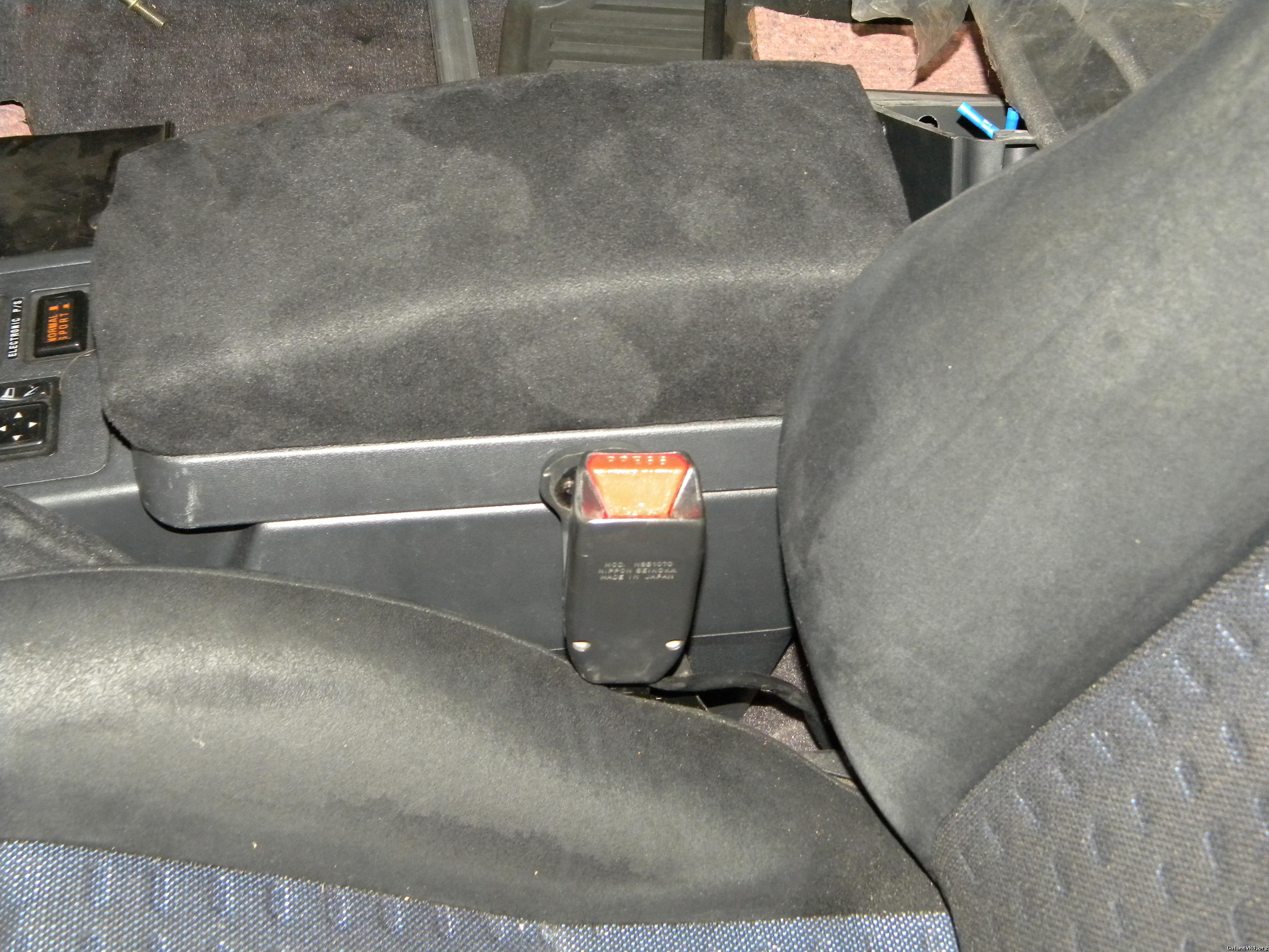

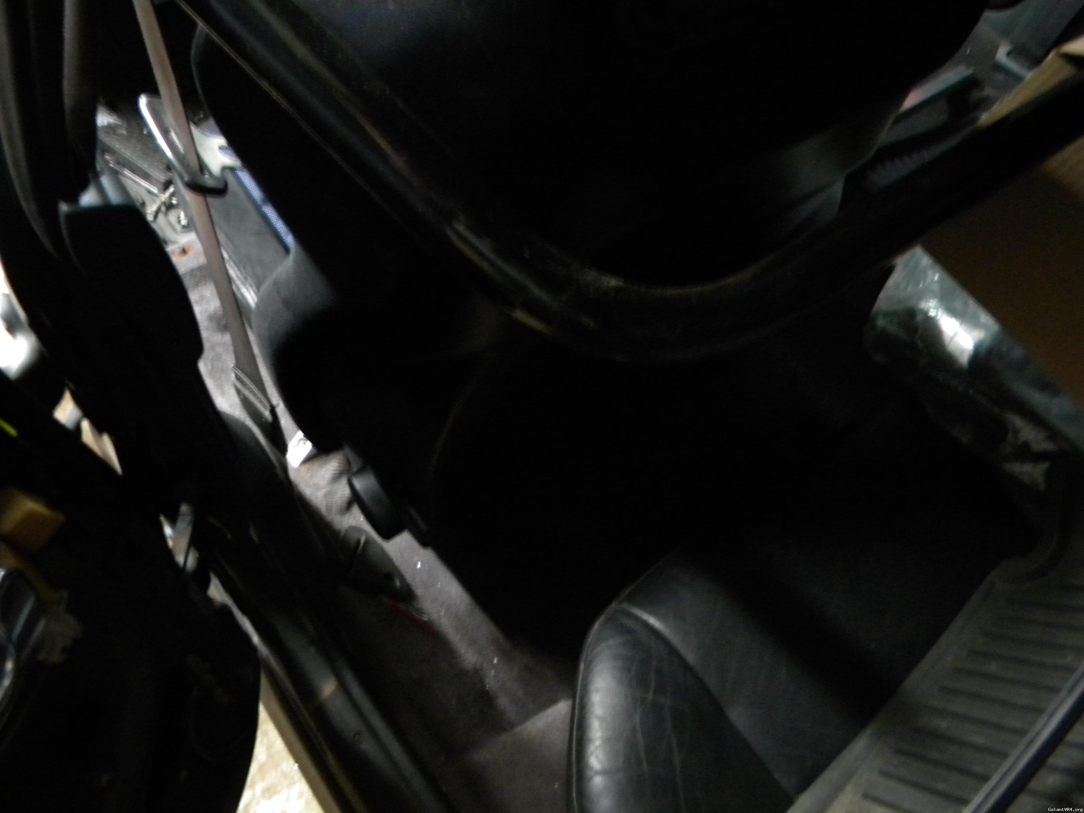

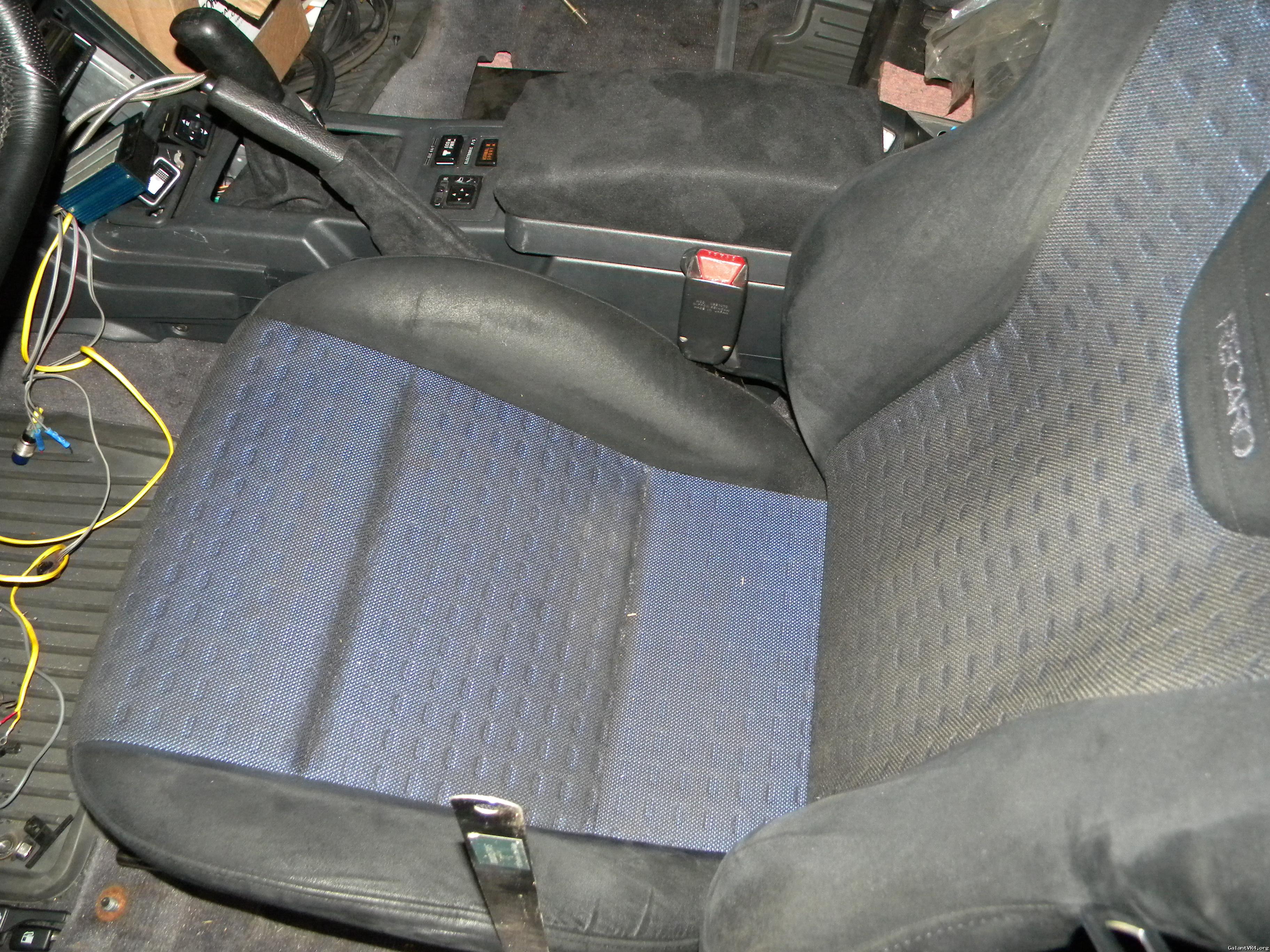

Idea of where all the way back sits, seat back is in normal driving position
Inside corner drivers side
Outside corner drivers side
All the way back with harness bar

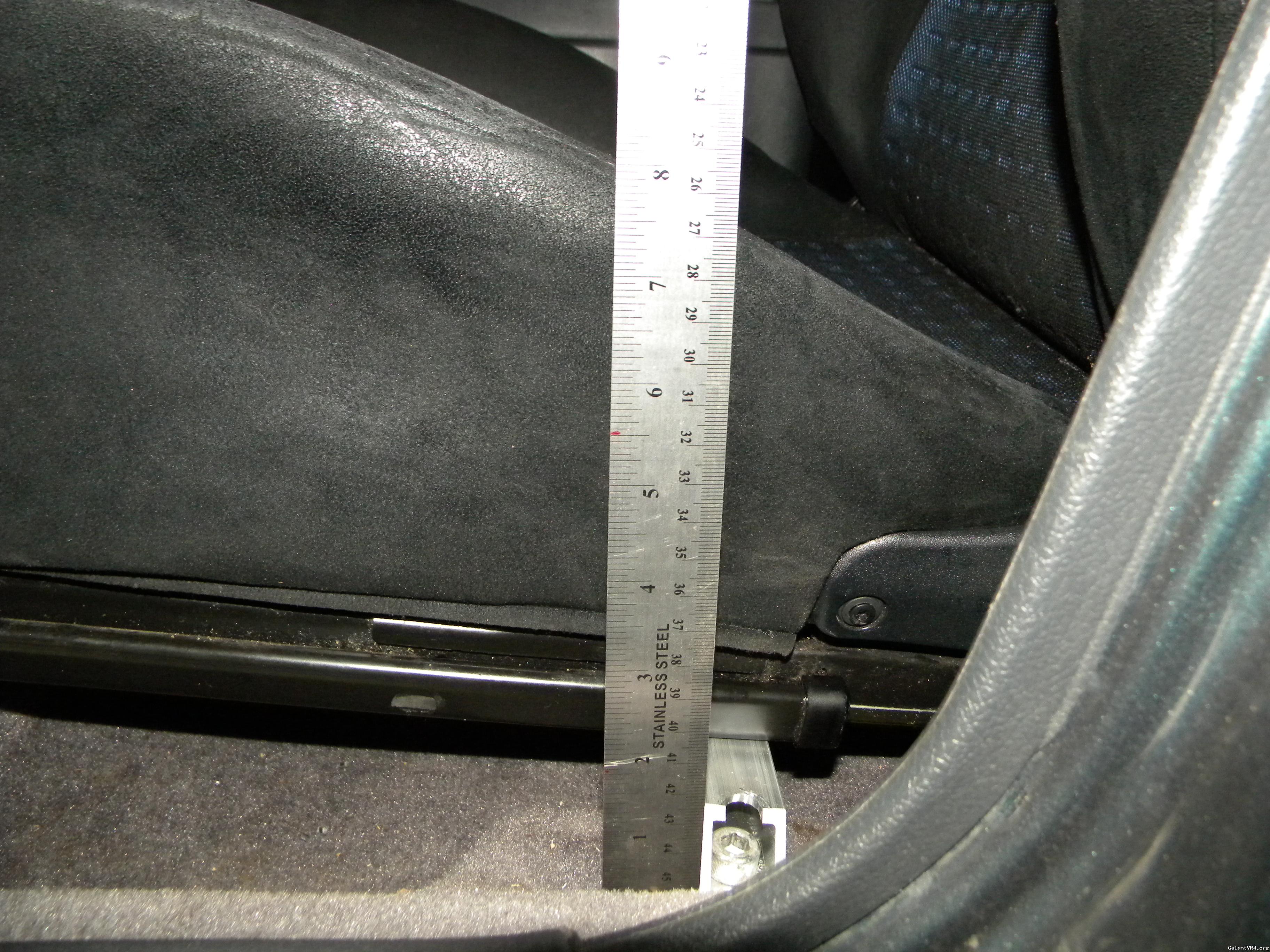

Install height edge of bolster is 8 inches up but the blue center area looks to be about 4 to 4.5 inches up from the mounting point . Did this to give you taller types an idea of head room with a helmet and a lower CG for the guys like myself that likes curves.
I sat in it without any front brackets and had about 5 inches between my head and the headliner and I'm 6'0" and my car is a sunroof car.
All for now. I have to get the seat back to Vinny by 5 tomorrow so got to do work son. Later

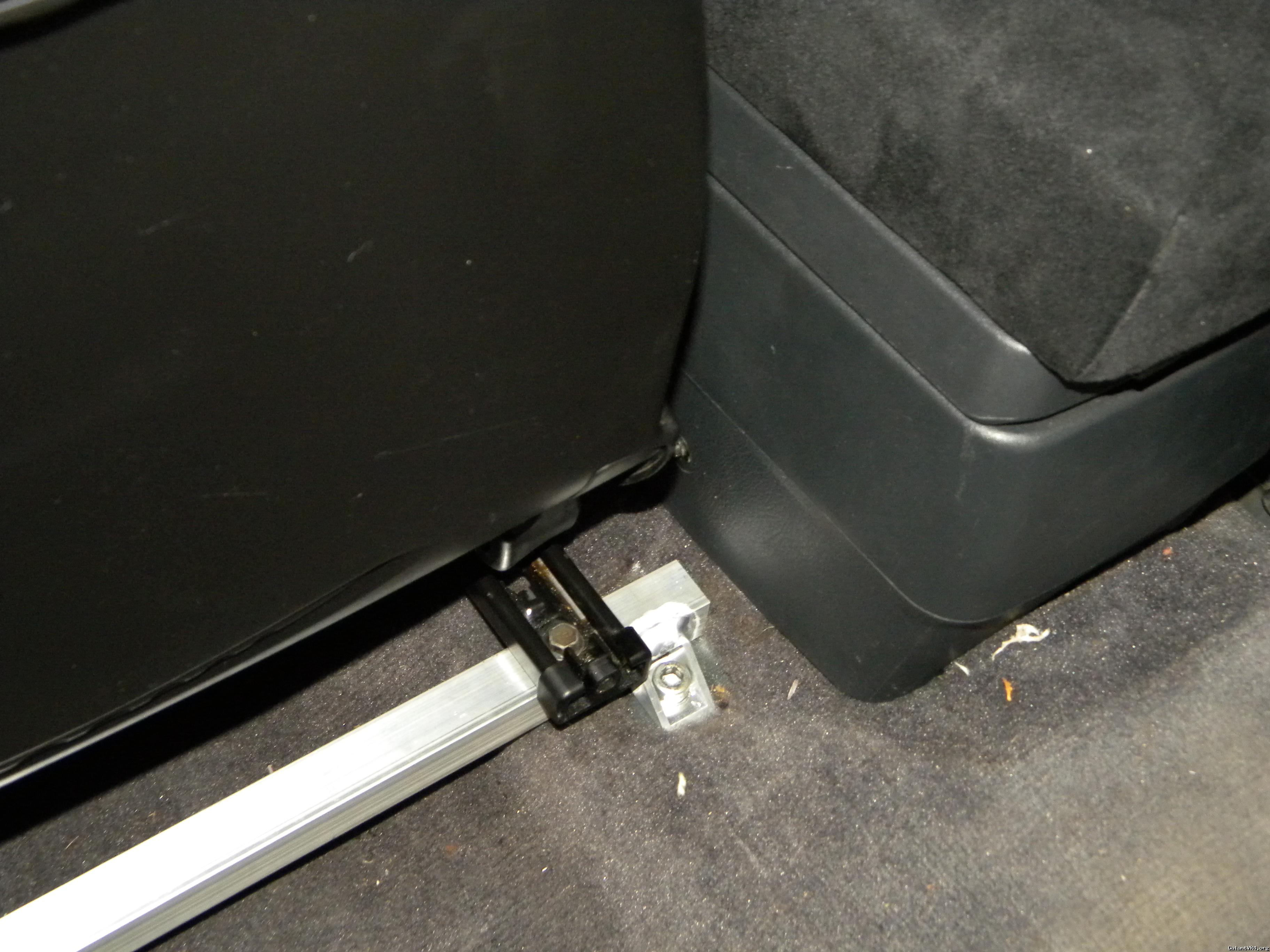

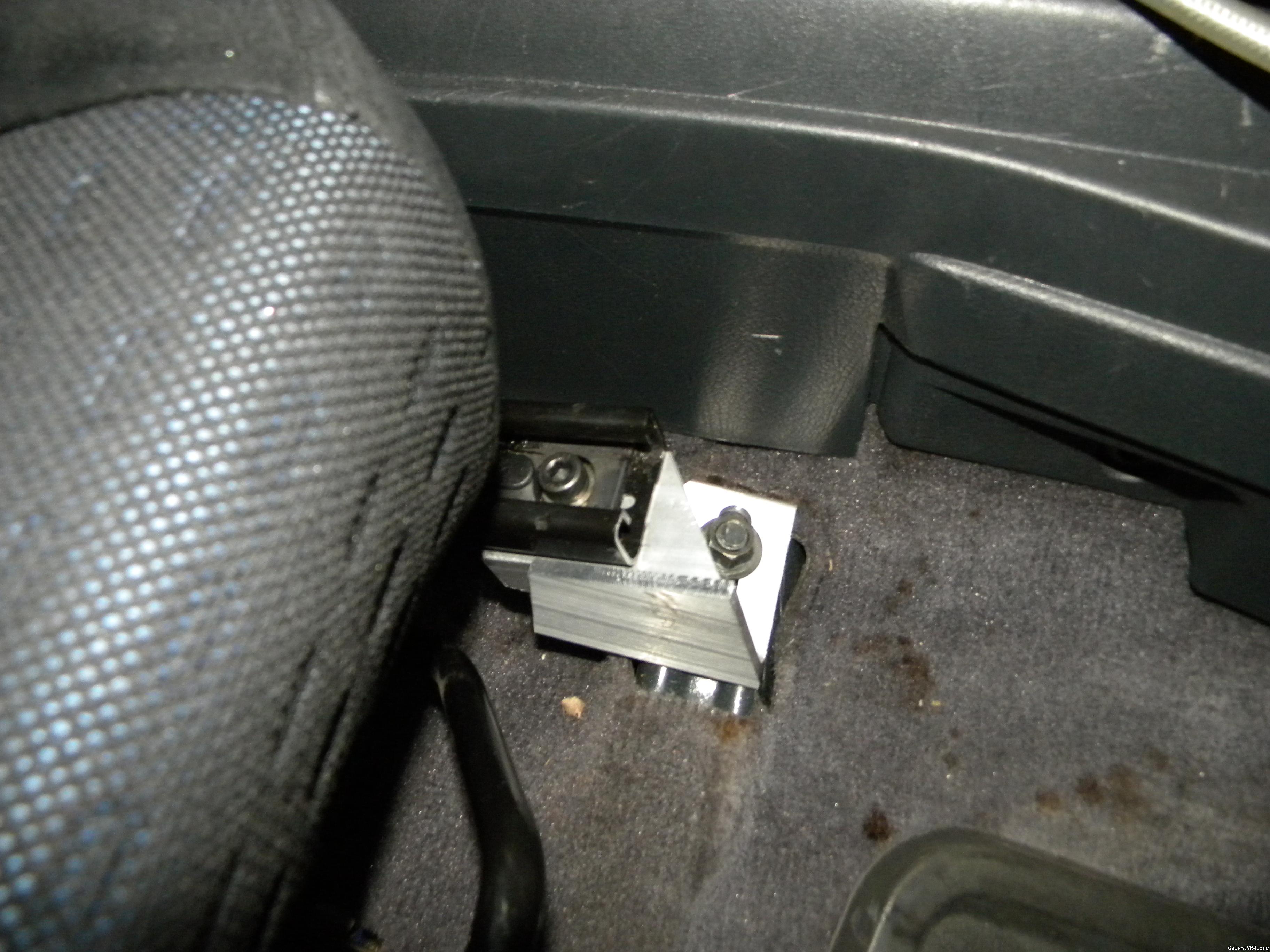

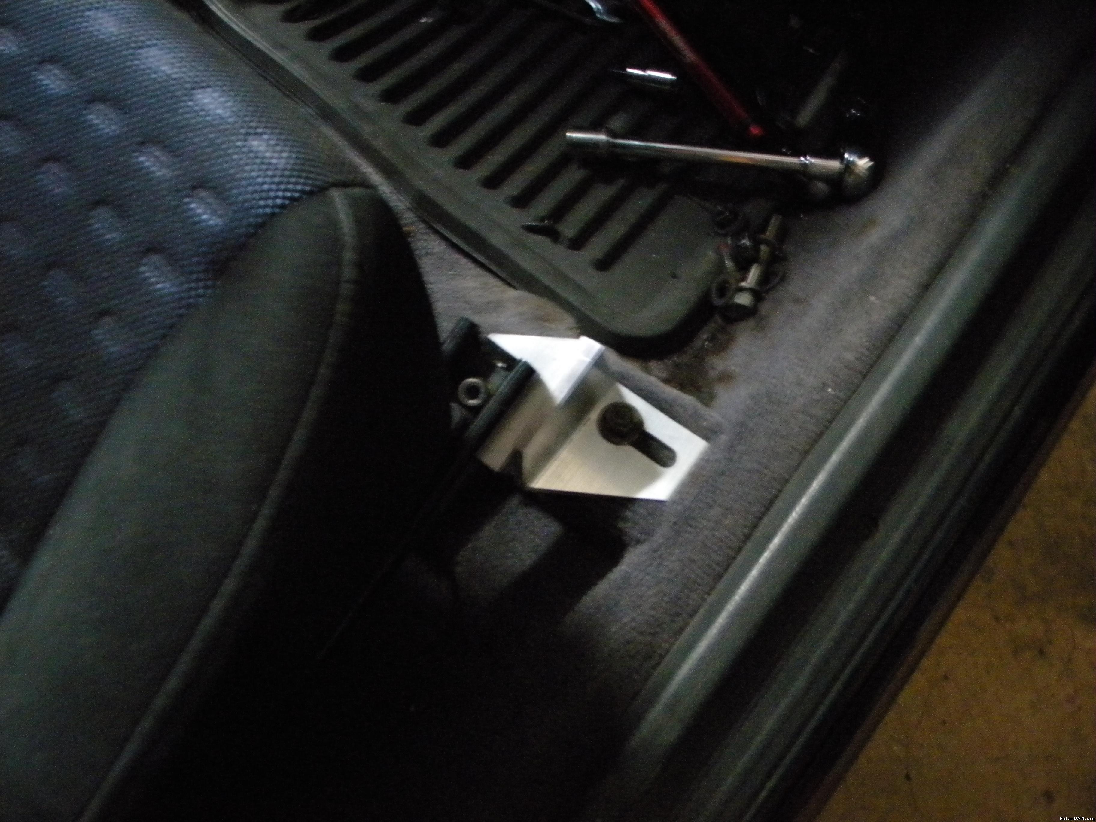

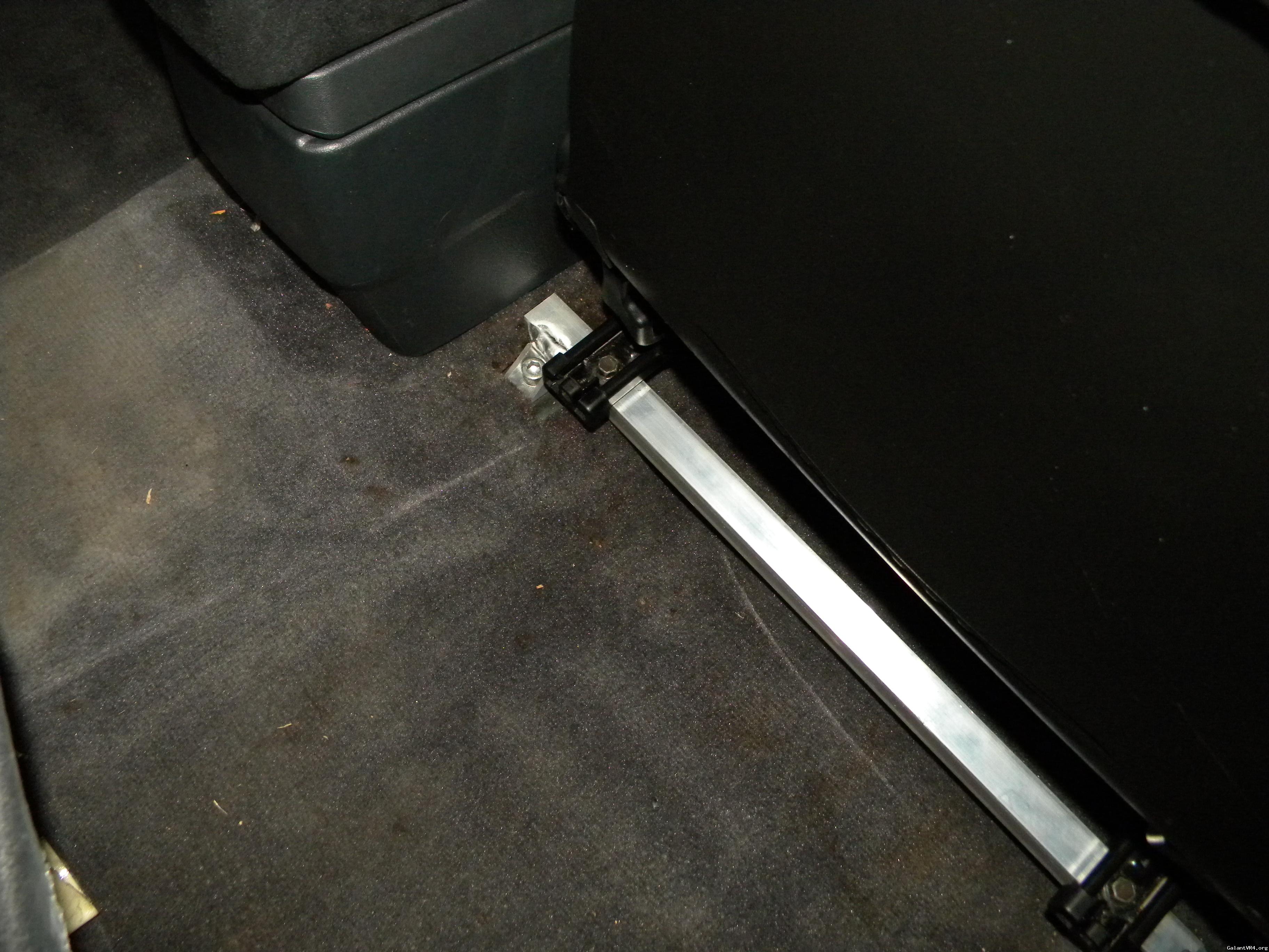

Prototypes are done for the front on both sides. Both seats slide beautifully and with zero effort all you have to do is pull up the handle and they slide. No interference from any part and will be completely plug and play. Except for the angle that's driver preference. After seeing them in the car and how they match the headliner, armrest and shift and e brake boot I may have to pick a set up but I really want the leather ones. Going to the car part swap meet tomorrow then watching commercials tomorrow night /ubbthreads/images/graemlins/grin.gif
I may come down tonight and start on the machine code to cut the brackets. I have to finish the drawings and draw it up in such a manner I can cut the 4 rails for the seats all at once then flip to the opposite side and run another program Then I'll do the same on the floor brackets. Better that way that chucking up pairs or singles. Singles would be 1088 times of zeroing the part to the mill and running code.
I lack 132 slots on the rear rails then 264 slots for the fronts and all the cuts around both sides of the angle so a few days of running the mill. I know you guys are ready for these and I'm trying my best but there's a ton of cuts with this.
drivers side
passenger side

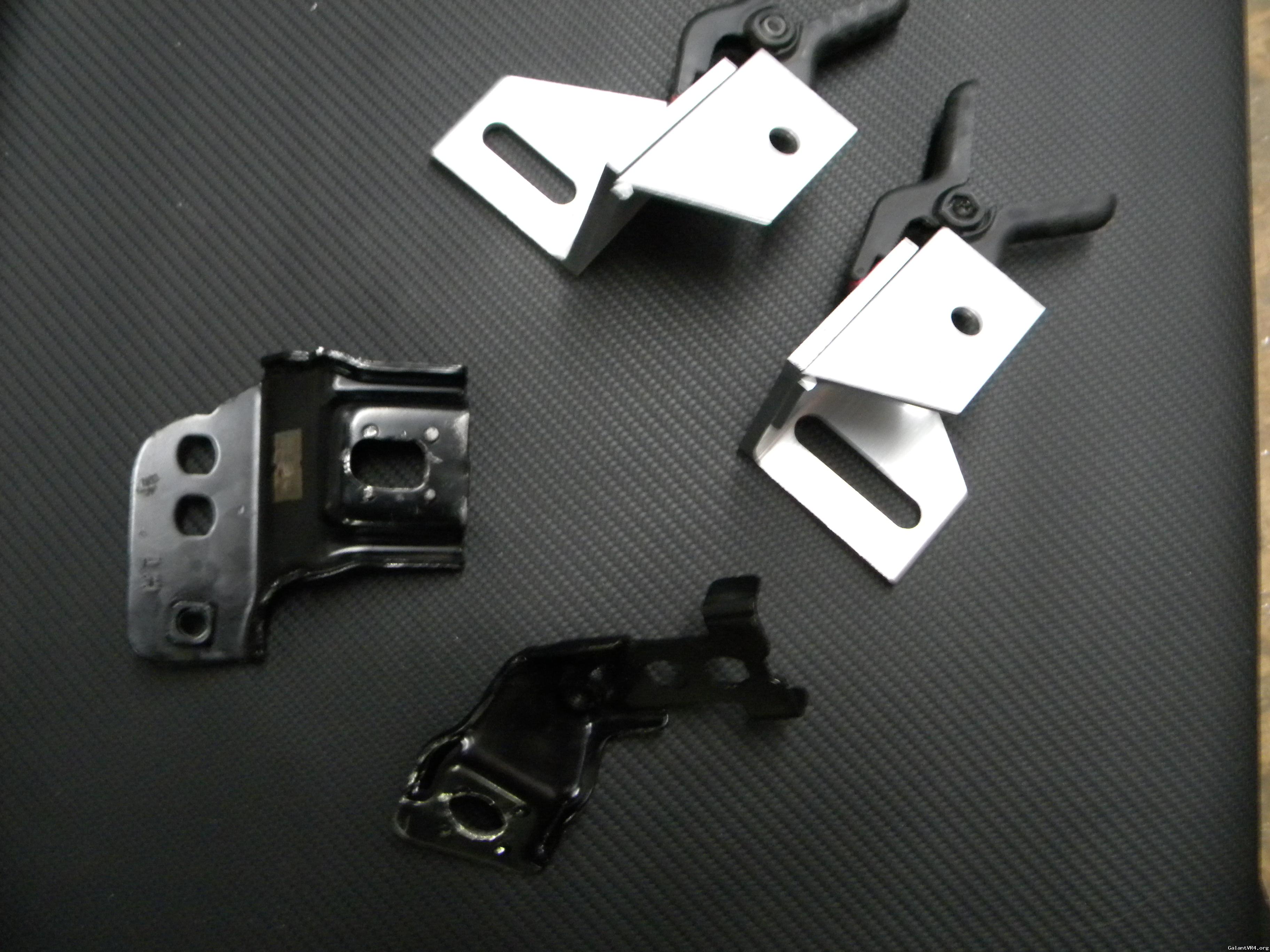

Mine compared to the factory evo tabs we used on Vinny's.

Well mother nature dumped more snow which in TN means no school and me watching kids but I did get all the slots in the rear bar finished about 30 minutes ago and a bunch of the code is done for the front brackets, Hopefully I can get done tonight / tomorrow and start cutting the front stuff.

Hill think about who's building these. /ubbthreads/images/graemlins/grin.gif I located the slots in the rear bar by moving the seat over to the center console to as close as I could with still having a small gap so the seat had no way of rubbing and to also center the seat on the wheel but also thought about the location of a cage during all of this. Your in business so don't worry they'll fit with your cage. /ubbthreads/images/graemlins/grin.gif

The set will include the long aluminum rail in the back that has the tab welded on and the slots cut for the seat then up front will also include the 8 pieces of aluminum angle to mount to the floor and to the factory evo rails. I just got finished with the jig and starting testing code now to cut these pieces.
