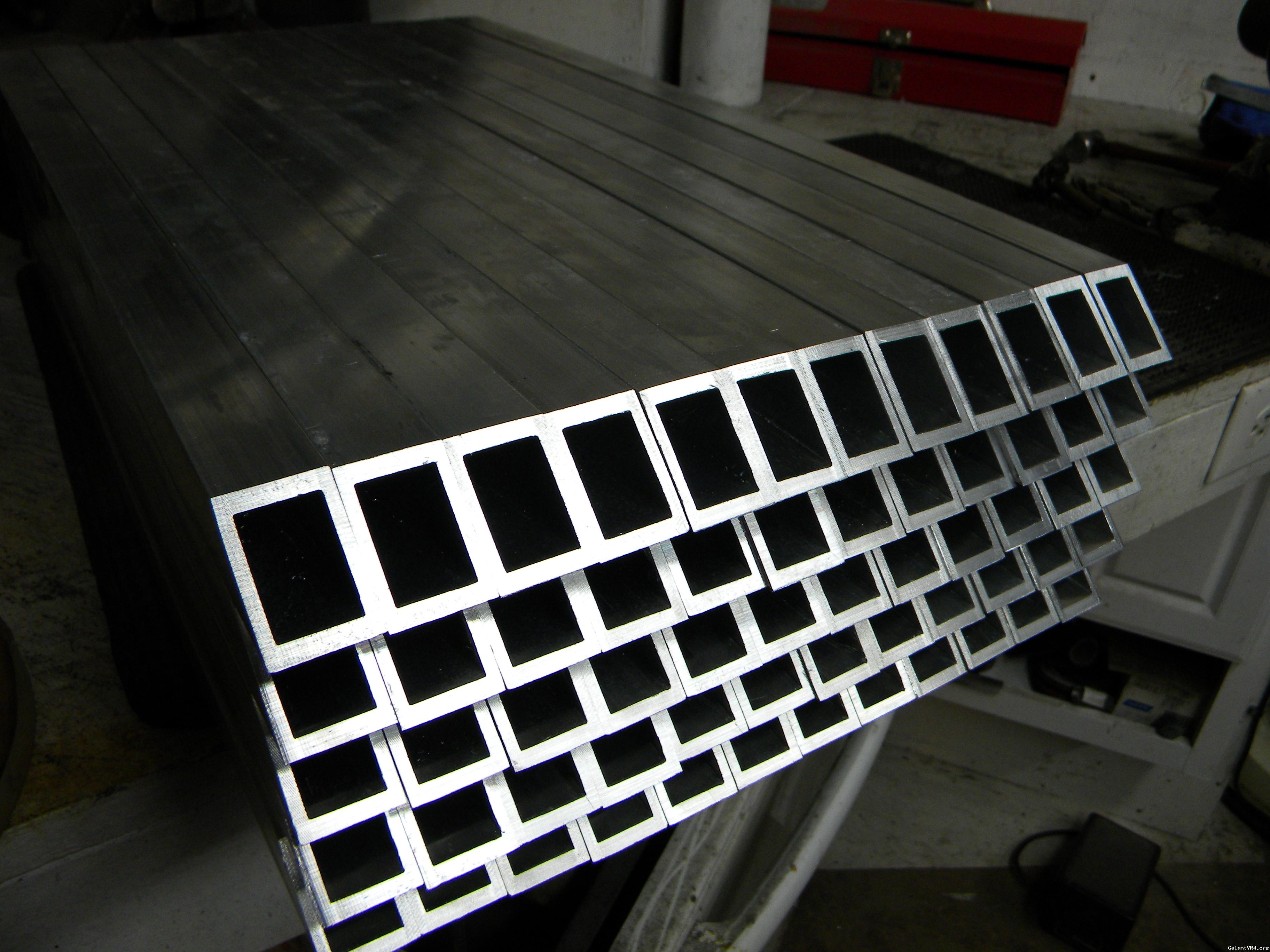

Angle is on order and the square tubing is in the shop. I went ahead and bought 120 ft of it. Probably start cutting to size and milling the ends this week. That's all for now.

Tiffany from the metal supplier called at 4 today and the angle is on order but has to come from another supplier and want be here till next week.
I was ordering aluminum 2.5 angle and 3 inch angle 1/8 inch thick. None of there suppliers can get it anymore since its not a very common item so I had to move up to 3/16 its double priced but she said she's giving me a deal on the 1x1 square so I'll eat the extra since I have so many wanting these.
Now I bought enough 1 x 1 for 30 sets of seat brackets. The way I'm building these they will work for evo seats and probably any other after market seat on the market if not it want take much to modify the front brackets for anything to work in the car. This price is good on this run. Its alot of set up on my mill and different cuts and welds and I want be doing another run because of the amount of work verses the cost of materials next time.

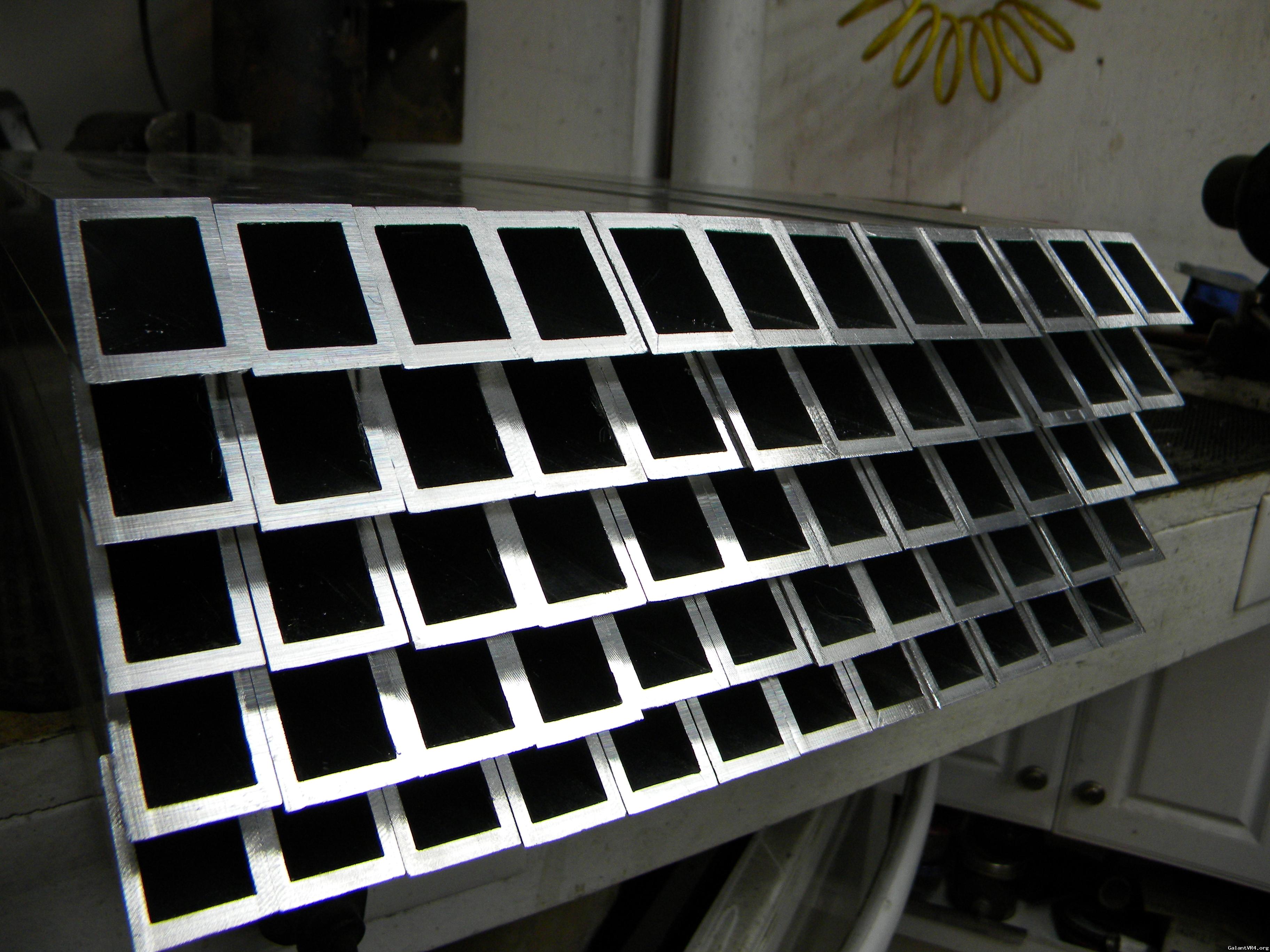

Ok cutting stuff on the mill today and Garfield just sent a PM asking if I wanted a set of evo rails to use so this is coming together finally.
With the amount of set up for each step I went ahead and cut all the 1 x 1 I had so there will be 30 sets produced, easier to do it now than later. We're now at 19 sets claimed and 11 open sets. Thanks Curtis

Progress
The end next to the driveshaft tunnel is a straight cut and its milled and pictures show the end next to the outside of the car. So the big ones are ready for the mount holes to be milled and the bracket for the inboard rear mount that isn't lined up perfect. Thats all for now. Have a turbo to mod tomorrow for Milton and somemore stuff to do but hoping I can get all 60 tabs preped for the inboard.
