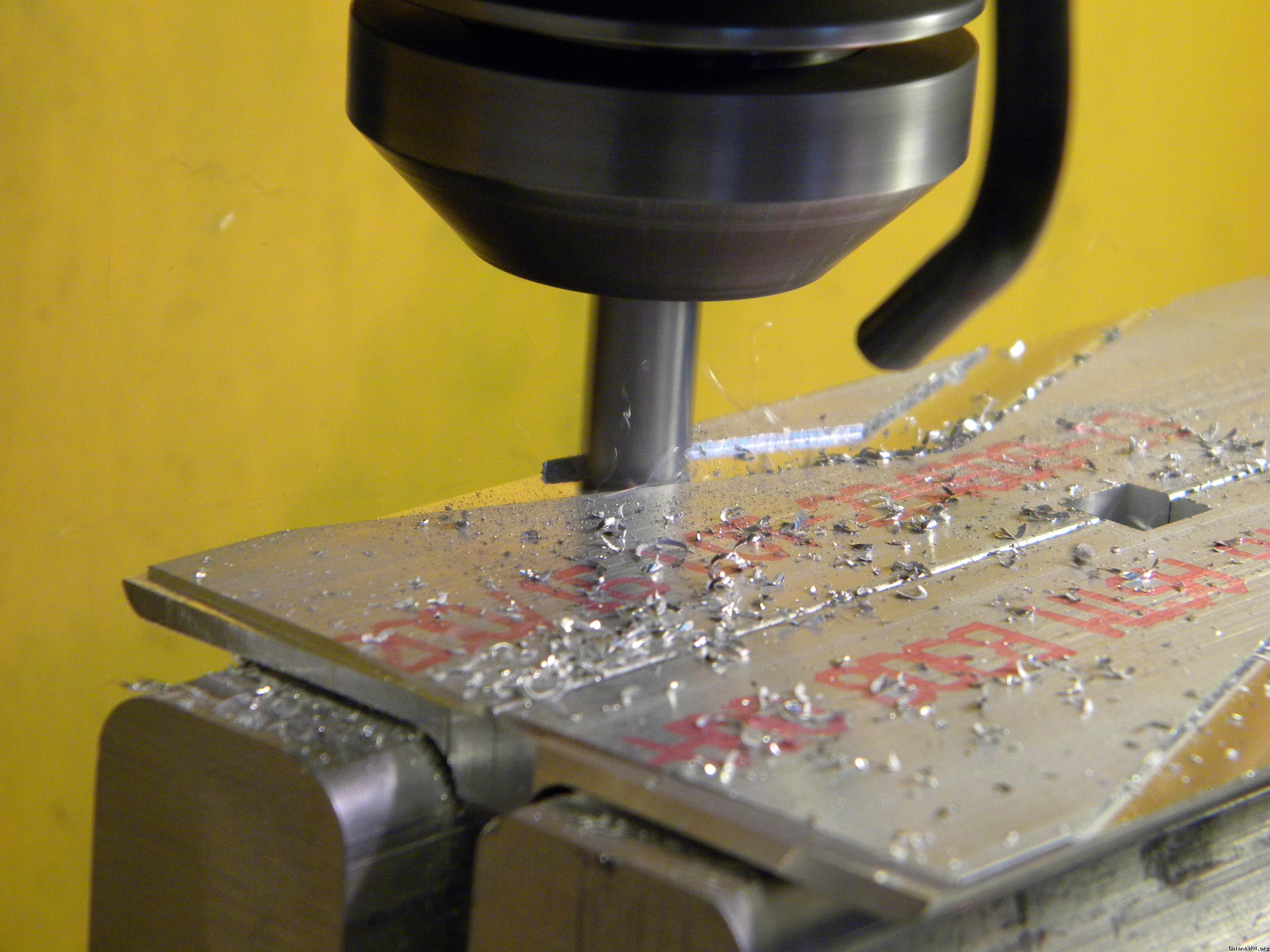

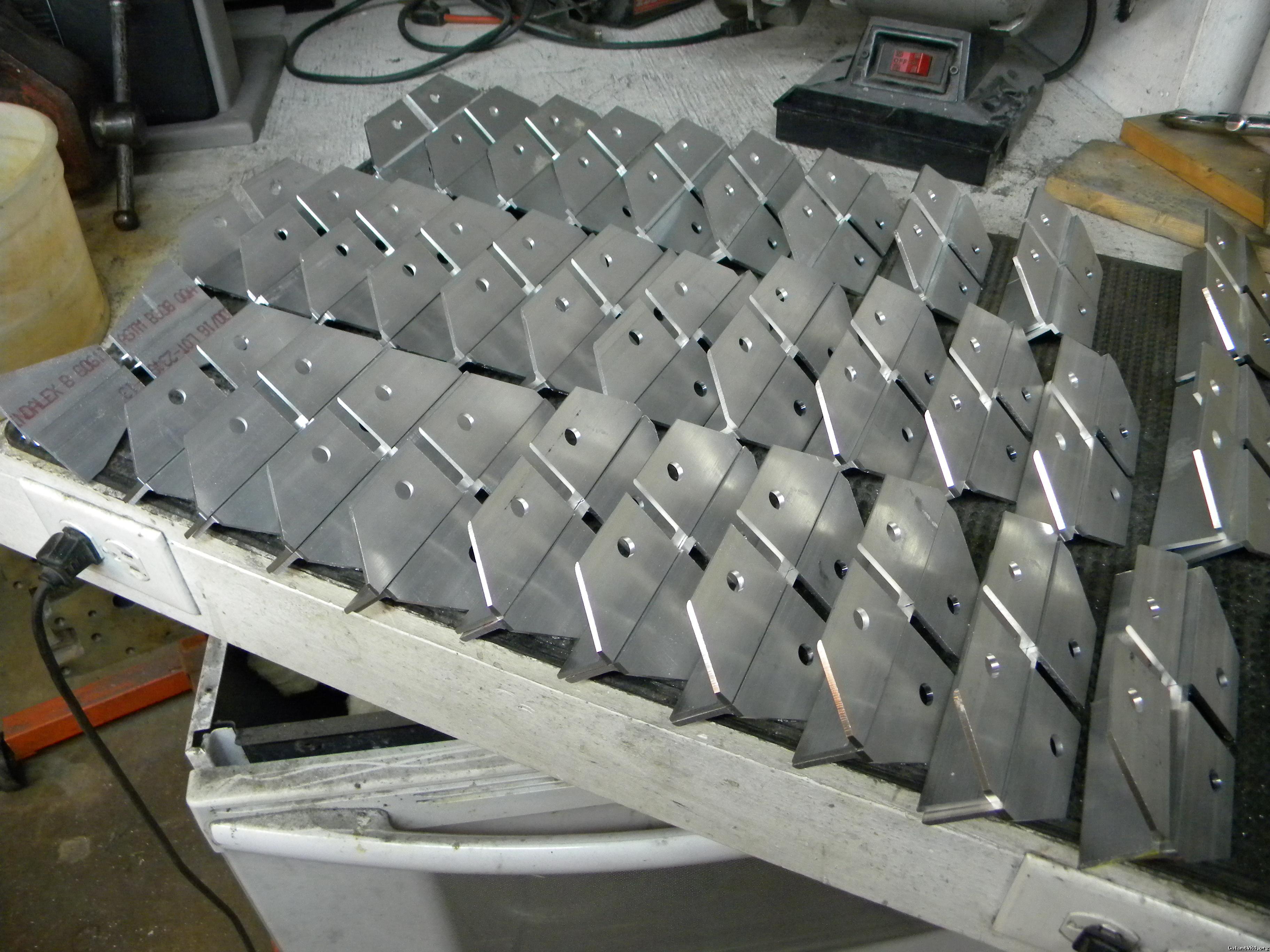

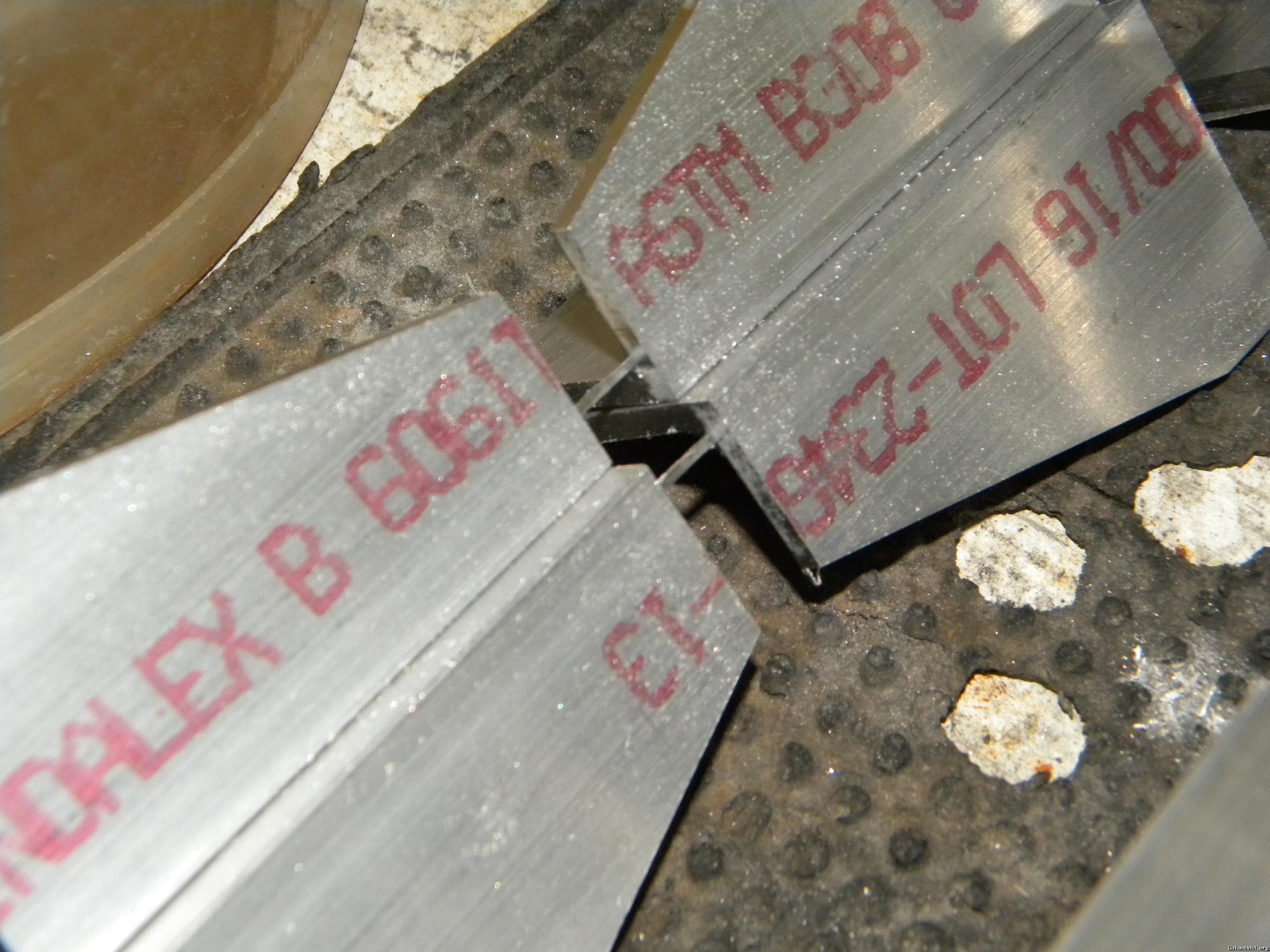

The brackets that mount to the seat rails should be done tonight. Seems like the only time I can be left alone long enough to do anything without interruptions is after 10. I got the feed rate cranked up and keeping the cuts shallow so not to disturb anyone sleeping.
The cuts facing upwards are all done and doing the cuts that bolt or weld to the others now. If I finally get sick of them and decide to go to bed I'll finish them tomorrow night and finish up code for the other thicker stuff that bolts to the floor.
Here's pictures to prove to John (Toybreaker)and Chris (Boostin Hard) I am working on these. Enjoy On and look close I left the pieces connected with a .5mm strand, I needed some entertainment /ubbthreads/images/graemlins/grin.gif

The run of brackets for the rails are done. Going to watch the Olympics for a while then come down and check the code for the floor brackets and start cutting them tomorrow. I don't have them cut out yet so I'll chop them out in the morning and start running programs in the afternoon.
