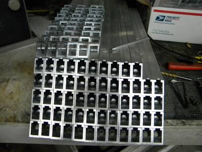

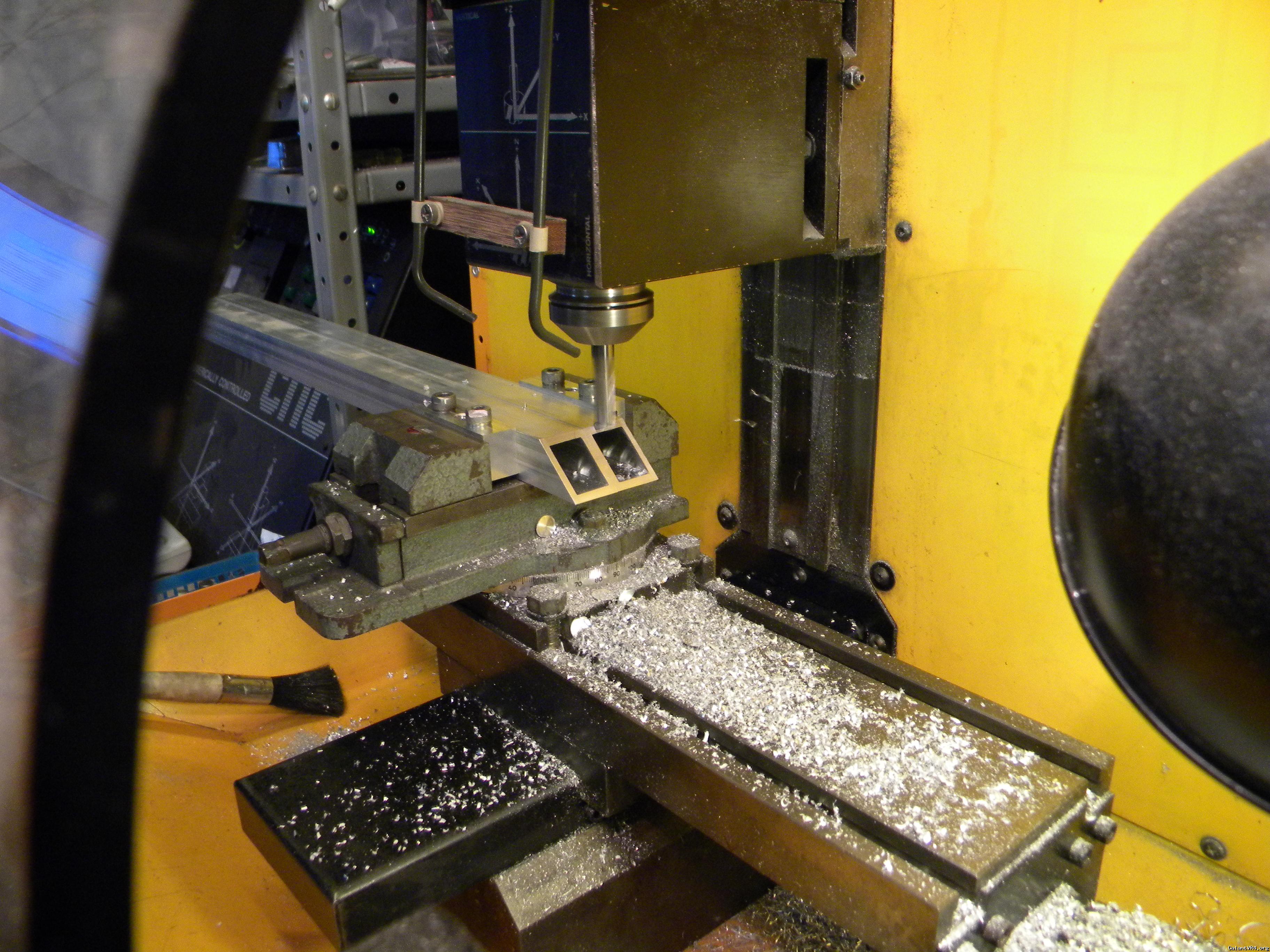

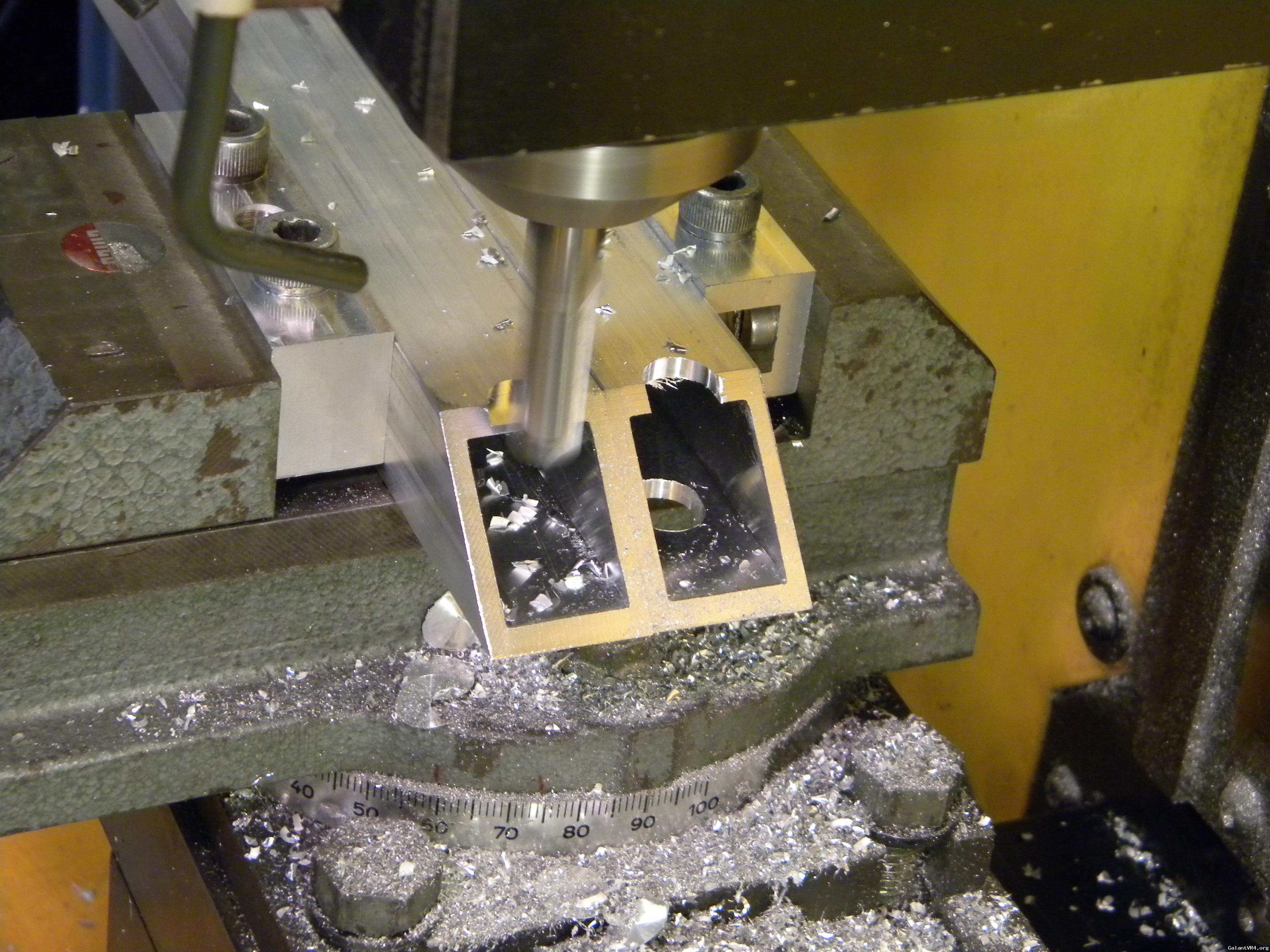

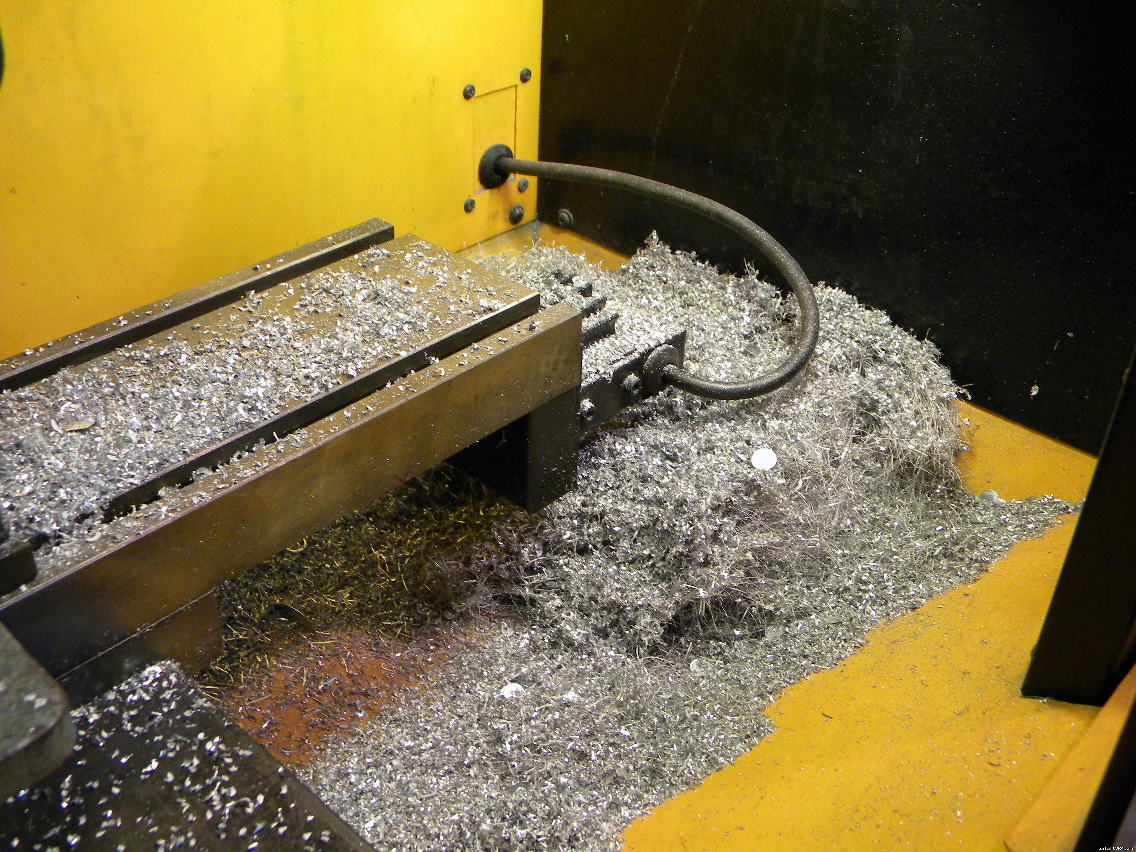

Well cutting slots tonight had to edit code so the mill is quiet so not to disturb the family. I'm up late every night anyway but Vinny called and will be here noon Friday and since the metal supplier will have the angle stuff for the front Friday morning will be a wash. Hoping to have all the rear bars cut sloted and welded up by tomorrow night. I checked and the factory bolts with the 14mm heads want work so I notched the top and cut slots so nice allen heads will fit and want be a pain to install. If the buyers want hardware included I'll check my supplier next week for a price for all hardware needed. Allens for the seats, floor new nuts for up front and even the bolts for the side brackets. Figure if we're going to do this might as well make it look sexy.
anyway pictures.
When I started the mill was clean /ubbthreads/images/graemlins/grin.gif

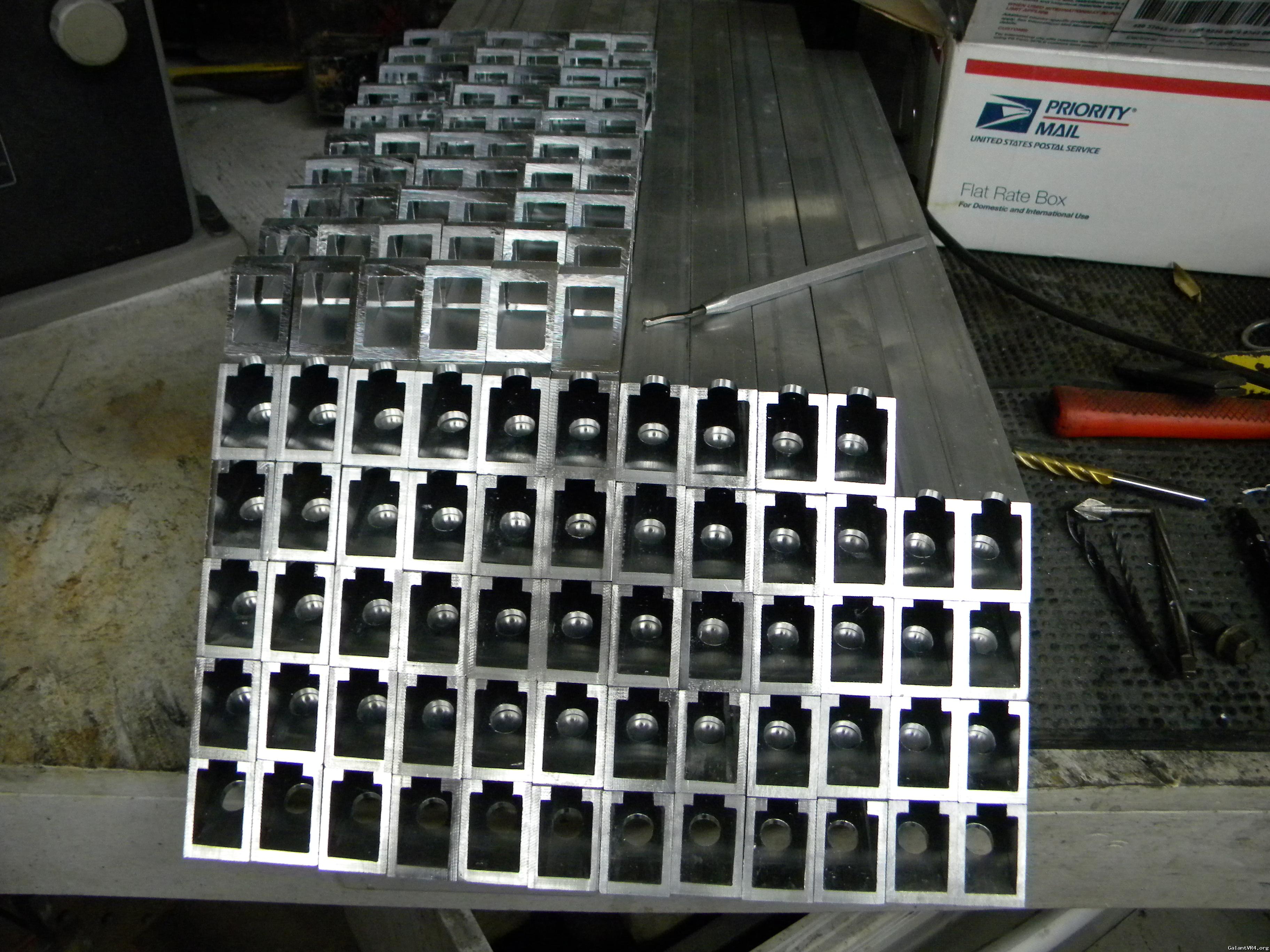

But first pictures of tonight's progress
All the little pieces have to be milled tomorrow like the long ones then tig welded for the inside rear corner to mount to.
