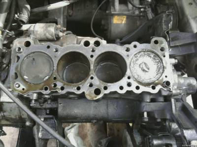

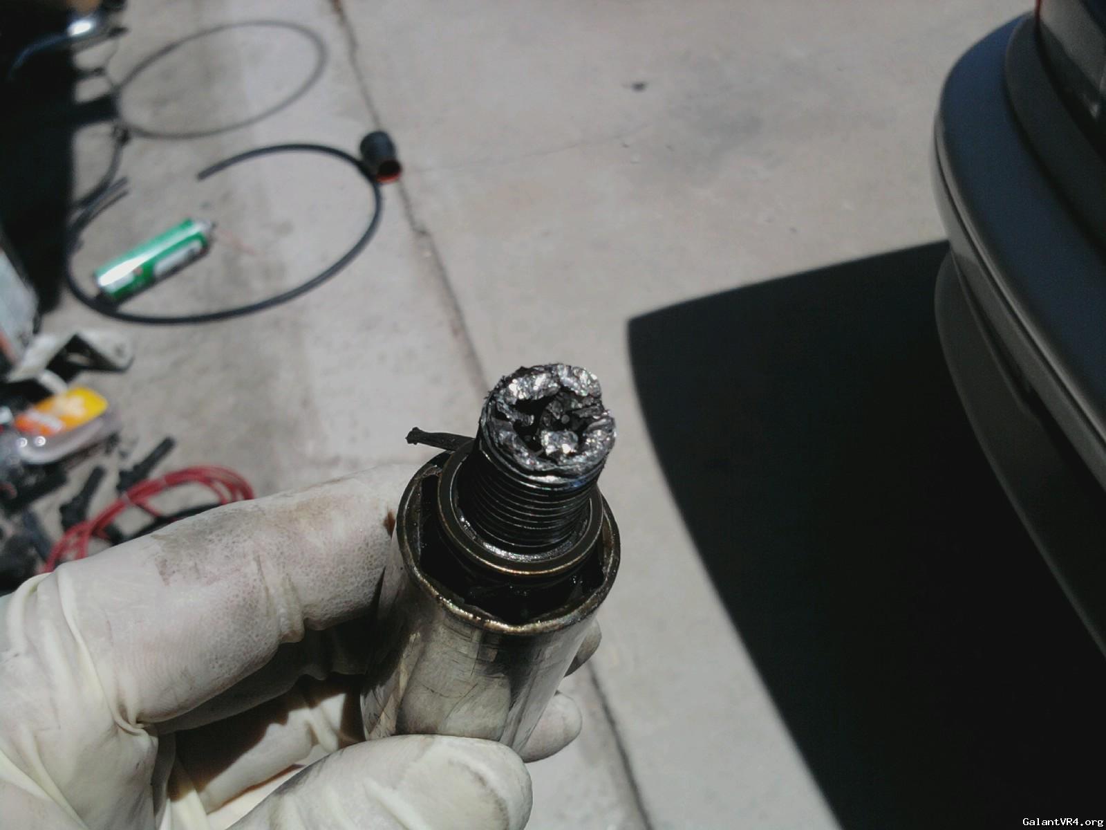

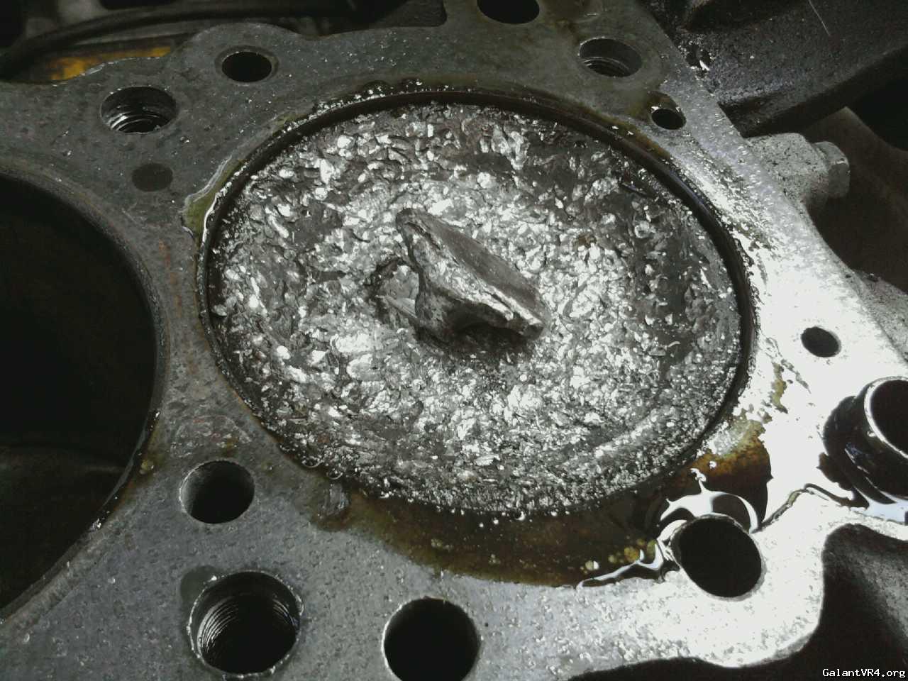

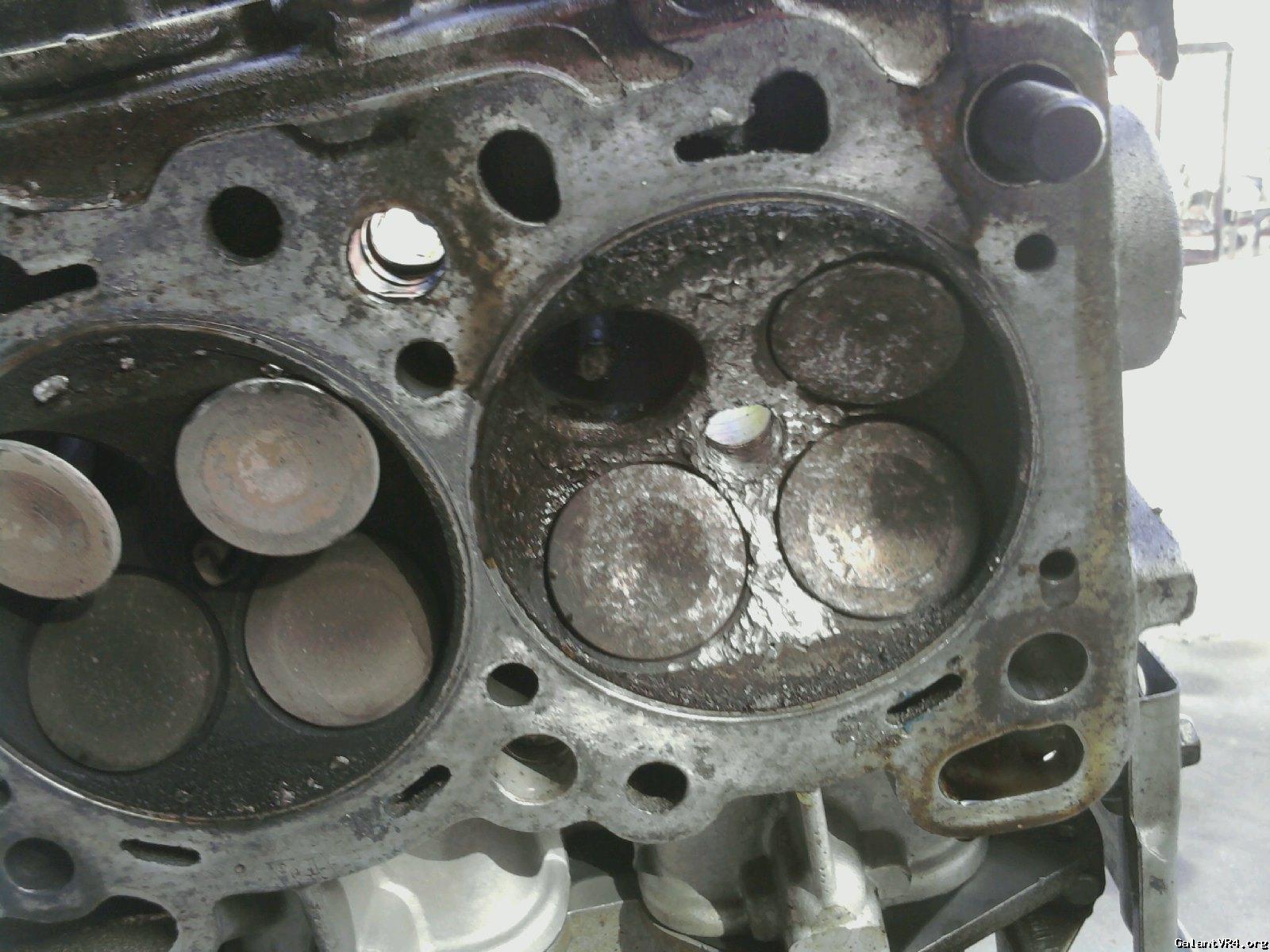

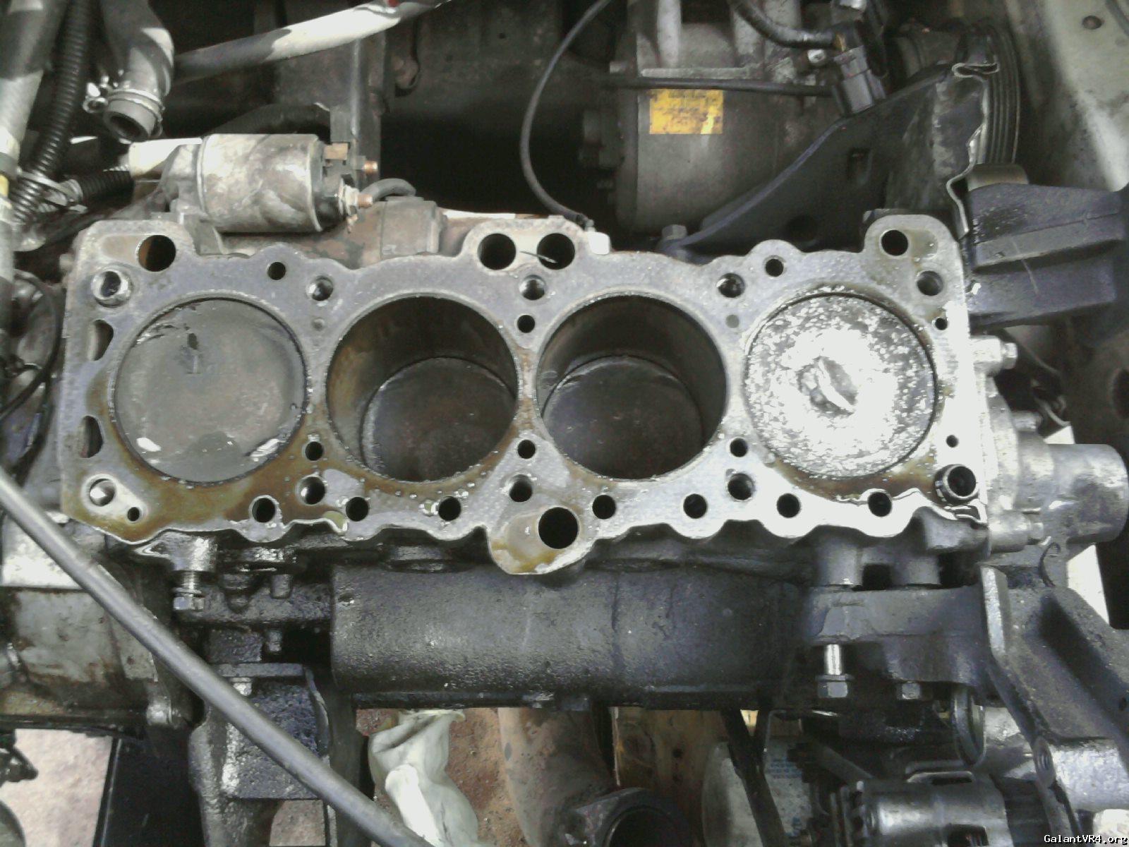

I was driving on the highway about 75mph and the car decided to just shut off. I'll just let the pics do the talking.

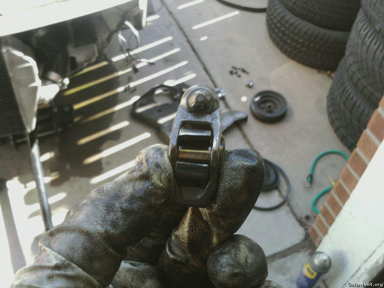

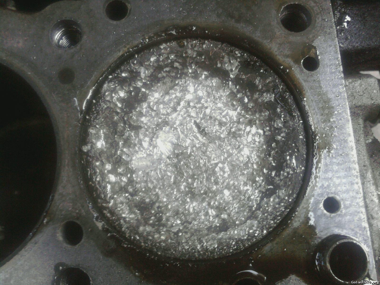

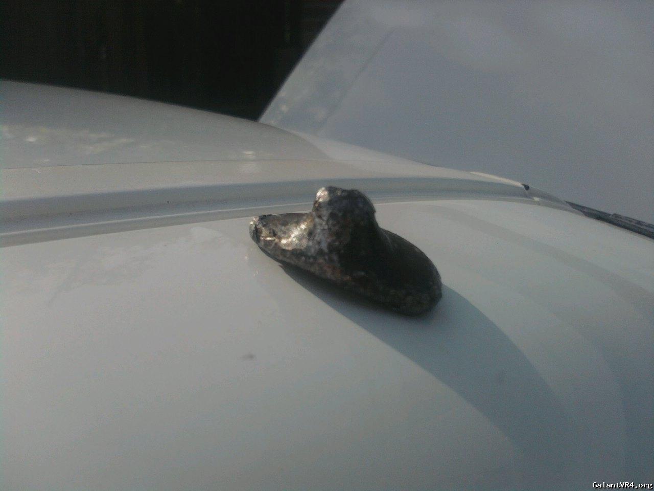

This was my daily and didnt really give me any major troubles until now. I thought maybe I could of put a new head on there and have it running the day afer but seems like the damage was more than I imagined. If the valve wouldnt of broke it might of still been repairable but it is what it is.

So what happened exactly?
The crank pulley bolt came loose which made the harmonic balancer come off totally?
Then the lower Tbelt gear on the crank slid out or something?

I had seen major Tbelt failures which destroyed the engine caused by BOTH the harmonic balancer coming off or the main crank pully bolt backing out.
A: the harmonid dampner crank pulley gets loose....wobbles a bit, cuts into the plastic timing case like butter and either slices of AC belt or chunks of plastic case get between the Tbelt and pulleys and cause the jump & carnage.
B: the main crank bolt backs out (the one that has the 1/2" square hole) and allows the crankshaft timing belt pulley to walk back off the crank and when it gets about halfway off, the key aligning the pully/crank will snap and allow the two to rotate..causing carnage.

Exactly what Nate said. The bolt holding the pulleys together came loose and the timing belt was only about half way on as you can see the marks on the timing belt. The body of the car held the harmonic balancer and it didnt completley fly off. When the harmonic balancer backed off it pretty much tore up the alt belt but didnt rip it off and somehow it seized. My powersteering was going out so I think that is what caused the alt belt to seize. With the sudden stop of the alt belt and the timing belt half way on it skipped therefore causing all the damage when a valve broke. I dont understand how it happened a year after the rebuild but its a Mitsu thing.
