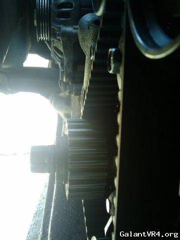

/ubbthreads/images/graemlins/banghead.gifand heres what it look like i just have crank bolt on to hold it into place crazy thing is its all in timing still

And make sure the timing belt isn't reused if there are markings on the underside. That's just asking for more trouble. Personally I would just go with another one even if there aren't any other markings but that's just me. I would tripple check the timing as well. That "grinding" noise that was not elaborated on could have been piston to valve contact unless it was definitely on the outside of the engine.
well 11 bent valves /ubbthreads/images/graemlins/mad.gif and rebuild soon decided to go through jonvr4 to have this repaired thanks for all the heads up guys and, sucks for me only had her running for 2 days /ubbthreads/images/graemlins/banghead.gif /ubbthreads/images/graemlins/banghead.gif /ubbthreads/images/graemlins/banghead.gif /ubbthreads/images/graemlins/idea.gif
