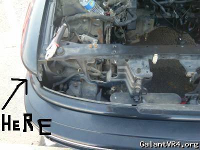

I want to say I recently took this bolt out. I'll try to remember to take a look when I get home. I know it's kinda goofy to get to. I almost wanna say you have to come in through the back via the wheel well.
Are you talking about the bolt that holds on the steel piece between the headlights/grill and the bumper? I'm pretty sure the bumper needs to come off first if so.
You can still slide in there and get to it. Back when I had no clue what I was doing I removed the bumper by taking all those damn 10mm nuts off to remove it.
I managed to take the filler off without removing the bumper. Was it easier? NO.
That's also not something you'd wanna do if you have nice paint, as it's highly likely you'll scratch the sh*t out of the top of the bumper trying to finagle that thing out of there.
I managed to get the fender off without removing the bumper, or the metal trim piece between the headlights and the bumper. But I know I had to take a bolt out that was attached to that strip. I don't remember it being something that would damage the bumper, but I remember it being a pain.
I am going after the end's of the skinny trim that sits on top of the bumper.

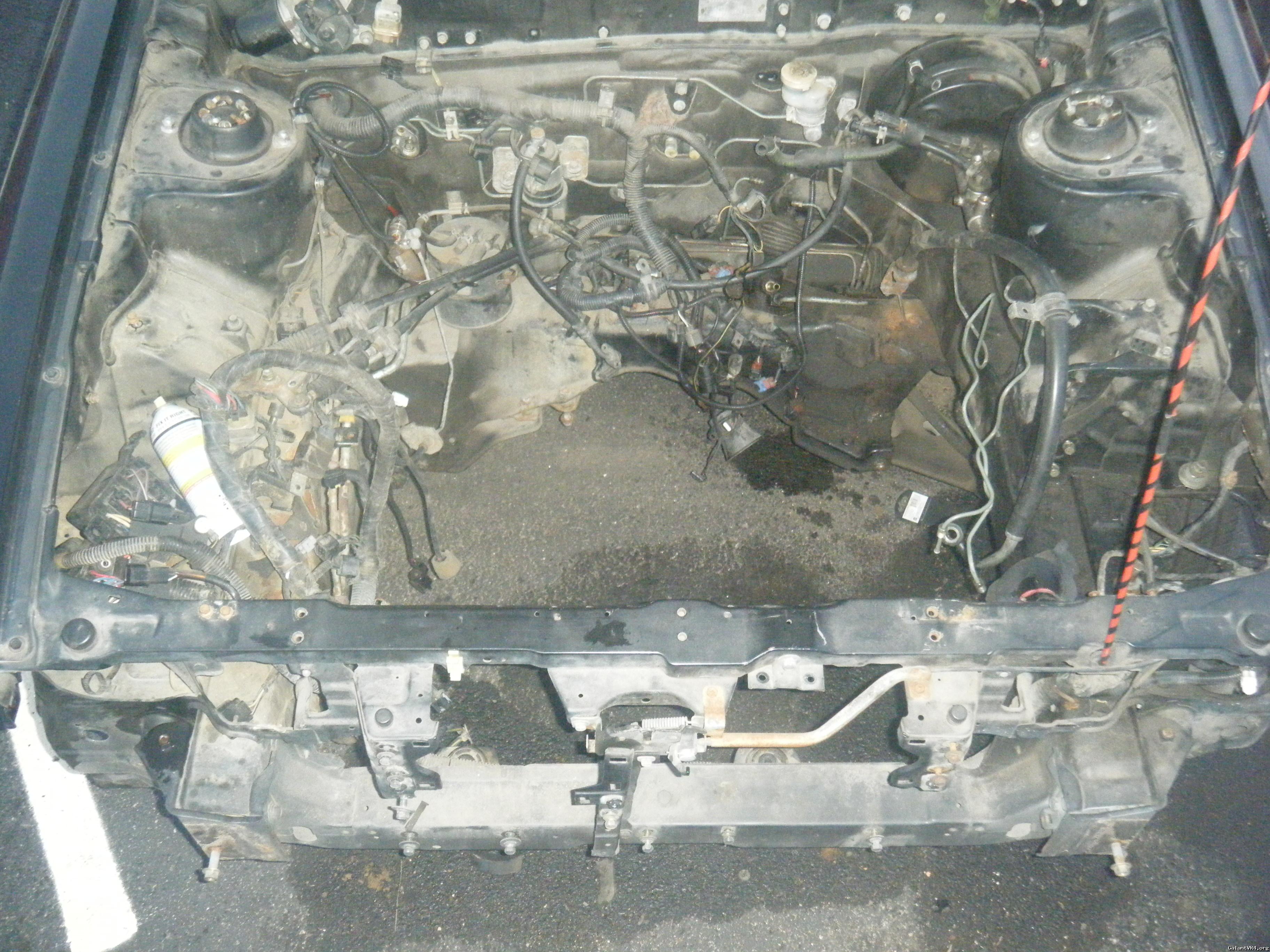

I just got both fender liner's off this morning.
I am actually taking everything off.
bumper, fenders everything.
So I can clean clean clean maybe a little more cleaning and then some painting.
I will be back to it in about an hour so I am sure I will find some way to get it off.
Thank you for the advice, I will try from the wheel well and see how that goes.
Remove the inner fender first which makes it a lot easier to get to everything. The bumper has to come off first to take the other trim piece off which is held on by two bolts. Hope that helps you out. Easy peazy lemon sqeezy... /ubbthreads/images/graemlins/smile.gif
Thank you to everyone for the help, I actually got the bolt off from the front. Front lights off the car. With a ratcheting box wrench.
I would like to point out that I did manage to remove that piece of trim before taking off the bumper. Not proud of being a little rough with the old girl, but I was gently at the same time.
