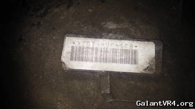

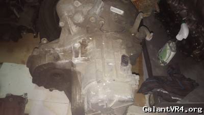

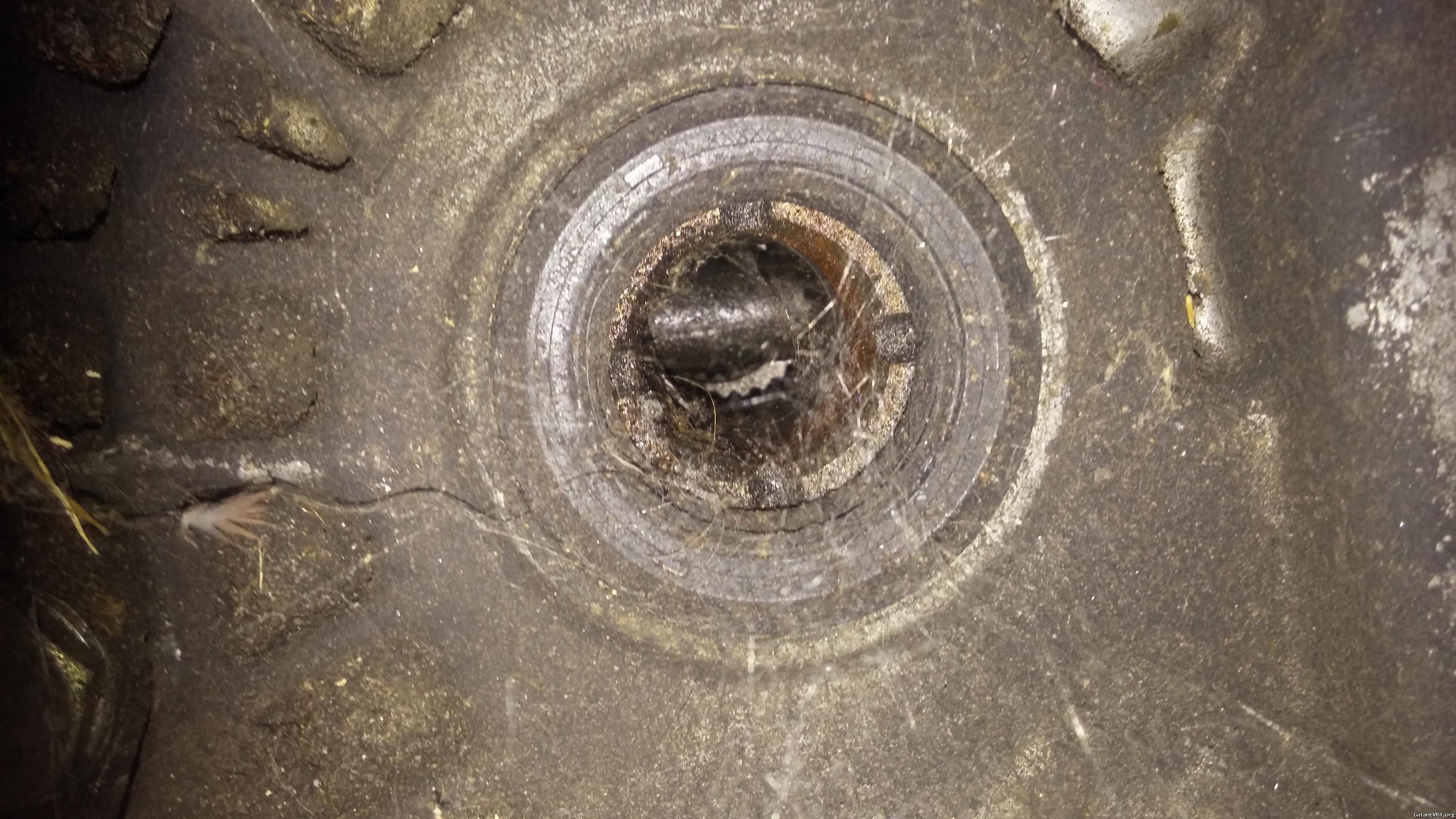

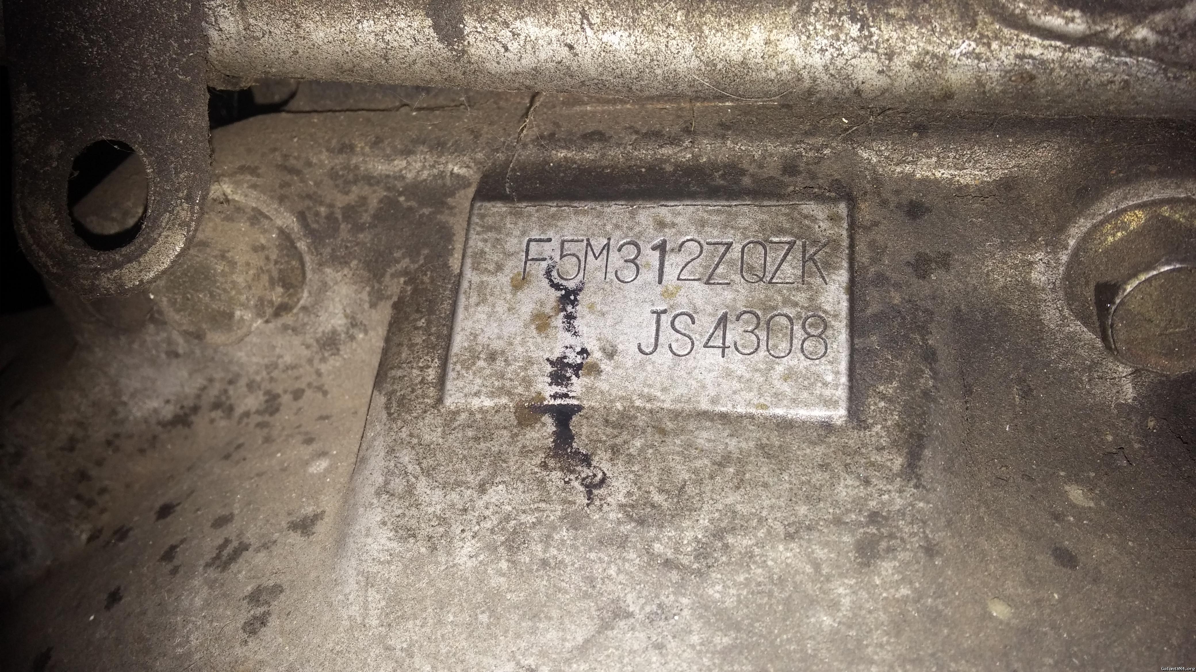

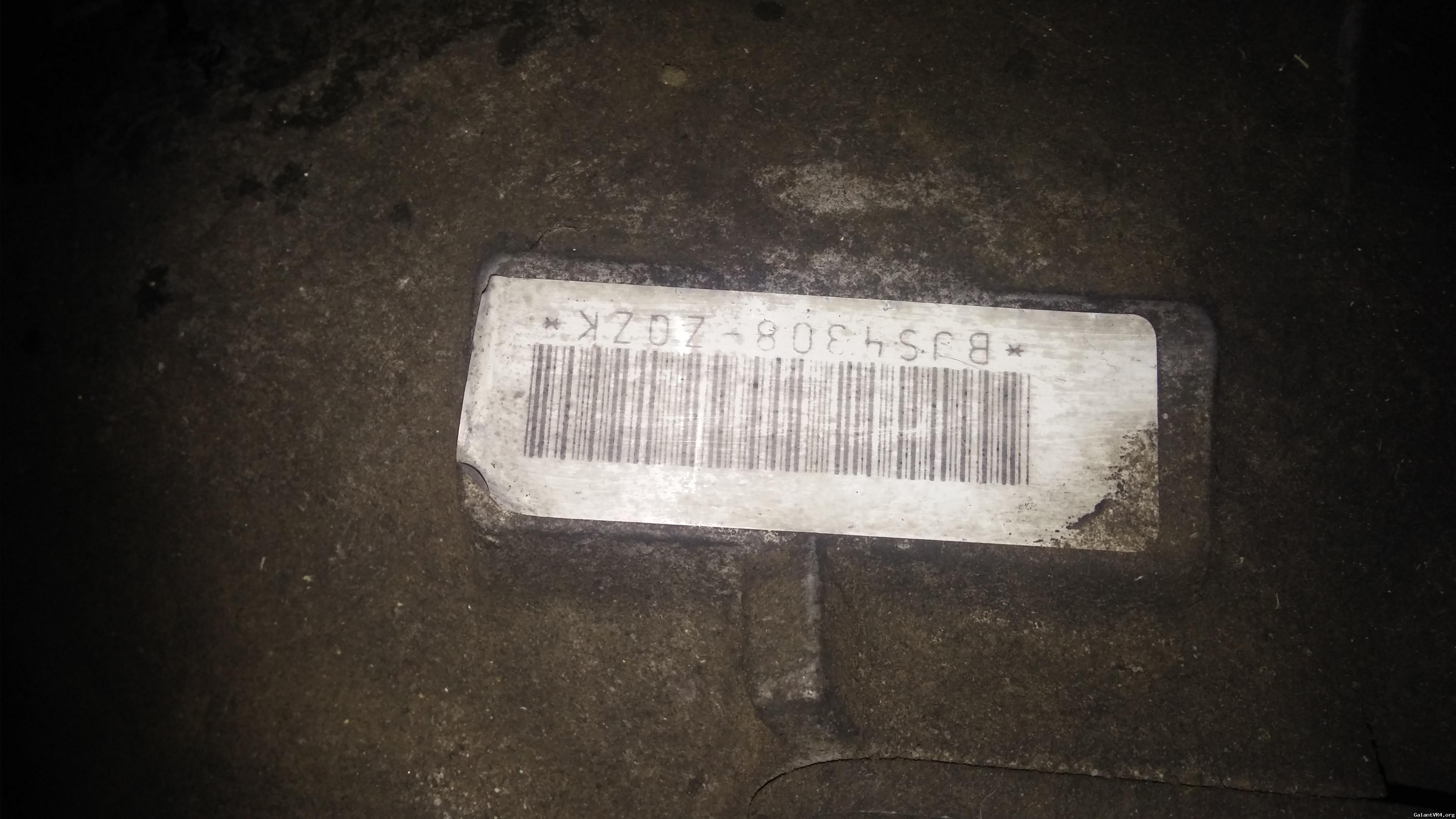

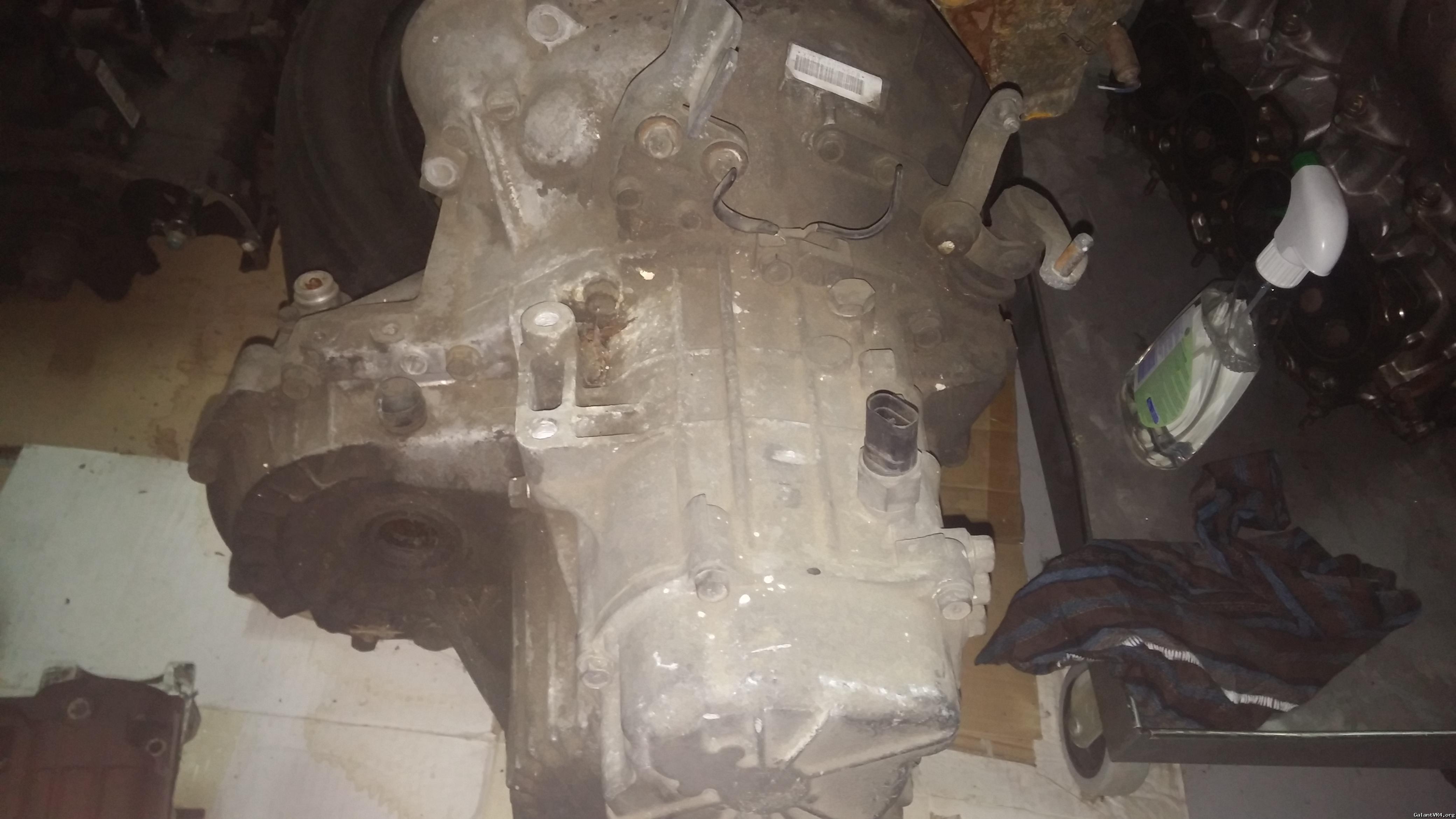

Hi All,
I'm looking to go back to a FWD gearbox.
Seems wasteful to run an AWD VR4 RS box in a FWD daily.
So back to research.
The original AMG box was an F5M31-2-ZQZK.
Open front diff.
Photos below:

F5M33 is probably the way to go if you're looking for a FWD M/T. This would be from the 89-94 DSM. I'm not sure if there was anything equivalent offered in any sort of tangible numbers outside north america. Since your engine mounts are on the block, being a galant.. i believe you could actually run the 2nd gen DSM fwd 5 speed as well. Essentially any F5M33 would bolt up. Unless i'm forgetting something about the 2g GS-T trans vs the 1g.
