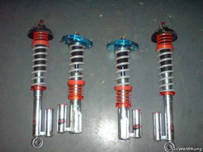

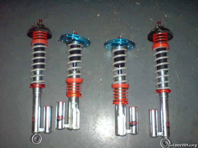

My VR4 Hotbits Race DT2
VS

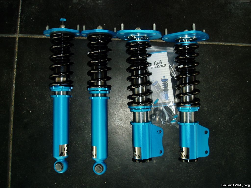

G4 VR4 coilovers (rears modifed to suit a cyborg lancer which is meant to be the same as a fwd galant)
The hotbits were $2400 AUD vs the G4 $1400 AUD.
bazeng
Feb 6, 2003
2,520
Melbourne, Australia
I wonder if I could just remove the small helper spring (red ones) on the hotbits and wind the height down to suit the FWD galants?
