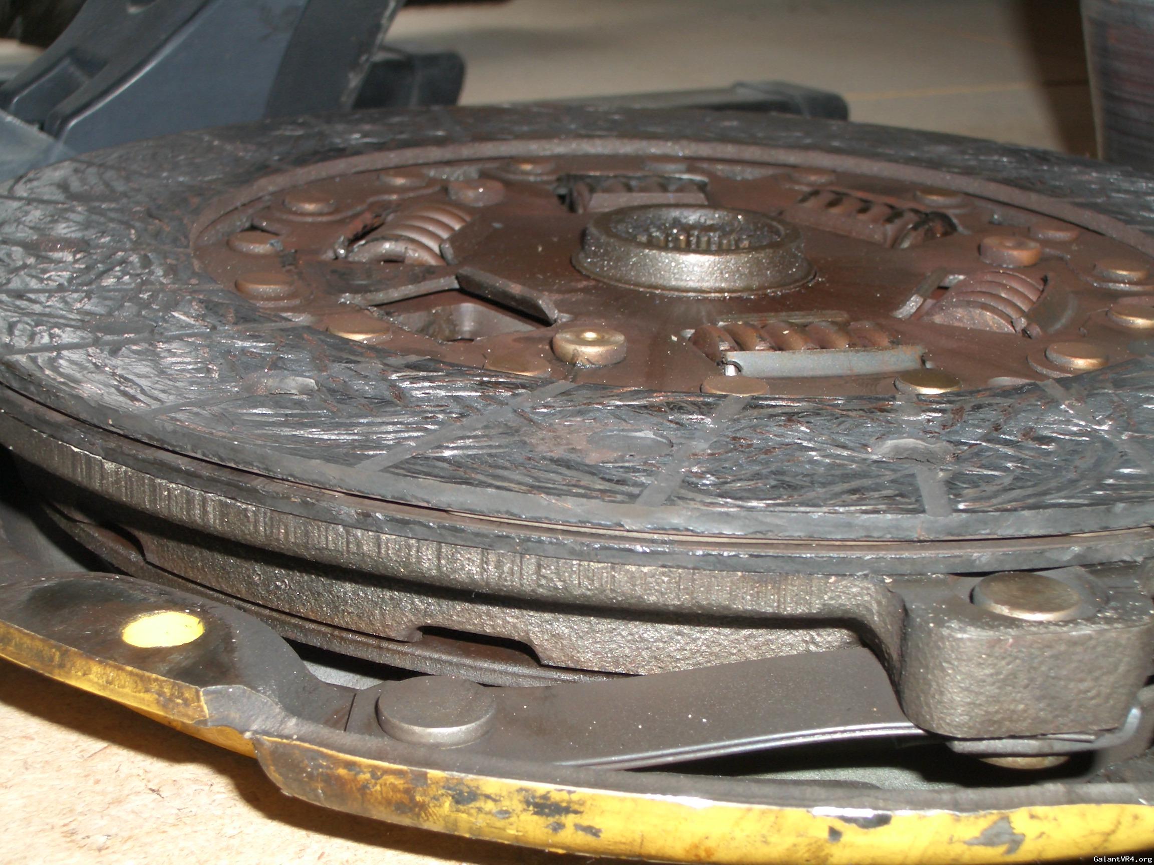

So my clutch went south on me and after pulling the transmission I discovered that my ACT Street-Disk had popped a spring. I was surprised to find though, that the friction material wasn't that warn despite me putting about 20k miles on this clutch over the course of 5+ years of driving.

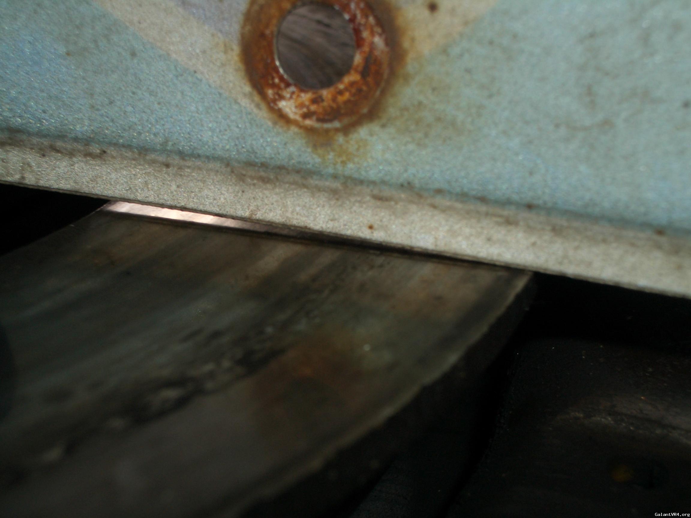

So I think to myself, perhaps if it's just a pre-mature disk failure, maybe the pressure plate is reusable and I can save myself some cash. Upon inspection, the springs are all still good, there are no popped rivets and the surface isn't cracked or pitted or even noticeably warped. Then I pull out my straight edge and lay it across the surface and this is what I see.
I seems that the pressure plate itself has warn down by about 1mm more on the inner radius than on the outer radius. It's enough to convince me that I need a new pressure plate. I've been trolling the web on and off for about two days now and I have yet to see an image or hear tell of another clutch doing this. Has anyone else seen this or is my car just being awesome again?

Cliff-notes. According to ACT this is caused by torquing to the factor recommended value instead of the ACT recommended 27ft-lbs. Also, the rep said it's reusable as long as the difference is less than 1mm? Your thoughts please.

The disk was nice and snug on the transmission splines but w/ that spring popped it's certainly shot. The main question was whether the plate is done or if it's reusable. If it's done I'll just get a 2600 w/ street disk. If it's reusable I'll get a sprung 6-puck and keep it on the 2100 pp. The friction surface on the pp looks basically fine but that slope has me thinking it'd eat through a new disk pretty quickly and I certainly don't want to be doing this job again any time soon.

^^ I agree that 27ft-lbs seems like a lot for even a high grade 8mm bolt and I definitely don't want to break on off in the fly-wheel. Last time I used OEM bolts at 12ft-lbs as per Mitsu recommendations. Next time I'll get some grade:10.9 and torque to ~20 as a compromise.
The 6-puck idea was intended as an upgrade that would allow the reuse of my pressure plate. Since it looks like I'll be replacing anyway I think that I'll probably go 2600 s/ street disk. This is after all a daily driven street car and I'm not really excited about having a track-only clutch in it.
