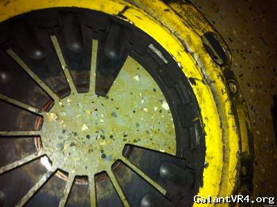

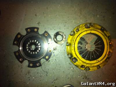

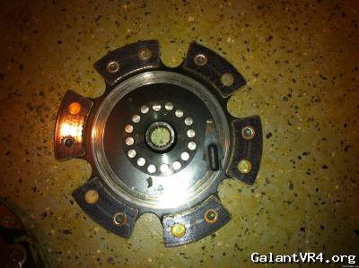

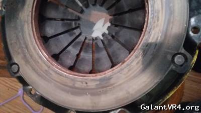

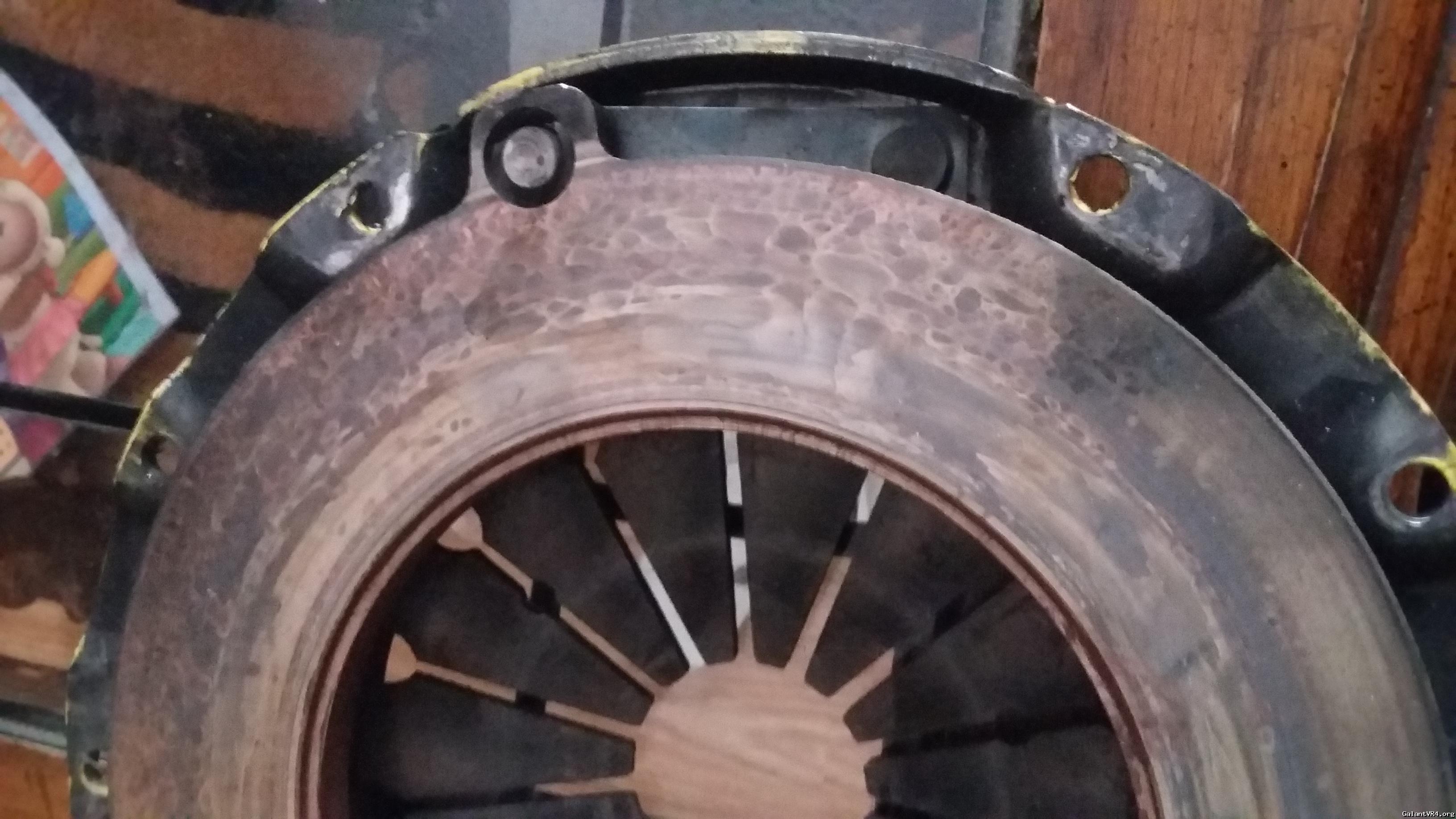

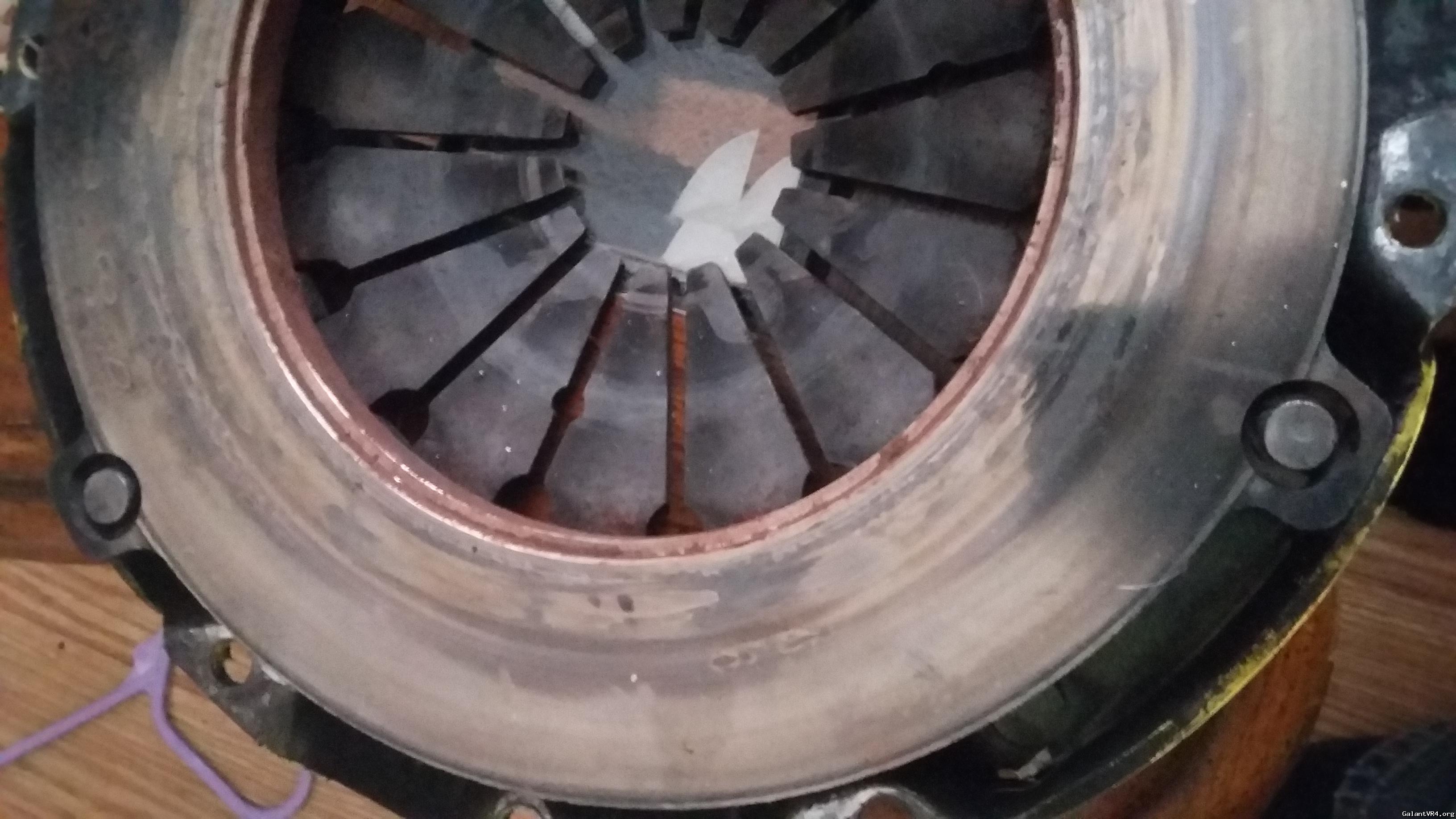

Act pressure plate was applying pressure unevenly would not allow me to get in gear. Pulled transmission and there is heat marks on half but not obvious bent fingers or signs to why it was doing that. Has anyone else has this problem with an act pressure plate?

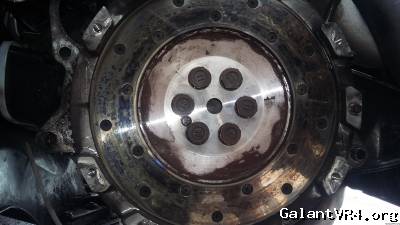

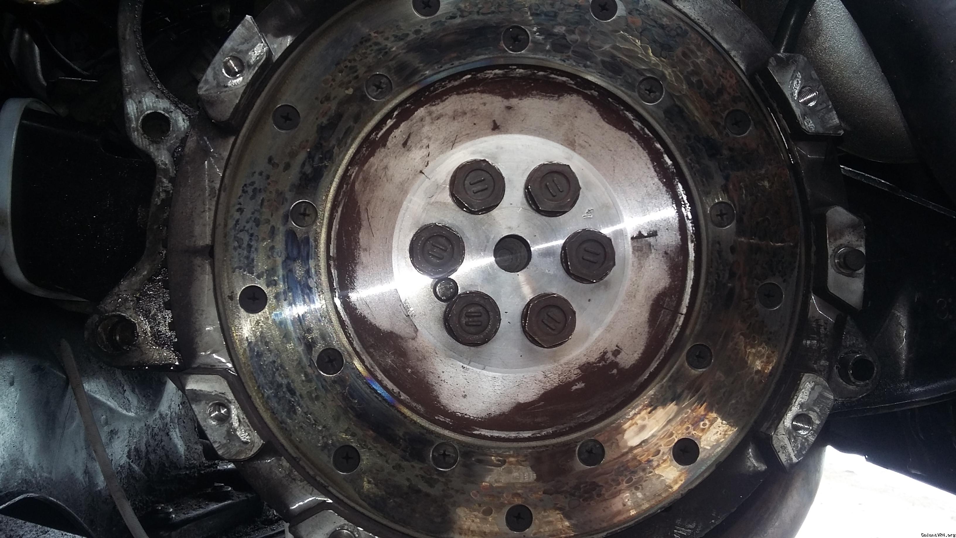

You have some lovely heat/scorch markings in two spots on the insert of that flywheel, not to mention as you said the uneven appearance of heat markings on the pressure plate disc.
Place the pressure plate down on flat surface, confirmed flat, very flat. Measure from the surface to the bottom surface of the pressure plate bolt tabs (underside facing the table now).
I am wondering if we can tell with a single stroke if the pressure plate apply springs (3?) could be weak or one out of spec.
Sure is a hell of a lot of heat going on in there.
Is this combination new?
If you can setup a dial indicator on the flywheel friction surface, and then measure it in five different locations (without moving the dial indicator - just rotate the flywheel) then we can tell if the flywheel has some abnormal lateral runout like a brake rotor exhibits.
Check your crankshaft end play while you are in there for shoots and giggles. This also makes use of a dial indicator.

I've ran the setup for about 15k. All the tabs match the others. It looks like it would be completely functional, I was hoping someone else have seen this, with there where the pressure plat looks fine but is faulty. I'll check out my fly wheel more tomorrow.

My clutch has never slipped since I had the car and the disk looks real good so I am curious about the heat. I'm ordering a new pressure plate going to bolt on the tranny and look through the inspection cover and see if its applying pressure crooked, like it was when before I pulled the tranny.

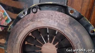

I wonder if your in the beginning phase of the problem I had with an act 2600 pp. I had 3 clutch fingers go out on me, which made it impossible to shift, I hope you checked everything in the clutch system like no leaks proper clutch adjustment with no drag.

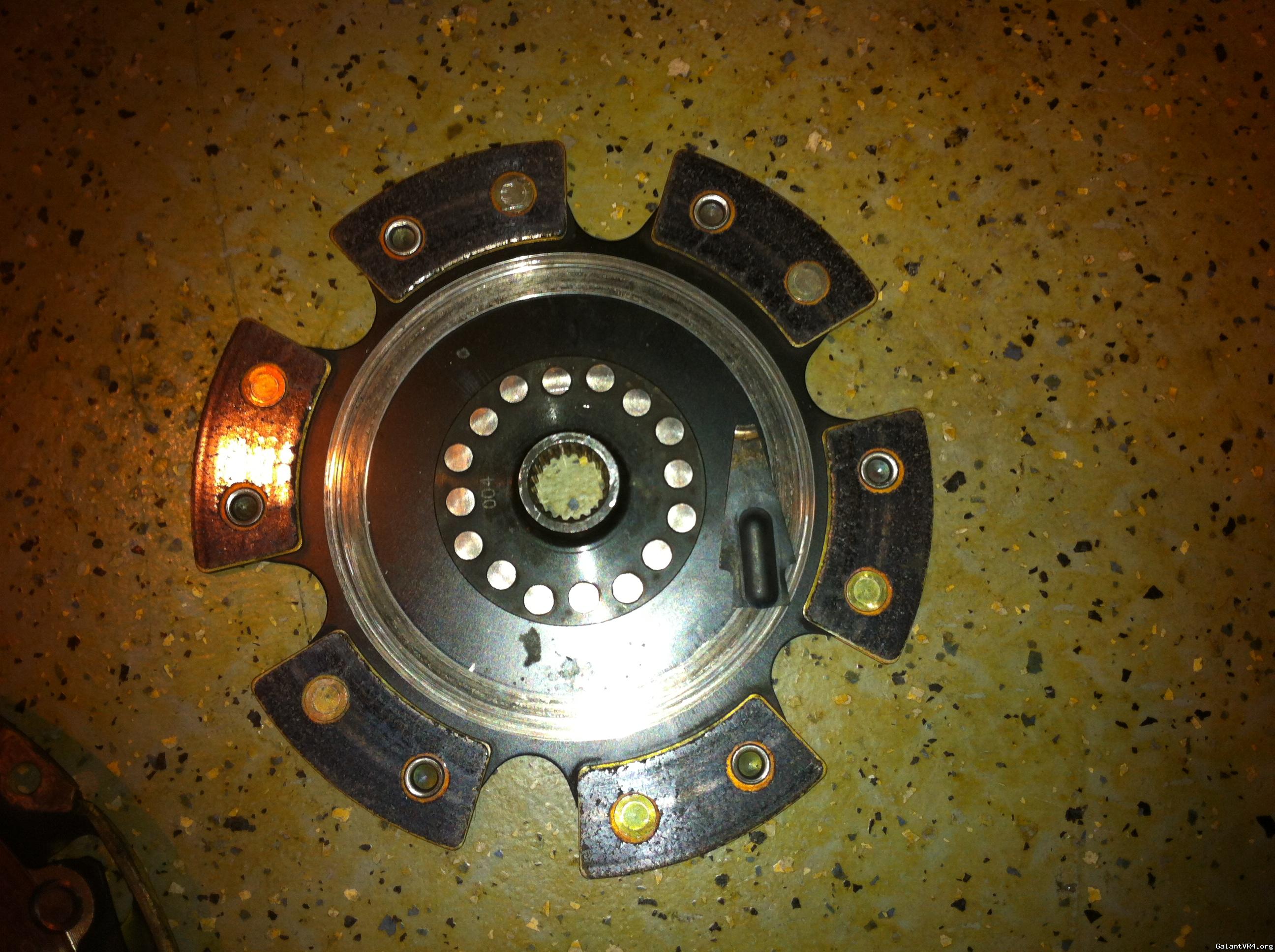

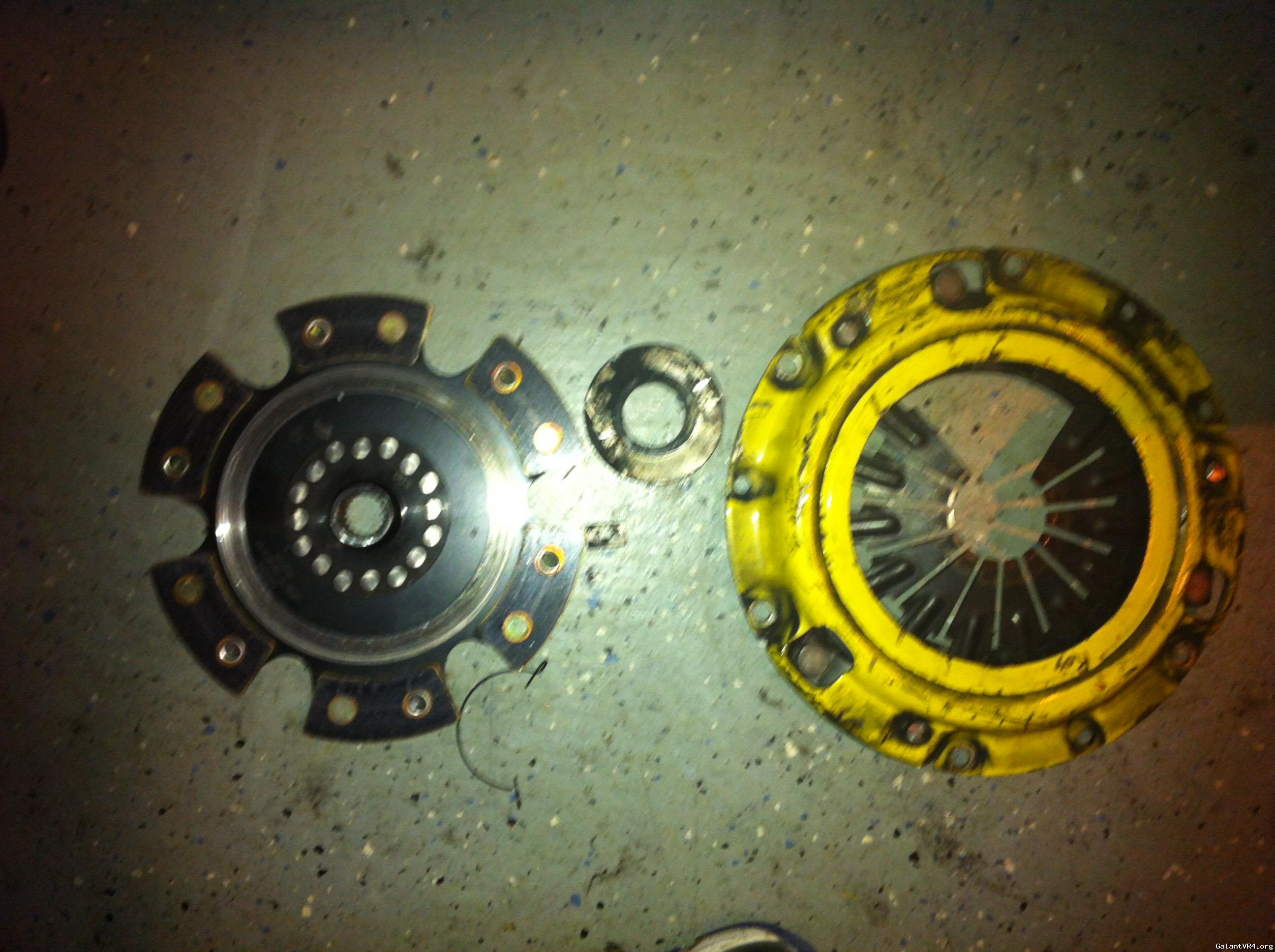

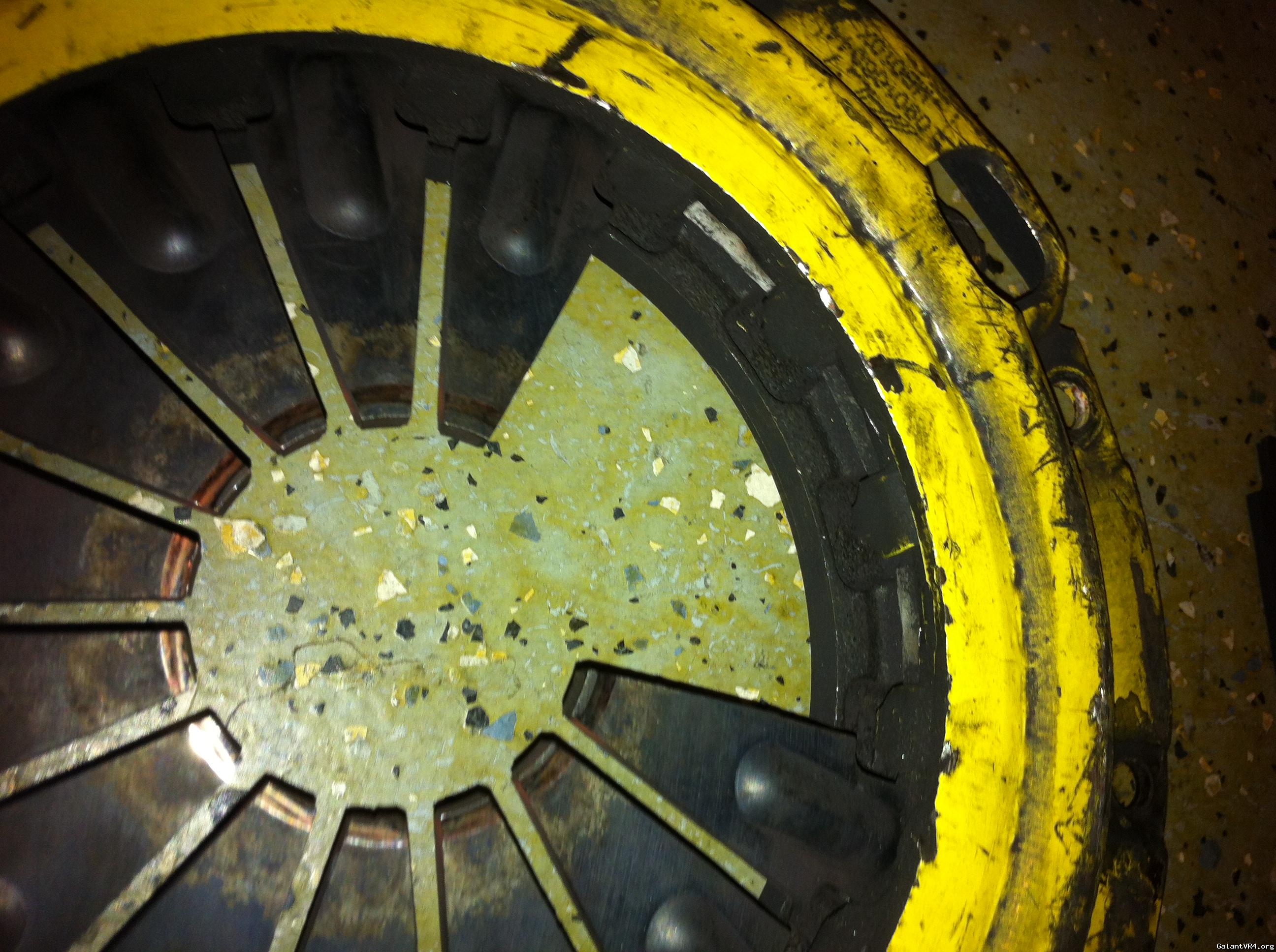

I had the same problem as you I couldn't get it into gear I pulled the transmission and that's what I found. I noticed it was getting harder and harder to shift then one day it wouldn't I also heard one of the clutch fingers rolling around inbetween the flywheel and the pressure plate, I didn't know what the noise was until I pulled the transmission.
You can see in the picture that the finger left a groove in the clutch disc.

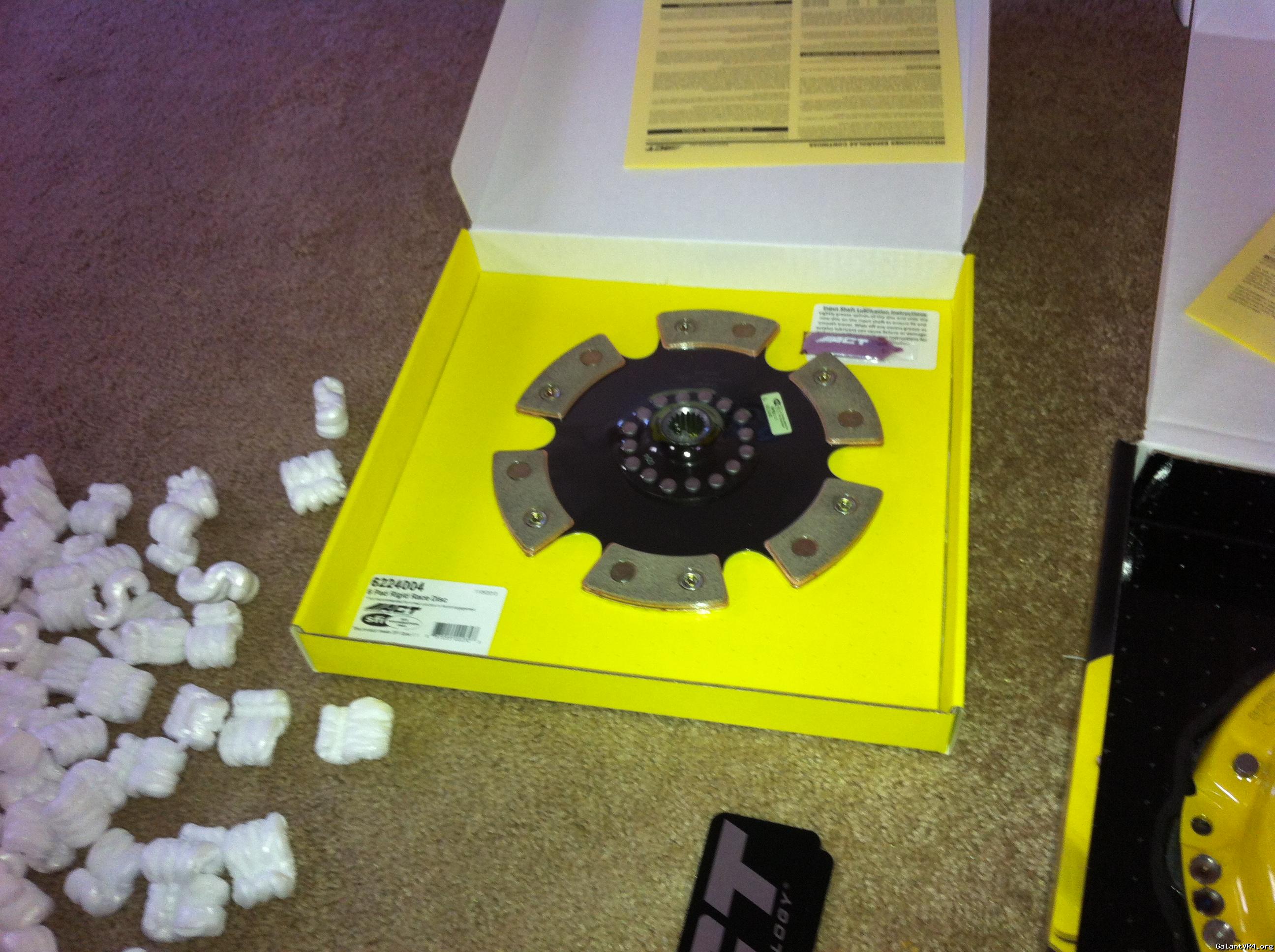

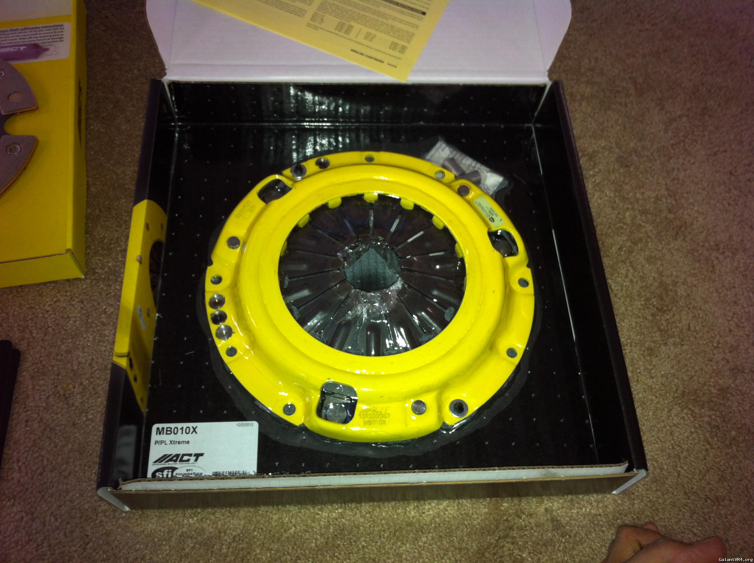

Contact ACT and explain the situation in a appropriate manner they'll make it right, I filed an RMA and got a new pp and disc I had to buy my own flywheel since it was a fidanza. They've been known to have a bad batch of pressure plates out there. I probably didn't need to buy a new surface for the flywheel but I did it anyways better safe than sorry.
Good luck.
