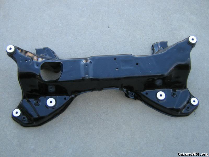

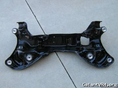

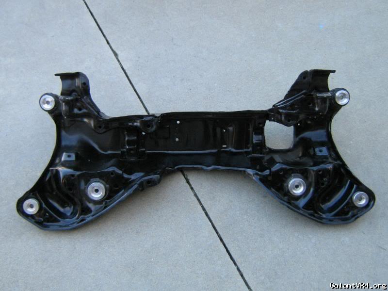

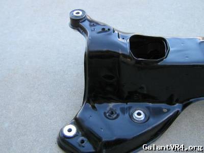

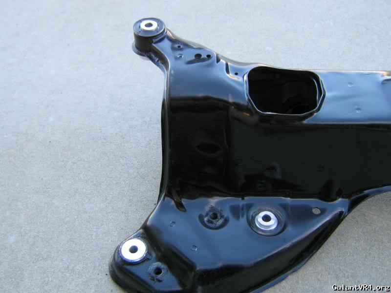

If you want metal, be better off with brass and pressed in, but IMO better to stick with rubber or at least polygraphite (so you don't have squeaks)...you can always find a rubber that has a higher durometer # (stiffer, harder)...However, some sort of isolation/dampening is a good thing, provided it's not all cracked up, etc.
