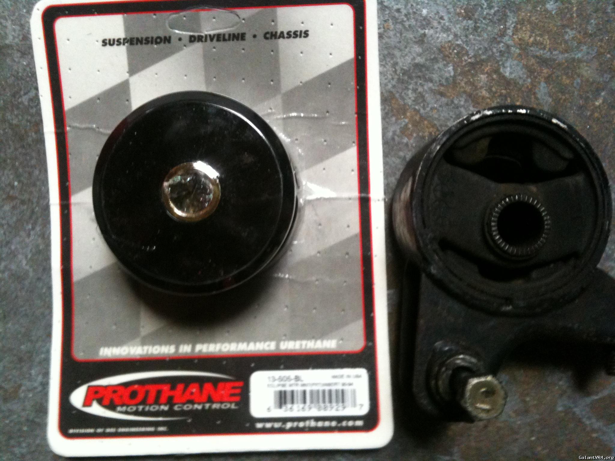

As I'm sure most know, Prothane's front motor mount is no longer the two inserts that compliment the factory mount, but rather a solid piece that needs to be pressed in.
Before I pass the point of no return and cut out the metal sleeve, I'm wondering if anyone thinks that I might run into any problems being that the bolt hole for the original mount is off center and the prothane is centered. All three other mounts will be replaced with Prothane pieces and I don't imagine there will be much give being that they're solid and pretty firm. I just don't want to have a problem getting the bolt through the front one when then engine goes back in. What do you guys think? Install this one, or leave it alone?
Maybe I worry too much... /ubbthreads/images/graemlins/dunno.gif
I have that new one pice MM. It helps to have an extra person to work the jack while you try and slide the bolt through the hole.
I put the jack under the transmission and lift the whole assembly slowly, little bit at a time while I try to push the bolt in. Once you get the mount bolted to the support bar you will see which way the motor needs to go in order to get the bolt in.
And FYI the front and rear are the two that are most commonly installed on gvr4's/dsm's. Most people don't mess with the sides because our motor really doesn't shift side to side as much as it does front to back. Installing poly mounts will transmit more vibration to the cabin but the trade off is reducing a ton of slop from the old oem MMs.

Thanks! Just wanted to make sure I wouldn't run into any issues. In it goes!
I don't mind the additional vibration. I did all the mounts in my old 2G and removed my balance shafts, so I know what I'm in for. /ubbthreads/images/graemlins/smile.gif

If you'll notice that the motor mounts are off-center to the top, but when the engine is installed, the weight of the engine causes it to sag approximately to the center of the mount. Shouldn't be a problem.

That insert was a little tough to get in, I took the mount right out and used a floor jack and the frame rail to my truck to get it in without going in sideways. If there is trouble getting the bolt through the mount, try mounting it first then, bolting the mount in place

I just installed this front mount. Prothanes instructions list it as a two piece mount that can be pressed in by hand. Had me going for a while thinking they'd sent the wrong mount. I was contemplating going down to the shop and pressing it in but I figured, the whole rest of the kit is split bushings, why should this one not be. So I grabbed my smooth-serrated bread knife and VERY CAREFULLY cut it in two. Got a really nice clean cut and pushed it together from the outside just like the other three.
Can anyone see a reason that having this be a split mount would be a bad thing?

I just used my 6" bench vise and a bit of axle Greece and pressed it in.
However, can't see any reason why it would hurt the bush if you cut it in half. The bracket that bolts to the motor will fully encapsulate the bush so it can't slide out once installed.

I just pressed mine in with a vise and lube as well, went right in with minimal fuss...
I personally can't see why dividing it in half would be an issue since the bracket squeezes it together, but they might've done it for some reason. /ubbthreads/images/graemlins/dunno.gif

I did this today and ran in to two distinct issues. The urethane bushing is like 4mm less than the hole it's supposed to go in and the bolt hole in the metal bushing is entirely too big for the bolt.
I didn't take all the old rubber out of the old mount before I pressed it in. If I was smart about it I would have offset it like the original center hole was off set.
As for the metal bushing I used the center from the stock rubber part and cut an equal length of 3/4" copper pipe and pressed the bushing inside the pipe. This made a decently snug fit.
It was still a great big pain in the ass to get the new mount in. 3 hours and now the side mount won't line up.
