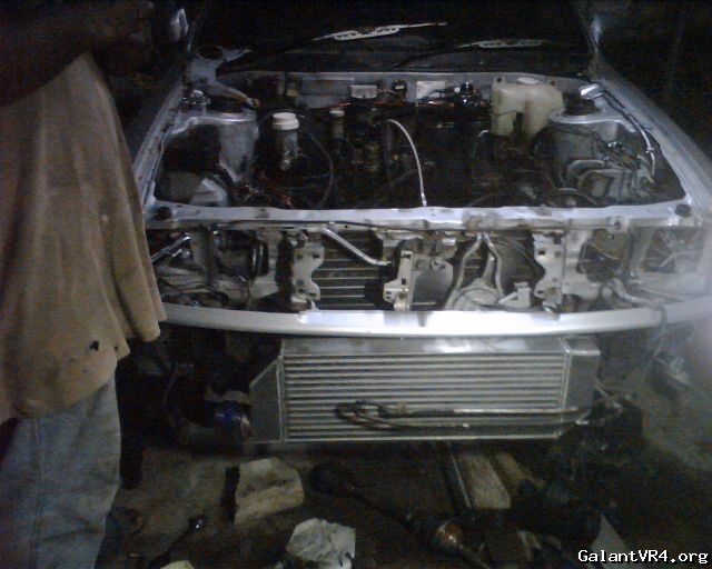

We dropped the sub frame to finish remove the 4WS stuff remaining and to put on the new LSD. We found out one of the brake lines had been broken, so that needs to be repaired before the car can make it back to the road.

Looks good, but I would ditch that power steering cooler. It is not really needed and the lines can be looped easily. Or at least put it behind the intercooler if you are determined to keep it.
