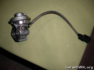

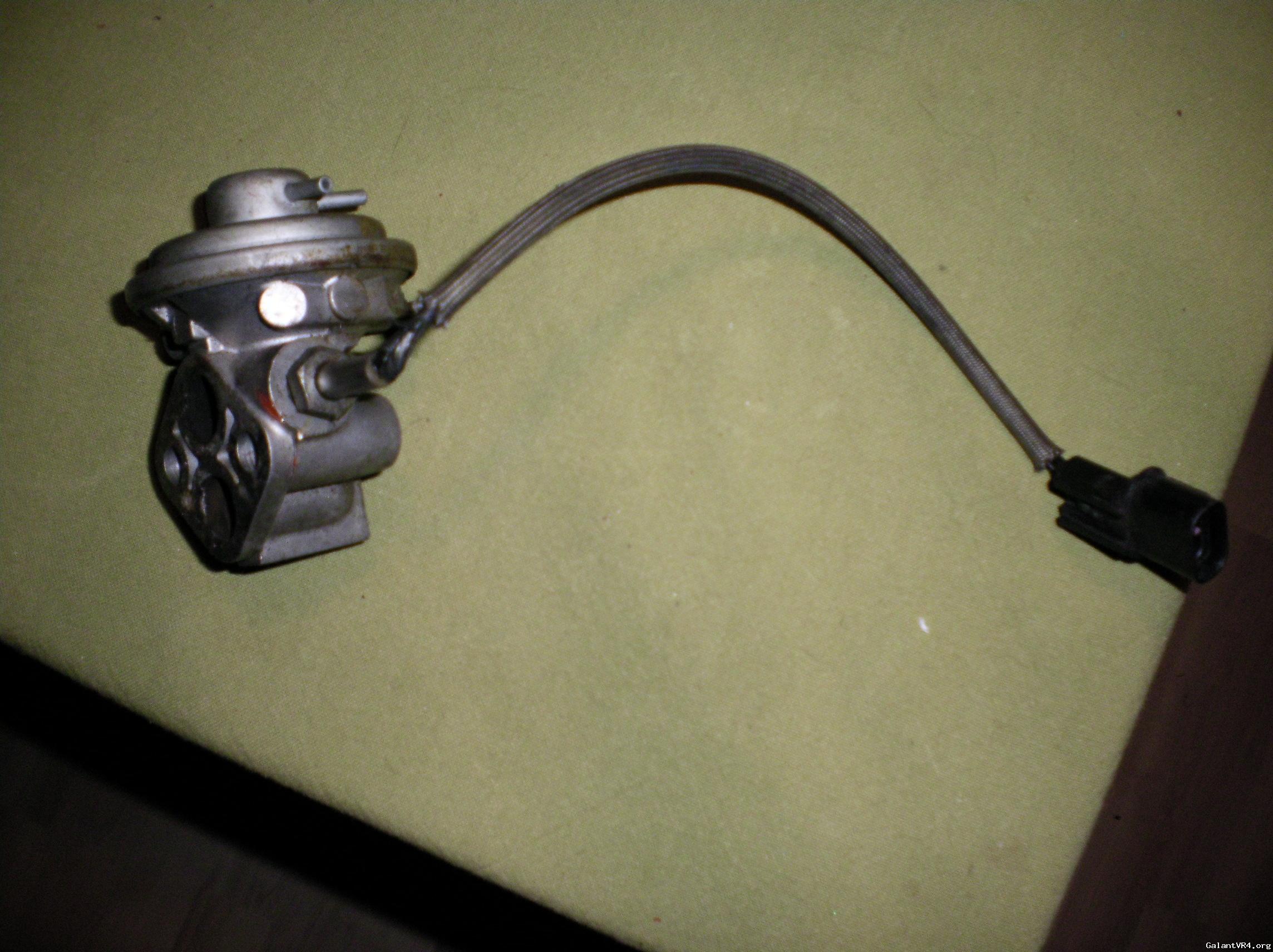

EgonOlsen
May 4, 2010
333
Denmark, Europe.
ok so far so good, or bad. Havent found the problem yet.
I put in another ISC black 1. made no change whatsoever.(Imeasured both the new and the old 1, the old one have a funny read on 1, but the new measured same resistance on all pins.)
I took off the EGR and found a can homemade block off there, made a new block off and put it on again. Made no difference either.
I had the throttlebody off and put 2 new gaskets on. Made no difference.
I have bought a pipe and stuff to make a boostleaktester.
1 Question. This "sensor" or what it is on the EGR valve, is it ok for it NOT to be plugged in? and if no, where does it plugin to? mine was already off.
