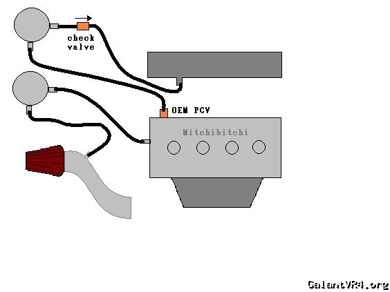

This is the right way to do it. You can make your own catch cans if you have fabrication equipment, but you need to make sure they're set up properly, kind of like this Saikoumitchi Can
The important features are the straw on the inlet, the mesh (stainless steel or brass wool will also work, but not plain steel or copper, as they will corrode) and the release holes, which prevent the liquid from frothing up.
The only improvement I would suggest is a bypass check valve on the VC/intake side that lets fresh air pass directly into the VC instead of going through the can.
Quoting chrisb33:
dual catch can set-up.
