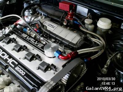

So, i've noticed a lot of valve covers with AN -10 fittings on them lately. This has always seemed like a good idea to evacuate a lot of crankcase pressure, albeit not the greatest looking thing. It makes the engine bay look a bit more cluttered once all put together.

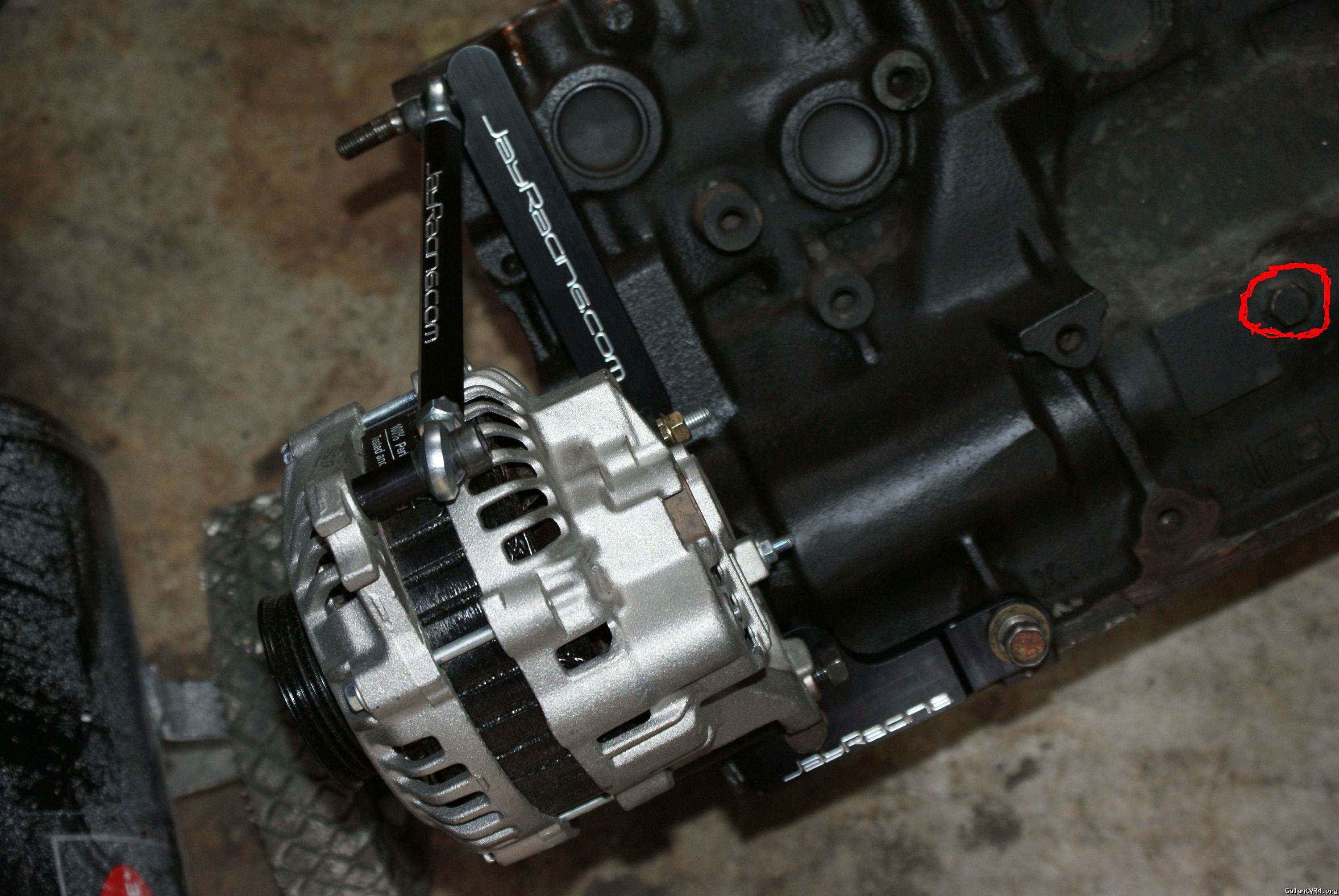

I was wondering about a more "out of the way" option of doing this. Those of us without balance shafts have an entire area that could be dedicated to evacuating crankcase pressures. There is a hole conveniently drilled already, as well. It's not very big, but it could be enlarged. The area inside the block where the balance shaft usually sits could easily be baffled off with a little sheet metal, keeping most oil out of the PCV hose, and keeping more oil down in the pan, actually.
What about using this hole? Maybe enlarging it for better evacuation.
It would be easy to take a piece of sheet metal and put inside that area so that oil isn't thrown at the hole.. this way only vapor and pressure would be released. Right?

This is my alternative.. i'm thinking i may go this route, but the block idea seems pretty good. At least, most of the pressure is probably generated in the block, oil would bleed down faster into the case, and pressure would leave faster, as it doesn't have to fight its way up past the cylinders and water jacket.

Let's take your first idea a bit further. Because you've suggested a spot so low on the block, you'd also be able to build a self draining catch can, mount it under the intake manifold. The oil could drain right back into the block. Then you'd be able to have double protection from oil escaping, your in-block baffle and the catch can.

I don't see why it wouldn't work out. I think i'm going to try it. If it fails, all i have to do is plug a hole. I'm going to tinker with a spare block i've got tonight and see what i can come up with.

After looking at everything, i think going with Hal's vented oil cap and a catch can that drains back to the bolt hole i circled would be the best solution. Hal's cap has gotten great reviews, even though there are only about 20 of them out there. I'll be ordering one as soon as i figure out what catch can i'm going to run. It won't need to have all that much baffle in it, since it's going to drain back to the block.
This is a solution which has worked for many decades for big american cars that get a lot of blowby. It'll work out great for my setup too, im sure. I'll be going for something that would look a lot like what's in the photo above.
The nice thing about that cap setup, is that it is more "interchangeable" and if i wanted to, i could run a scavenging line to the exhaust instead.
