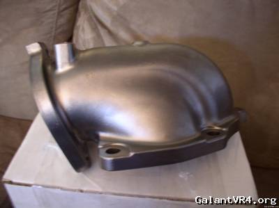

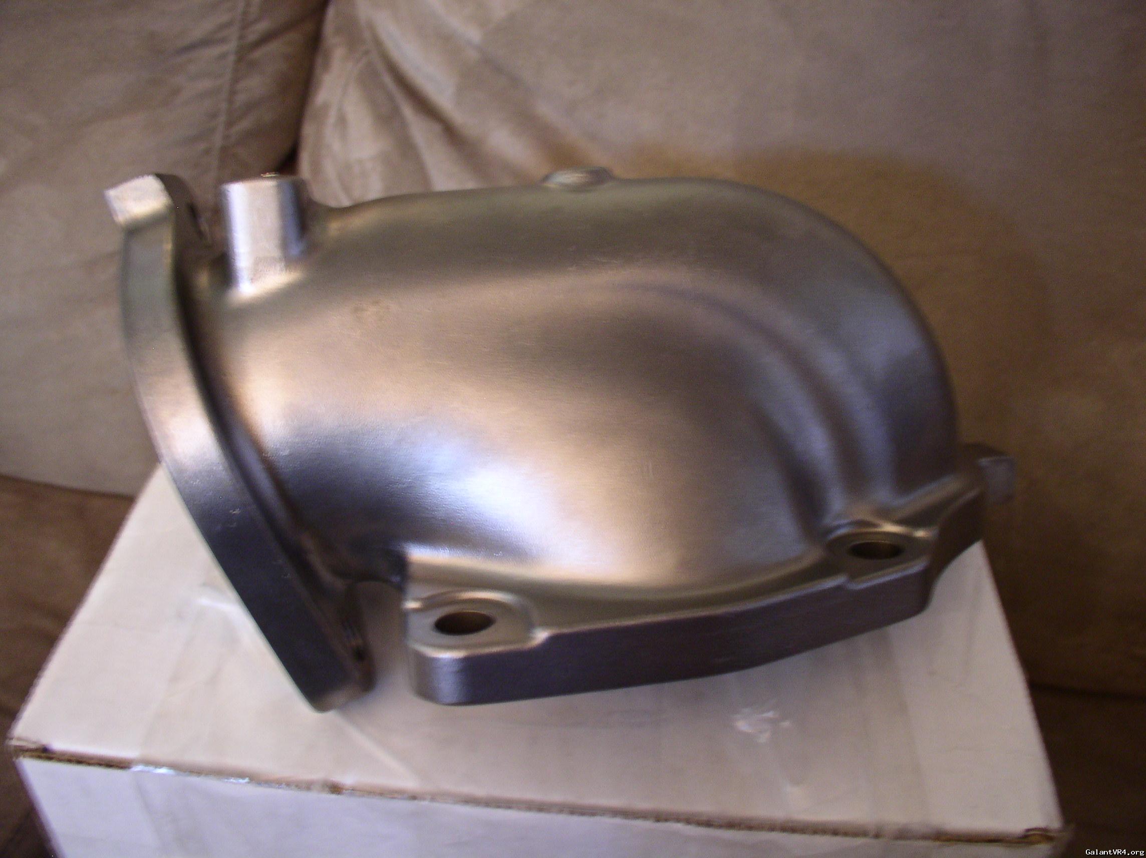

Well.. after days of search I just came up with this (and put it on order):
It's a little late but does anyone on here have any experience with them?

I'm not sure if that's what I had pictured in my head, but it looks like it will flow well! Never heard of the brand, but it's cast, so it should hold up pretty well. Seems to be dense like the FP manifolds.

Quoting doelcow:
When that arrives, could you post up some larger pictures and tell us if that will work with the stock lower heat shields.

Why, what's wrong with the pics on that website?

Quoting cheekychimp:
Paul.
Will do

Quoting steve:
/ubbthreads/images/graemlins/bowroflr.gif
ISWYDT. I thought it was my browser at first or that age was finally catching up with me and my eyesight had gone /ubbthreads/images/graemlins/rofl.gif

Nothing is wrong with the picture, that is the actual size he will be getting. /ubbthreads/images/graemlins/rofl.gif

That looks like first class manufacturing . I like the smooth inner casting.

Is that cast stainless? Looks nice whatever they did...

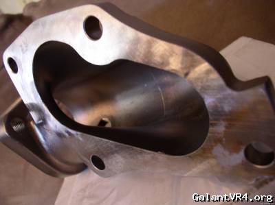

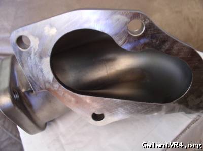

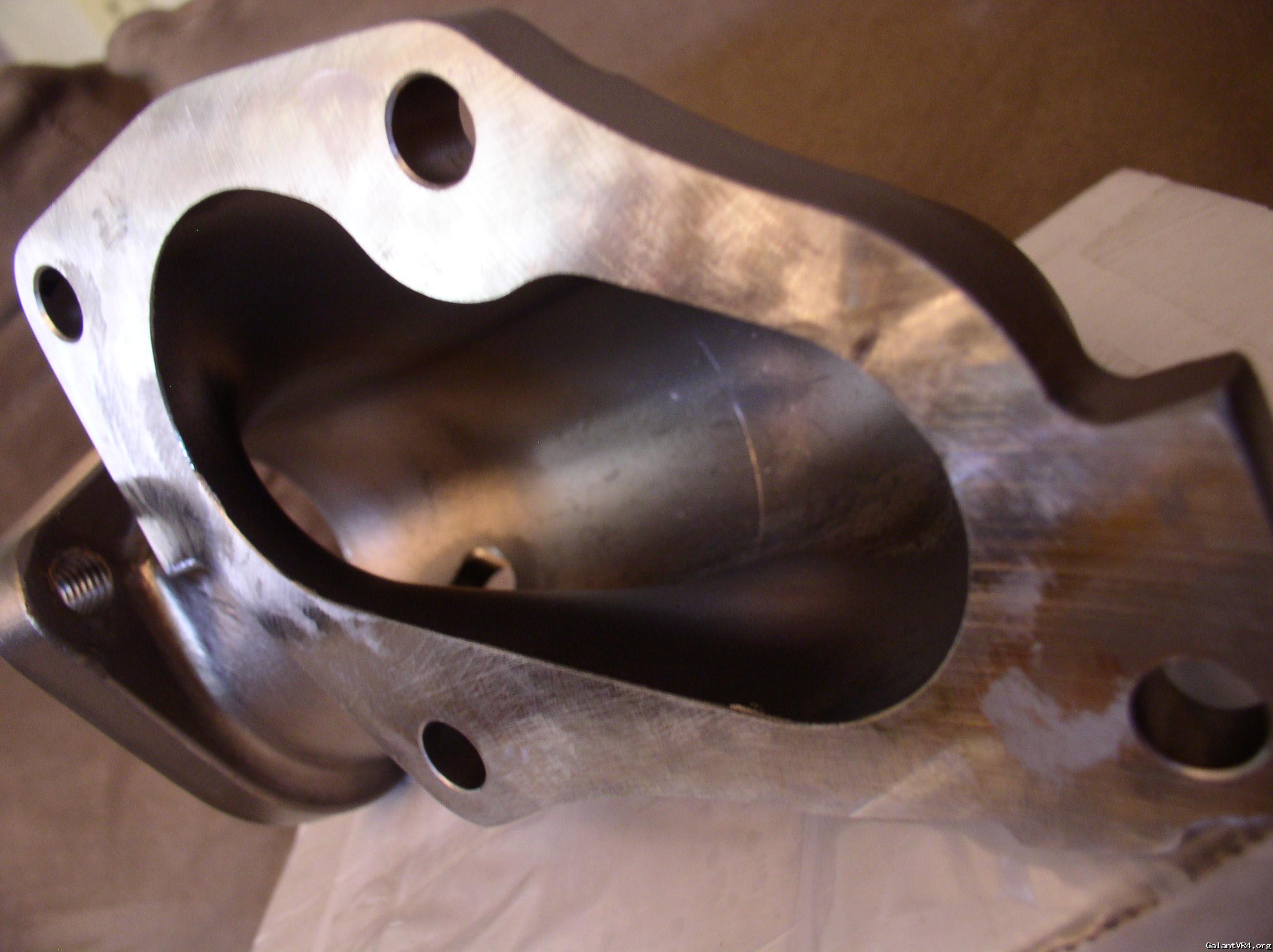

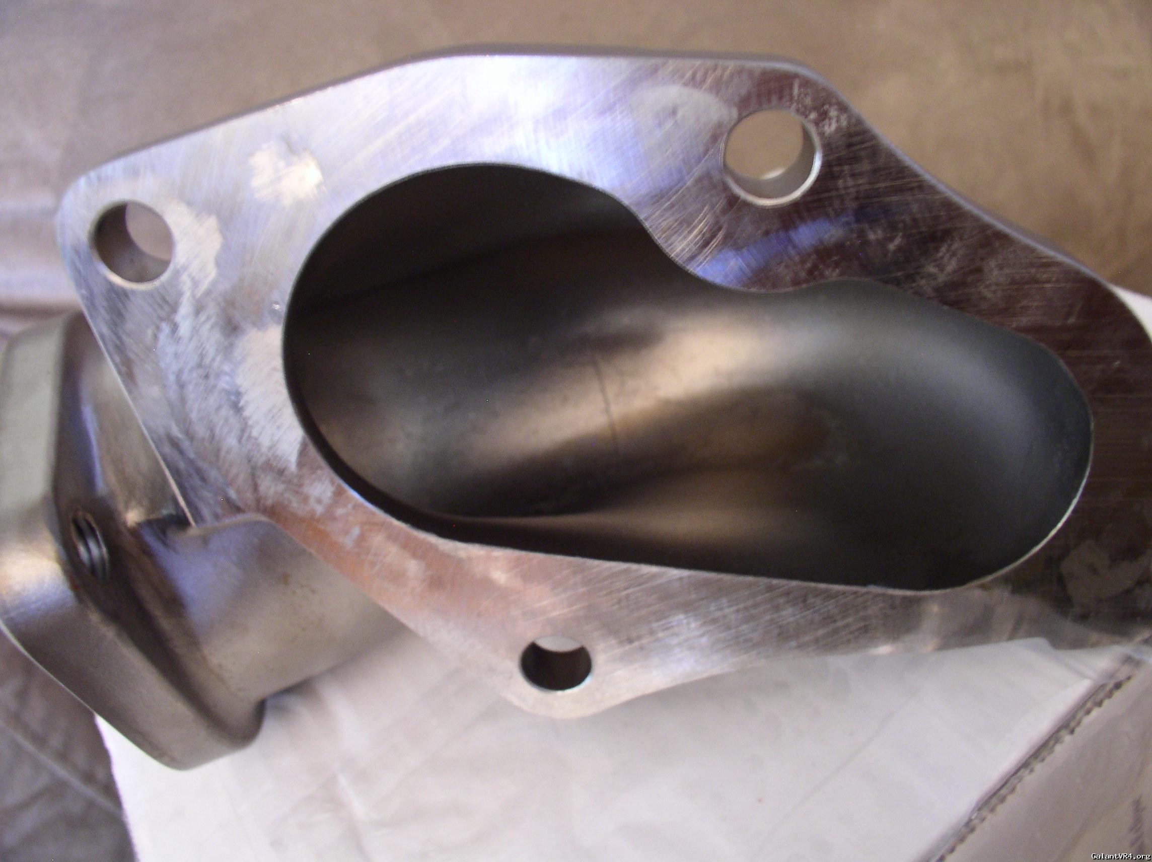

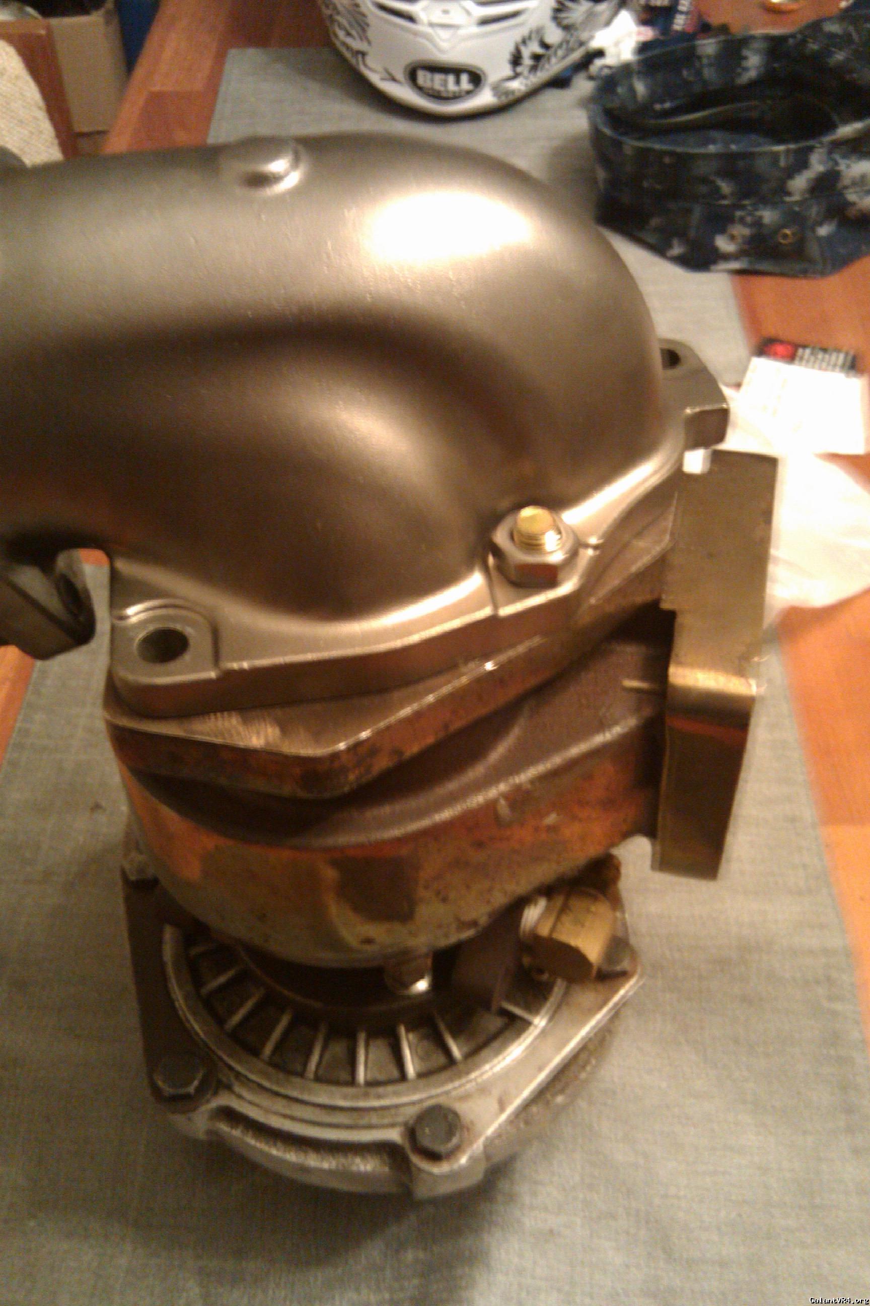

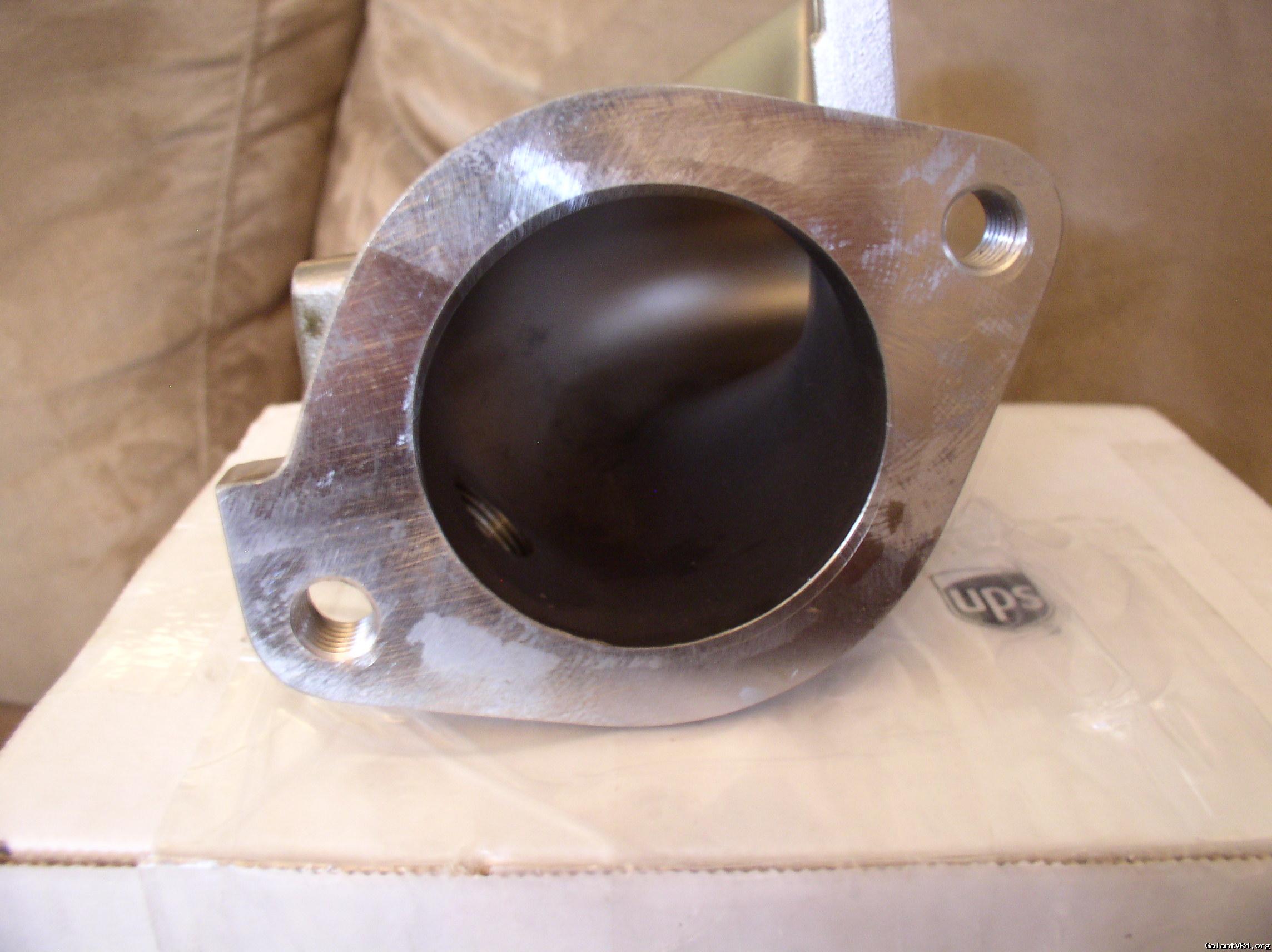

Yep. Cast stainless... line-up is garbage though. Just test fit it and it's going to take me a day to port match it...

The boss at the bottom flange looks like it's in the right place for the stock heat shield.
Port matching won't be too bad, it's less than 1/4" it appears.
