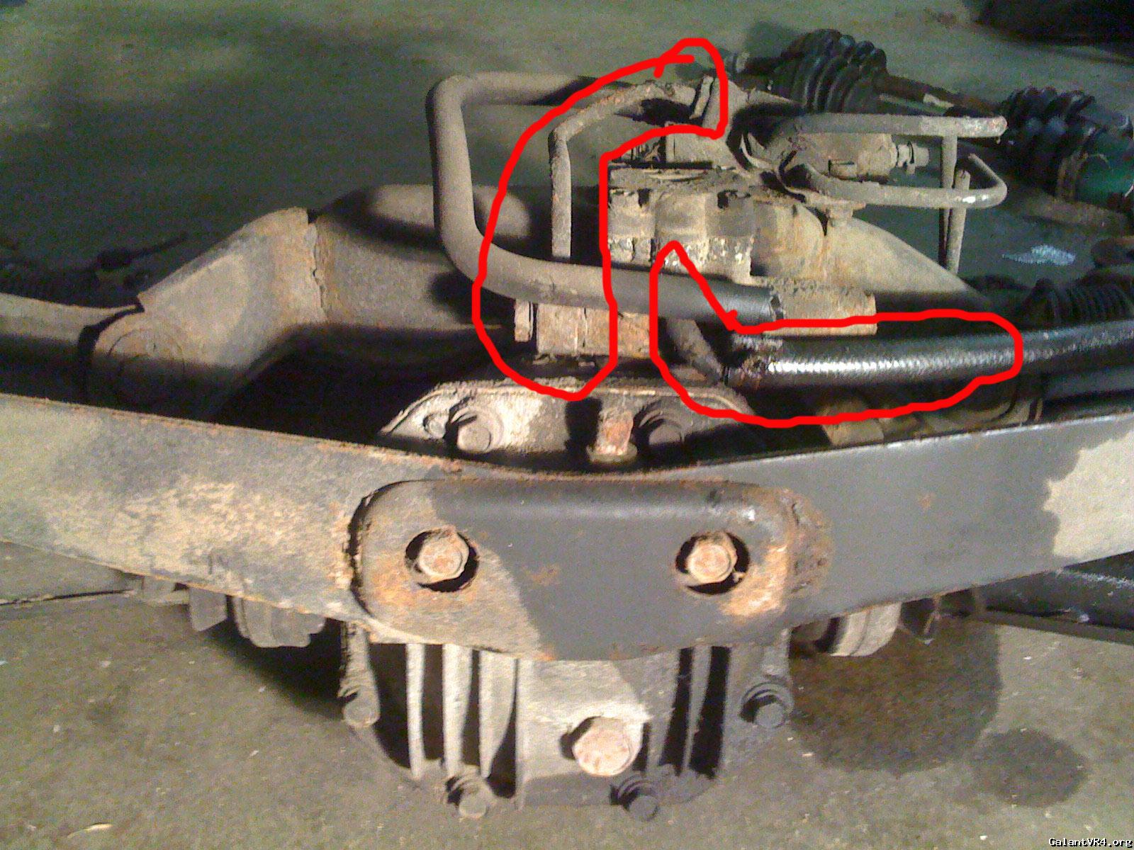

If I am dropping out just the rear diff for replacement (not the entire crossmember), are there specific lines I need to disconnect before doing so? I thought about searching, but don't recall this ever being discussed specifically.

are you deleting the 4ws or just changing the diff?? if you are just changing the diff you might not have to disconnect any lines. just remove the bolts to the 4WS pump.

If I remember correctly, the rear diff has 2 lines plumbed into it. You have a low pressure feed line from the PS resivoir and a high presure line out to the rear rack rack.
Good luck getting those lines to break loose.
