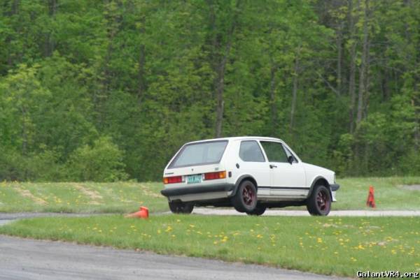

What tires are you running? With sticky enough tires and a stiff enough rear sway bar I would guess that 6"-8" of inside rear tire lift is possible. Not quite VW A1 GTI tripod territory, hopefully?

Your issue doesn't seem to have anything to do with your rear differential, but rather the suspension you're running. Too much body roll results in your unloaded rear tire parting company with terra firme.

My car lifts the rear tires really easy too, I think I made a post how I got stuck in a parking lot because of it too. haha
I think my evo rear shocks just don't have enough travel, as soon as the body starts to roll the wheel comes up.
On uphill tight turns I just blast the inside tires loose in 2nd gear. I don't think the car has much body roll, doesn't feel like it at all.
But I really love my evo mr shocks. It's like I need to lower it another 3 inches in the strut travel and lower the shock towers. Seems really dumb, guess the rear shocks just aren't perfect or maybe I have no idea what I'm talking about. I'm going with the latter /ubbthreads/images/graemlins/laugh.gif
