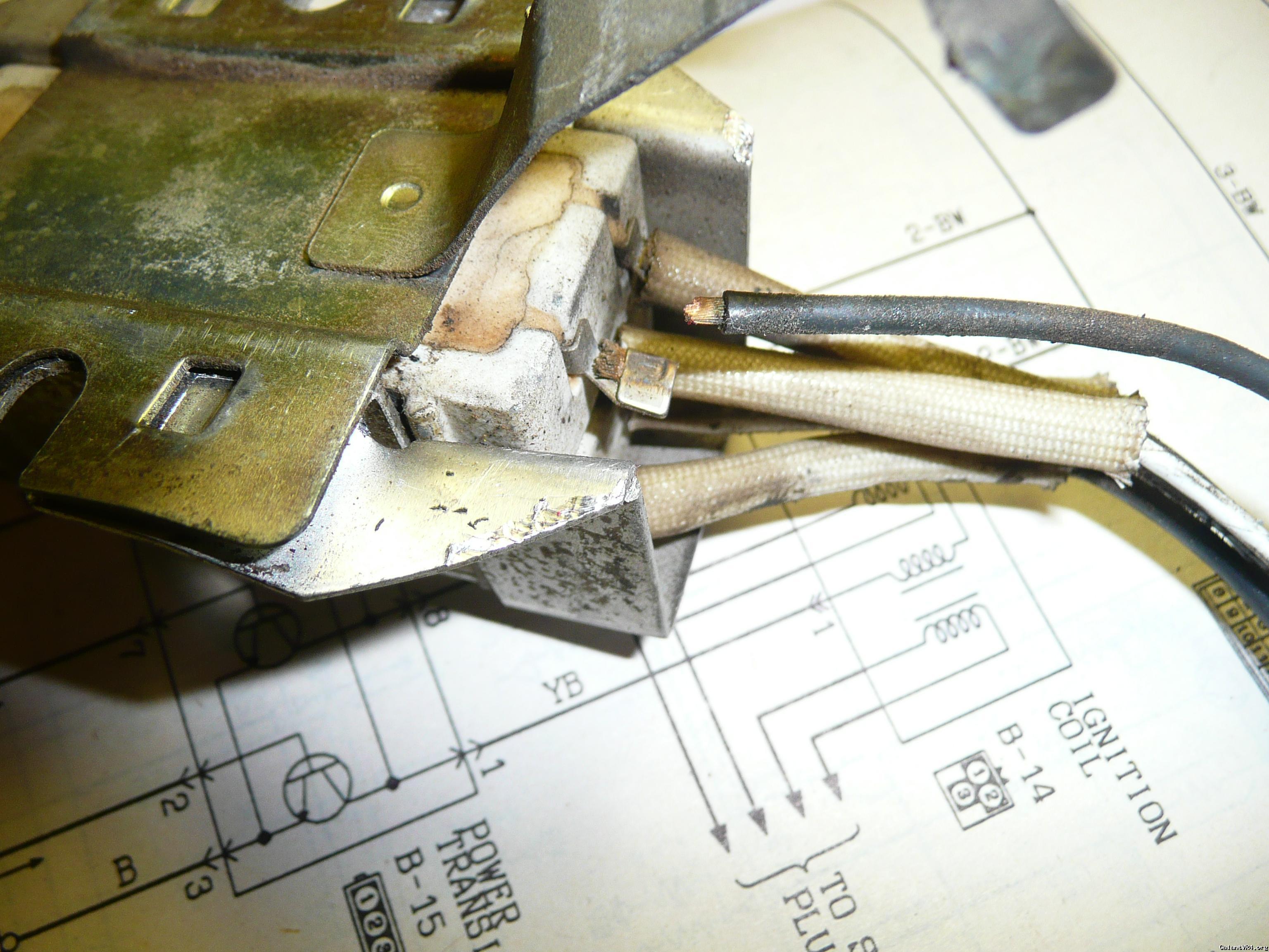

Check the four coils of the injector resistor with an ohmeter. They should all be the same, ( +/- just a schosche.)
Check the wires at the resistor

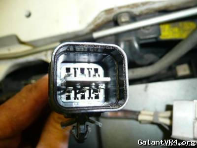

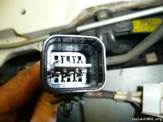

Slide the little cotton sleeve back enough to check the integrity of the wires at the resistor. I've seen a few that had the wires breaking/broken there.
This one kicked my ass!
Notice the pin that's slid down a scosche. When you'd plug it in that lil bastid would back out of the housing like a two dollar whore on dollar night ...
So, yea, learned the harday that the pins can back out of the injector resistor connector, and give just enough continuity to fool the voltmeter and the noid light. It was only when the injector was plugged back in that there wasn;t enough continuity to get the job done reliably.
