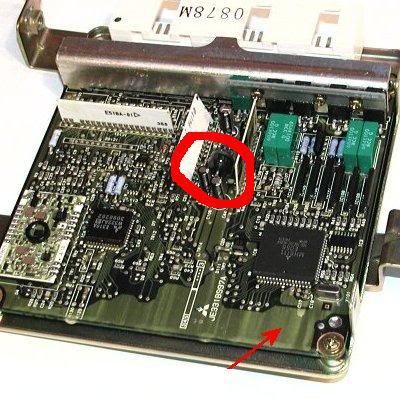

i took it out opened it and saw a somthing was fired here

Try replacing the ECM with a known good one, if you can find one to borrow. Can you take a picture of the 'fired' part of the ECM?
we tired that actuly tired 4 diffrent once no resalt
sorry dont have the box anymore it was core for out local Mitsu Galant Guru
its a small Smd Component in the area i pictured
The small surfacemount part is just a .1uF capacitor, with is not essential to the proper operation of the ECU. But, it proves that your ECU was the victim of leaking capacitors in that same area:
