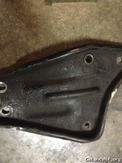

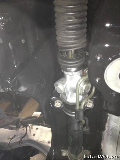

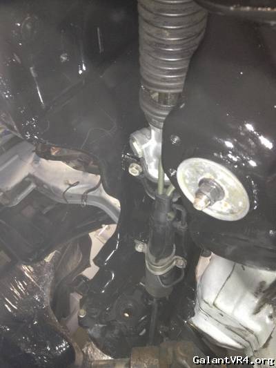

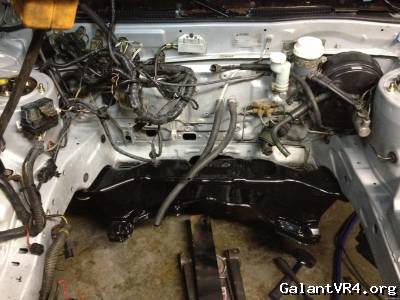

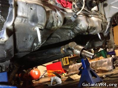

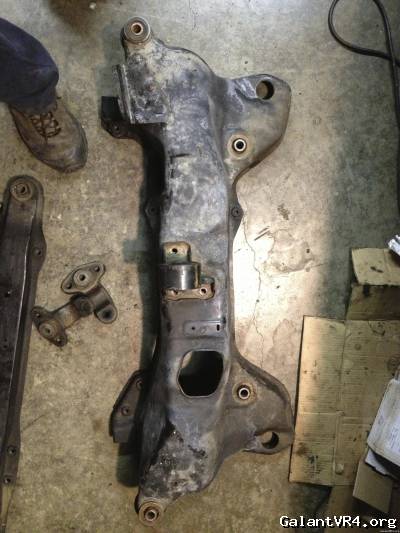

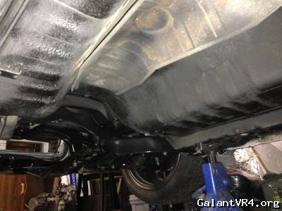

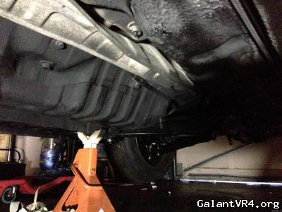

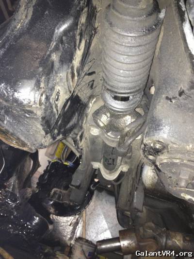

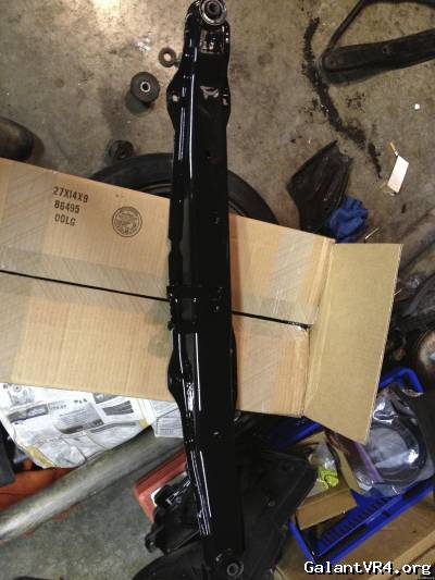

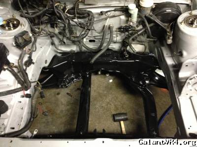

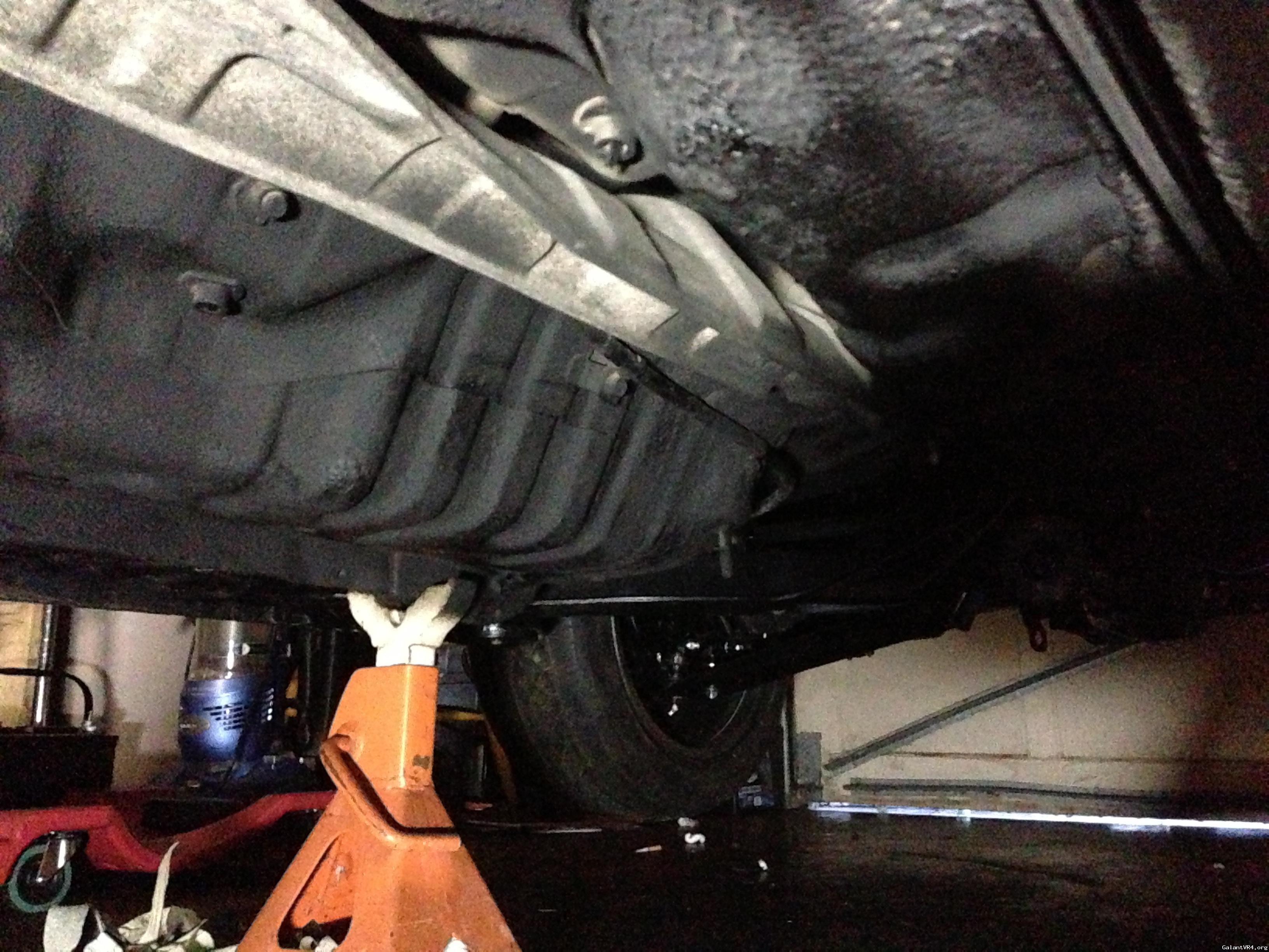

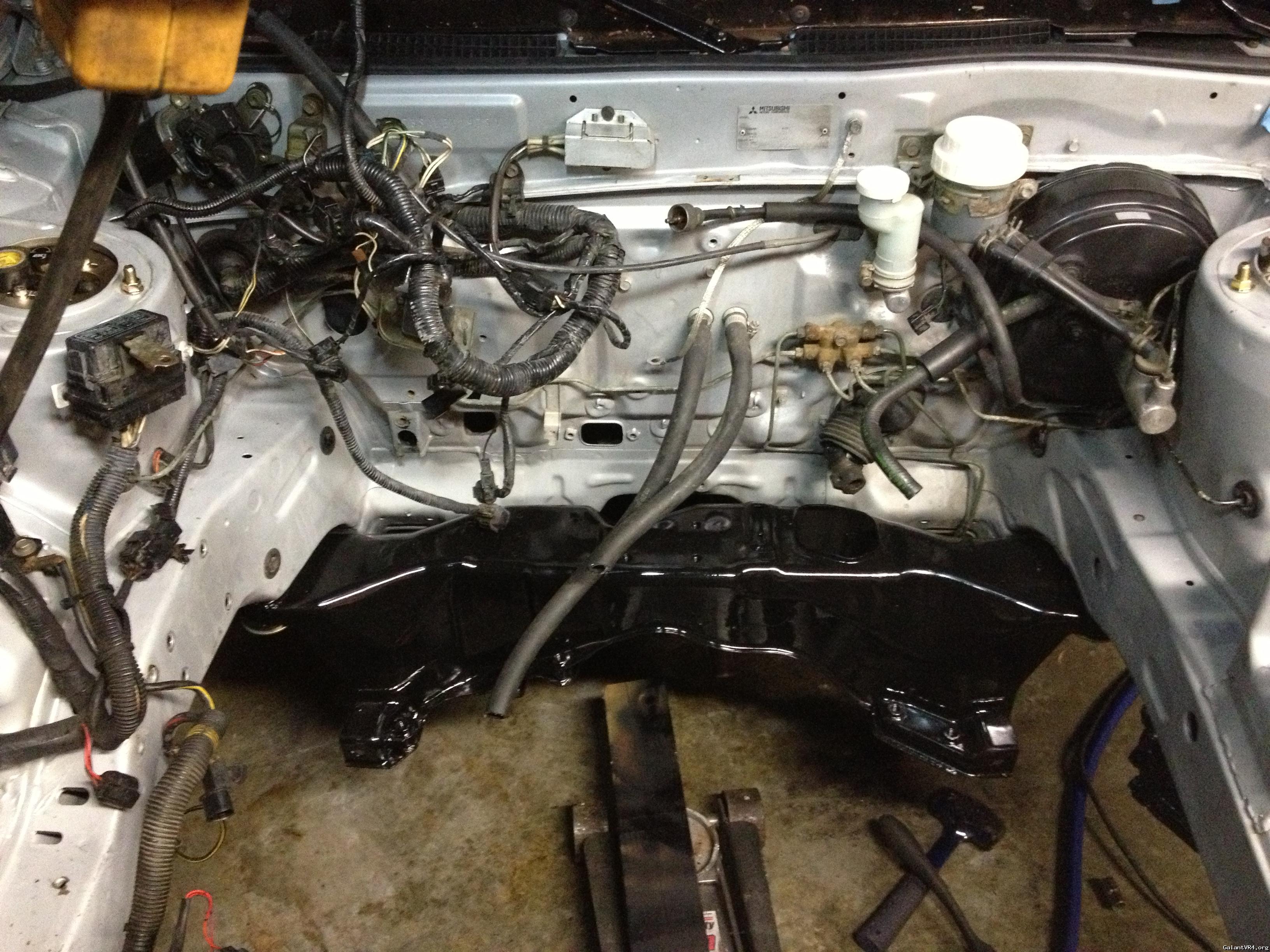

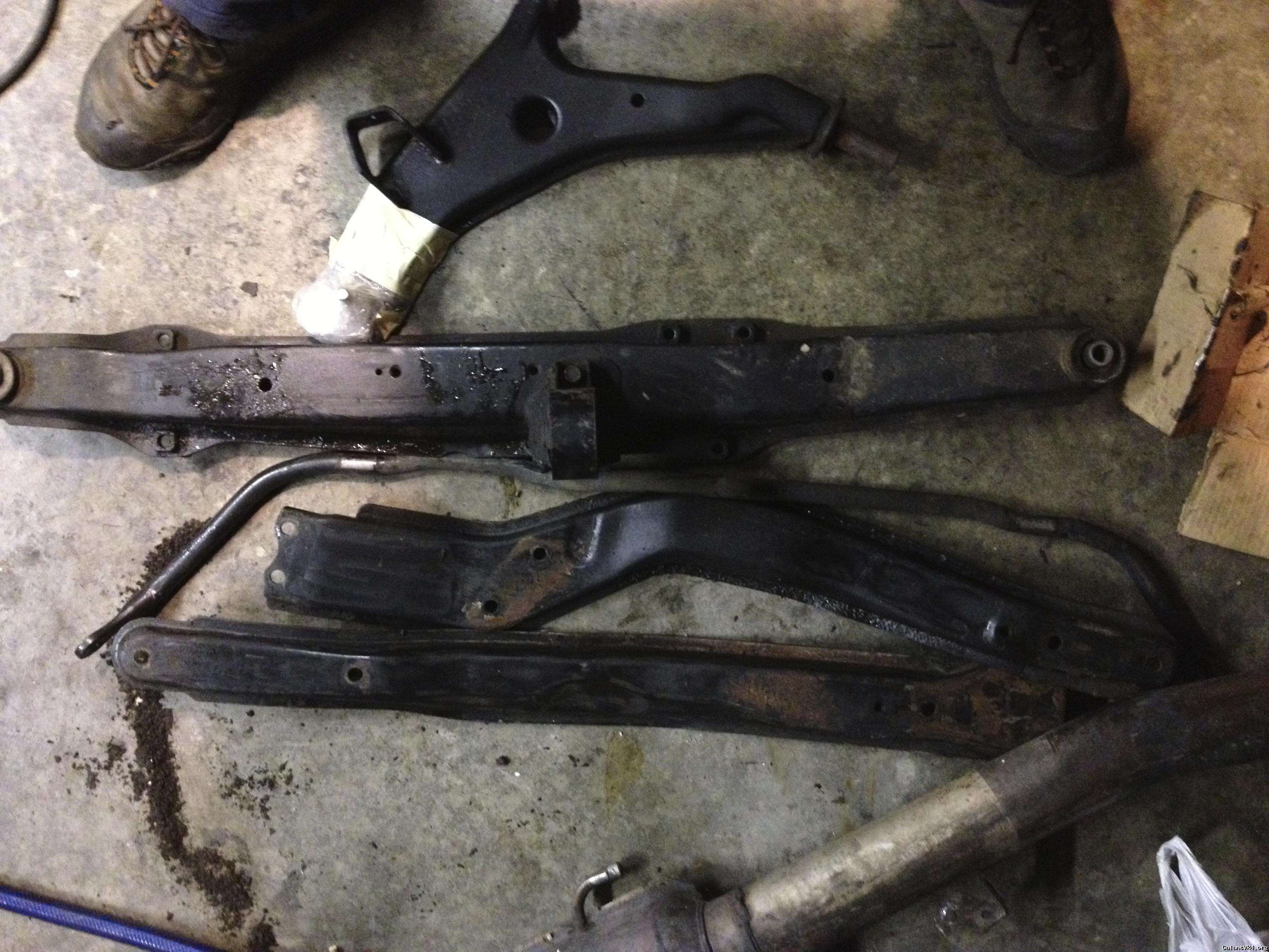

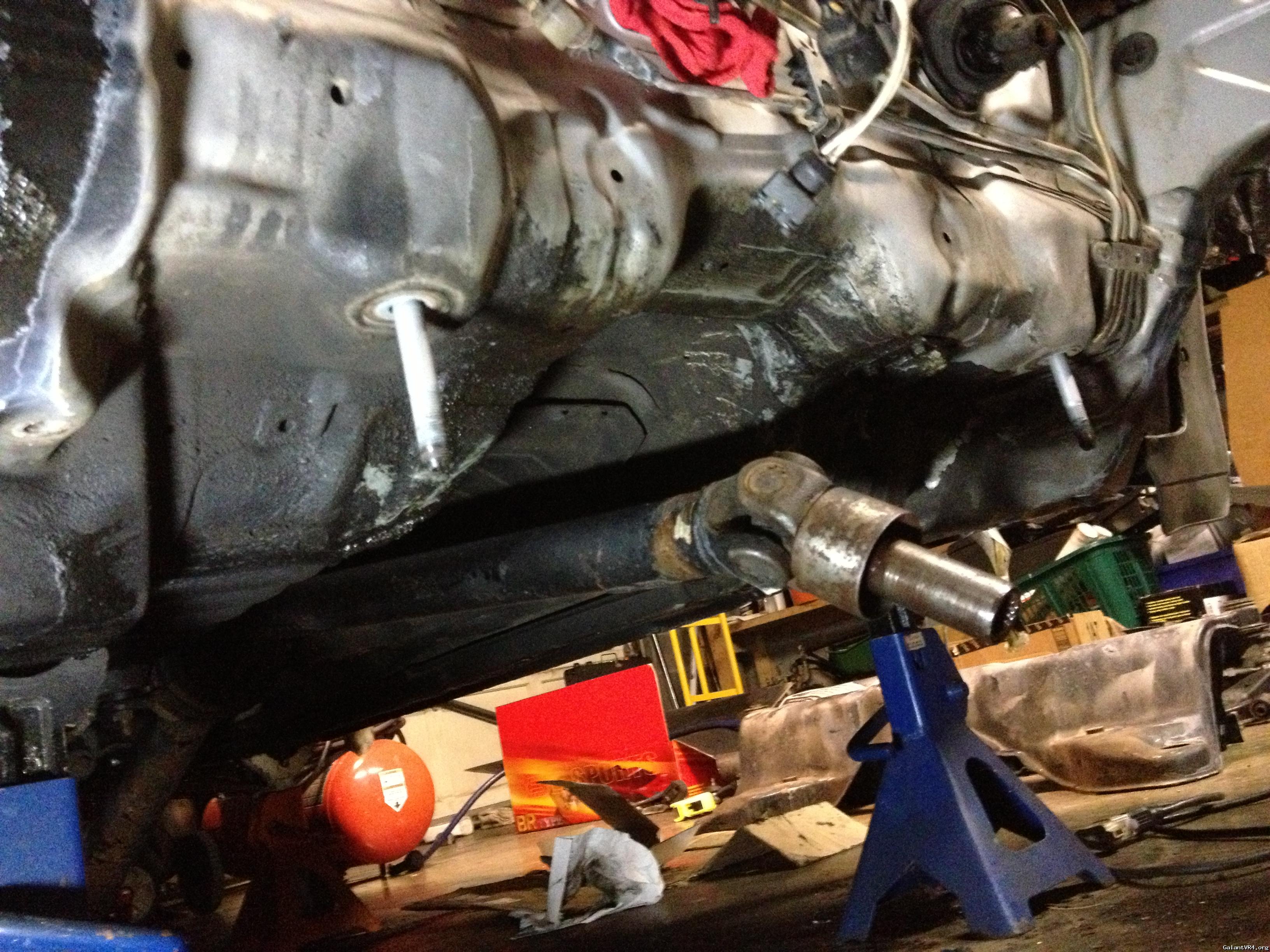

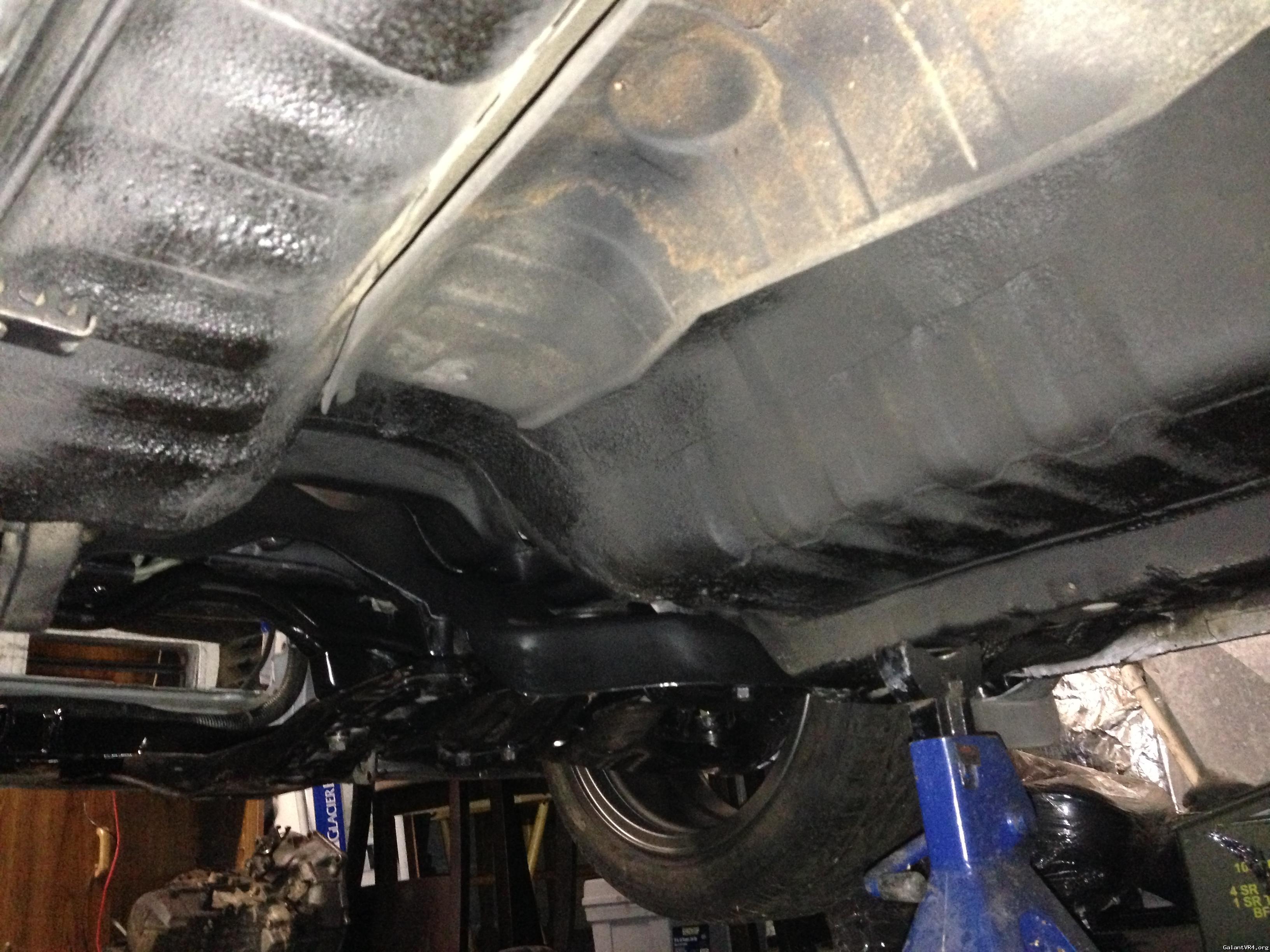

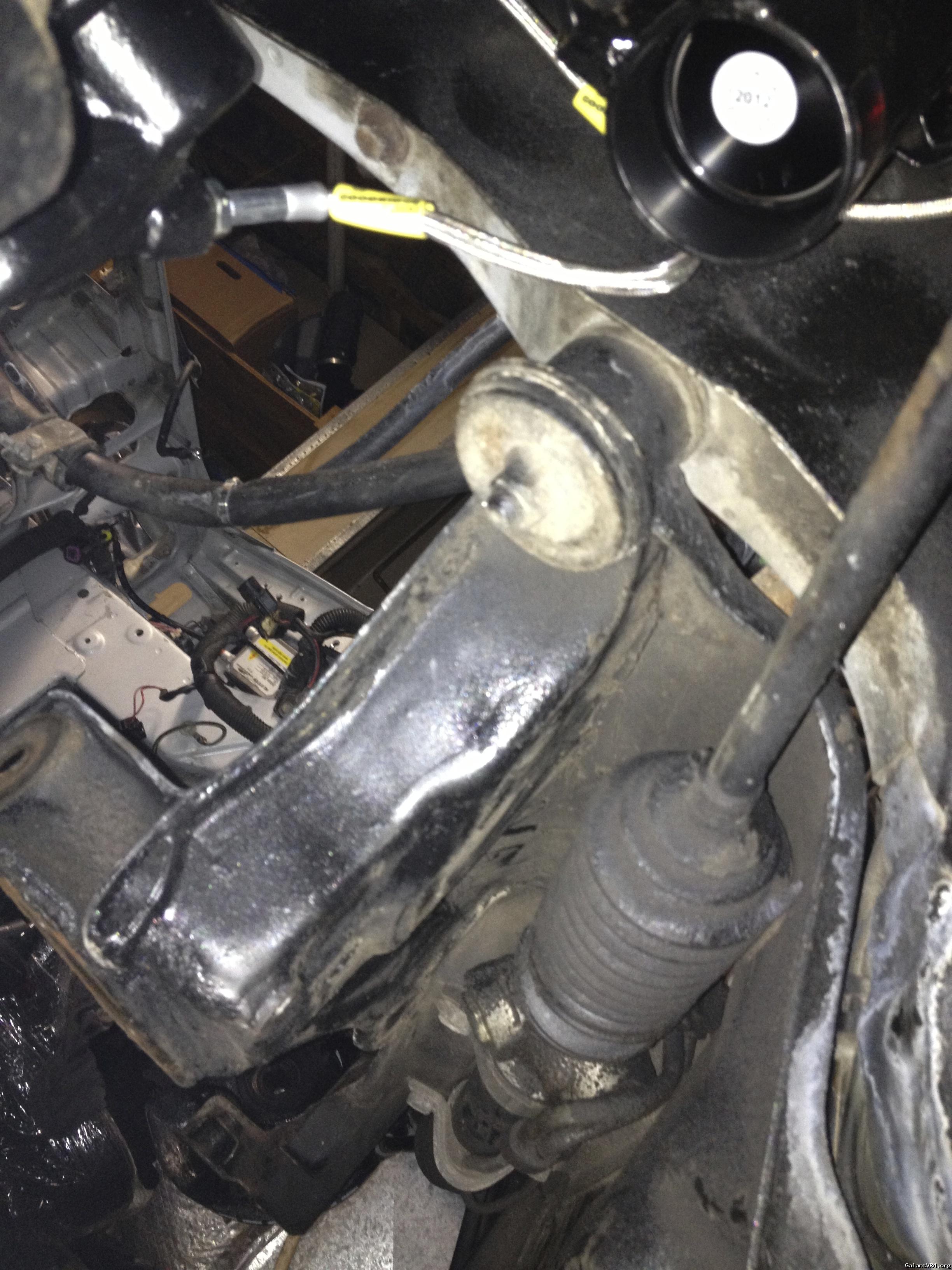

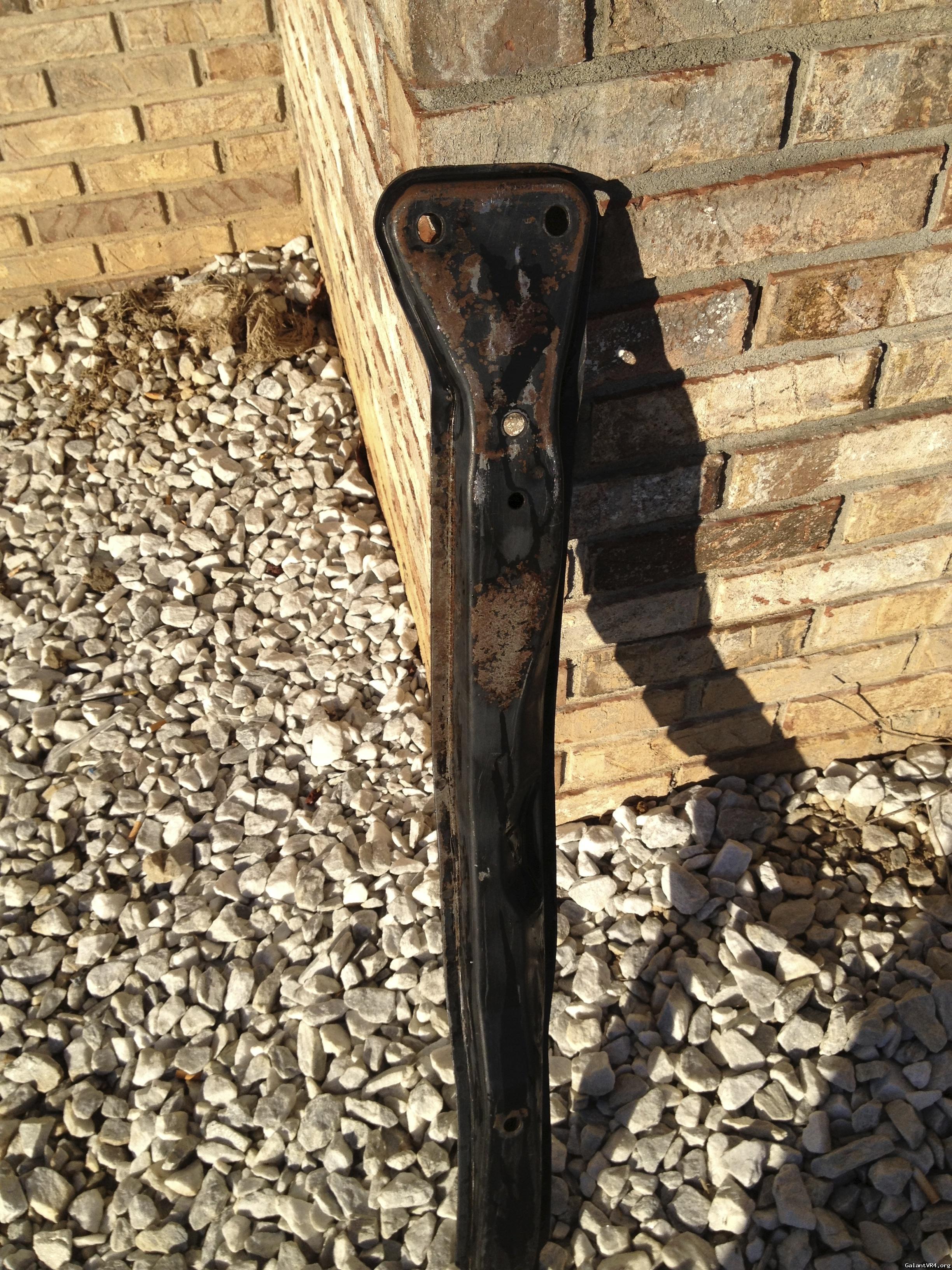

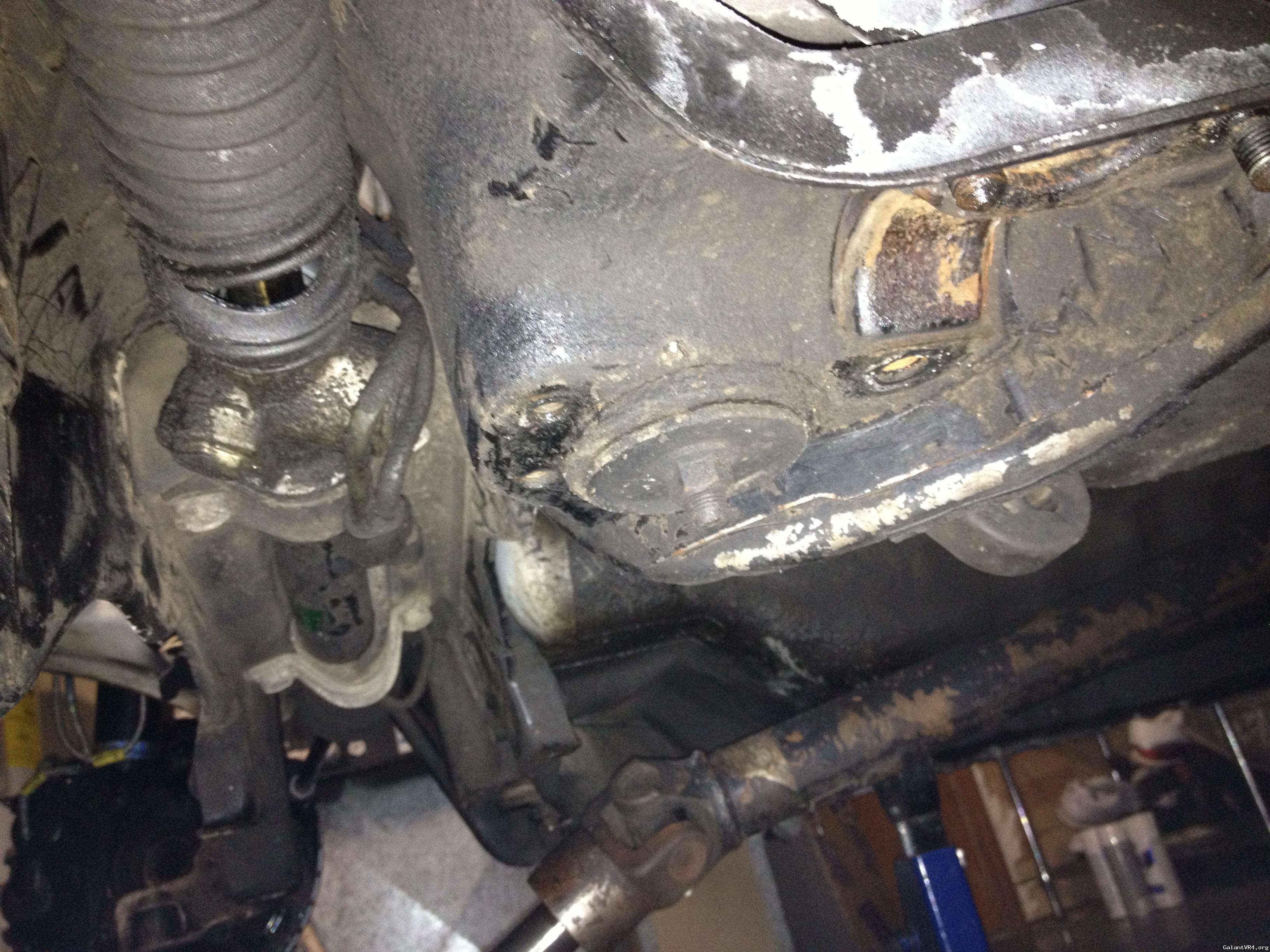

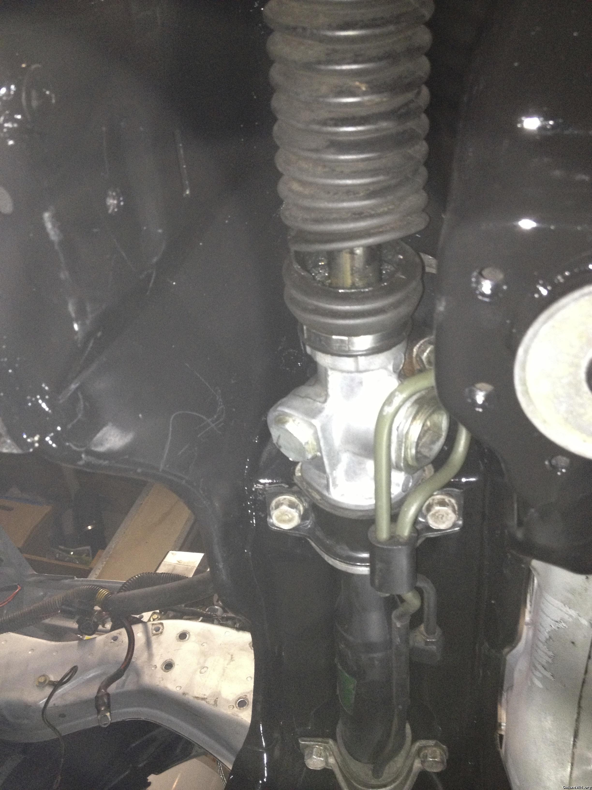

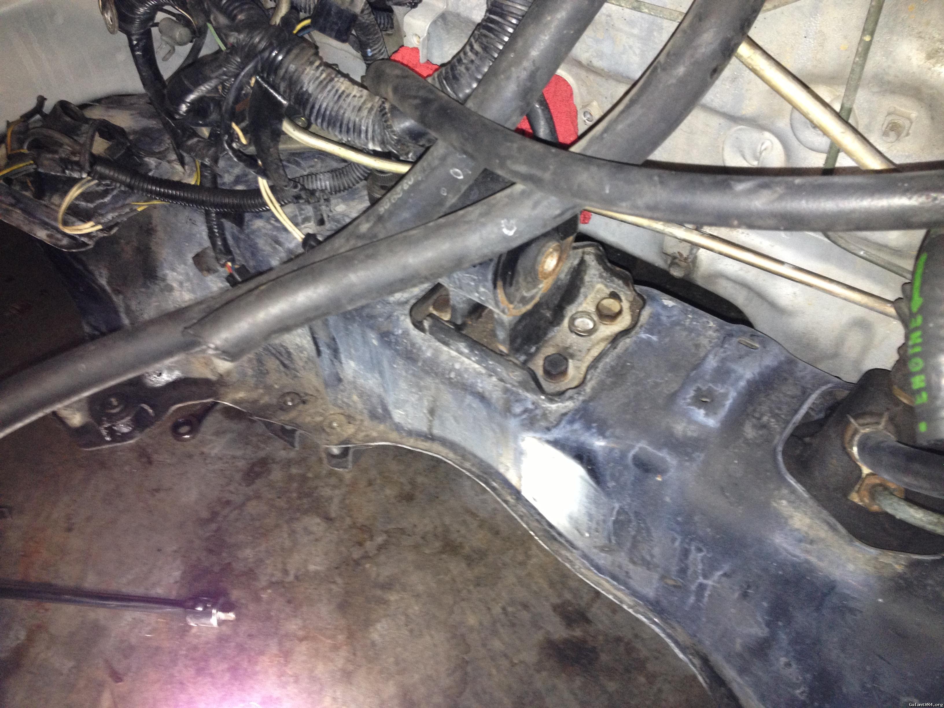

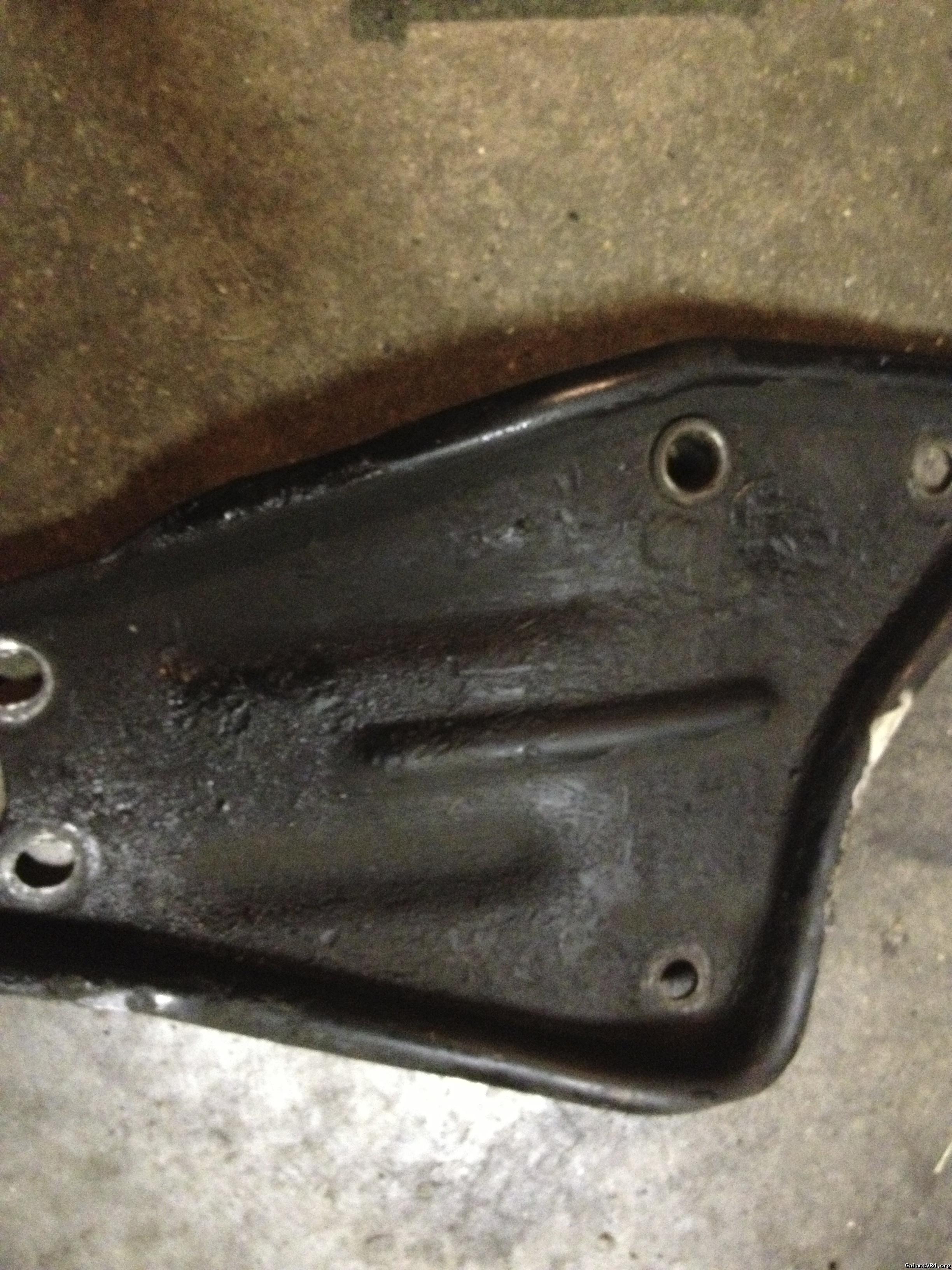

Cleaned underneath and sprayed rubber coating photos didnt come out well but all of car was undercoated

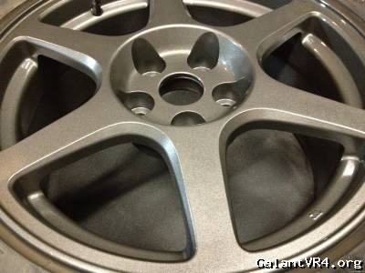

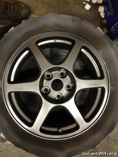

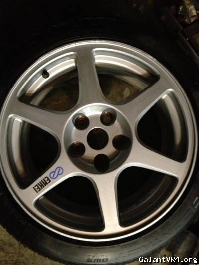

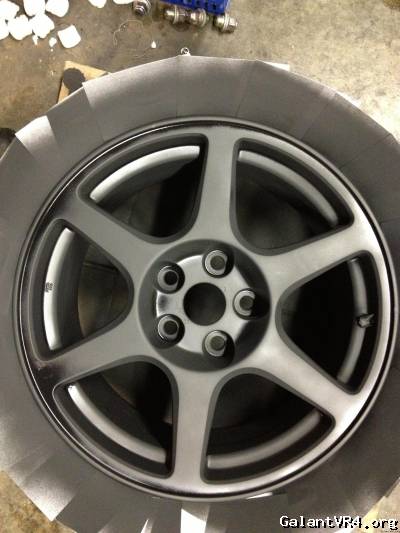

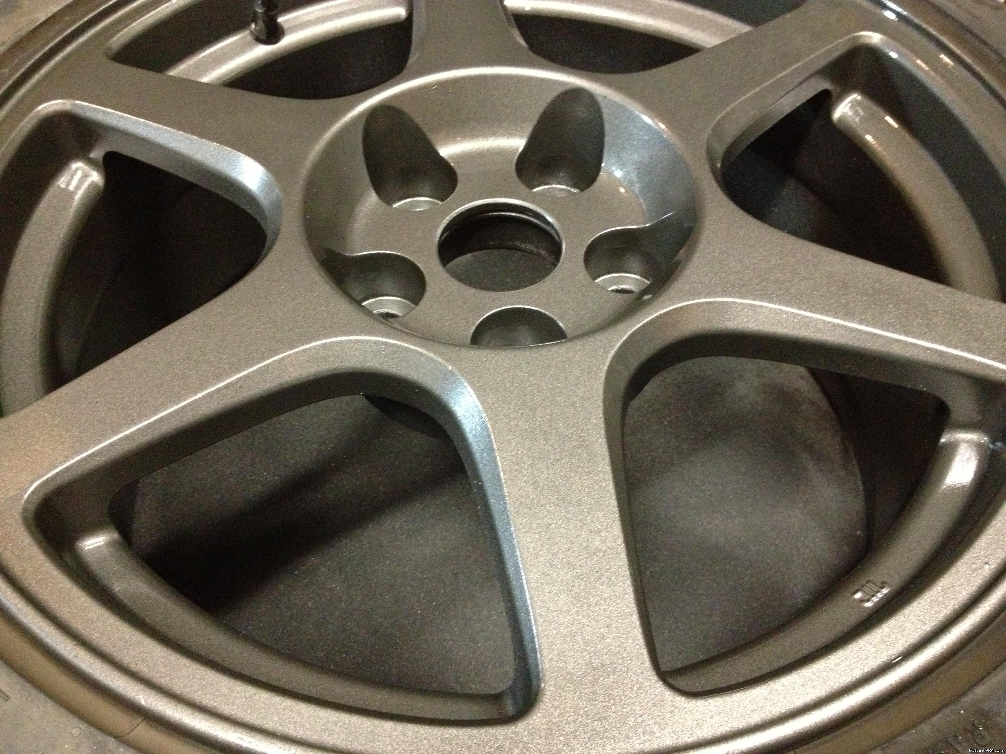

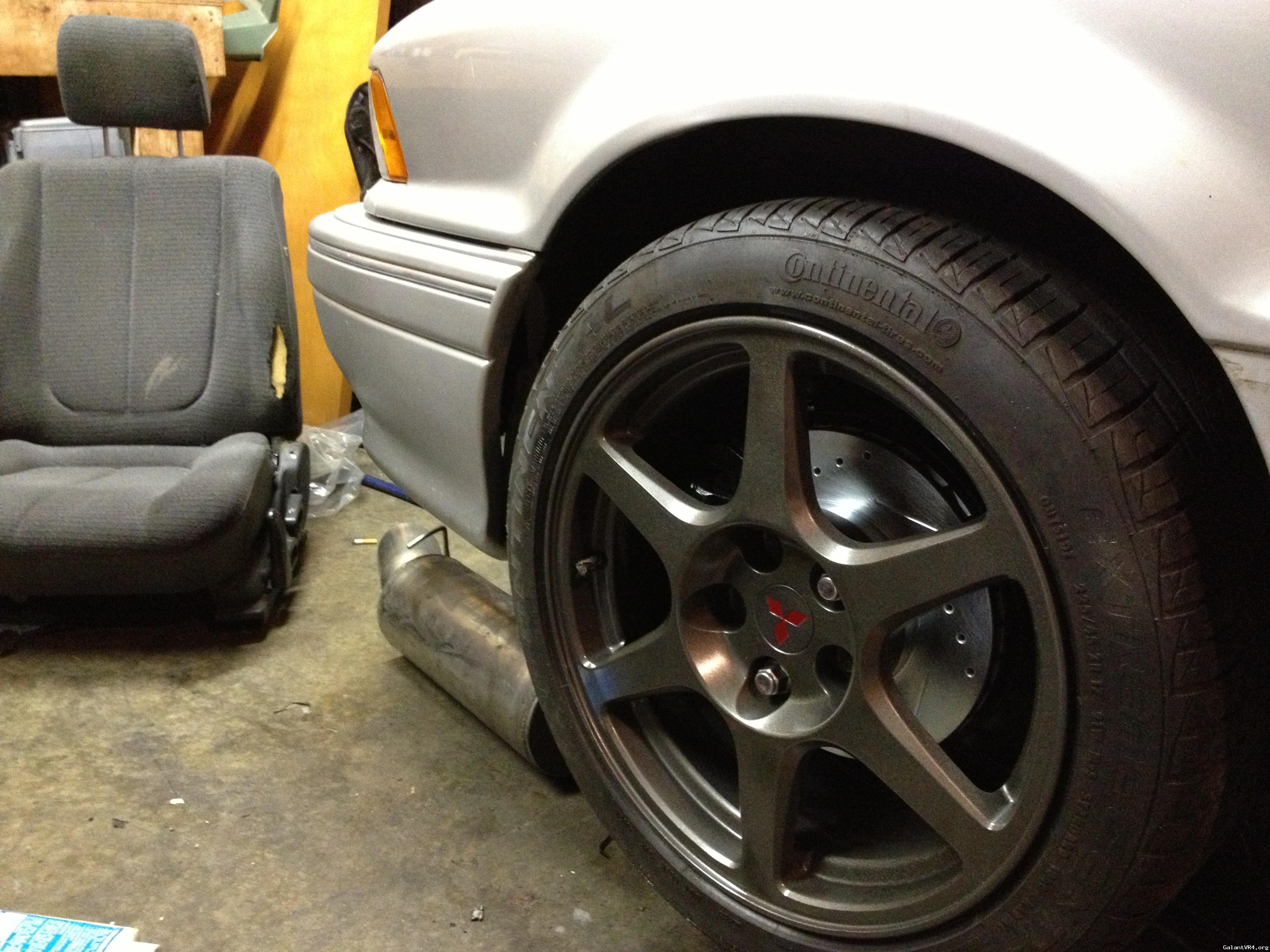

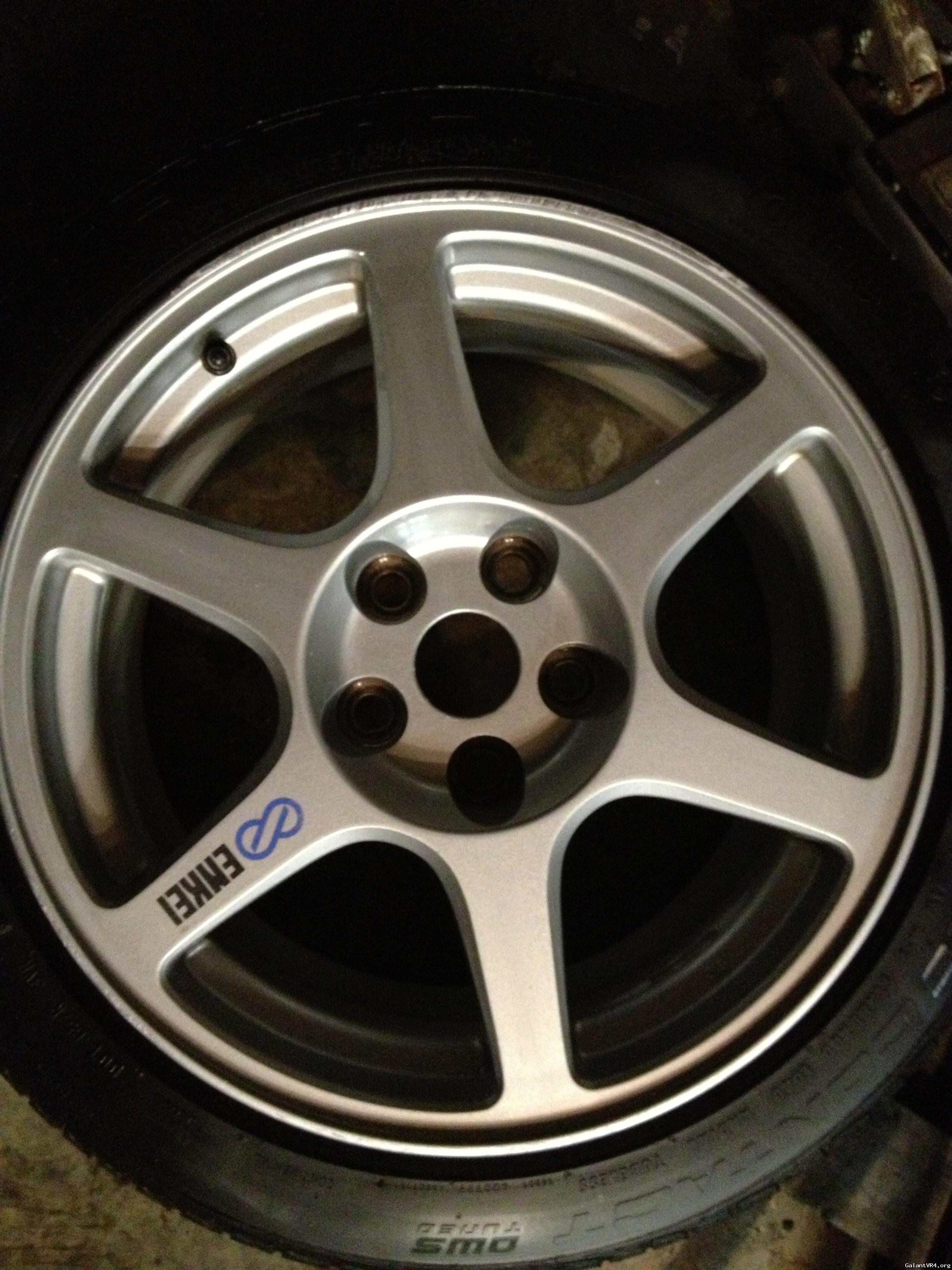

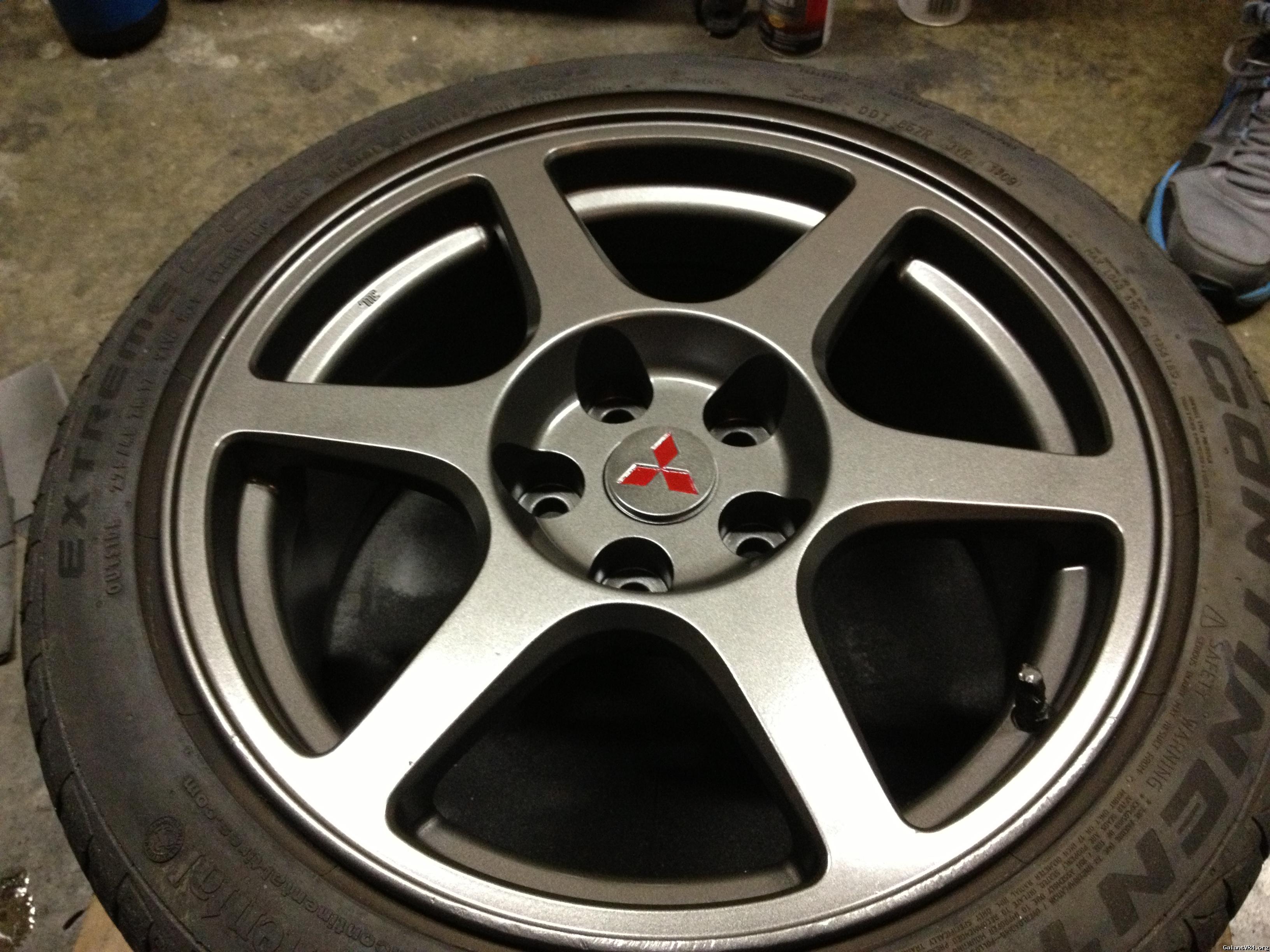

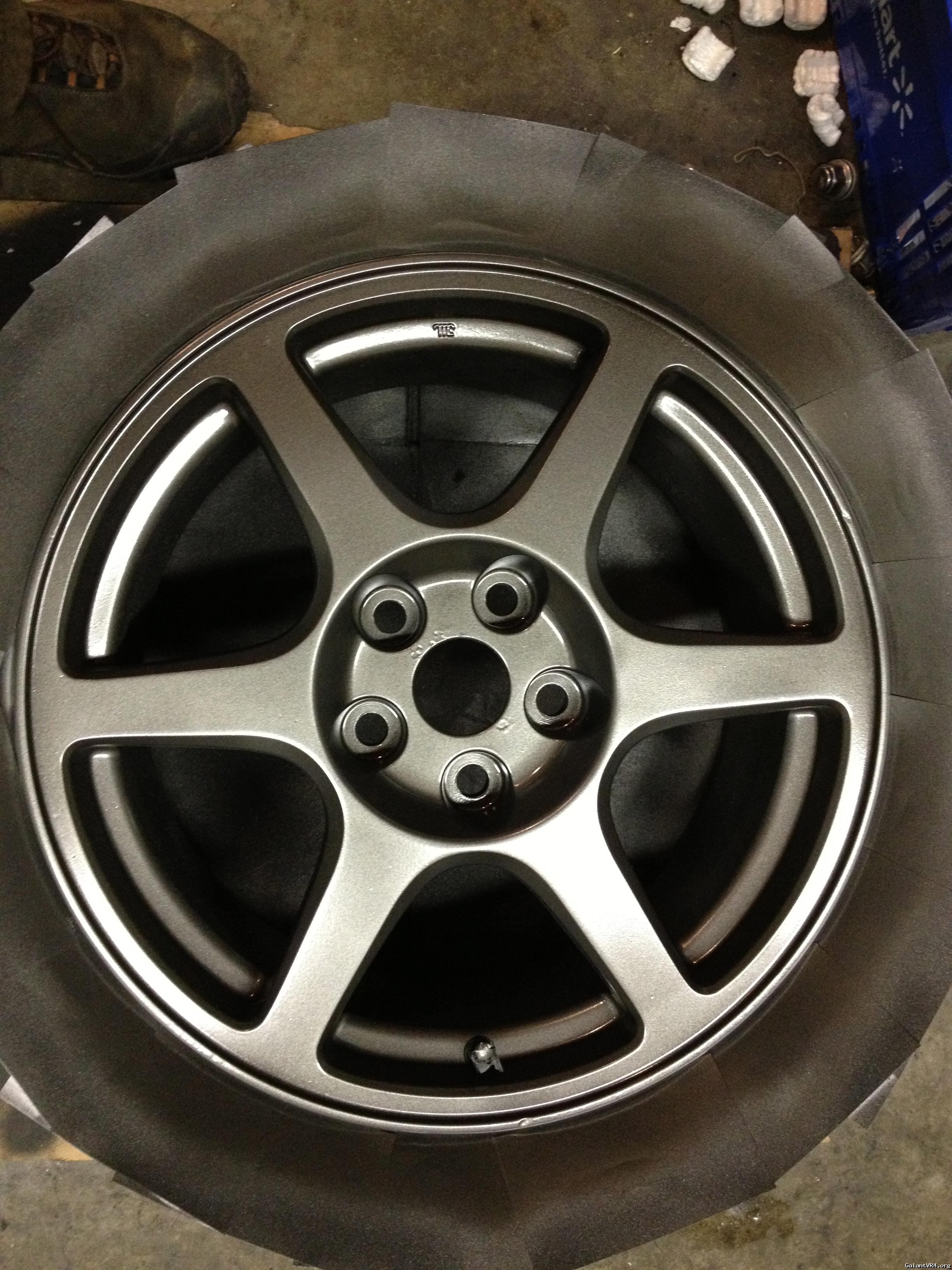

Wheels: First I cleaned and degreased them, then lightly sanded them and filed down curb rash
Primered
I didn't want to be like everyone else and have black wheels (no offense) I wanted to be slightly different. I bought VHT "Cast Iron" Engine paint and Clear coat, the color has a little sparkle to it, Looks amazing in the light or up close.

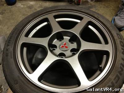

After a couple coats of paint and clear
Then did the same to center caps then painted the Diamond "Ferrari Red" with model paint then cleared it

Great job. Looks great. Reminds me when I did mine. Have fun!

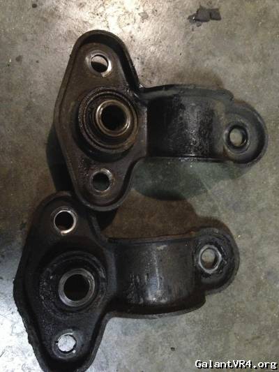

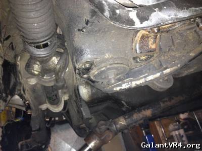

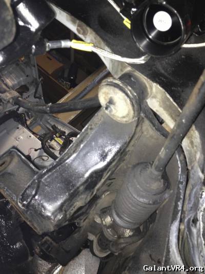

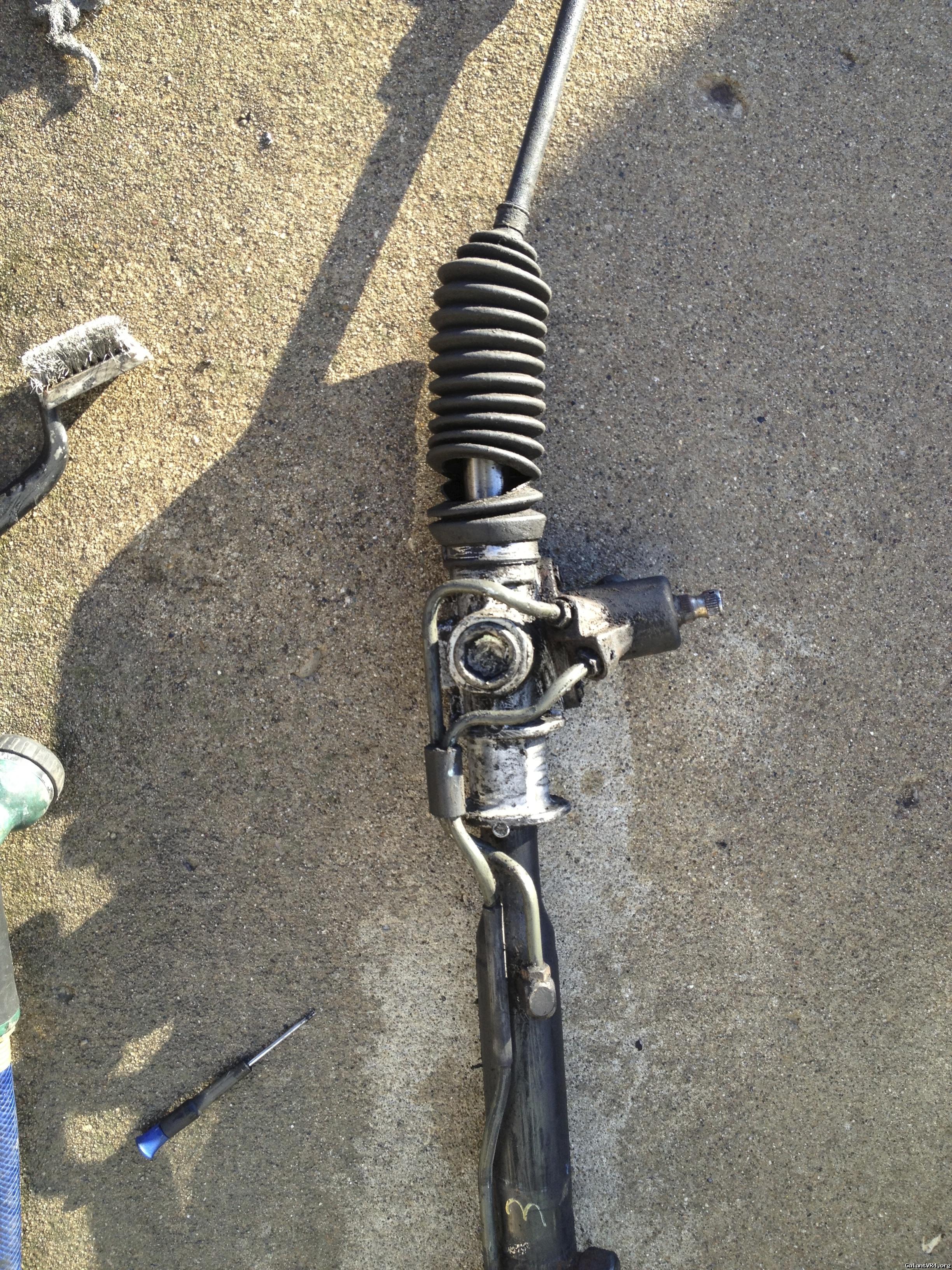

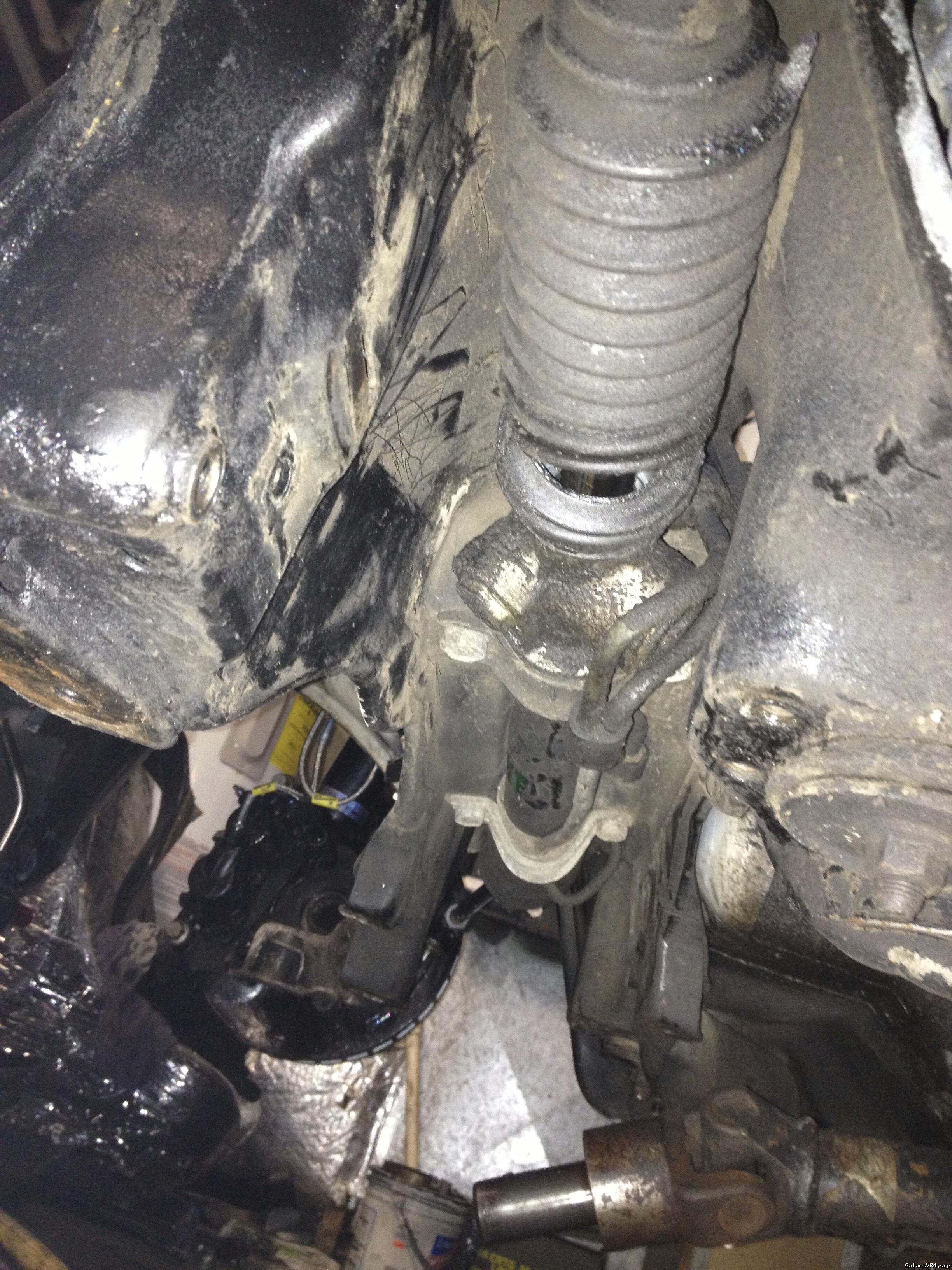

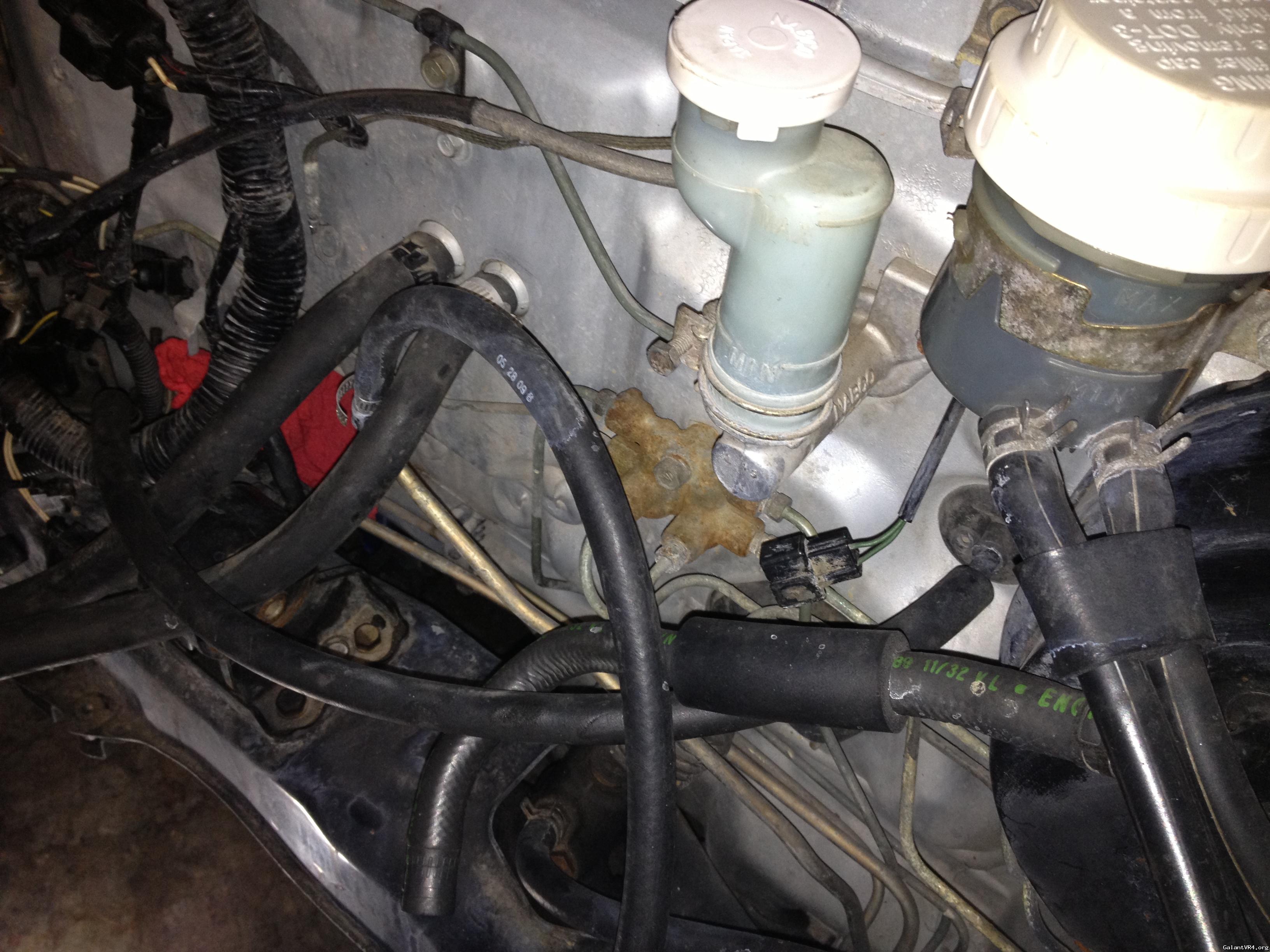

So, nice job you are doing, but why not replace the torn tie rod boot when you had it apart?

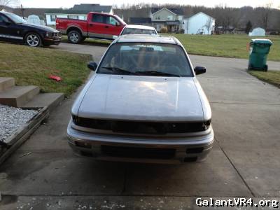

Some exterior Stuff:

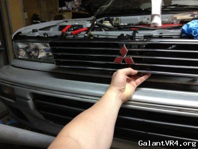

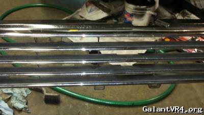

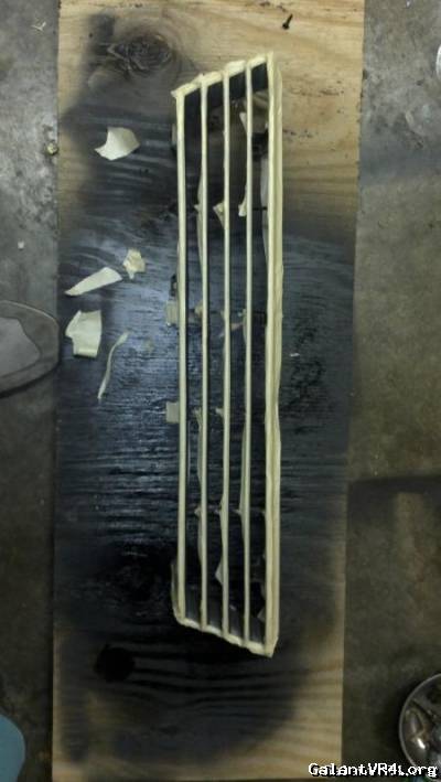

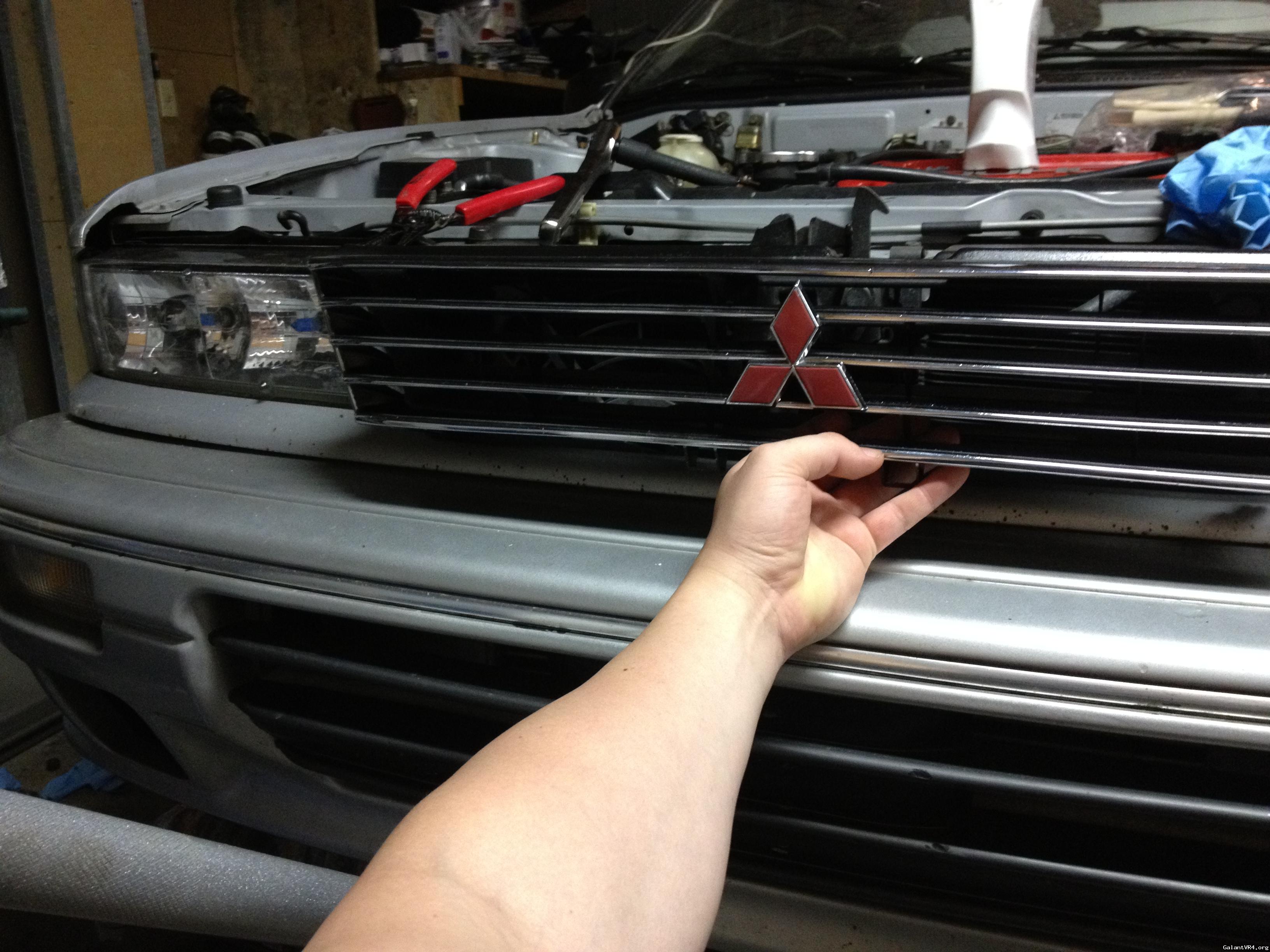

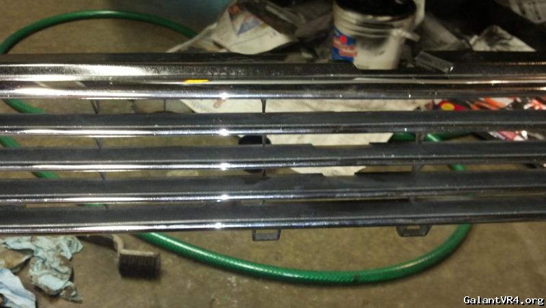

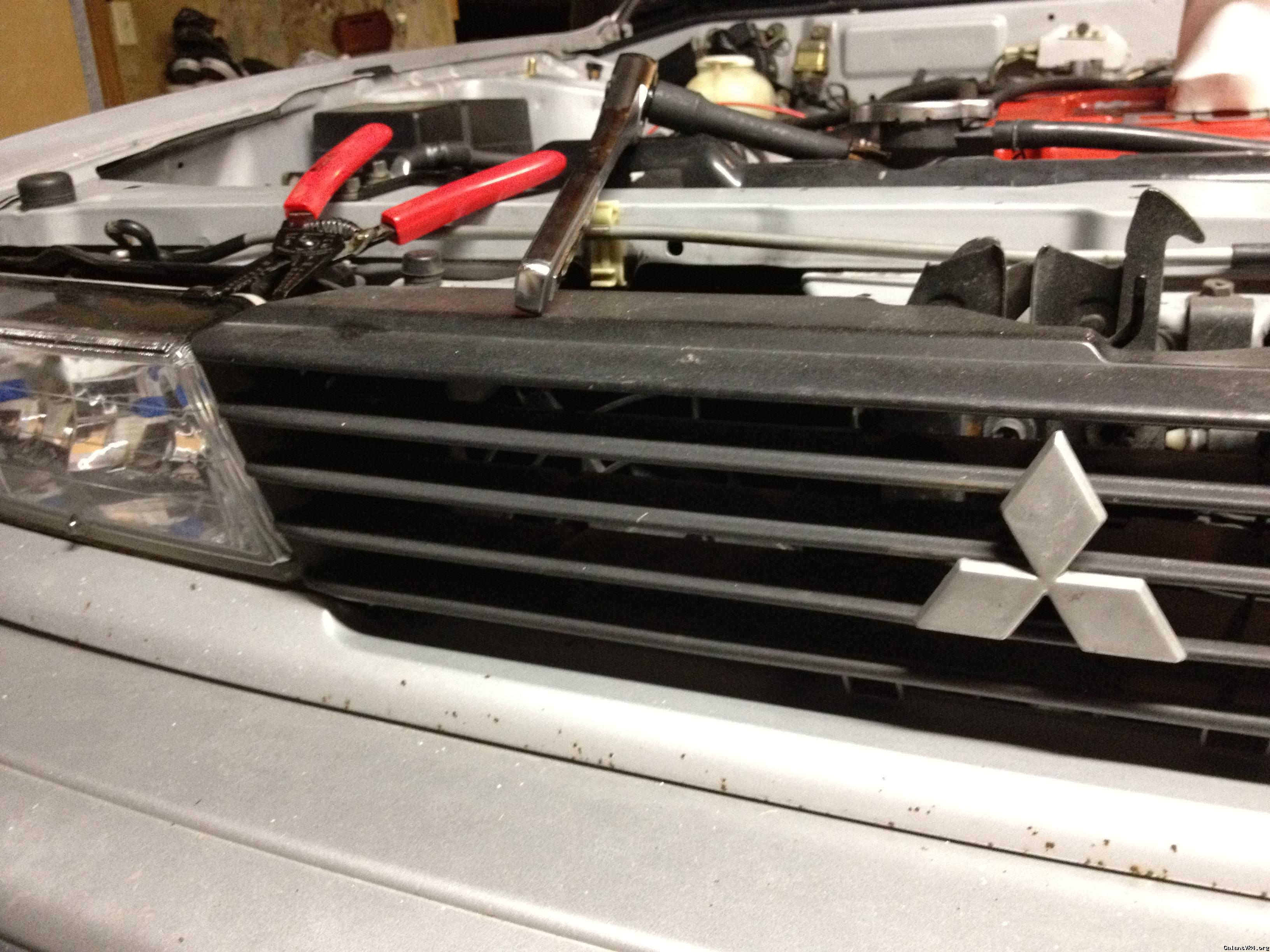

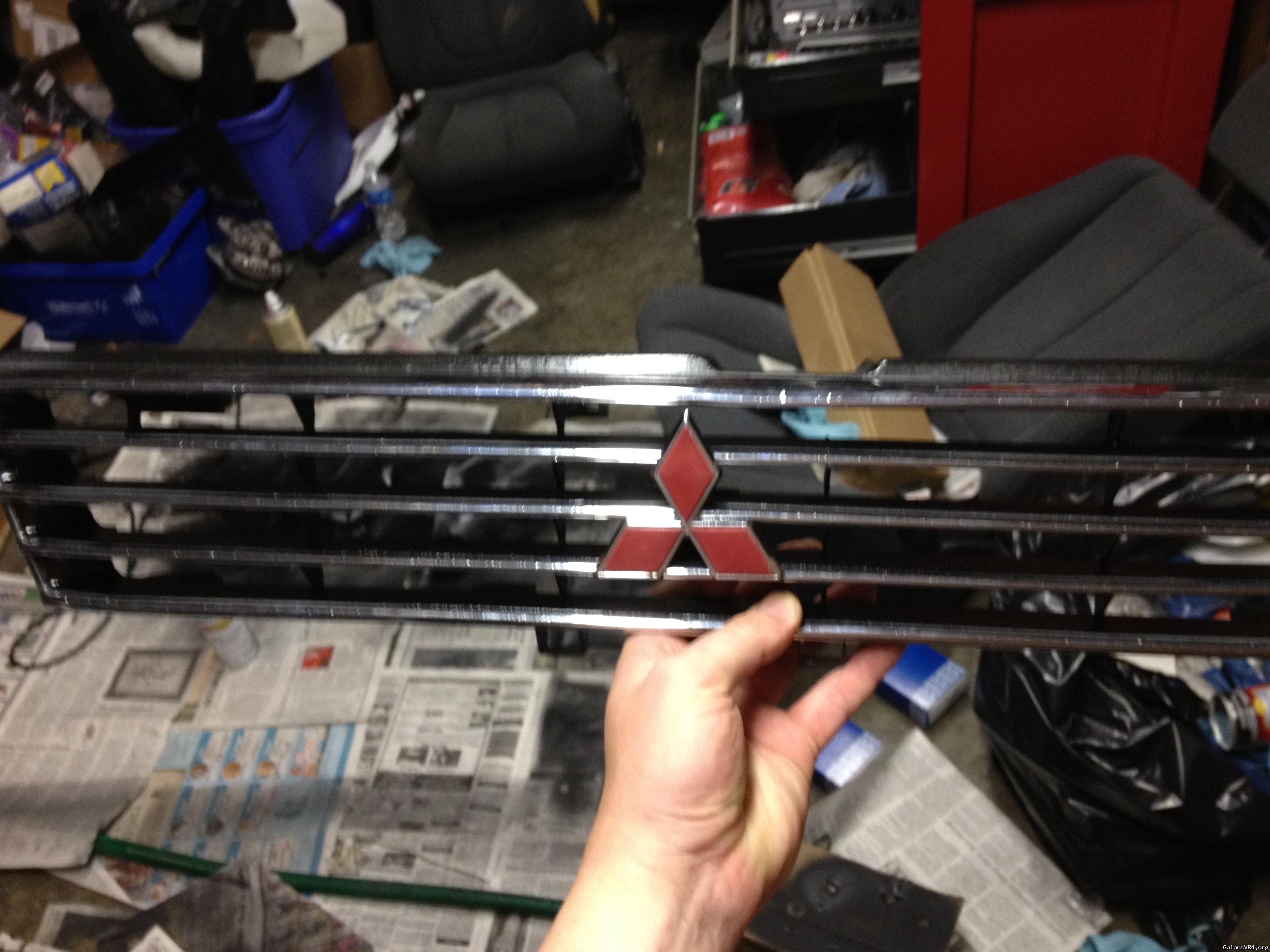

Old Grille

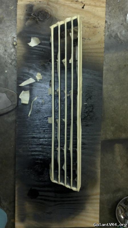

Took an 89 Grille buffed the emblem to remove oxidation, then taped off the chrome and painted it the remaining areas (it was very faded)

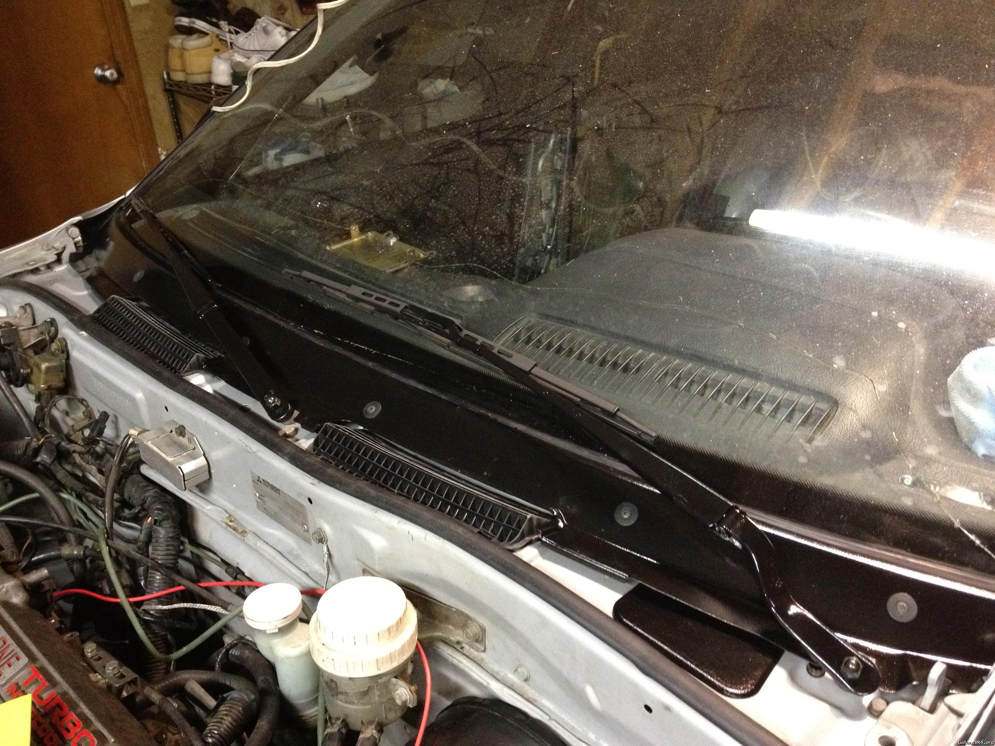

More Exterior/Body
Before:

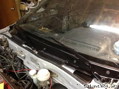

After: Cleaned everything and repainted everything

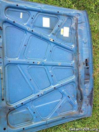

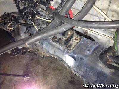

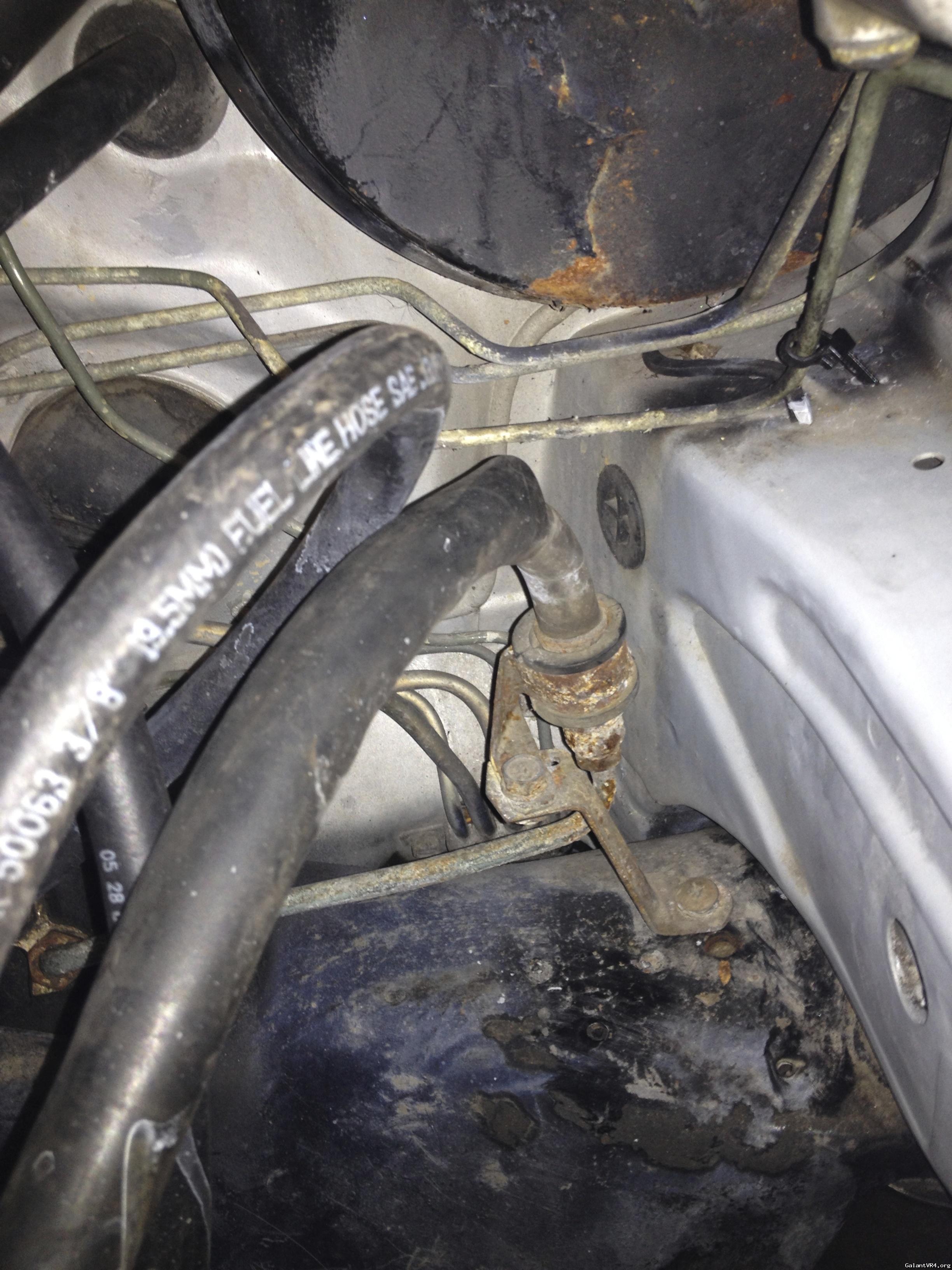

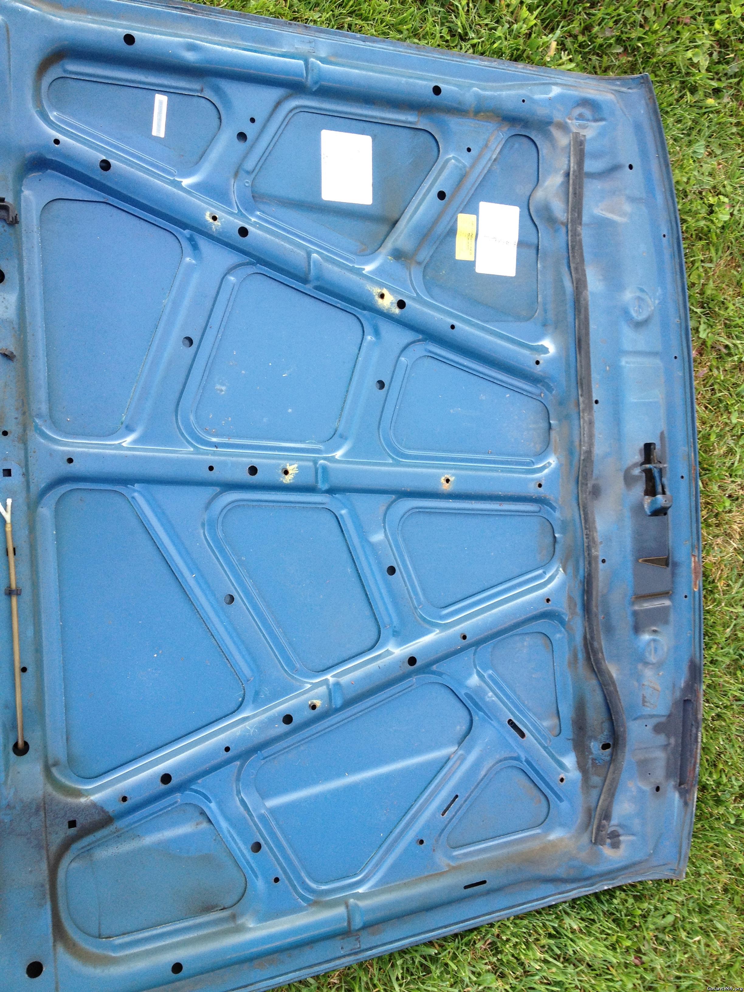

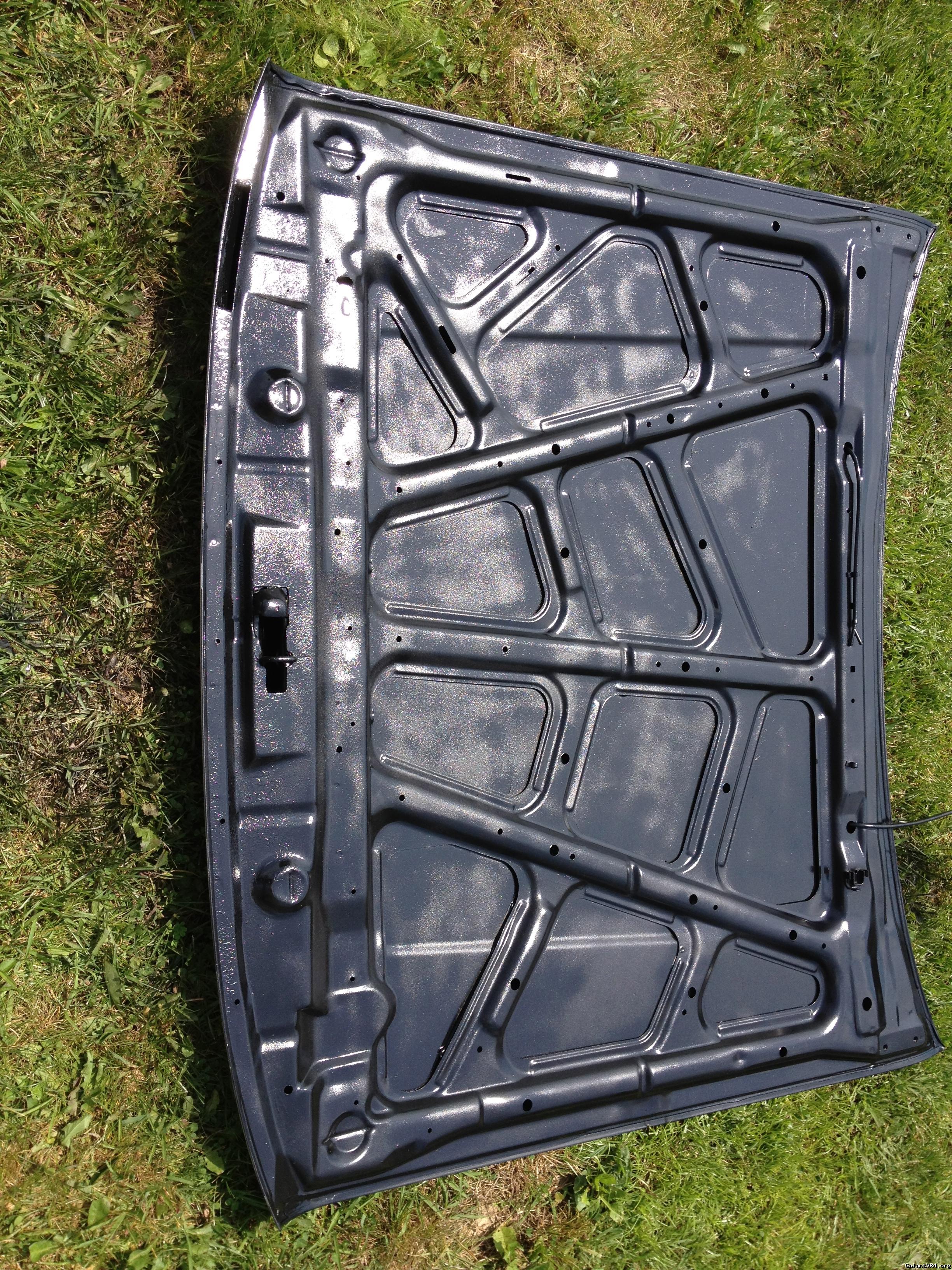

Although hood was replaced and painted by previous owner, he didnt paint it underneath. Didnt notice it at night lol, had some rust that I had to treat. Had to clean and degreased it. Used rust bullet, primed, and then 2 coats of engine enamel.
Before

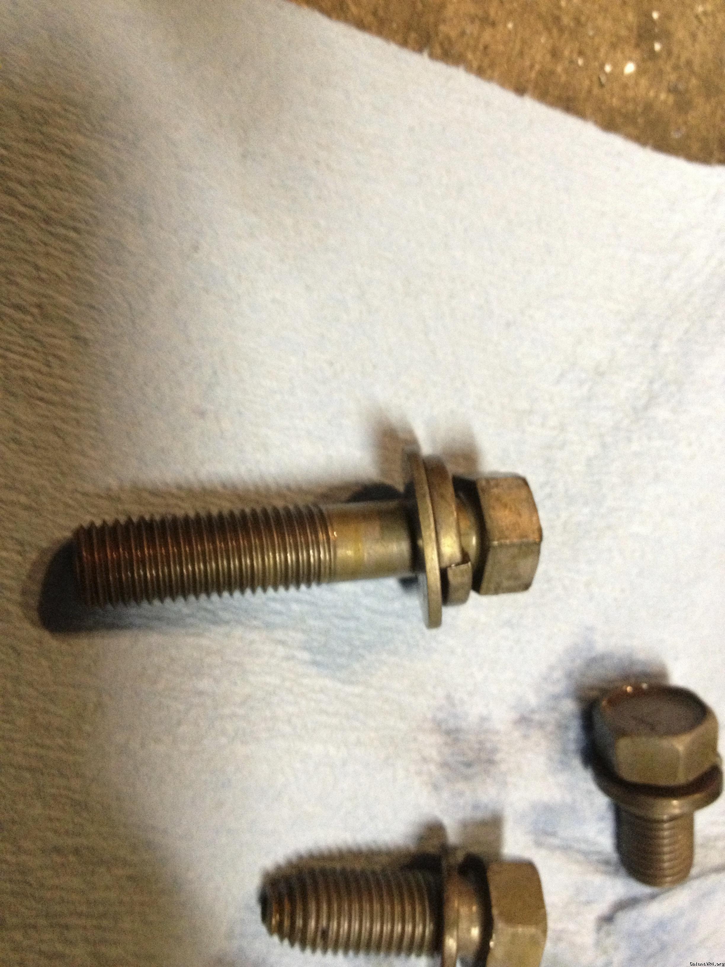

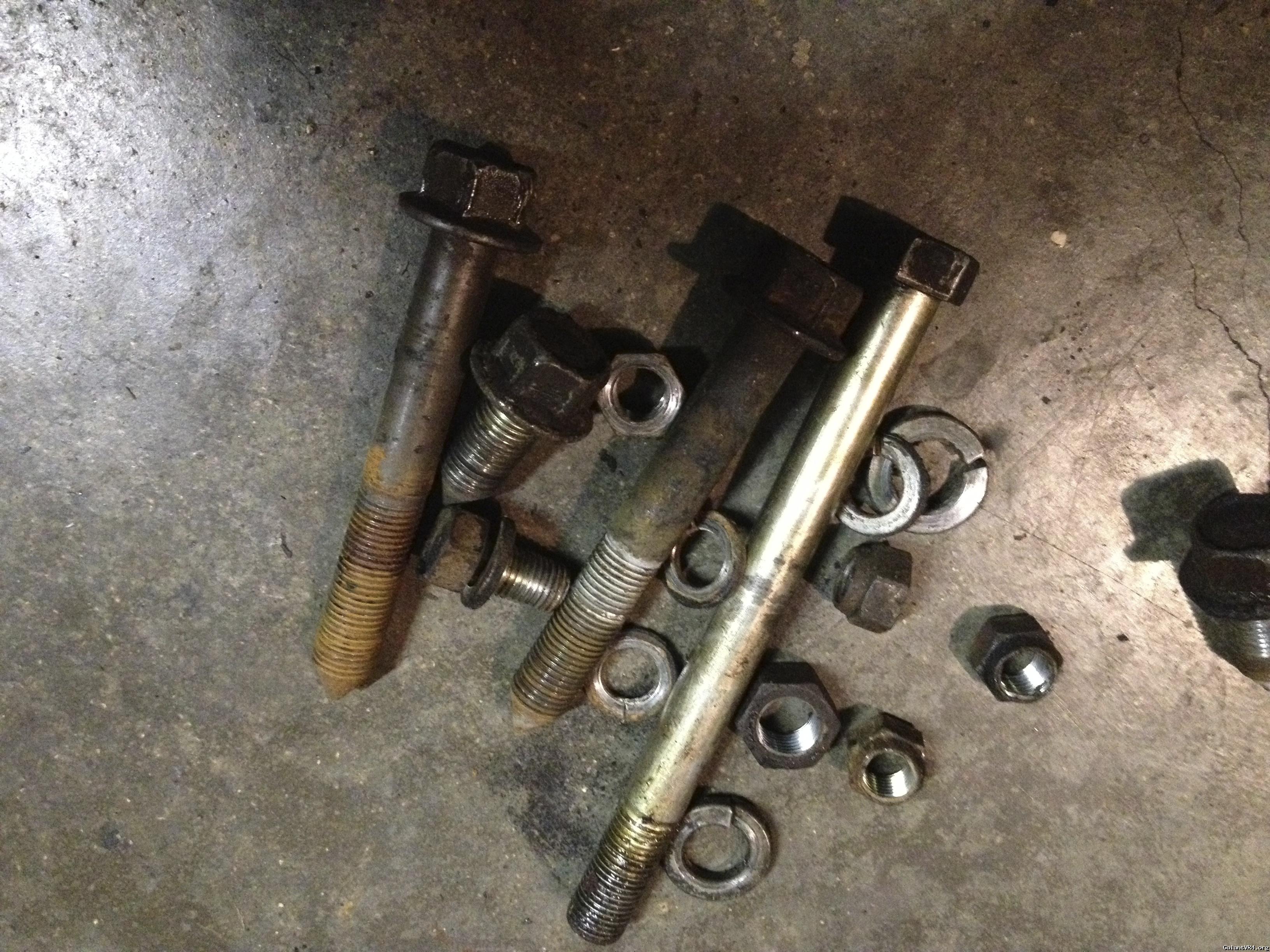

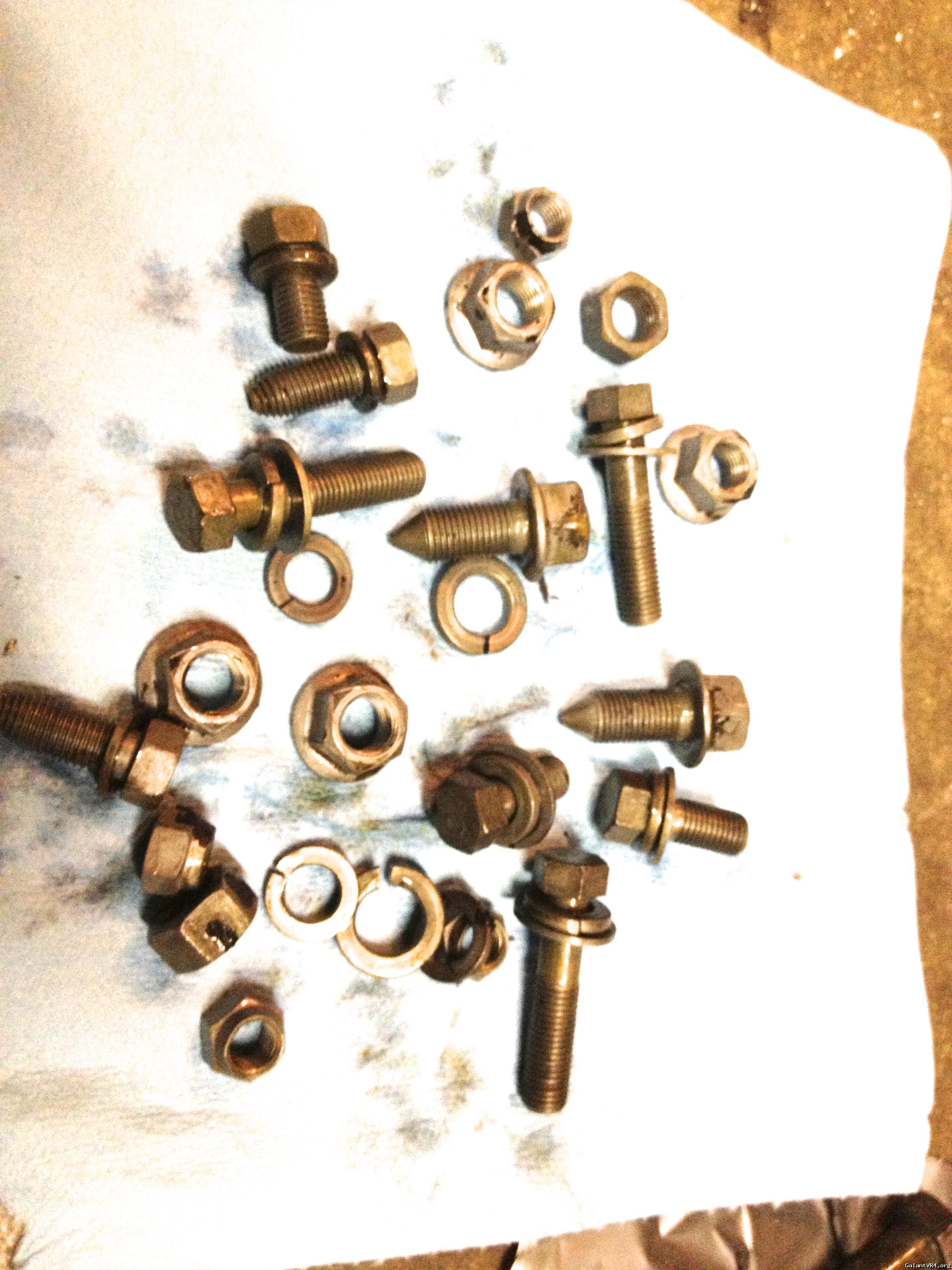

Im a little OCD. I took all bolts (literally all of them and treated them in a rust remover bath that didnt harm them but removed all rust) later repainted every bolt.
Before and after results of bolts:

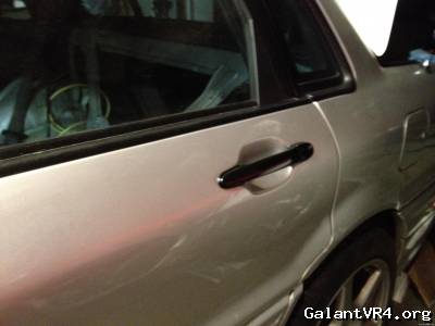

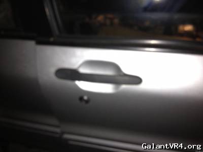

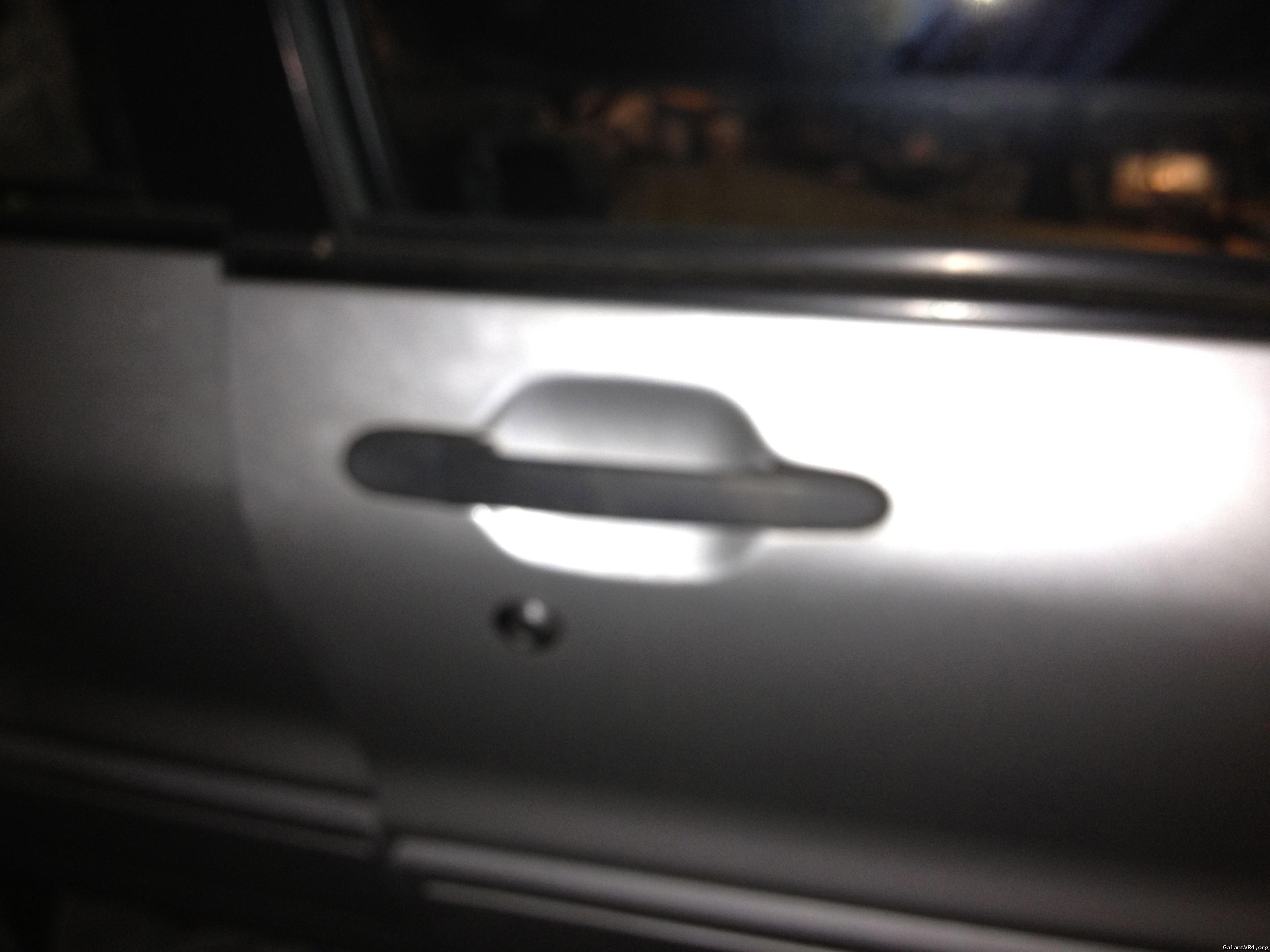

The door handles were very dull and oxidized. Light sanded them and painted them with 3 coats of plastic paint and 2 coats of clear:
Before
After:

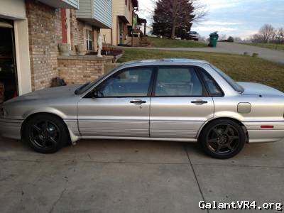

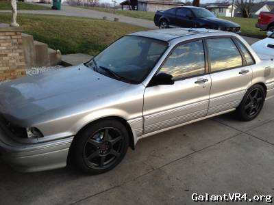

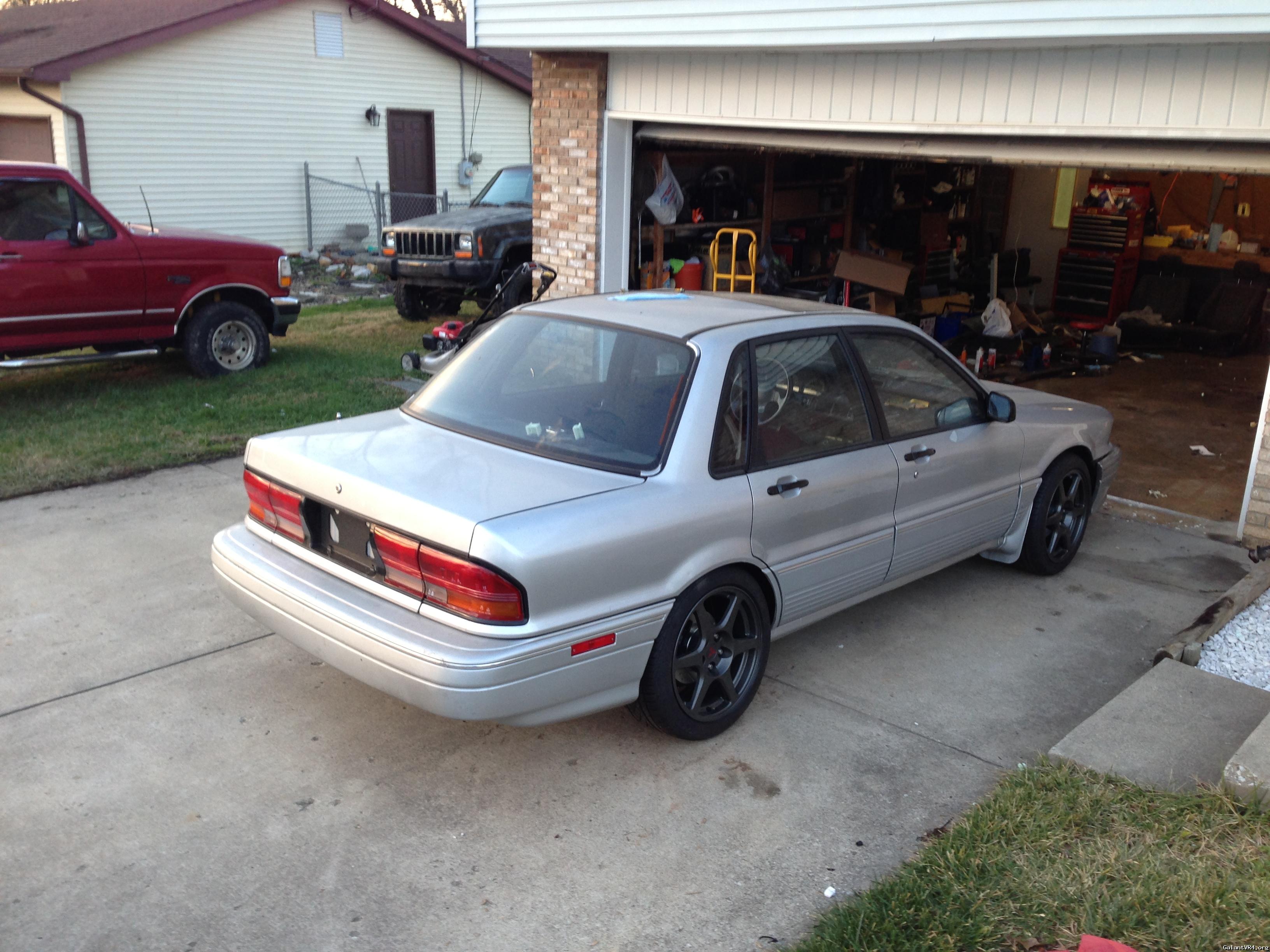

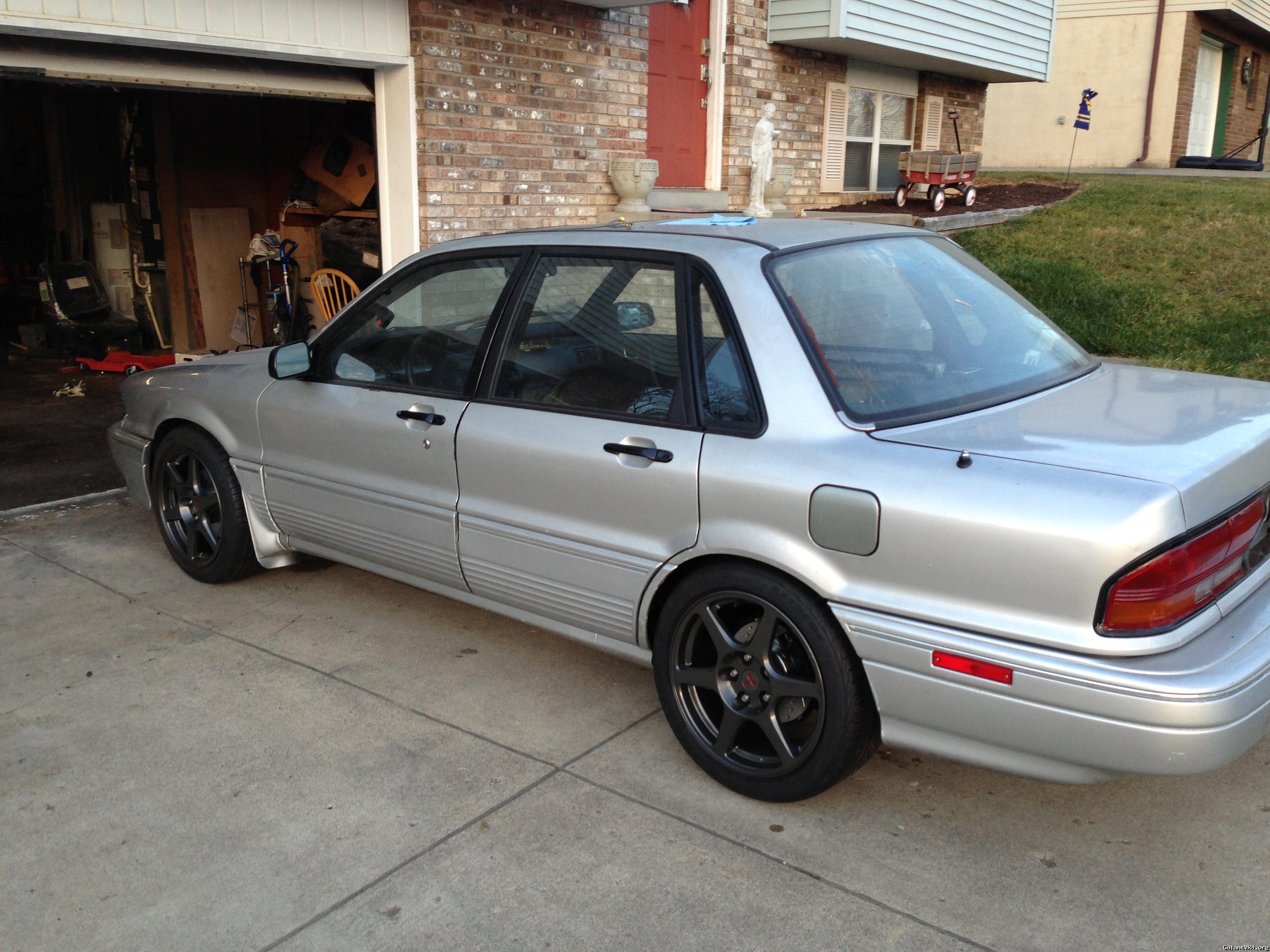

More photo whoring:

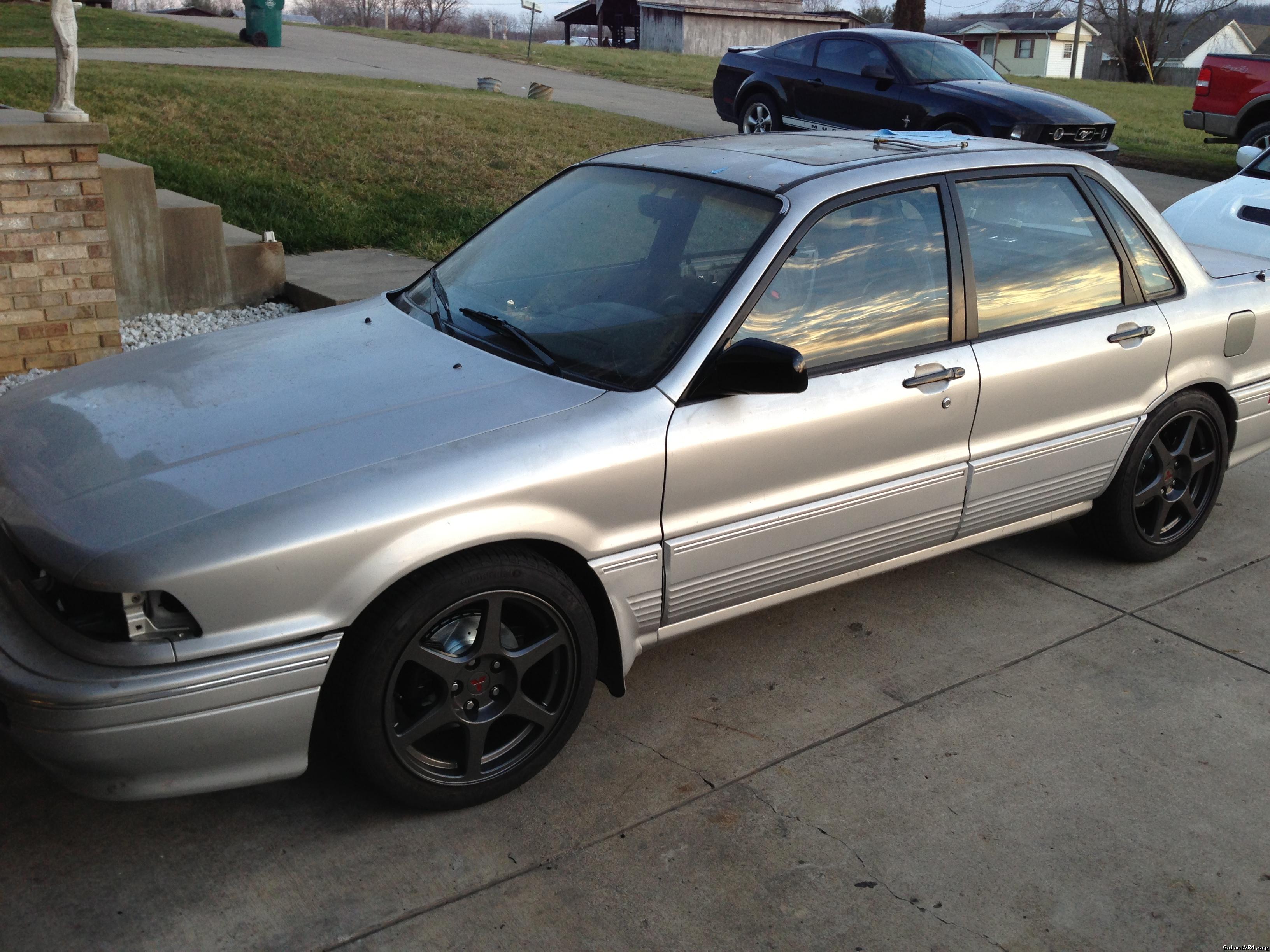

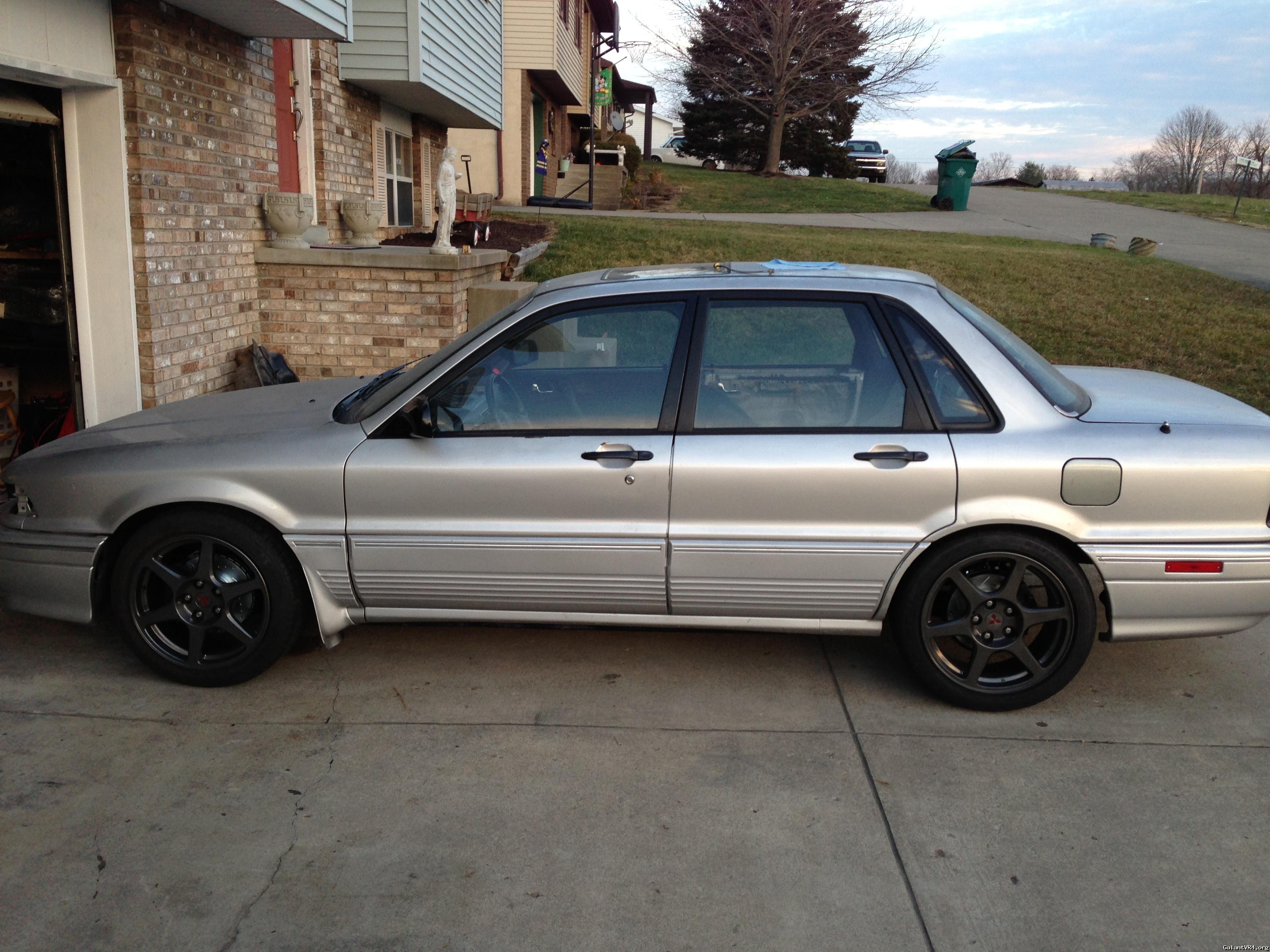

This is how the car sits now: I added a JDM keyless gas door, and removed the non-power antenna. I bought an ebay eclipse power antenna and had to do alot of mod-ing to make it fight just right. I bought a set of 91 taillights buffed them along with all other signals, etc

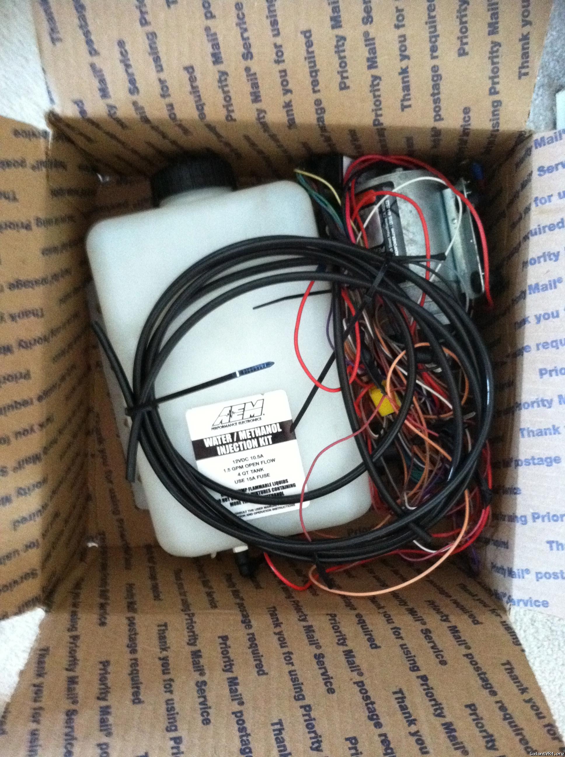

Some goodies and MISC stuff then Im done for the evening:

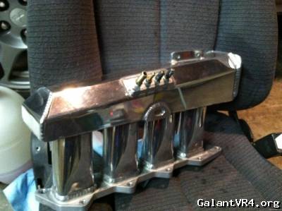

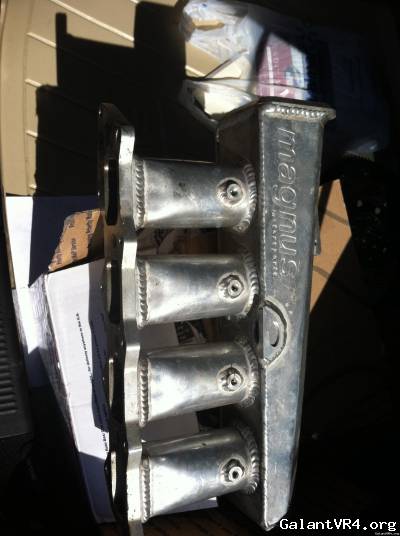

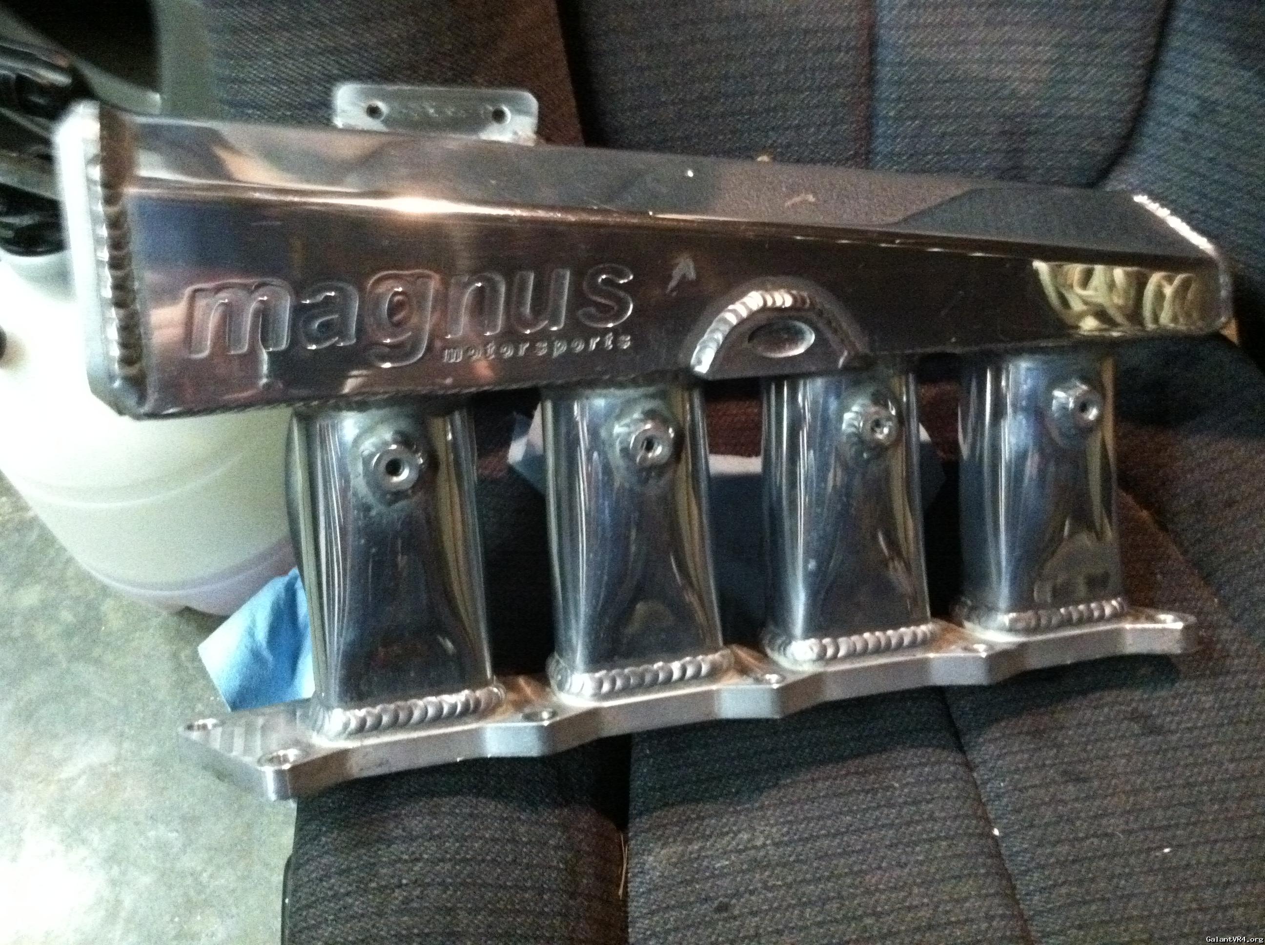

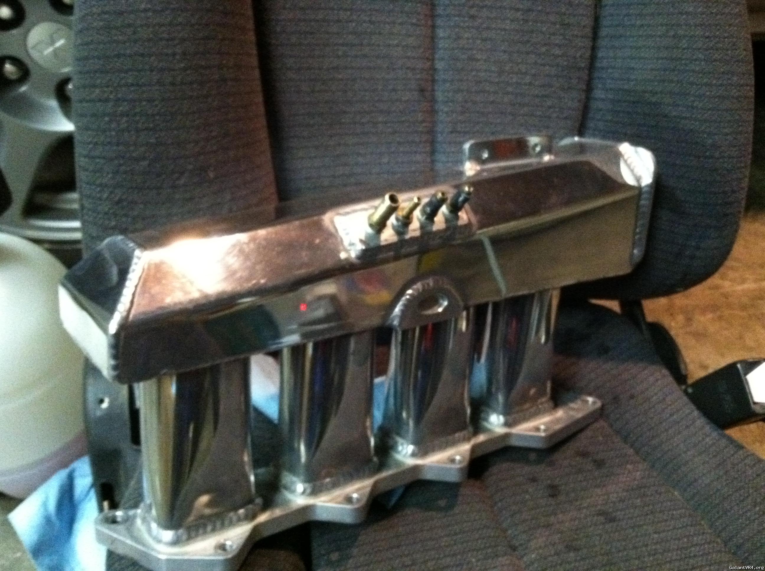

Magnus intake bought used needed polishing
Hours later:

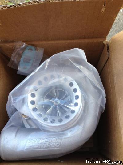

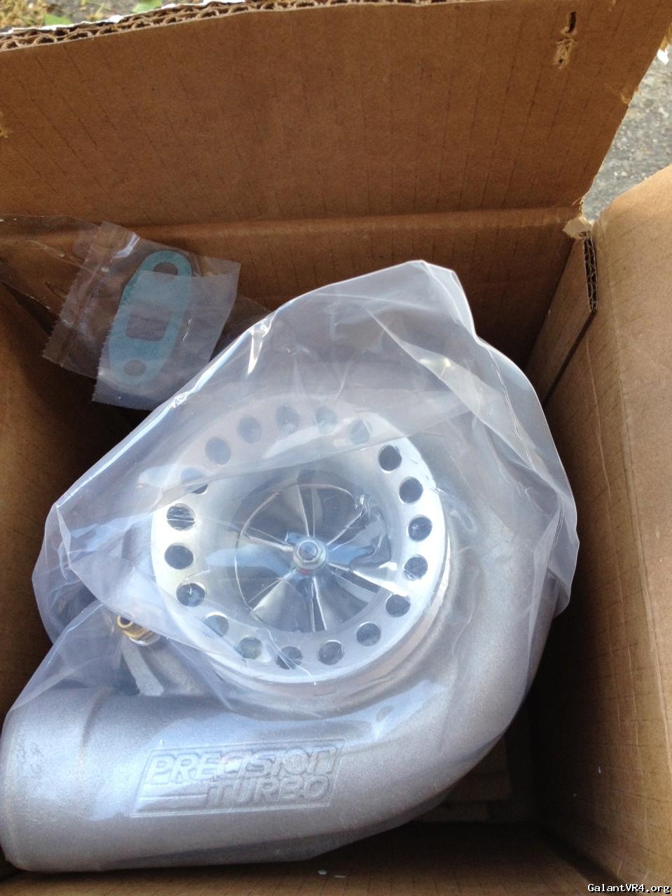

Turby Goodness PTE 6266
Little Meth
