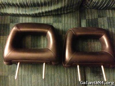

Thanks man it's been a labor of love lol. I don't have the interior back in yet hopefully in the next month it will be completed as far as trans swap and engine build. I have a full 92 leather interior to install and I just got a mint set of conquest headsets off of mirageman. I am going to use a hurst pro matic shifter with the stock console with either a leather boot to make people think I have a 5spd or I planned on doing what golfball did and use a piece of carbon fiber. It's funny cause I wanted to do the carbon fiber insert with a slot cut out for the shifter for awhile and then I saw golfball did it lol. Hopefully it's all done by the shootout

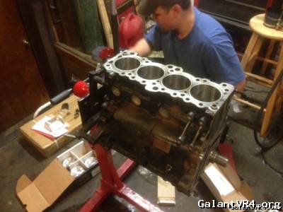

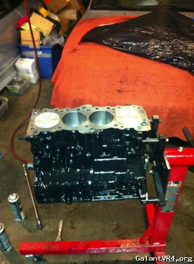

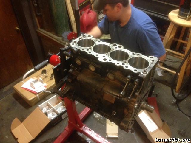

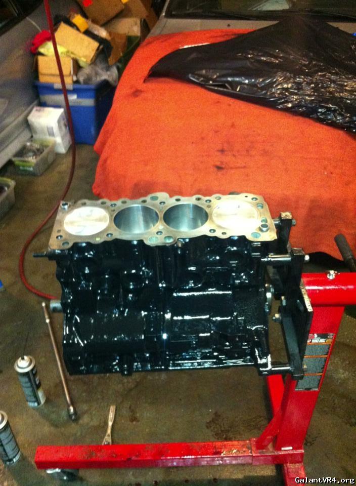

rexwagon1909
Jan 22, 2012
165
Hurricane, WV
Started to build the motor. We ended up running into problems witht he oil squirters and the Wiseco HD pistons (no pics). The skirt is longer and strikes the oil squirter tip. Ending up bending one bad. Engine should be built tonight after oil quirter fix
