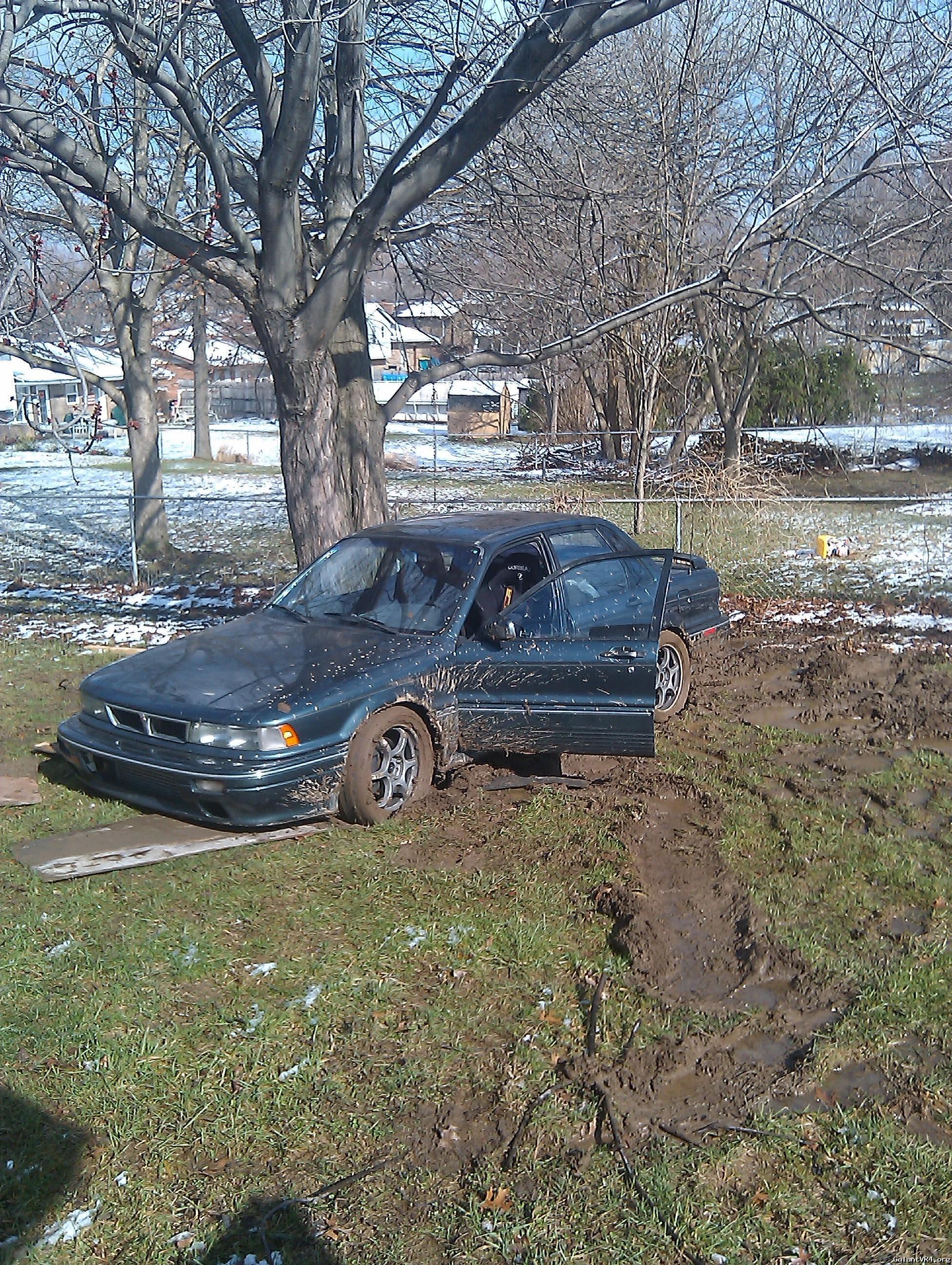

So as always I waited until the last minute to start working on the car for the upcoming Auto-x season. First thing I tried to get the car out of the shed and got stuck in the mud.

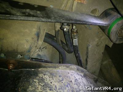

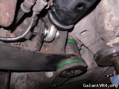

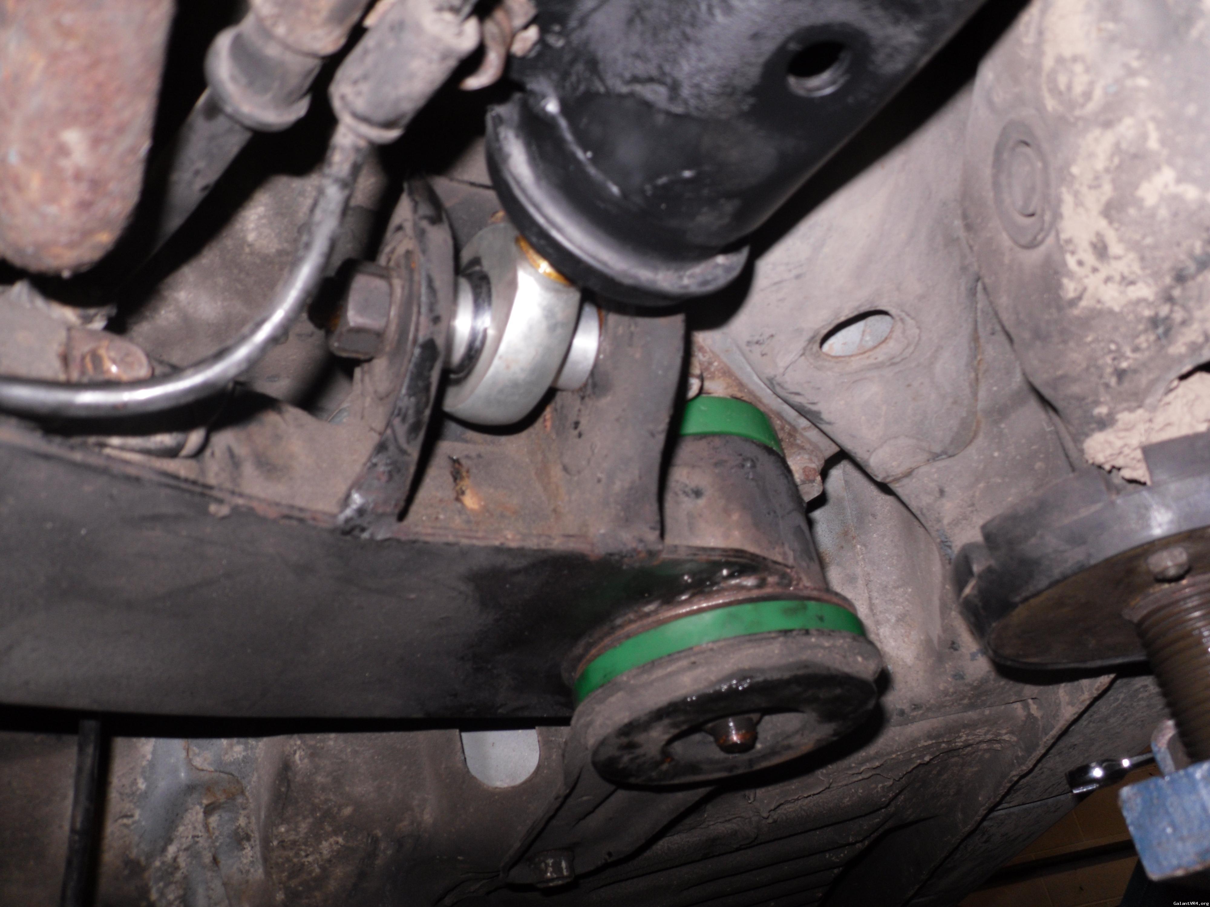

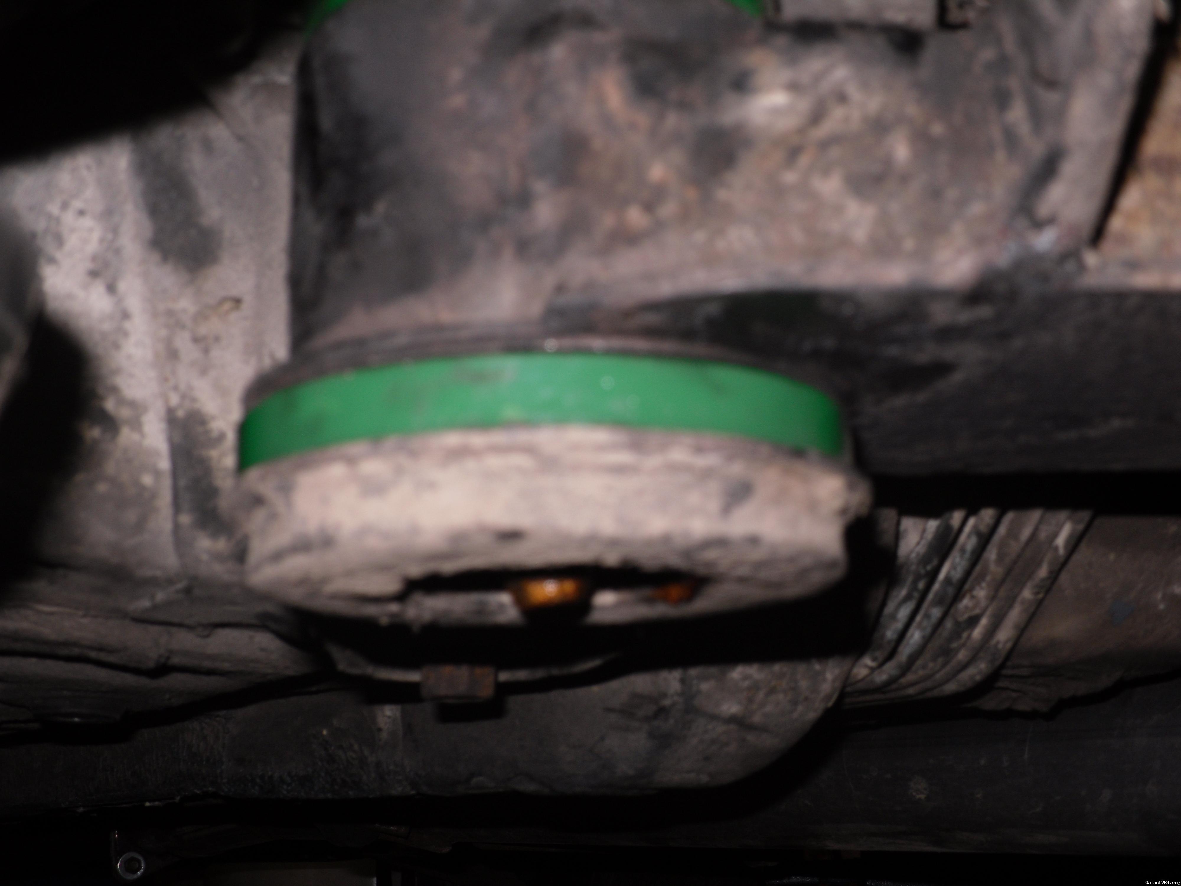

After destroying the lawn I had to go get the truck and pull her out. I finally got to work and got some parts installed that I have been holding onto for about 2 years. Active toe elimination kit and rear subframe bushings.

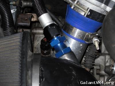

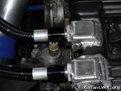

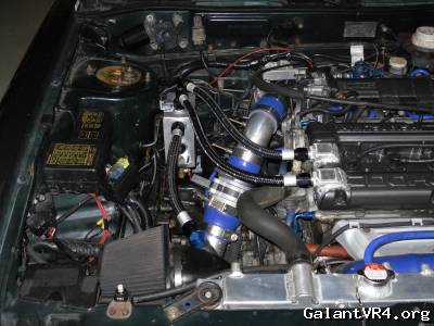

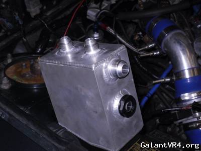

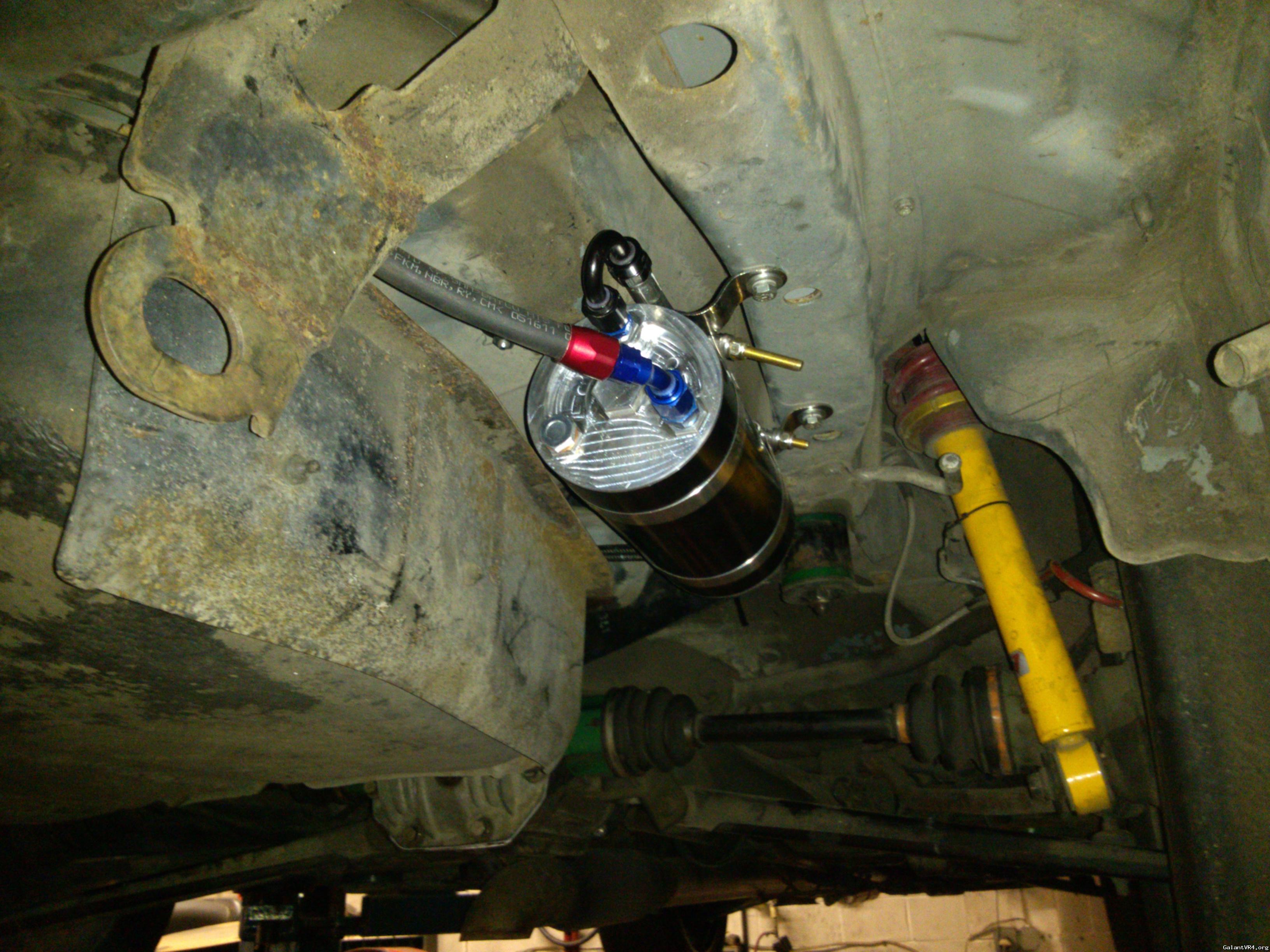

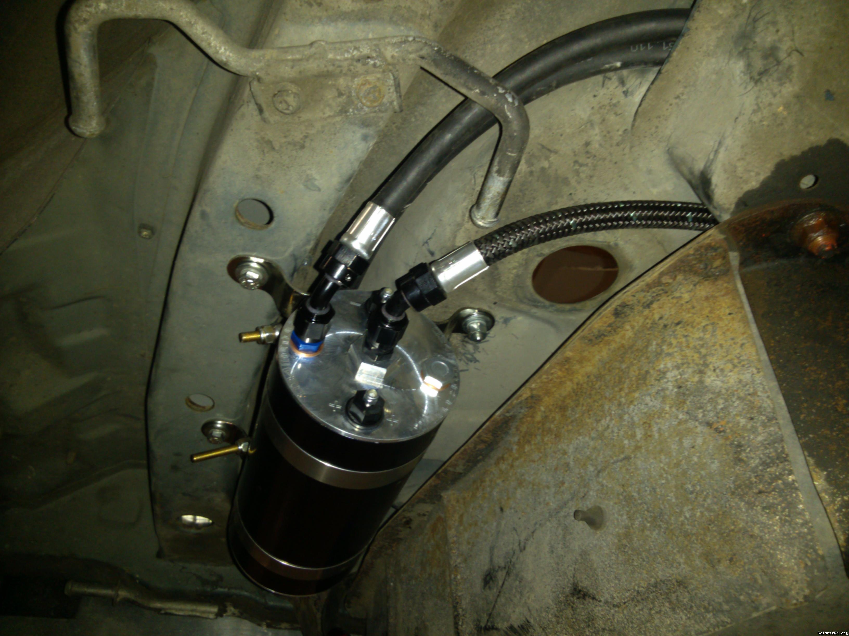

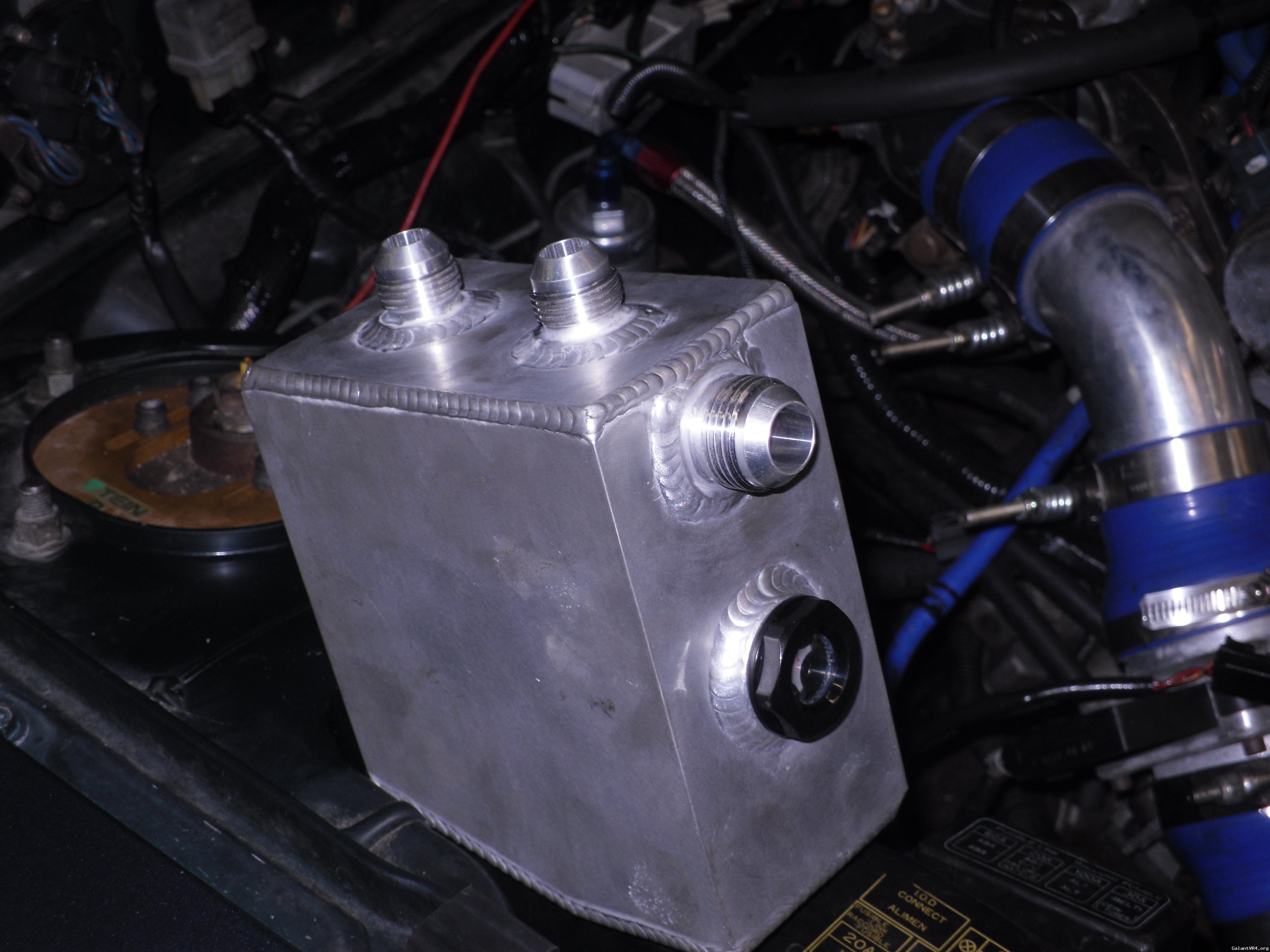

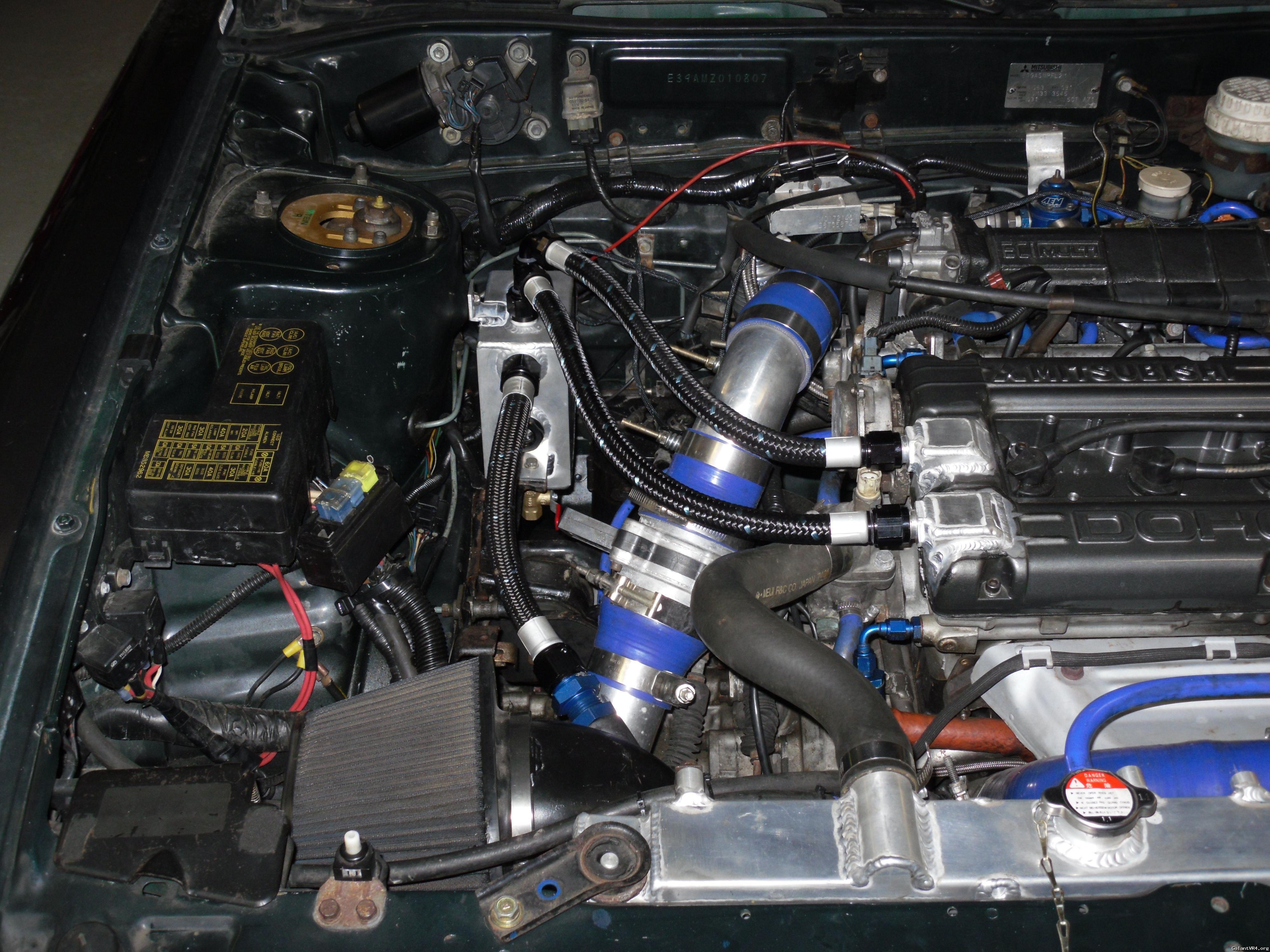

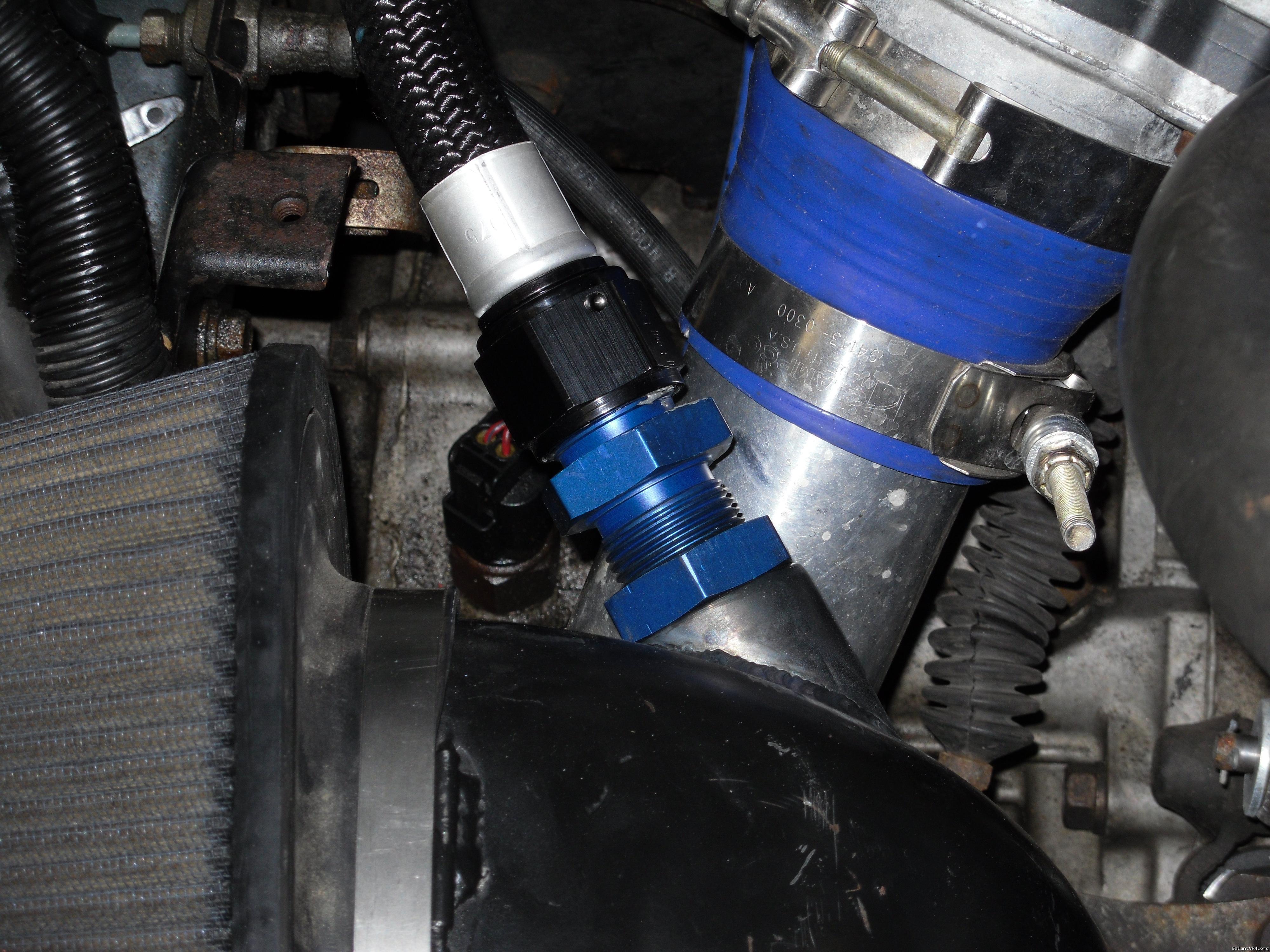

Had a day full of fun, but hopefully it will pay off. I still have to do the new crankcase vent and catch can. More pix to come

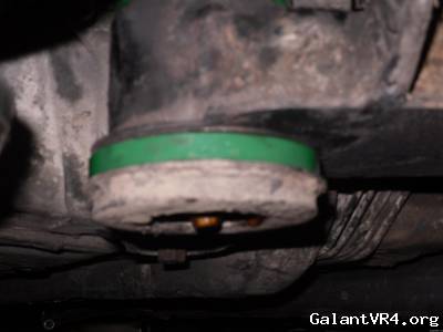

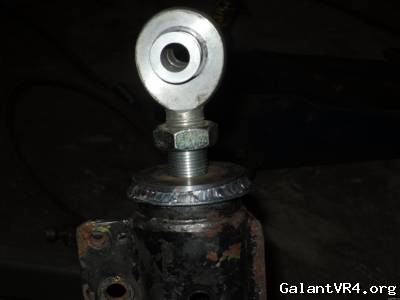

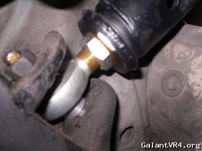

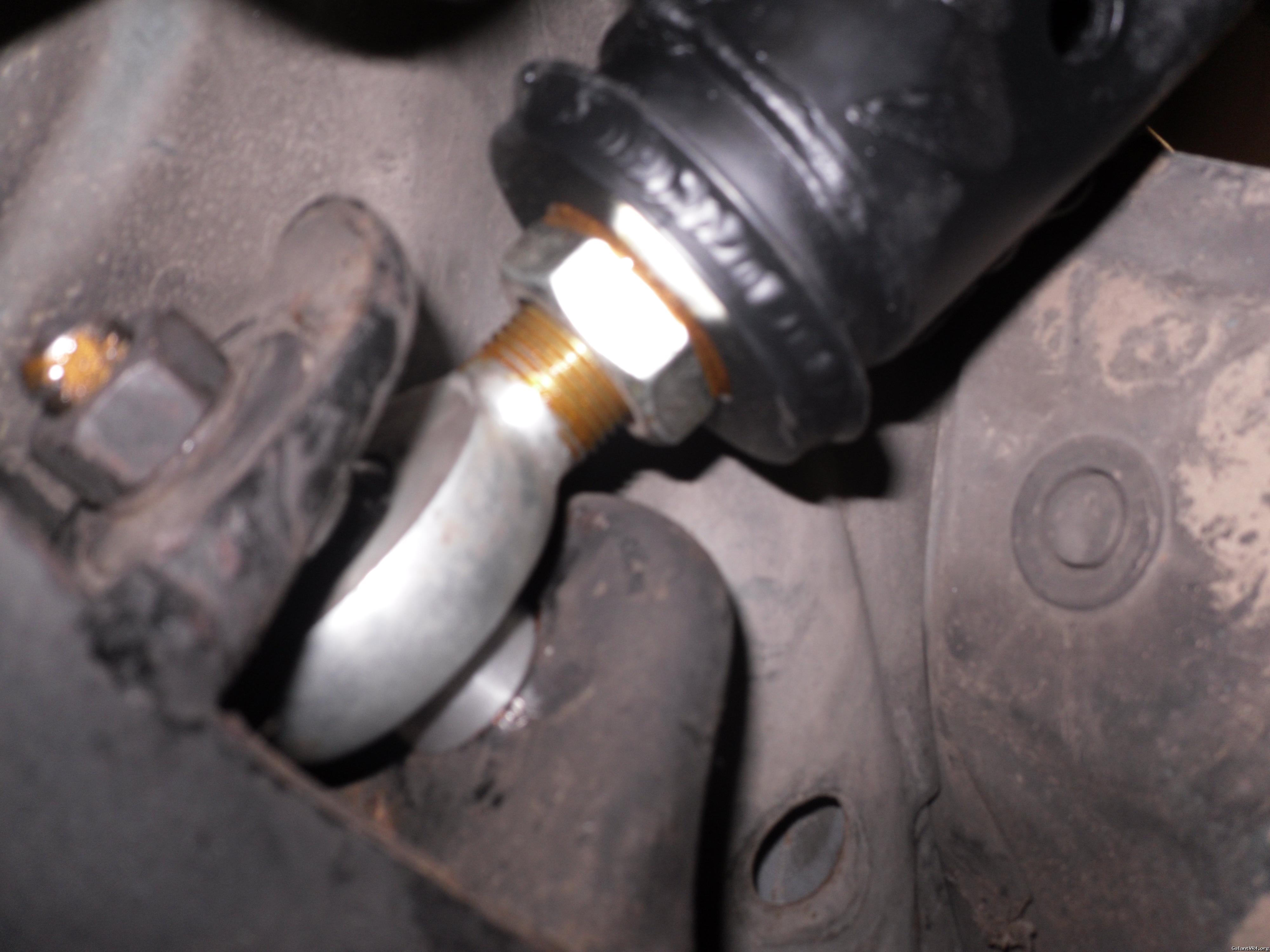

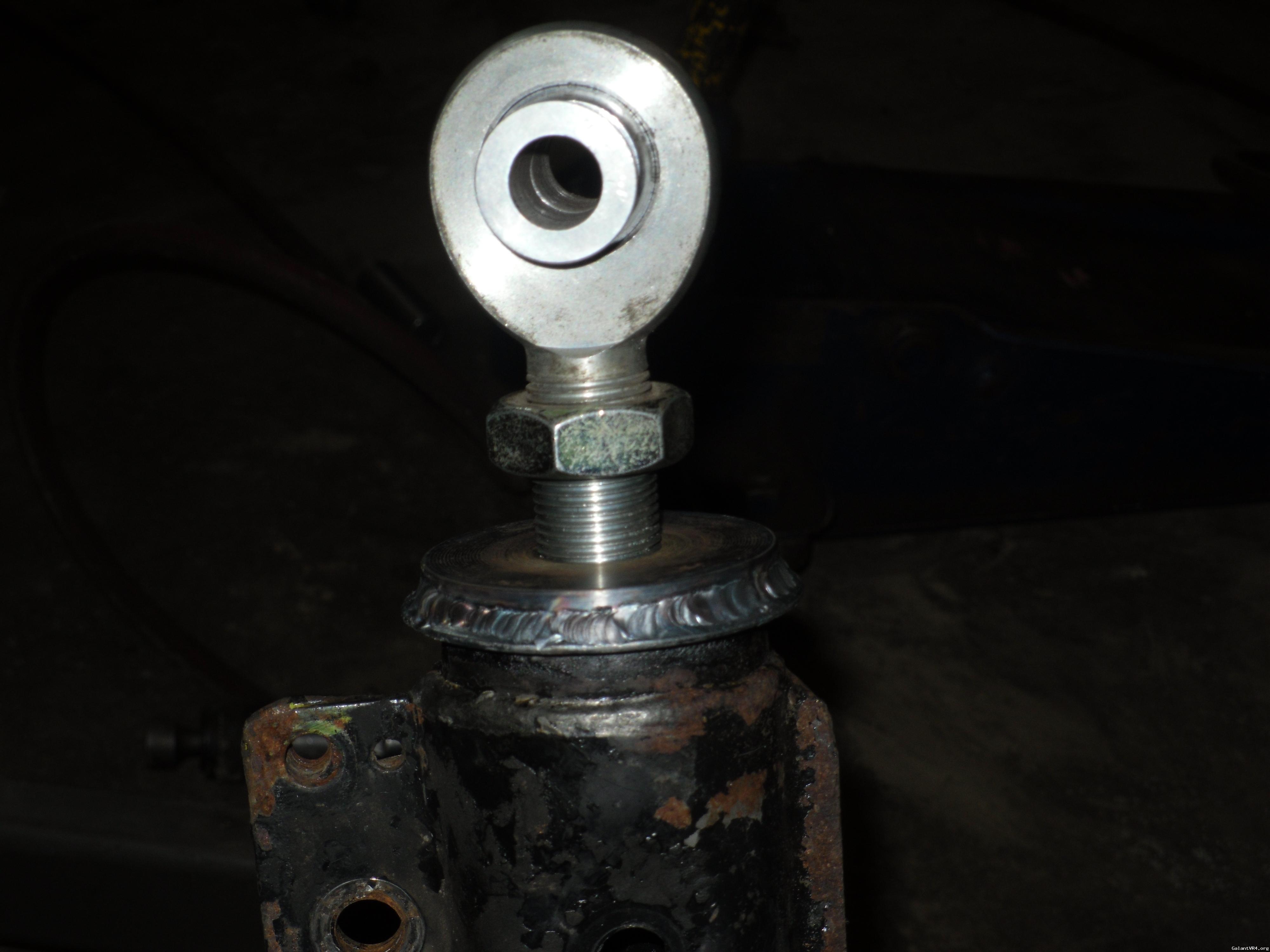

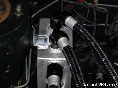

Got the valve cover ready to be dropped off back to the powdercoaters. Trying to figure out where I want to mount the new catch can. The active toe kit was simple. Take the trailing arms off. Remove the old bushings, remove old paint and prep surface. The steel bushing had to be hammered in as it was a tight fit. I heated it with a torch to get it good and hot and then welded it to the control arm. I anti-seized the heim joint and nut threaded them all the way in and then back out 5.5 turns. Re-assembled everything and then aligned it.
CutlassJim
Jul 17, 2006
1,699
Manchester, NH
Make sure to coat that heim joint with paint or grease or something. If not it will turn into a big pile of rusted poo in short order.

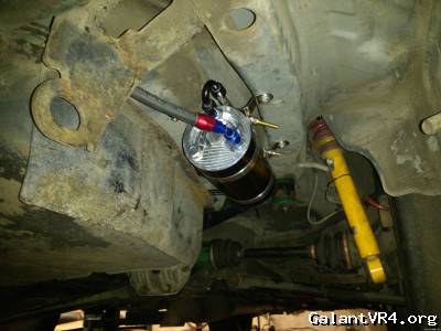

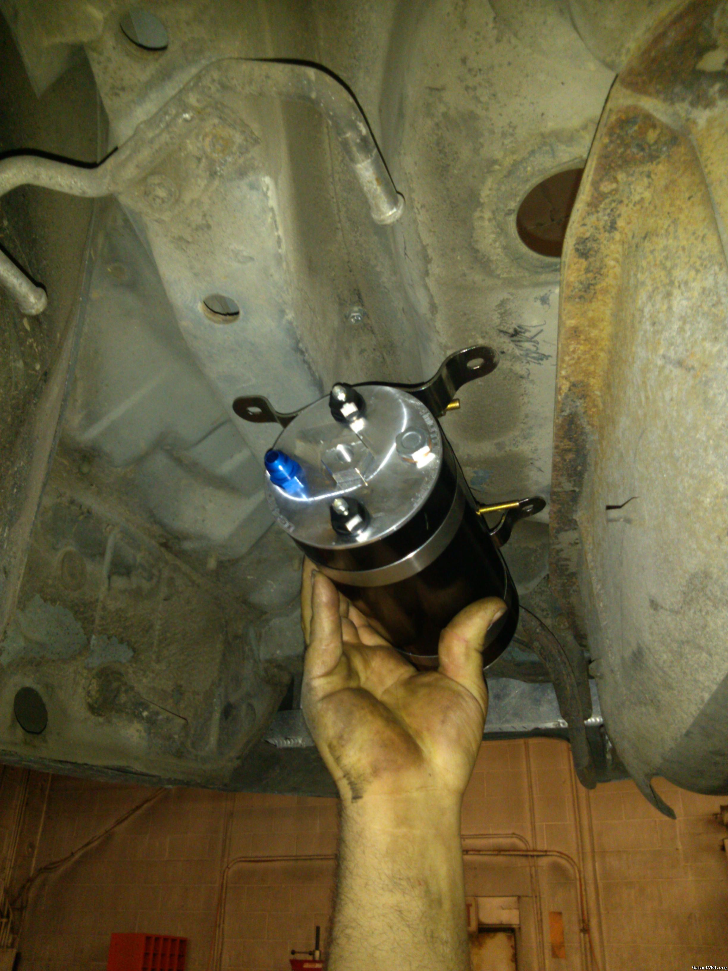

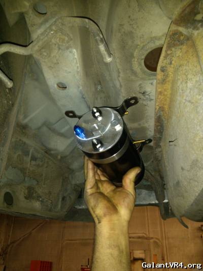

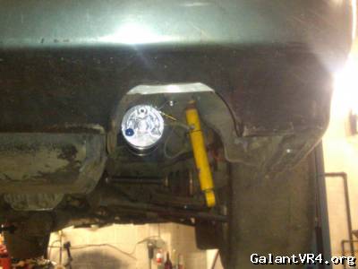

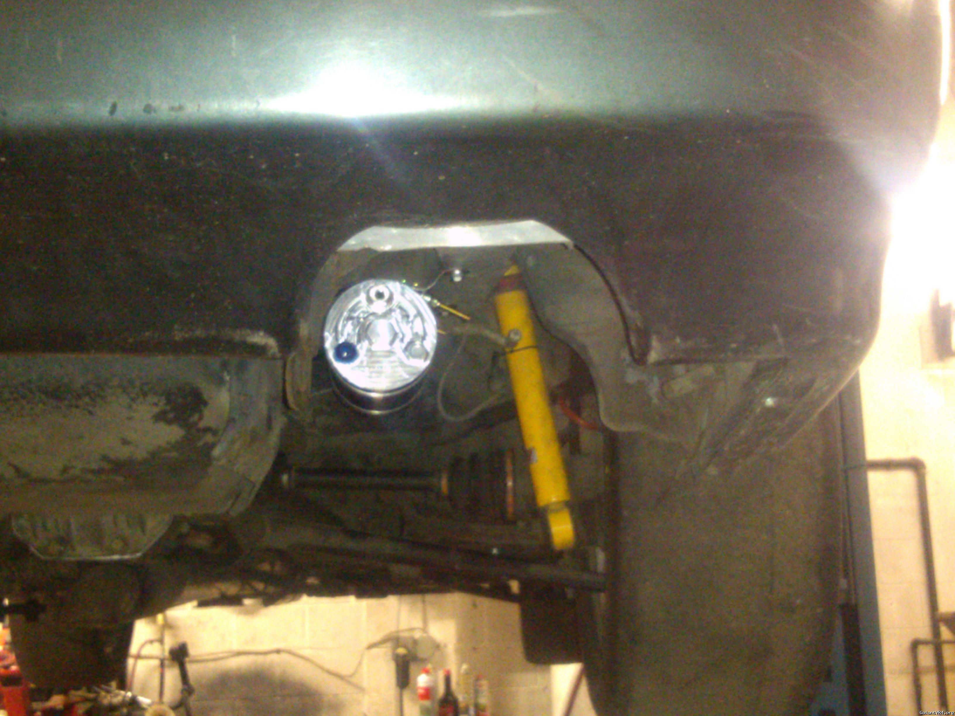

So its time for a new auto-x season to start. Last year all I did was replace the rods in the motor after the hose going to the wastegate came off and the boost went to almost 40psi on pump gas and bent one of the old rods. This year I'm working on the fuel system and handling. I got this nifty piece from 034 motorsports. It holds 1 liter of fuel and houses my Bosch 044 pump.

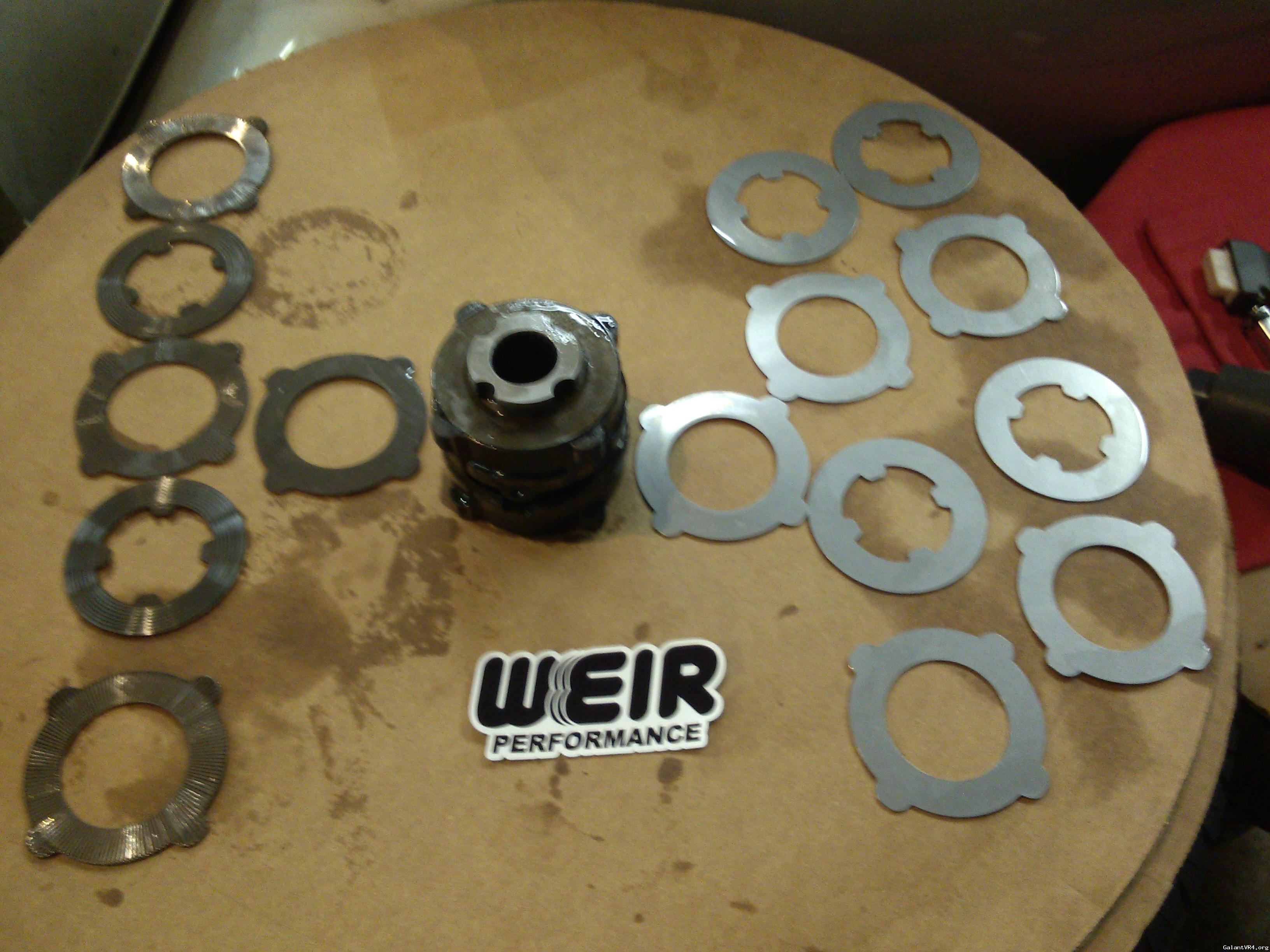

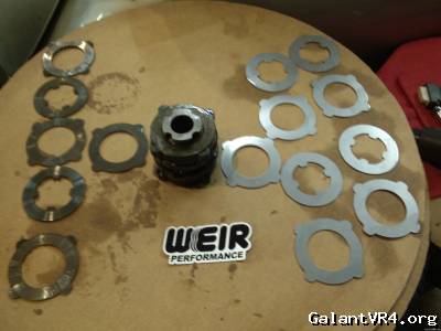

I also decided to rebuild my evo rear diff with the Weir Performance 16 plate Max grip kit. Stock plates on the left new plates on the right.

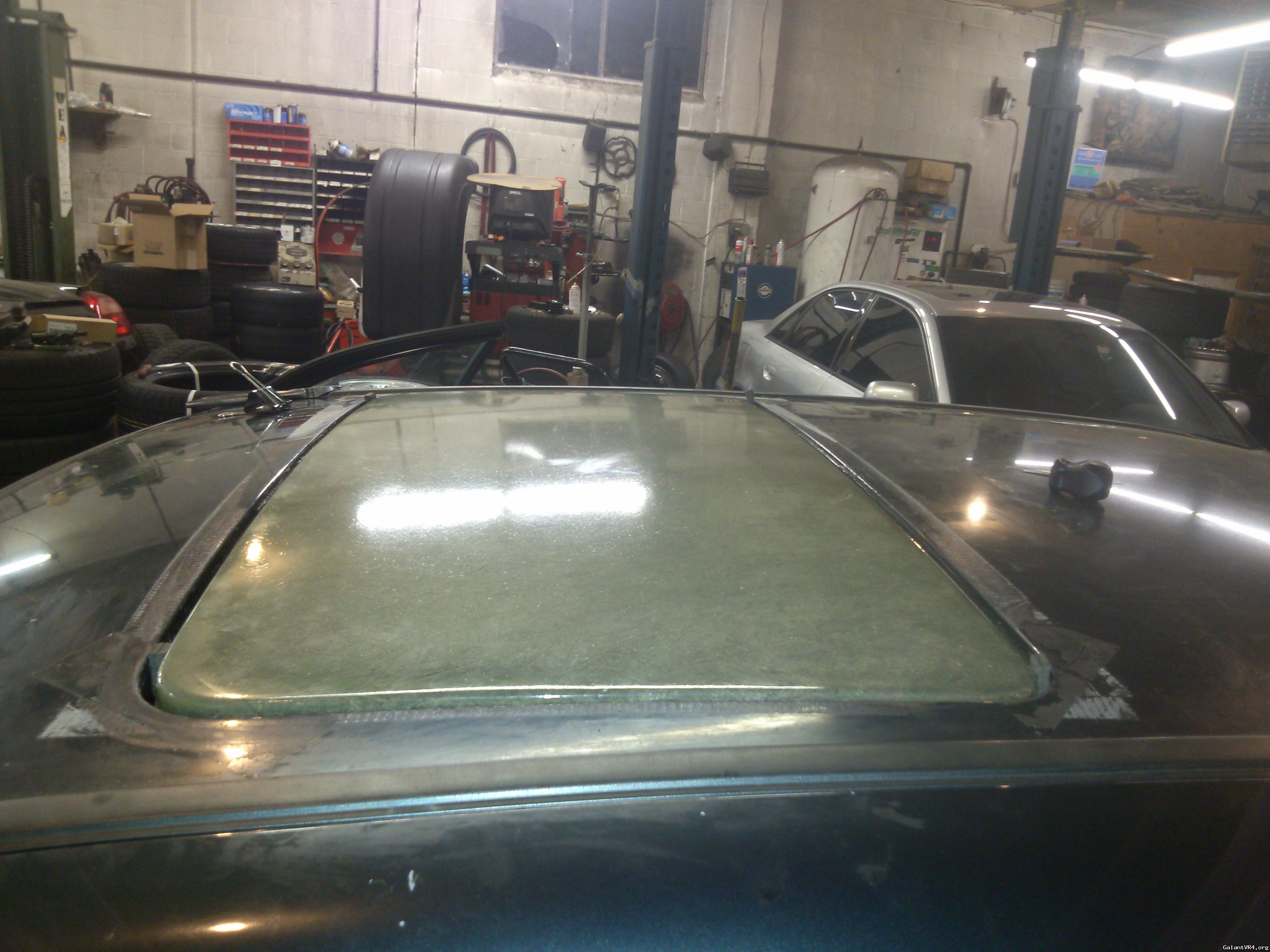

I also ordered new 17x9.5 wheels with new hoosier 275/35R17 A6 tires. Will have pictures as soon as they show up. I've been working on removing weight so the sunroof is gone and I am working on a carbon sunroof delete panel. That should be done next week. I'm also going to attempt to make my own subframe connectors. Hoping it will be as simple as it looks.

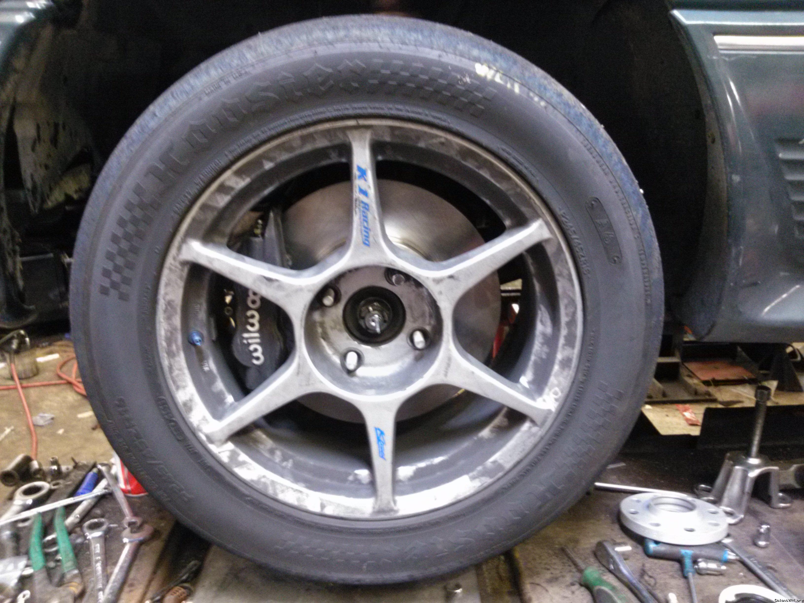

They are Rota Grids 17x9.5 with 12mm offset. The wilwoods are custom. I made the brackets and am using re-drilled Ford Crown Victoria rotors and custom hub rings. I'm actually probably going to be selling the rotors, rings and brackets in the future if anyone is interested. I had them under my 16" Kosei K1 wheels that may be for sale also. They only have 5 auto-x's on them and about 200 street miles. I'm running DTC-70 pads. I am going to go to Evo 9 rotors and make another set of brackets now that I have 17" wheels. My calipers are for 1.25" rotors and the Crown Vic rotors are only 1.10" so I have to use and extra set of backing plates once the pads get worn some. You would need caliper part# 120-11132 available from summit for under $160 ea. and are compatible with the thinner rotor.

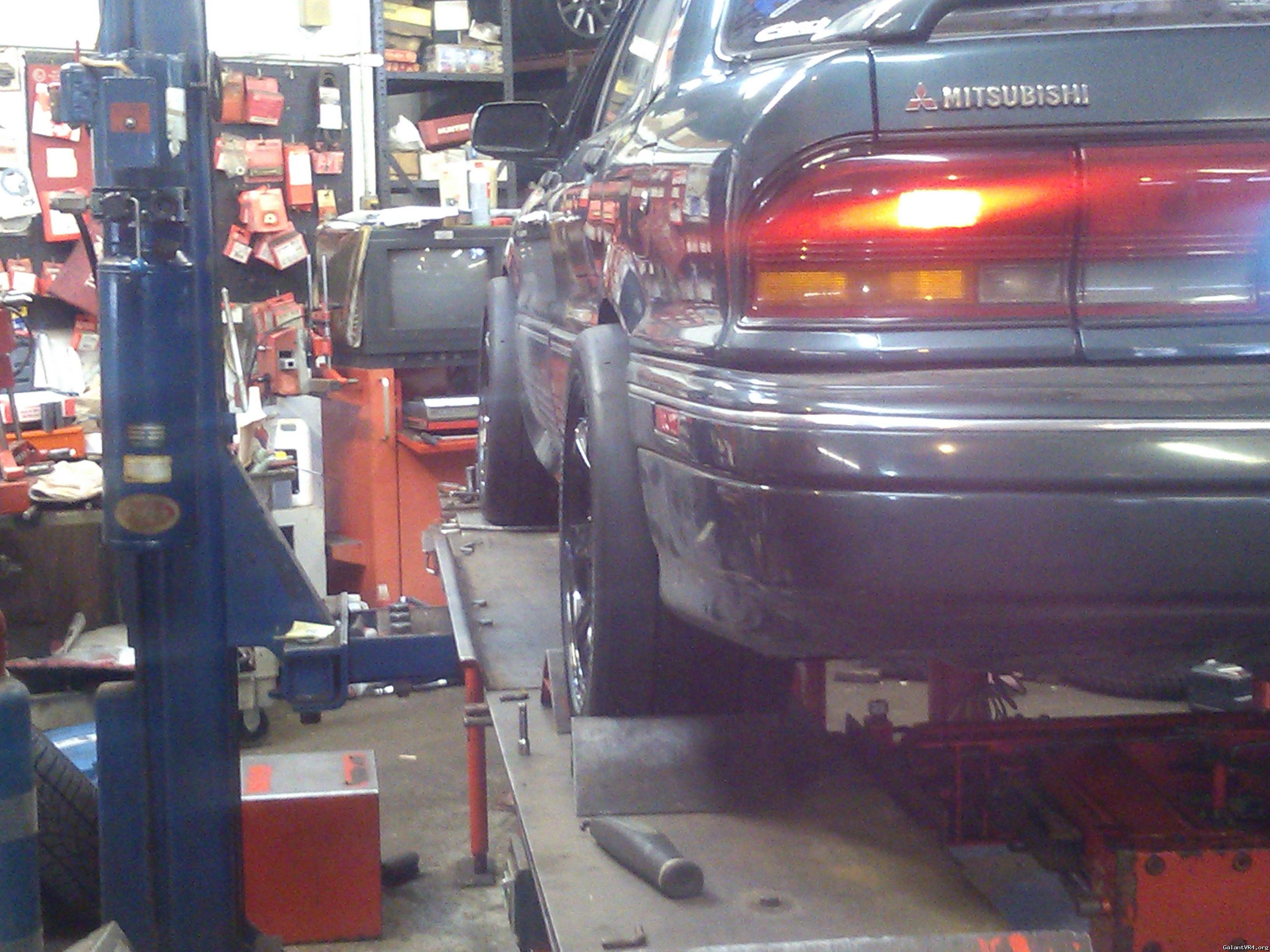

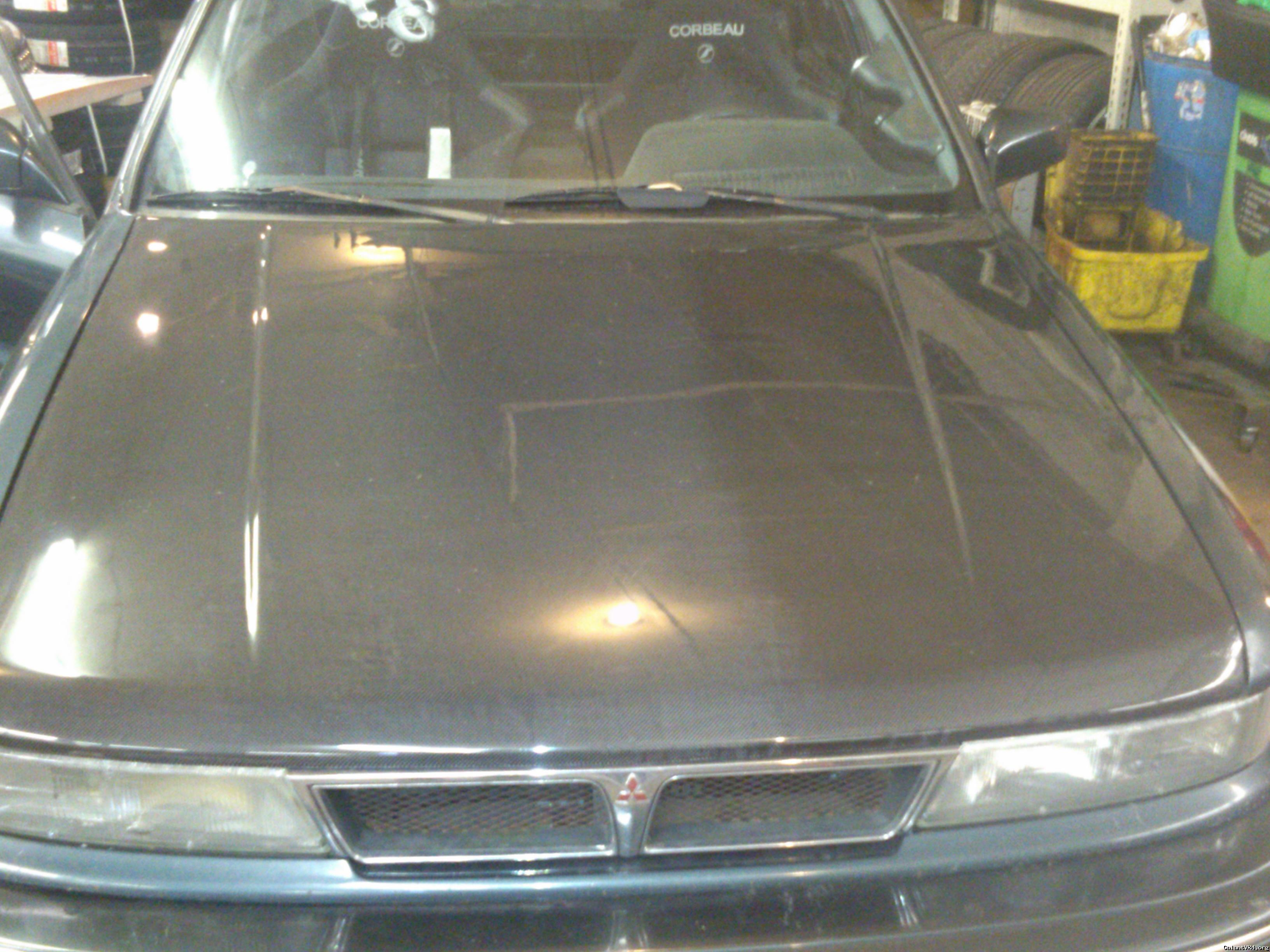

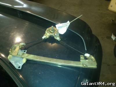

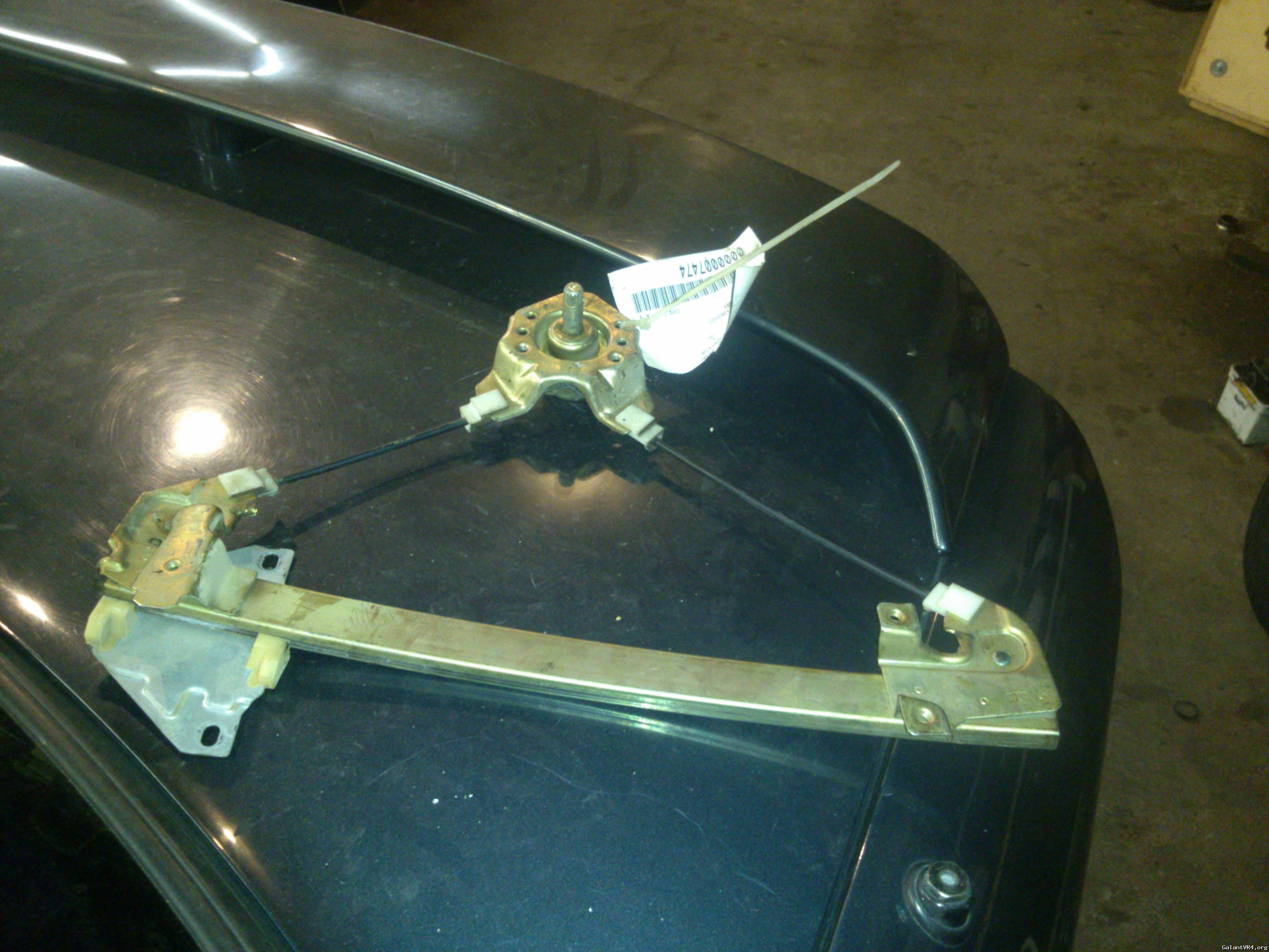

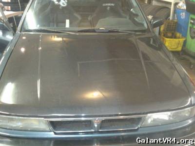

Some goodies showed up this week to take more weight off the car.
Carbon Hood

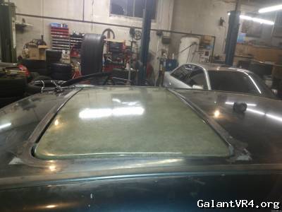

Test piece for sunroof delete. I'm waiting on the epoxy to show up to make the carbon one. The gaps ended up being more than I wanted but whatever.
Manual window regulators

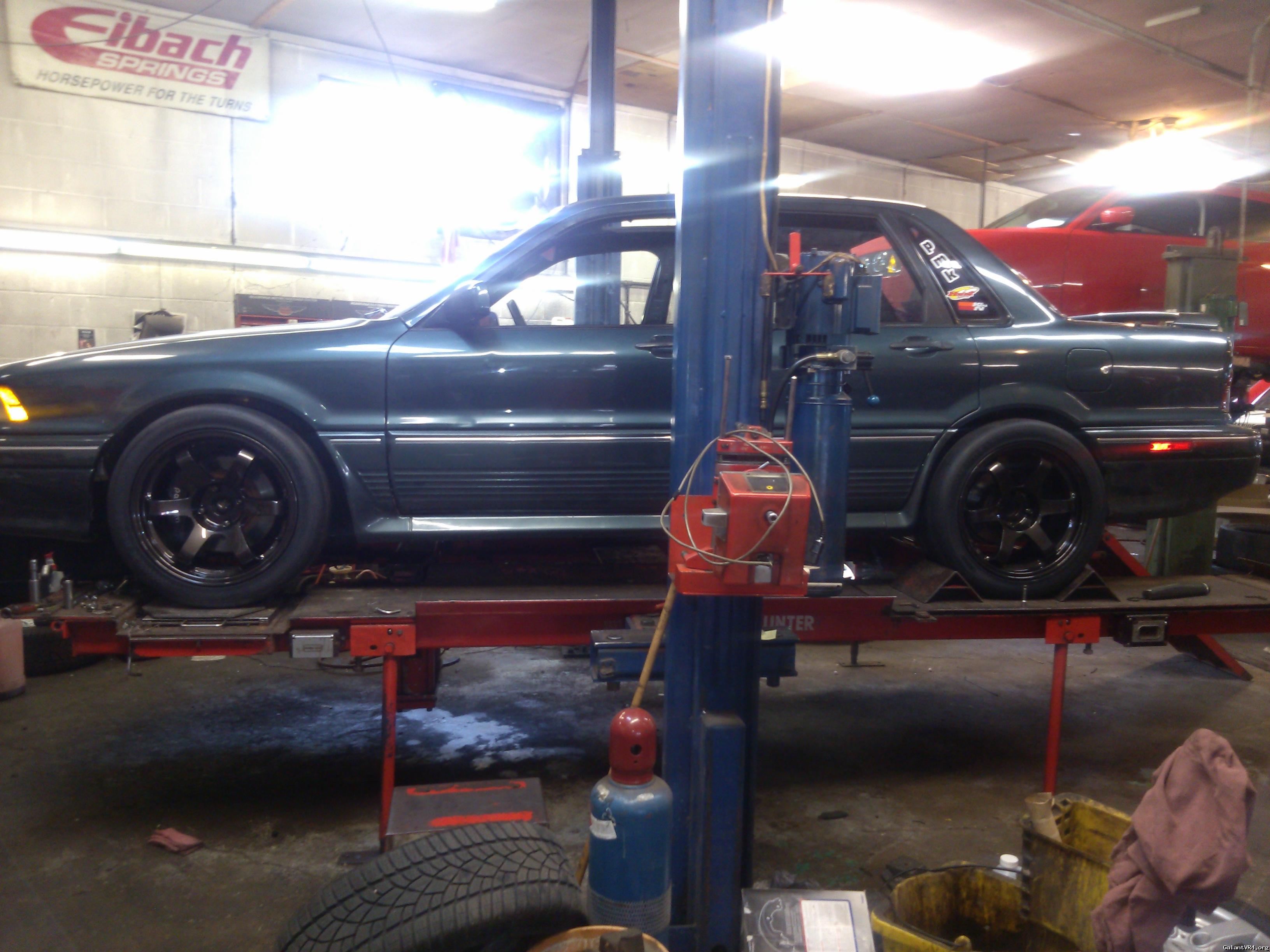

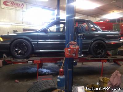

With all of this the car should be in the 2750lbs range. I had the scales under it when I was installing the frame connectors and it was 2835lbs with them on and my heavy street wheels. Hopefully I can find time to do the alignment and corner weights in the next week or so.
