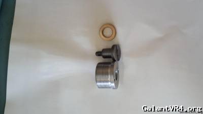

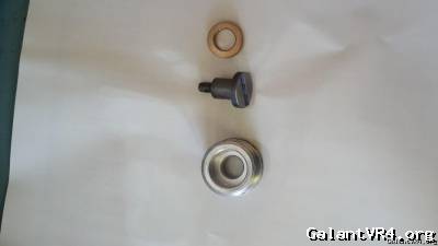

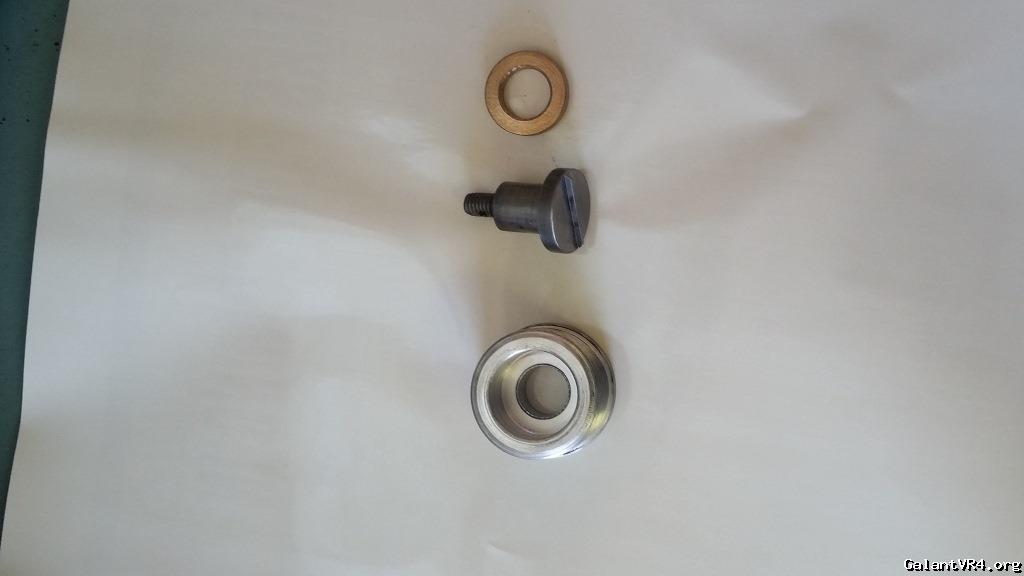

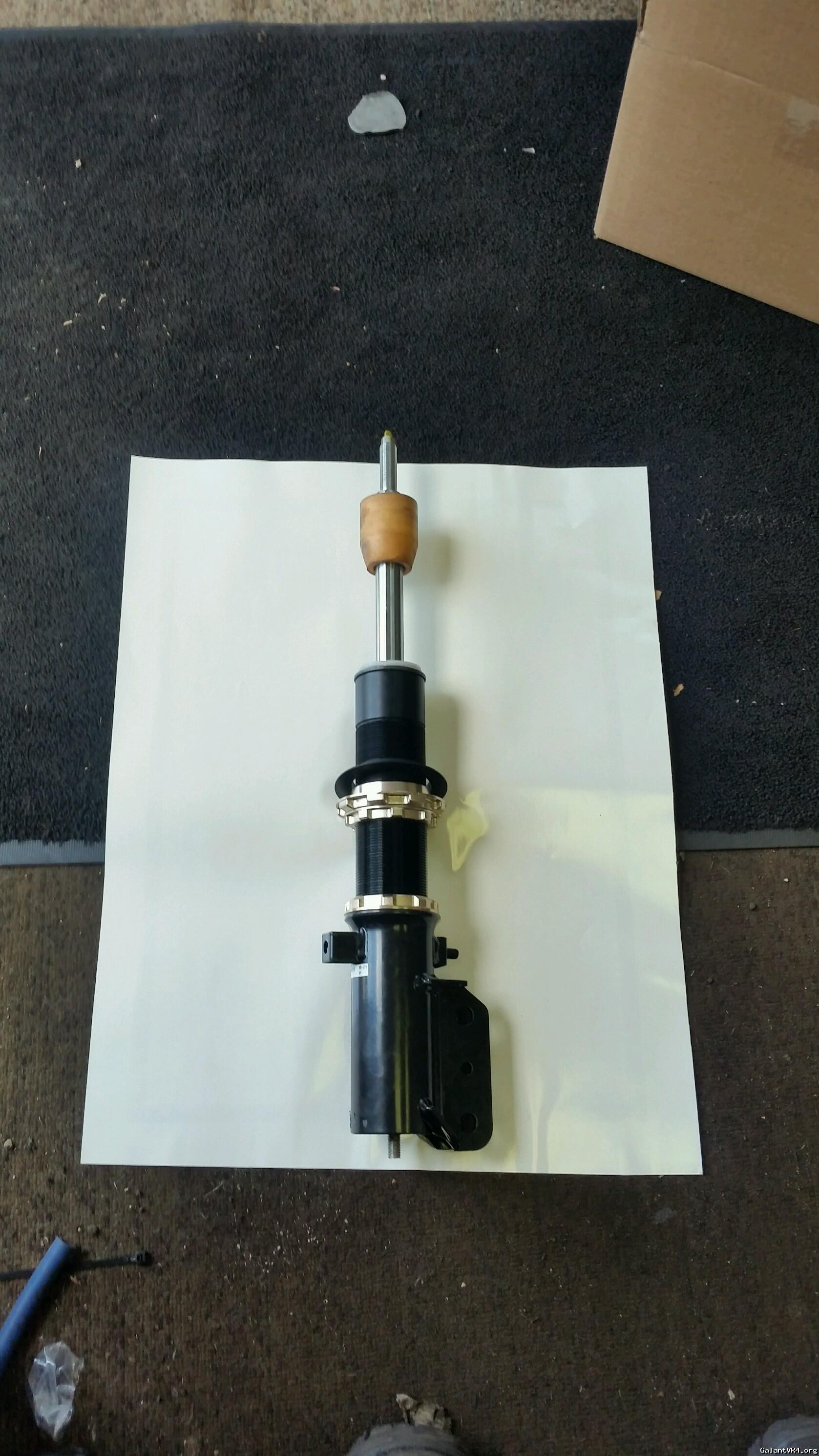

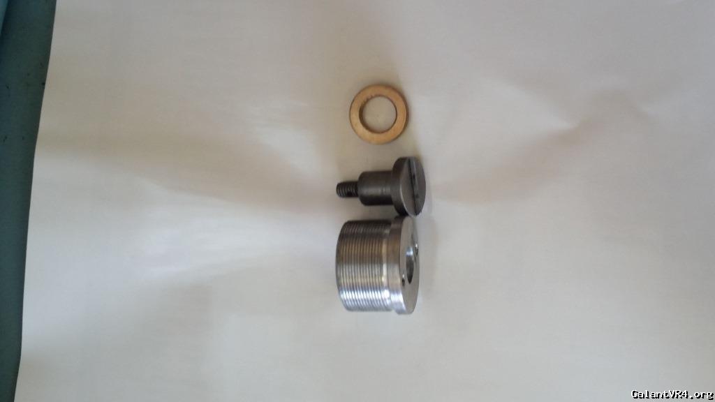

So I haven't done much to the car other than fix misc broken stuff. I wasn't quite satisfied with the suspension on the car but didn't like what was available for sale either. I have been planning this out for years but never got around to doing anything. Finally got around to getting it done. Custom front coilover shocks using Koni 8611 race inserts. I am re-doing the compression adjuster knob but for the most part its done and I've already got to test it out. I couldn't fund doing the custom rear shocks so I just had the ones already on the car re-valved. I also installed a set of FWD spindles. The car drives really good.

Nice work! Any more info on the Coilover setup? I had always figured there must be a way to use cheap housings, and fit them with a Koni/Bilstein etc insert.

I actually had a machine shop make the housings and a custom lower gland nut to house the adjuster adapter. I bought the lower mounts and spring perches from bc. I have tein camber plates and swift springs.
