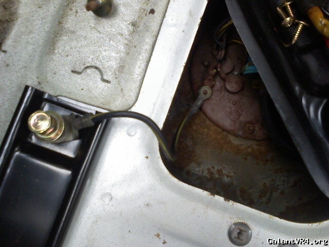

Run a 10GA wire from the pump housing plate to a frame point (clean all gounding points and then protect). Just because you have 10GA for power does not mean that the pump is gounded good enough stock.
Yes but that's the relay ground; it's not connected to the fuel pump. He's talking about grounding the fuel pump as well, so you're upgrading both the hot and cold sides (relative to the pump) of the circuit for optimal flow. Which is a good idea btw; I'm going to go ground my fuel pump this afternoon. Thanks for the tip.
11,009
I had a grounding issue following my rewire, new fuel pump and reconnecting a wire that broke off the fuel pump housing. I added a second ground to make sure it was good and stable. Good advice to make sure the ground is good, because otherwise it can shut down the fuel system.

Bringing this thread back up...would I be able to get away with grounding this wire from the housing plate to the bolt that the rear bumper bolts to (that big ass bolt coupled with another one for the bumper support)??? Thanks
