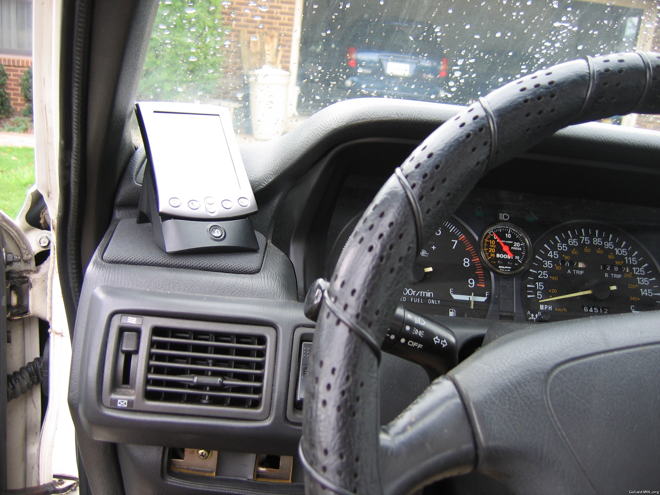

i know i saw this one somewhere but i cant find it again. anybody know how to modify a logger cable so it provides power to the palm while in the car. i hate the thing turning off on me.
I used an old docking cradle for connecting the palm to the computer. I then used the instructions here to add the serial capabilities to be able to hook it to the car. When doing this, don't disconnect the USB wires. Once I made sure that it would communicate with the car, I added power. To do this, I just found a palm car charge pack at staples I think that had a charge cable and a cigarette lighter plug with a usb port on it. I discarded the cable and plugged the USB portion of my charging cradle into that. It charges when the car is on and turns off 1 automatically 1 minute after the car is turned off. I don't think you have to go through all of that hoopla if you don't want to though. I think you can use a palm cabel that has USB and serial dongles on it and plug the serial cable end to the datalogger and the USB end into a cigarette lighter USB deal.
