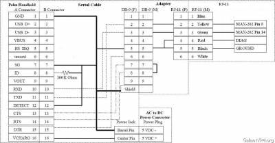

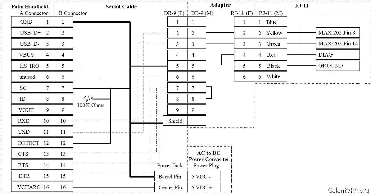

It was the car battery. What parameters should I turn off? The only thing I had selected was the RPM and INJD. I am doing this with the car on but not running due to what is mentioned above.
I hooked everything back up with a partially charged car battery. With everything on I got "none". I unplugged the mass air and got code 13. So I DEFINITELY can check codes.
I didn't spend very long with it this time. So, I didn't exhaust all of my options. But everything I did try so far hung when I unpaused to log.
This is the current setup. I am lacking a pin out for the max-202 or a schematic for its circuit.
With the above setup, I tried all the baud rates available. 1920 and 1953 gave me ECU comm error. 2148 and 2193 read the codes but locked the palm when I tried to log. 2246 gave me an ecu comm error on the "active" and about 8 miscellaneous errors in stored. Everything higher gave me a serial comm error, although I stopped trying after 19200.
I went back and tried the two that worked with out the jumper from pin 7 to 8. It made no difference.
