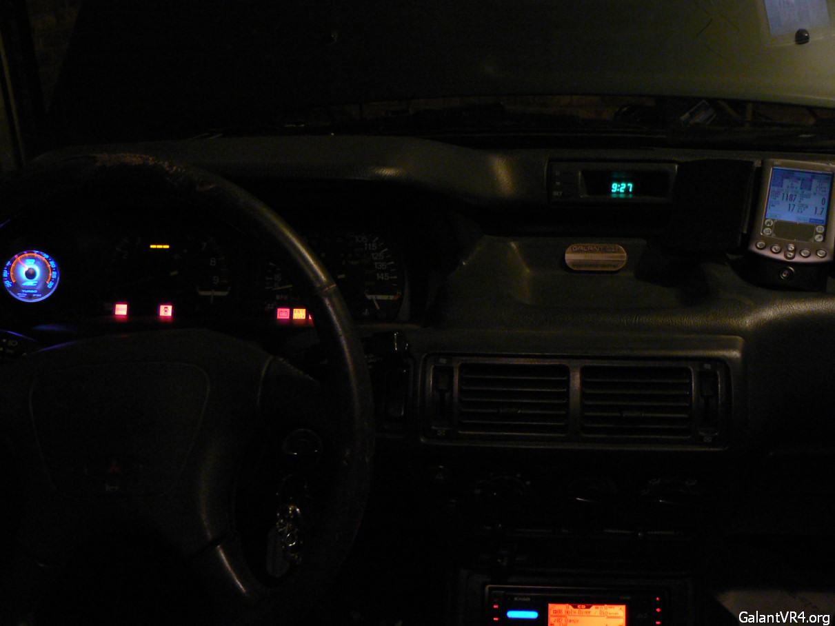

I think I posted that link to the cradle mod awhile ago!!! I've done this and i currently have an m515 logging and charging. (the PDA's battery no longer holds a charge so I have to have the charging, MMCD lies on the memory card). GPS would be nice but, at least for me, it will have to be a separate device. I really like Pioneers in-dash system if it weren't for teh $2000 price tag. I'm waiting for a portable device that can recieve the XM NavTraffic signal. The pioneer can pick up traffic info from XM and automatically direct you around and help you avoid the stop and go. Pretty cool. They just need that in a portable for multiple vehicle applications.
-Josh
PS. When I get my car back up to PA, I'll take some pics of my logger setup. I modified the cradle to provide logging and charging. I then removed the stabalizing wait from teh cradle, ran the wires out the bottom of the cradle instead of the back and bolted the wires to the driver's side speaker grill. The wires go through the grill and around the speaker to get to the ECU and power. The angle is great for my tall self to read while driving. I haven't had it fly off on a launch yet either, I'm guessing the angle helps with that too.

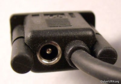

Ditto. Right now I'm using the palm serial cradle for the M505. This is the universal cradle that comes in either USB or Serial that you can wire for both. The nice thing is that you can just adapt a 12V source right into the end of the plug at the serial connector. I'm going to hack the cradle up so I can mount it in a more suitable location and add the rear clips that Palm didn't include. I have managed to make mine go flying once or twice.

From those I concluded that I can get the serial sync cable (on order /ubbthreads/images/graemlins/rolleyes.gif ). The resistance between pins 7 and 8 will probably be 7.5K ohms. For an RS-232 peripheral it should be 100K ohms and for a modem it should be 220K ohms. I'm not sure which one I need. Anyone know?
FYI, a short is USB.
So I'll mod that as needed. I'll go with the 100K unless someone tells me other wise. I also bought about $10 worth of components to piece together a voltage regulator to get the 5 volts the palm wants to see. I'll just cut off the power connector on the sync cable and hard wire in the proper voltage.
I have a funny feeling, this seems like it will all work out but will probably screw me in the end.

The cable showed up. The resistor is a 7.5k. My guess is it won't work, but I lost my rj11-db9 adapter (see other thread) so I can't test it.
