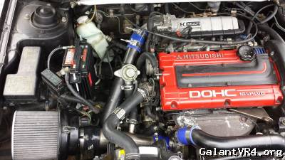

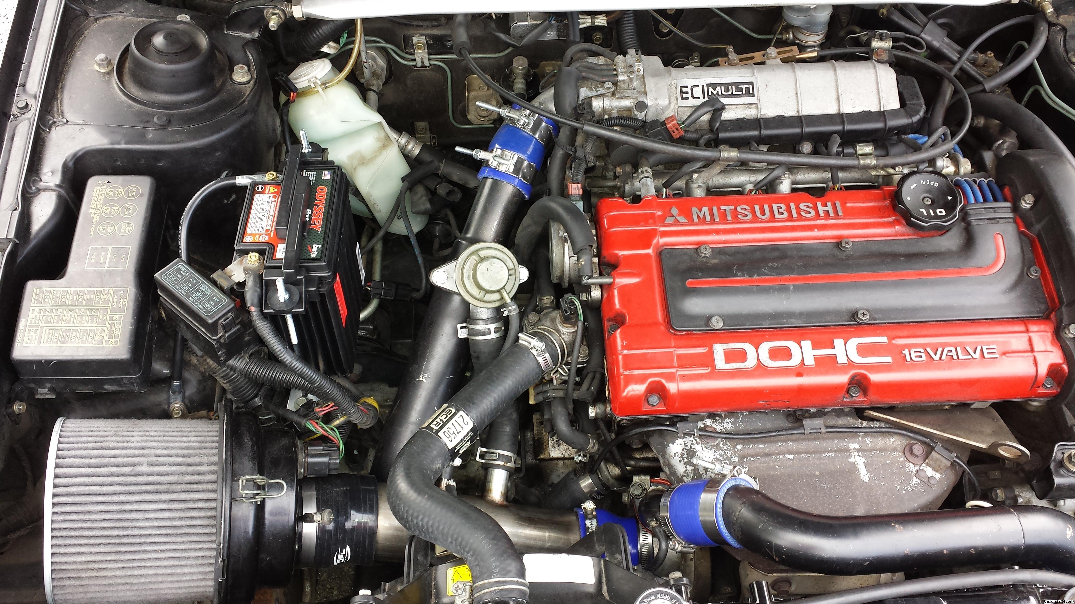

I bought a small odyssey battery and mounted it where the air can goes in stock position. making a bracket was simple and used a universal tie down you can buy at the parts store. Didn't have to reroute any wires and used the stock cables. Works great

My setup. Didn't have to change any wiring other than put in a new ground cable from the battery.
