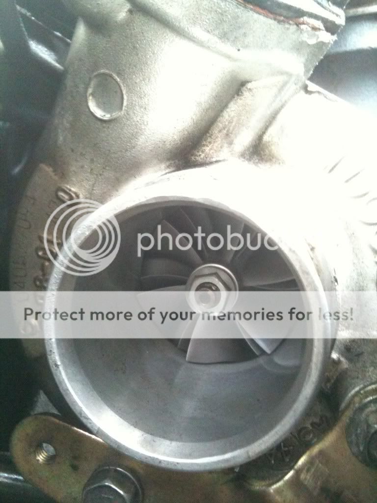

part #s of small 16g,big 16g and evo3 16g
GSX_TC
Apr 7, 2011
3,733
Houston, Texas
You think I have an Evo III Big16g than Anthony? That's what I have based on those numbers. But everyone has told me it's just a regular big 16g
GSX_TC
Apr 7, 2011
3,733
Houston, Texas
ok so what turbo is this then, i was told it was just a Big16G
beaner
Jun 22, 2005
1,562
b'ham, mi
I feel like I've owned 50 tdo5 turbos through trading and swapping over the years. The 47 indicates it's an Evo III. If it had 52 it would be a small 16g and 42 is a big 16g. Those are the only numbers you really need to know. 14b is pretty obvious. The tdo5h 20g is a head scratcher, then you realize the compressor housing is machined out and the intake wheel is huge. /ubbthreads/images/graemlins/hsugh.gif
