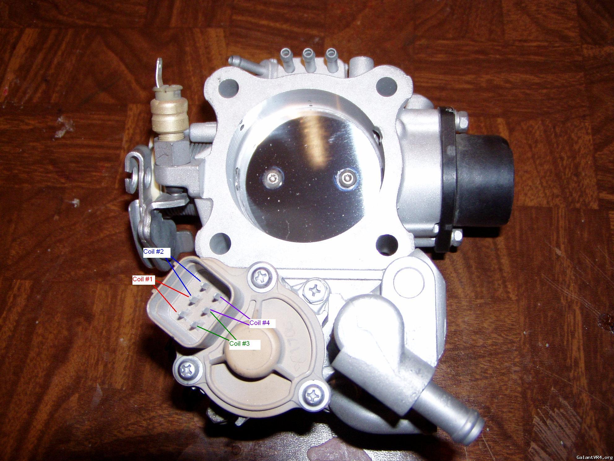

You most likely have a seal or gasket that has failed in the TB or an injector seal that has cracked or gotten so hard it can't seal anymore. And these really show up after full temp has been reached.

Omg I'm gonna go crazy. I didn't hear any extra air being pushed from the TB /ubbthreads/images/graemlins/dunno.gif Maybe I don't know what to fully look for but I have thought of everything I could. /ubbthreads/images/graemlins/bawling.gif
